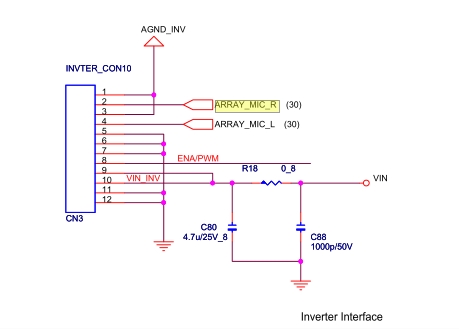

                              Sounds like a plan. Would you happen to have a diagram for this laptop or know where I can find one? The info you provided is very helpful.

                                Re: Opinions on converting CCFL to LED
                                what is your mobo model name ?
                                  Here you have a Inverter Interface it´s from a TOSHIBA Satellite A505-S6025 - QUANTA TW3A - REV 3A.
                                  ENA/PWM usually are separated signals, and VIN =19 volts.
                                  ARRAY_MIC_R, ARRAY_MIC_L are signals that usually are not in this conector.
                                  Also normally are two pins of ground.

                                    You guys have really jumped in to help. Thanks a lot. My board is a compal nswaa. I was able to find a diagram. Now i have to find the page with the inverter pinout. I connected everything back with the converter cable without the led inverter and it works.
