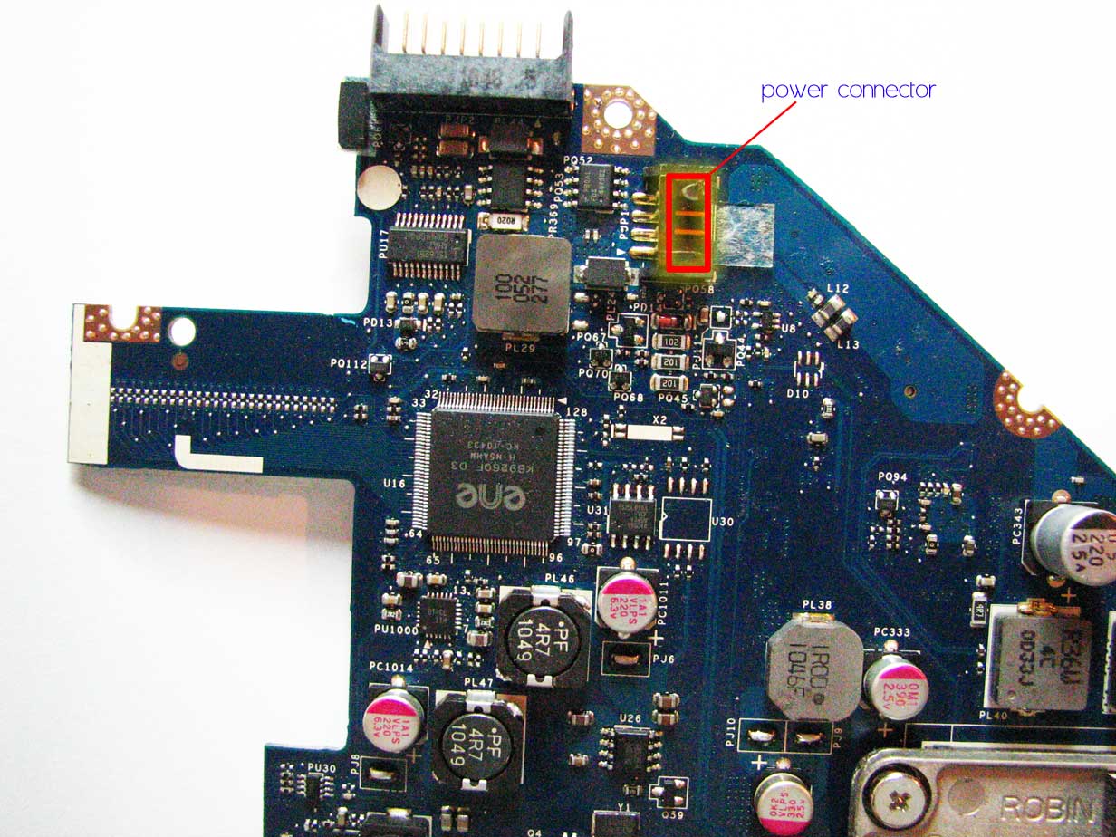

    Hi. I need help with acer aspire 5742z Laptop has no power an is complete dead, no lights no nothing.
    I got picture of power (I think) part on motherboard if help.
    What element could be damaged ?
    Thank you.

    Try checking the inductors? Its the square big blocks, they might of fallen off.

      Re: Acer aspire 5742z no power / dead
      Here's the schematic: http://lqv77.com/download/645/
      Trace from the power input and see where the voltage disappears. With it plugged in, you should at least have the standby voltages.

            Did you eliminate the obvious:
            1. test power supply for stable 19V output
            2. make sure you have 19 input at the connector (plug it in the MB and test the solders that are on the motherboard)
            Capacitor PC343 (far right, big electrolyte one) looks bulged on the pic. Perhaps it's shortened?
            Just a thought.

                          For Acer 5742Z the motherboard is LA-6582P i guess if yes then Check 19 Volts PR351 (its shunt resistor) If no voltage present you need to check the charger controller IC ISL6251A (pins to check 24.DCIN, 8.VREF, 2.ACDET) if DCIN is OK and no other voltages present you need to check FET's PQ51,52. Also post what is the current pull up when connected to power source. Cheers
