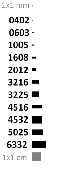

                              Re: Dell D610 bleed resistor
                              Originally posted by Uranium-235
                              <snip>what I wish is that someone made a non-smt one with those similar values =/
                              soldering even a brand new smt can be such a pita<snip>
                              Good grief! 1608 metric = 1.6 x 0.8 mm ! = ▪▪
                              Don't breathe!
                              A small jeweler's flat blade screwdriver to hold it and the smallest iron tip. Clean pads with solder wick, flux on pads, position part & HOLD tight to board. Tin iron and touch one end. Spin the board 180° and do the other.
                              Magnifier glasses help and great lighting.
                              Approx size chart from Wikipedia attached.

                                I can't tell if your first statements are sarcasm or not, are you saying its not that hard?
                                I used very fine ended tweezers, and fyi the smallest tip isn't always best, but the smallest FLAT tip is. I tried a very fine rounded tip and it didn't work so well. but then again neither did the small flat tip. I think its cause the part was fairly BROKEN off, and not new

                                  Moi? Sarcastic? Surely you jest!
                                  It's not that hard. Just don't breathe.
                                  Both ends still have the metal on them, correct?
