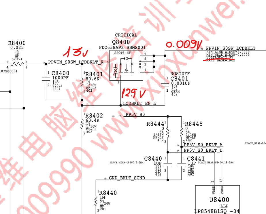

    Hi all . I really need your help. A MacBook arrived with a broken display to replace the display. After replacing the display the image disappeared. Everything works through the external screen. replaced some components with new ones and to no avail (U8400.U8500. U8501)
    here are some measurements
    PPBUS_G3H=13.07v
    F8400=13v
    PPVIN_S0SW_LCDBKLT_F=13v
    PPVIN_S0SW_LCDBKLT_R=13v
    ISNS_LCDBKLT_P=13v
    ISNS_LCDBKLT_N=13v
    PP5V_S0=5.14v
    PPVIN_S0SW_LCDBKLT=0.018v (should be 12.9v)
    PP5V_S0_BKLT_A=5.14v
    PP5V_S0_BKLT_D=5.14v
    BKLT_SD=12.97v
    LCDBKLT_FET_DRV_R=0v (should be 5v)
    PPVIN_SW_LCDBKLT_SW=0.035V (should be 55V)
    PPVOUT_S0_LCDBKLT=0.002V (should be 55V)
    EDP_BKLT_EN=0v (should be 3.3v)

            I have a very low voltage on the line PPVIN_S0SW_LCDBKLT=0.009v instead of 12.9 help restore
            replacing Q8400 did not help
            • mon2
              • Dec 2019
              • 14612
              Re: Macbook A1706. 820-00923-A. Black Screen.HELP
              This means that R8402 is just floating and not being pulled to ground. When the backlight is enabled, R8402 will be pulled low (to ground) and a voltage divider will be created at the gate pin of the pass through mosfet.
              That is, the backlight input voltage of ~12 volts will be lowered by the resistor based voltage divider built by R8402 & R8401. This lower gate voltage on Q8400 will cause this P-channel mosfet to enable.
              On a P-channel mosfet, the GATE voltage must be LOWER than the voltage being passed between source and gate pins. If the gate voltage is the same, the mosfet will remain off - as in your case.
              If R8402 is not being pulled low then do confirm that R8402 is not damaged. The backlight IC must also be enabled to perform this task.
              PS: You should be getting some beauty sleep not hacking
                As always, thank you very much for the extensive explanation. but even with the display connected it remains unchanged
                  Well, let's go back to the original problem: there is no backlight and it behaves as if the display is not connected
                  what else can I check?
                  R8402 =63.4K good
                    this is with the display connected
