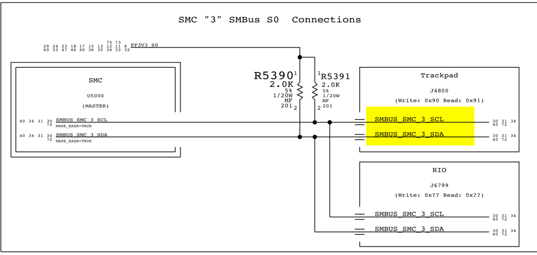

      Attach the trackpad. Meter in voltage mode.
      Carefully measure the voltage to ground of:
      SMBUS_SMC_3_SCL
      SMBUS_SMC_3_SDA
      Post each measurement. Given that the unit stops working when you attach the trackpad, the above SMBUS lines are a suspect.

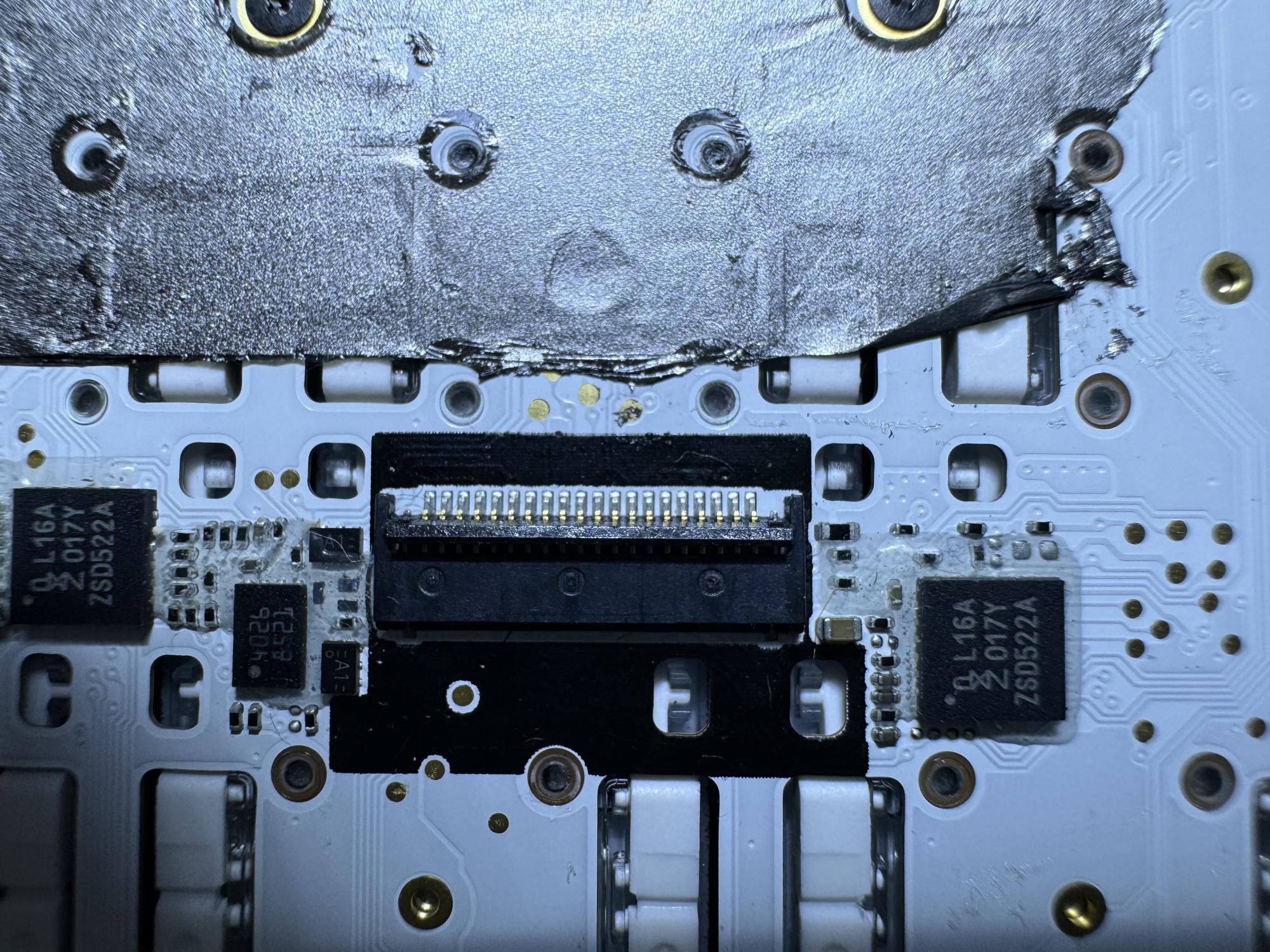

              So there is probably short on the keyboard. Is there anyway how can i inject voltage to keyboard connector to see which component is shorted (if there is) ?
              I've attached photo of the keyboard connector.
              Keyboard number is 820-00252-A but this gives me no schematics

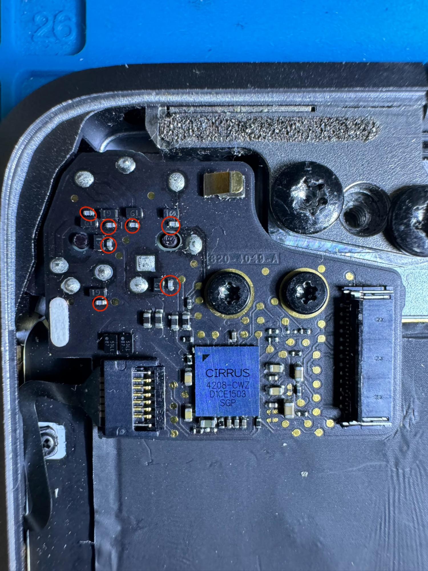

                Re: A1534 820-00045 - USB-C not working both sides
                Does anyone know if there parts are fuses ? (It's audio board) they looks to me like fuses and most of them beep if i test them only 2 not so i'm curios if this is why there is no sound

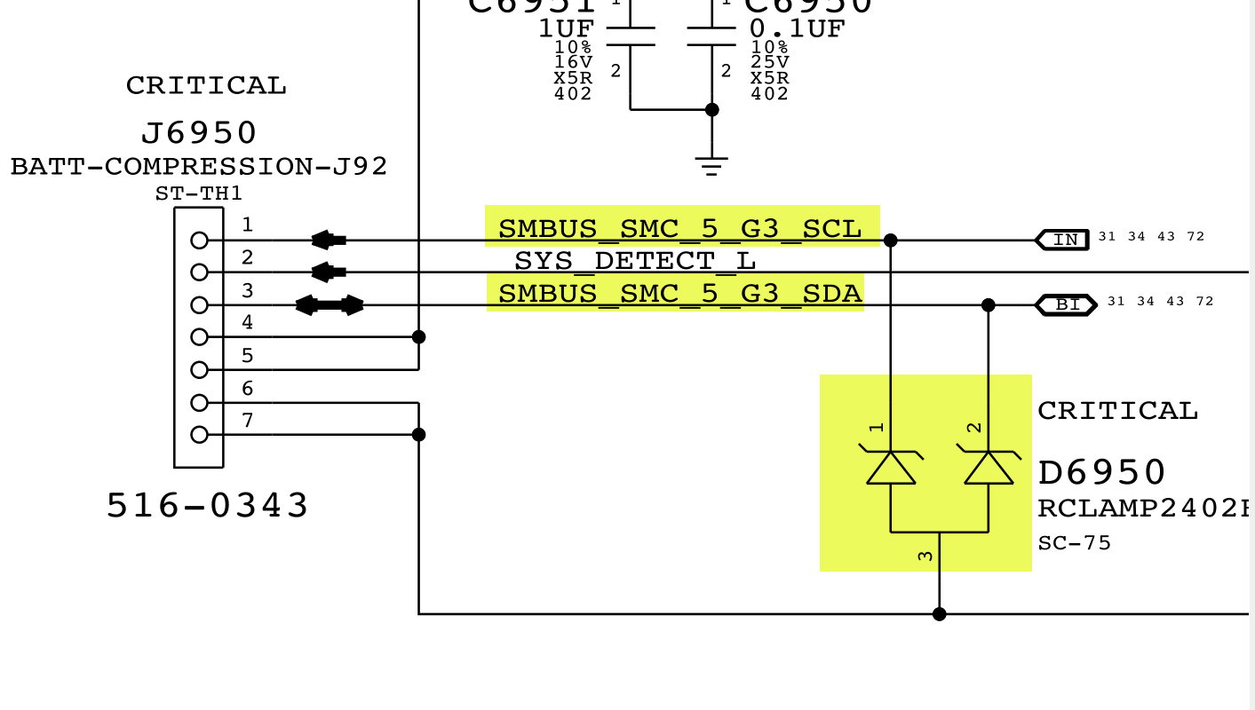

                    Attach the battery -> meter in DC volts mode (20v or higher is ok). Measure the voltage to ground of each pin of the battery connector. Of most interest are the pins # 1 and # 3 = Battery ESD diode pins. Often, one of these dual diodes will get zapped from being man handled and the ESD diode @ D6950 dies as it should under an ESD event. This prevents the battery communication from working after such an ESD event. Confirm the voltage to ground of these pins and also confirm by using the meter in DIODE mode.
                    In DIODE mode, red meter probe (yes RED) to ground. Black onto battery connector pin # 1 - what is the measurement? Then repeat for pin # 3. If the ESD diode is damaged, the reading will be very different for that leg of the dual diode and should be close to 0 volts.

                      I've checked and on battery pins I'm getting SMBUS_SMC_5_G3_SCL - 0,488V, SMBUS_SMC_5_G3_SDA - 0,588V
                      on D6950 I'm getting SMBUS_SMC_5_G3_SCL - 0,49V and SMBUS_SMC_5_G3_SDA 0,58V

                        So these SMBUS / I2C lines are not shorted. These measurements are good for a working pair of lines.

                                On post #10 -
                                1) are these voltage to ground measurements or diode mode measurements?
                                2) if diode mode measurements, remove all power and also remove the battery before using diode mode on your meter to test these smbus lines.
                                3) if voltages to ground readings then these values are not correct. Remove the battery and attach the power adapter and check these lines again to see if each line is at a higher voltage level. If not, the pull up voltage on this pair is missing.
                                4) if the voltage is ok without the battery pack but bad when the battery pack is connected then battery pack is defective.
                                5) if voltage here remains low but pull up voltage is ok then the esd diodes are damaged and they are pulling down these lines. Flux and remove the tiny esd diode pair. Measure again after the dual diodes have been removed.
