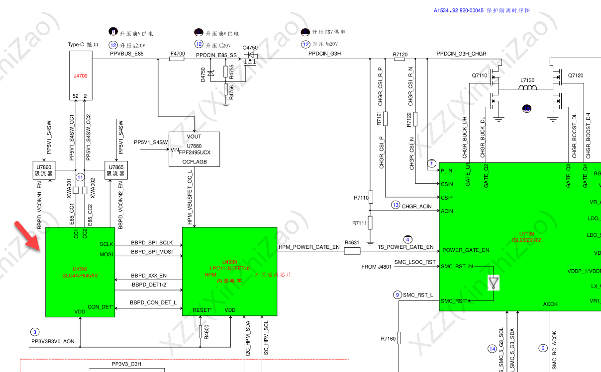

    Fair enough - confusing with another one of their craptops.
    See here and attached:
    https://old.repair.wiki/w/A1534_2015...MacBook_Retina
    The Dialog Semiconductor (Silego / Renesas) part is acting like the power delivery controller on this model = U4700.

      I've checked one more time and it looks like I have resistance on PP3V3R3V0_AON - 78ohms.
      I've tried to replace U7100 for another one but the resistance is still almost same now with replaced U7100 it's 80ohms.
      I don't have another U7100 so I have to order it and try to replace again if it help.
      I've removed U7100 and without IC (U7100) installed resistance to ground is still 84ohms. Probably something else is faulty ?

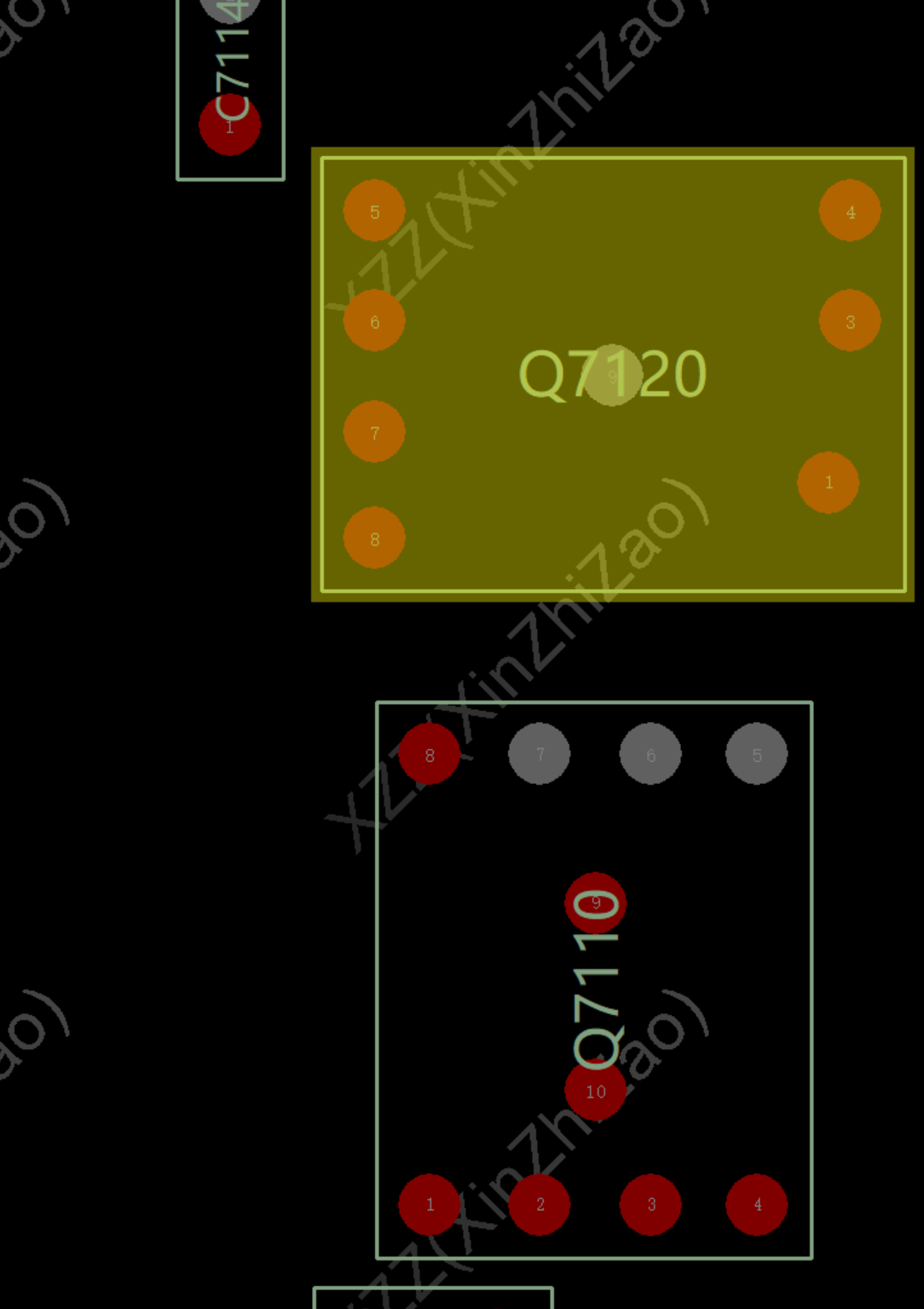

                  • mon2
                    • Dec 2019
                    • 13926
                    #49
                    Some measurements for these mosfets have been missed. It is important to check these parts. Let us do this by pin numbers. See attached.
                    Interested in the resistance between the following pins on Q7110:
                    pin # 1 (gate1) & pin # 2 (drain1)
                    pin # 1 (gate1) & pin # 9 (source1)
                    pin # 9 (source1) & pin # 2 (drain1)
                    The above is for the HIGH SIDE mosfet checking of Q7110.
                    Next,
                    pin # 8 (gate2) & pin # 5 (source2)
                    pin # 5 (source2) & pin # 9 (drain2)
                    The above is for the LOW SIDE mosfet checking of Q7110.
                    Interested in the resistance between the following pins on Q7120:
                    pin # 3 (gate1) & pin # 1 (drain1)
                    pin # 3 (gate1) & pin # 6 (source1)
                    pin # 6 (source1) & pin # 1 (drain1)
                    The above is for the HIGH SIDE mosfet checking of Q7120.
                    Next,
                    pin # 5 (gate2) & pin # 9 (source2)
                    pin # 9 (source2) & pin # 6 (drain2)
                    The above is for the LOW SIDE mosfet checking of Q7120.
                    Post each measurements for the above lines of mosfet checks.
                    • obelix24
                      • Jun 2023
                      • 291
                      • Slovakia
                      #50
                      Q7110
                      pin # 1 (gate1) & pin # 2 (drain1) - 3Mohms
                      pin # 1 (gate1) & pin # 9 (source1) - 2,2Mohms
                      - 0 ohms
                      pin # 8 (gate2) & pin # 5 (source2) - 10k ohms
                      - 5M ohms
                      Q7120
                      pin # 3 (gate1) & pin # 1 (drain1) - 7M ohms
                      pin # 3 (gate1) & pin # 6 (source1) - 0,9M ohms
                      pin # 6 (source1) & pin # 1 (drain1) - 2,2M ohms
                      pin # 5 (gate2) & pin # 9 (source2) - 4M ohms
                      - 2,2M ohms

                        Confirm these measurement again - otherwise, with the low resistance measurement this dual mosfet is defective and needs to be replaced.
                        • obelix24
                          • Jun 2023
                          • 291
                          • Slovakia
                          #52
                          I've removed this mosfet and checked pins directly on board
                          8 and 5 - 10k ohms
                          9 and 2 - 2,4M ohms
                          I've checked pins 8 and 5 on mosfet (on the table just mosfet) - OL
                          9 and 2 - 2,4M ohms

                            #53
                            ok after some time i've returned to this board.
                            I noticed that there was cracked IC U8310 (there was missing corner where PANEL_P3V3_EN is but macbook was working even with this - strange) i've replaced it.
                            I've connected official 61W USB-C charger with ampmeter and i was surprised that macbook was taking 19V and charging battery fine. When i turned cable 180 degrees there was nothing ampmeter was not turned on at all. I've tried also 15V (nintendo switch charger as i don;t have official 29/30W from apple) but this should be fine ... also only one side was turning ampmeter and charging with 14,5V ...
                            I then just tried USB-C cable that was connected to 5V only and to my surprise both sides where working, also in MacOS battery icon was changed and there was symbol that it's connected to power. So it looks to me that USB-C port is ok and is communicating with board.
                            Then i tested one more thing that i've connected USB-C hub (hdmi out put, USB-A and USB-C) and here on one side i got information in MacOS that "Unplug the accessory using too much power to re-enable USB devices" but there was no output connected to that usb hub )only hub itself.
                            So now i'm confused ... why one side of USB-C is working fine (charging, ...) and the other side is not charging but it's working when connected 5V only ...
                            • obelix24
                              • Jun 2023
                              • 291
                              • Slovakia
                              #54
                              OK finaly i got it
                              problem was that PP5V1_S4SW_CC1 was shorted to ground I was checking via diode mode on J4700 PIN52 and the reading was 0,003V
                              It looks like the trace was going only to U7860 but even with this IC removed short was still there. I've soldered little wire to pin 3 (U7860) and injected 0,9V it was taking only 0,3A and nothing showing on this side of the board, i've flipped the board and U4700 was getting hot after removing this short was gone I've soldered new U4700 and checked diode reading PP5V1_S4SW_CC1 and it was here 0,4V.
                              After placing board back to case port was fully working 14,5V on both sides
                              Only issue left is that there is no sound from internal speakers If i connect headphones sound is working. I can adjust sound via keyboard and internal speakers are visible in MacOS by no sound via them
