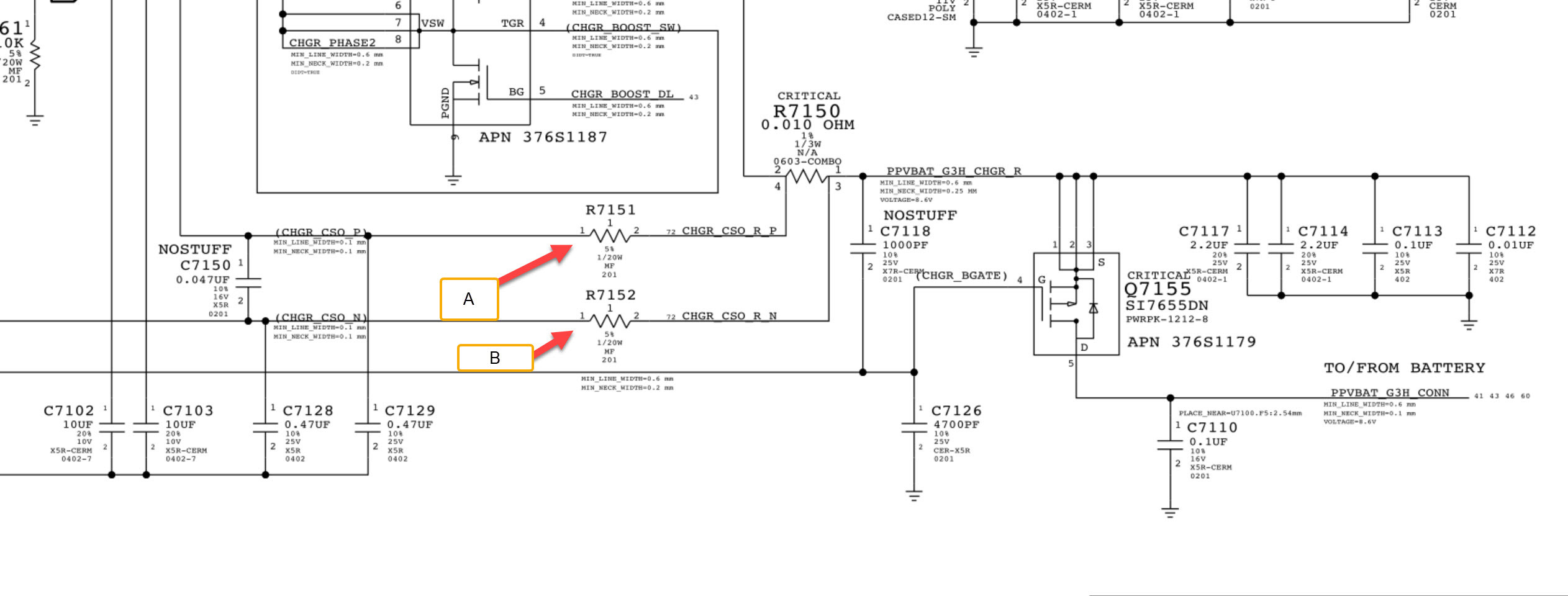

    ok so update...
    Reconnecting keyboard flex cable was issue and now keyboard is working
    battery charging is working but only at 5V. I now really don't know what can be problem that it's taking only 5V but charging.
    I've tried another battery and this one is not service required but still only charging at 5V ...

      Would you have another meter to test the voltage measurements?
      The posted smbus voltage readings are too high.
      Remove the battery to check if the same smbus pins are lower.

        I've checked now battery and charger connected (macbook turned on)
        SMBUS_SMC_5_G3_SDA (Pin 3) I'm getting 3,3V
        SMBUS_SMC_5_G3_SCL (Pin 1) I'm getting 3,3V
        should i try to replace U4700 one more time ?

          What is the voltage to ground of PPDCIN_G3H ? It should be 20v for the proper charging and operation of this macbook.
          Are you using the official and recommended power adapter? At least consider to use 65W or higher power adapter. U4700 is the Silego (SLG4AP645AV) device that will communicate with the power adapter to select the 20V power delivery contract using the CC1 / CC2 lines.
          Are the contacts on the Type C contacts clean? We did go down a similar rabbit hole a few weeks ago for a few minutes and found the only fault was the actual physical contacts were very dirty. Too dirty to even clean with alcohol. We had replacement USB C paddle boards for the macbook brought in for service. The client purchased new cables / new power adapters from Amazon with hopes of a quick fix. Suspecting her cat was the guilty party of this case.

            I'm using official 61W power adapter with official USB-c cable.
            PPDCIN_G3H - 20V

              Remove all power. Remove the battery. Meter in the lowest resistance mode.
              Measure the resistance between points A & B. Post the measurement.​ Click image for larger version

                resistance is 13 ohms (between A and B)
                • mon2
                  • Dec 2019
                  • 13931
                  Short your meter probes. What is the resistance measurement?
                  The resistance of this path is too high. It should be ~2 ohms.

                    #29
                    when I short probes resistance is 0,3ohm
                    on another a1534 board resistance between A and B is 2 ohms

                      Ok - so this is a fault. Need to determine between the 3 resistors in this path - who is guilty.
                      Measure these points again and if you do not see ~2 ohms, proceed to check the resistance of each resistor.
                      Measure the resistance across R7151 (pin #1 & #2) - should be ~1 ohms.
                      Measure the resistance across R7152 (pin #1 & #2) - should be ~1 ohms.
                      Measure the resistance across R7151 (pin #2) & R7152 (pin #2) - should be ~0,3 ohms since this current sense resistor is in milli-ohms if it is ok. That is, your meter will not be able to measure it neither will our $1,000 fluke so we only want to see like a dead short = 0,3 ohms at this junction.
                      Someone in this path is not behaving.

                        R7152 - resistance approx 2ohms
                        R7151 - resistance 11 ohms (so it looks like this is faulty I will try to replace)

                          I've replaced R7151 and now resistance is OK, but MacBook is behaving same.
                          Still only 5V on charger
                          I've checked PP3V3R3V0_AON and resistance is in Mega ohms - this should be ok.
                          I'm thinking if not U4520 or U4440 are bad ...

                            Remove all power / remove the battery. Review the battery mosfet @ Q7155.
                            Measure the resistance across the mosfet pins:
                            source (1-2-3) & drain (5-6-7-8)
                            source (1-2-3) & gate (4)
                            gate (4) & drain (5-6-7-8)
                            Post each measurement.
                            meaning that you have 5 volts @ PPVBAT_G3H_CONN ?

                              on PPVBAT_G3H_CONN I have 8,7V when MacBook is powered on
                              When it's off I get there only 0,7V but falling down....
                              according to Q7155 I think it's ok
                              source (1,2,3) to Drain (5) - 40k ohms
                              source (1,2,3) to Gate (4) - 2,8M ohms
                              Gate (4) to Drain (5) - 4,7M ohms
                              but as I wrote before. Macbook is charging battery but only at 5V and max 0,2-0,3A (I was able to charge the battery to 94% (before it was approx 20%)

                                40k resistance on Q7155 is considered to be low for a mosfet. Carefully flux and remove this mosfet for checking out of circuit. Compare to a known good unit and it should be with a higher resistance.

                                  Looks like i wrongly measured. After remeasure the value is approx 2M ohms also between source to drain.
                                  What do you think about replacing U4440 or U4520 ?
