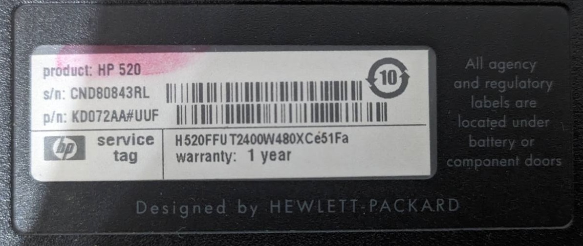

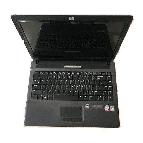

    Iat50 la-3491p rev 1.0 no power
    Hp 520
    s/n: Cnd80843rl
    iat50 la-3491p rev 1.0
    issue: Led shows up for a second then off
    bq24703 charger ic
    pins - name voltages
    1 - batdep - 3.2v
    2 - srset - 0v
    3 - acset - 0v
    4 - vref - 0v
    5 - enable - 0v
    6 - batset - 0v
    7 - comp - 0v
    8 - acn - 19.0v
    9 - acp - 19.0v
    10 - nc1 - 0v
    11 - nc2 - 0v
    12 - batp - 0.2v
    13 - ibat - 0.4v
    14 - nc3 - 0v
    15 - srn - 0v
    16 - srp - 0v
    17 - gnd - 0v
    18 - vs - 0v
    19 - alarm - 0v
    20 - vhsp - 17.7v
    21 - pmw# - 19.0v
    22 - vcc - 19.0v
    23 - nc4 - 0v
    24 - batdrv - 0v
    25 - acdrv# - 19.0v
    26 - acdet - 0v
    27 - acpres - 0v
    28 - acsel - 0v
