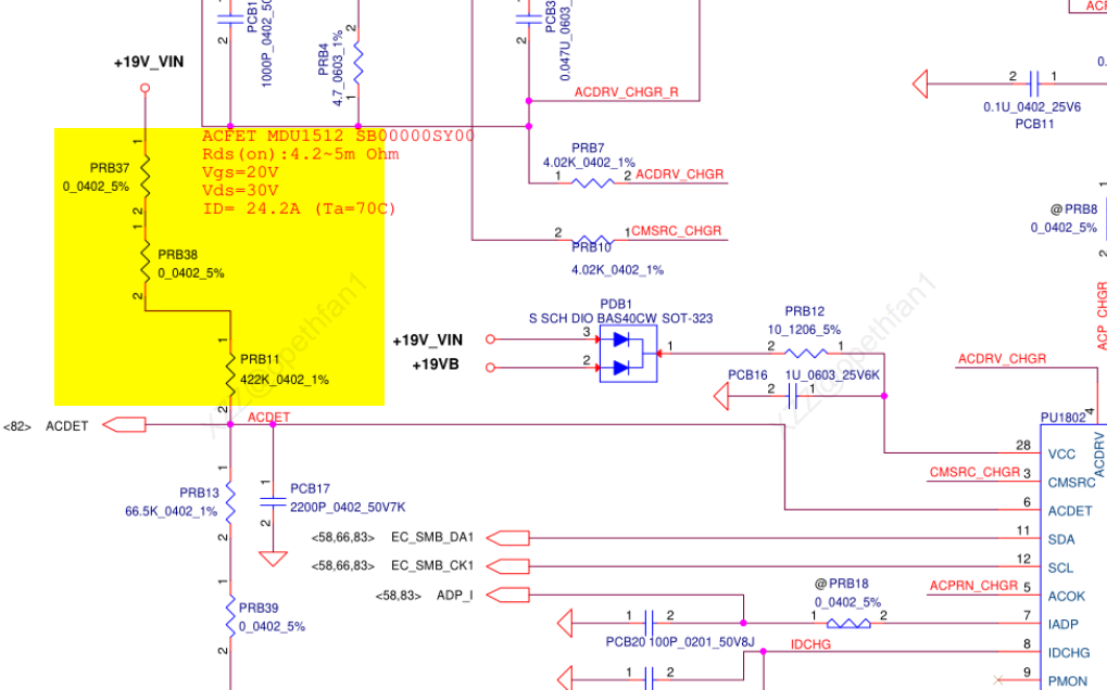

    i'm not skilled with laptop repair, i need some helps:
    i don't have ACDET on PU1802 and in consequence i don't have ACDRV
    please check pictures

    Confirm the voltage on each of the 3 resistors on ACDET (highlighted in yellow).
    Red meter probe on the resistor; black meter probe to ground. DC volts (20v or higher scale).
    Report each measurement.

        Remove all power. Meter in resistance mode. Measure the resistance from pin #2 (where you measured 0V) to ground. What is the resistance in ohms?

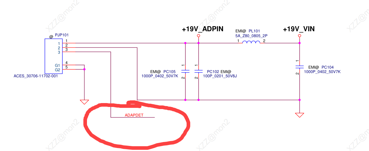

          Ok - see attached. This should explain your case with a solution.

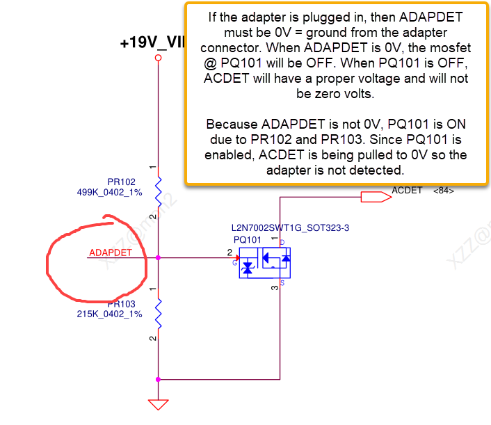

          Summary: Your ADAPDET pin on the power adapter is not supplying the ground (0V) to properly announce the ACDET voltage. See the explanation below and confirm each measurement.
          To test, take a piece of wire and touch one side of the wire to ground. Other side of the wire to PQ101 pin #2 (be sure you review where pin #2 on this mosfet is located).
          By shorting / pulling the gate voltage to GROUND (0V), PQ101 will turn OFF. Then you will have a valid voltage on ACDET.

              ACDET now is 2.6v but still no power

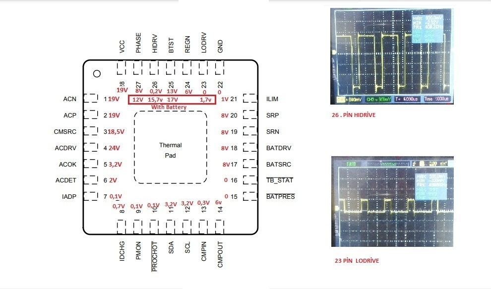

                      PJP101 power jack is important. BQ24780's 15 pin BatPres and REGEN are important. Measurements were taken with and without battery. Can you check?

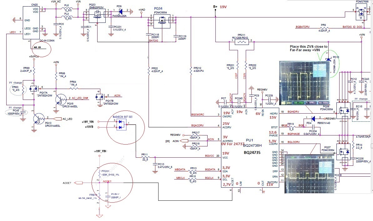

                          Looking for some help with this one if anybody can assist please? I have an HP Probook 470 G4 Laptop which recently started to intermittently failing to turn on, with intermittent white LED light(charging LED) by the charging port when it should have been charging and showing an orange LED instead. Definitely some sort of gradual failure. Now the laptop fails to power on at all, no charging LED, no Power Button LED either - seemingly dead.
