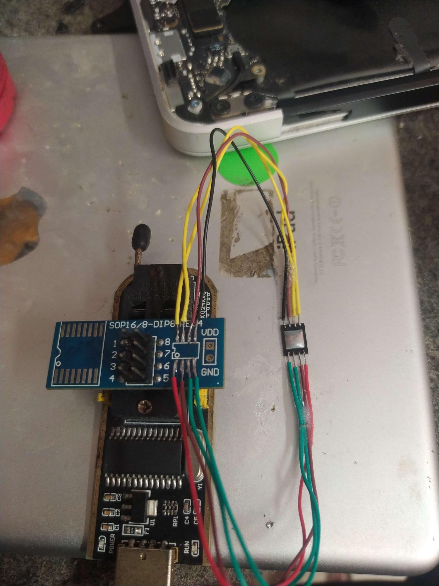

    So i found something strange, i have a mac a1370, already took the dump from the mx25l640E, i dont have the adapter but i managed to solder it on a board adapter with cables
    I can read from it
    I can erase it (VERY SLOW THO)
    but cant write on it, am using CH341 3v (came modded from where i brought it)
    Also using NeoProgrammer 2.1.0.19
    What can i do?

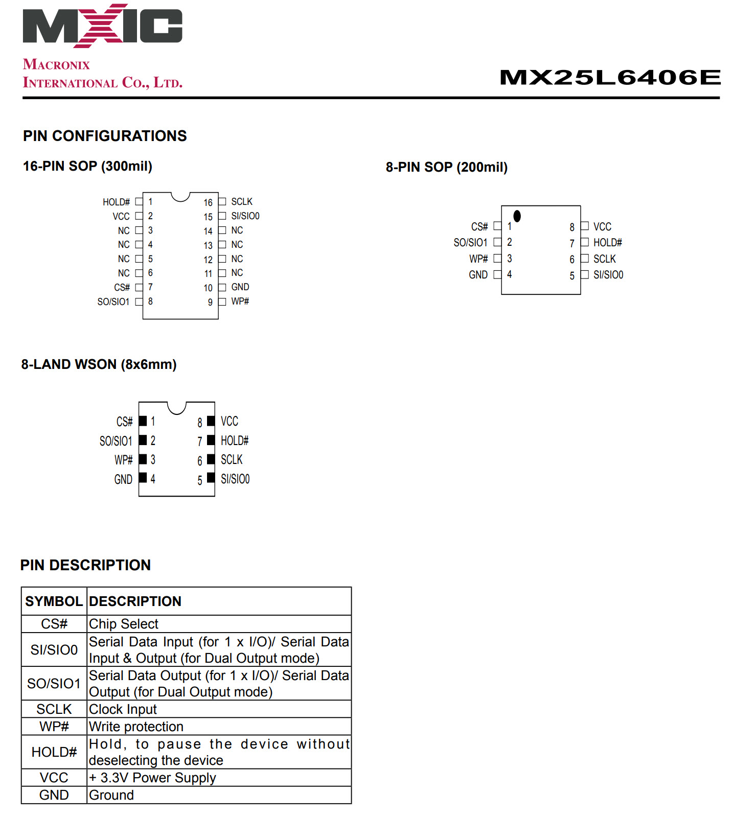

        What is the voltage to ground of pin #3 (WP#) on this IC?
        If it is a logic low = ~0 volts, then the memory IC is write-protected. You can hardwire this pin #3 to the Vcc (3v3) pin #8 to remove this hardware write-protect feature.
        That is, on the chip, directly wire pin #3 to pin #8 - do not feed pin #3 back to the programmer circuit.

          The Pin 3 is already hardwired on the programer itself with Pin 8 and Pin 7 too

            So WP# is always getting 3.3v

                  It was pulled from a board, previously was working but had EFI password

                    Just tried CH341A software but same result
                    I mainly use Neoprogrammer 2.1.0.19
