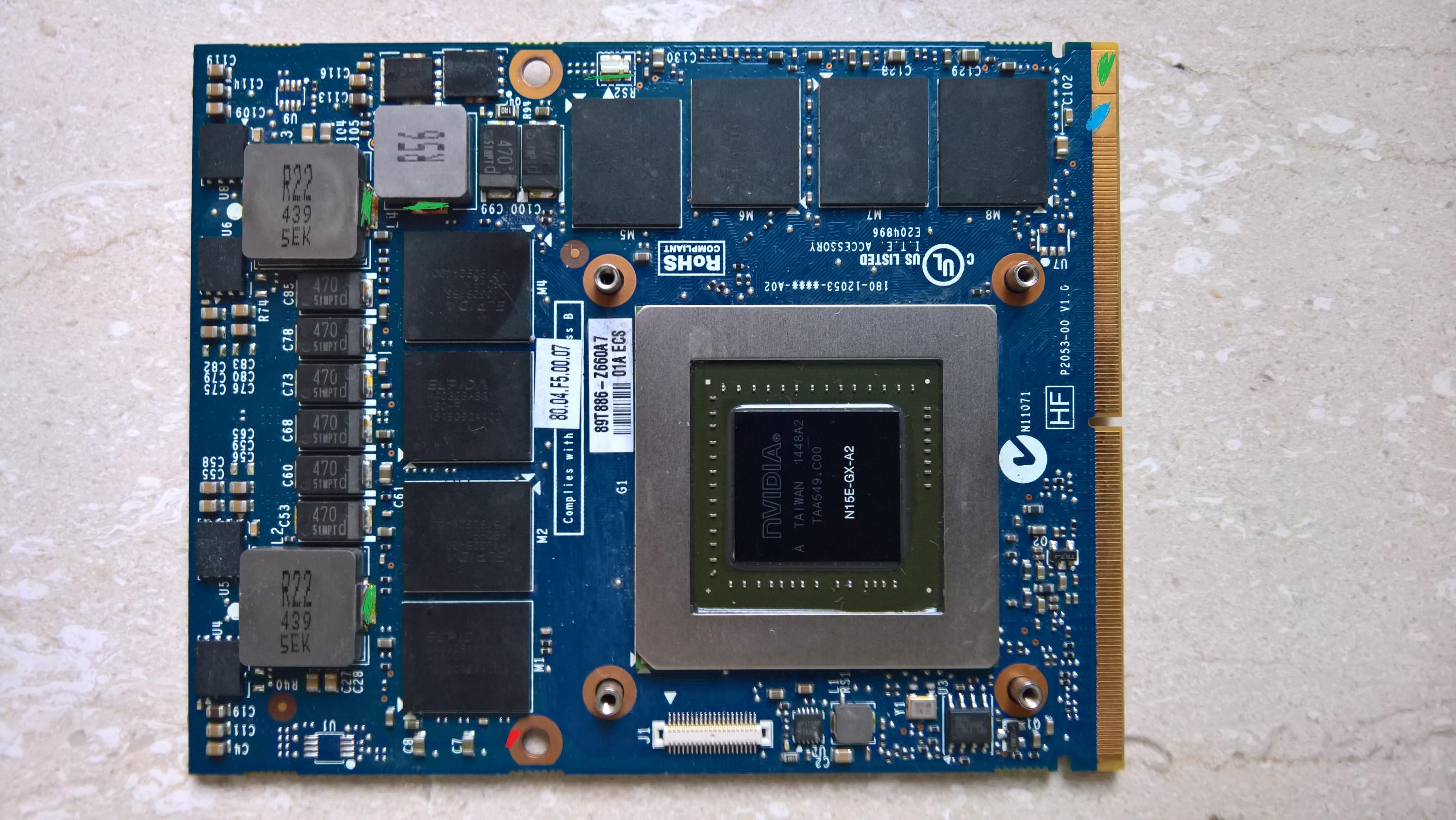

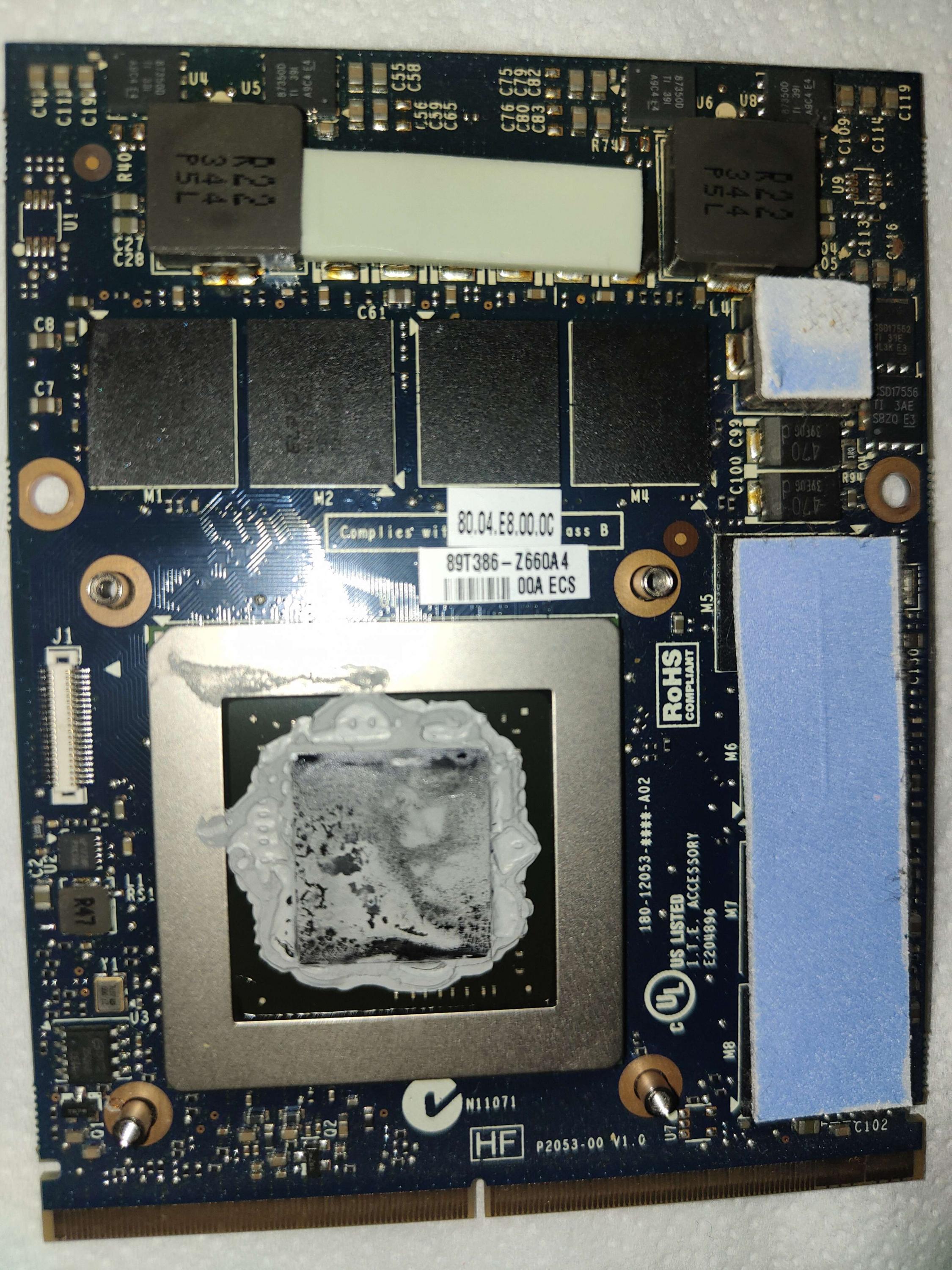

    I've taken a good look at the GPU and did not find any damage or burn marks.
    I'd like to take some measurements, but I only have experience with measuring electrics, not electronics, so I need some kind of visual guide for where to measure and what values to expect.
    I was unable to find any schematics for the GTX 880m.
    Some help would be greatly appreciated.
    I have a multimeter on hand, and I'll put pictures of the GPU in the attachments.

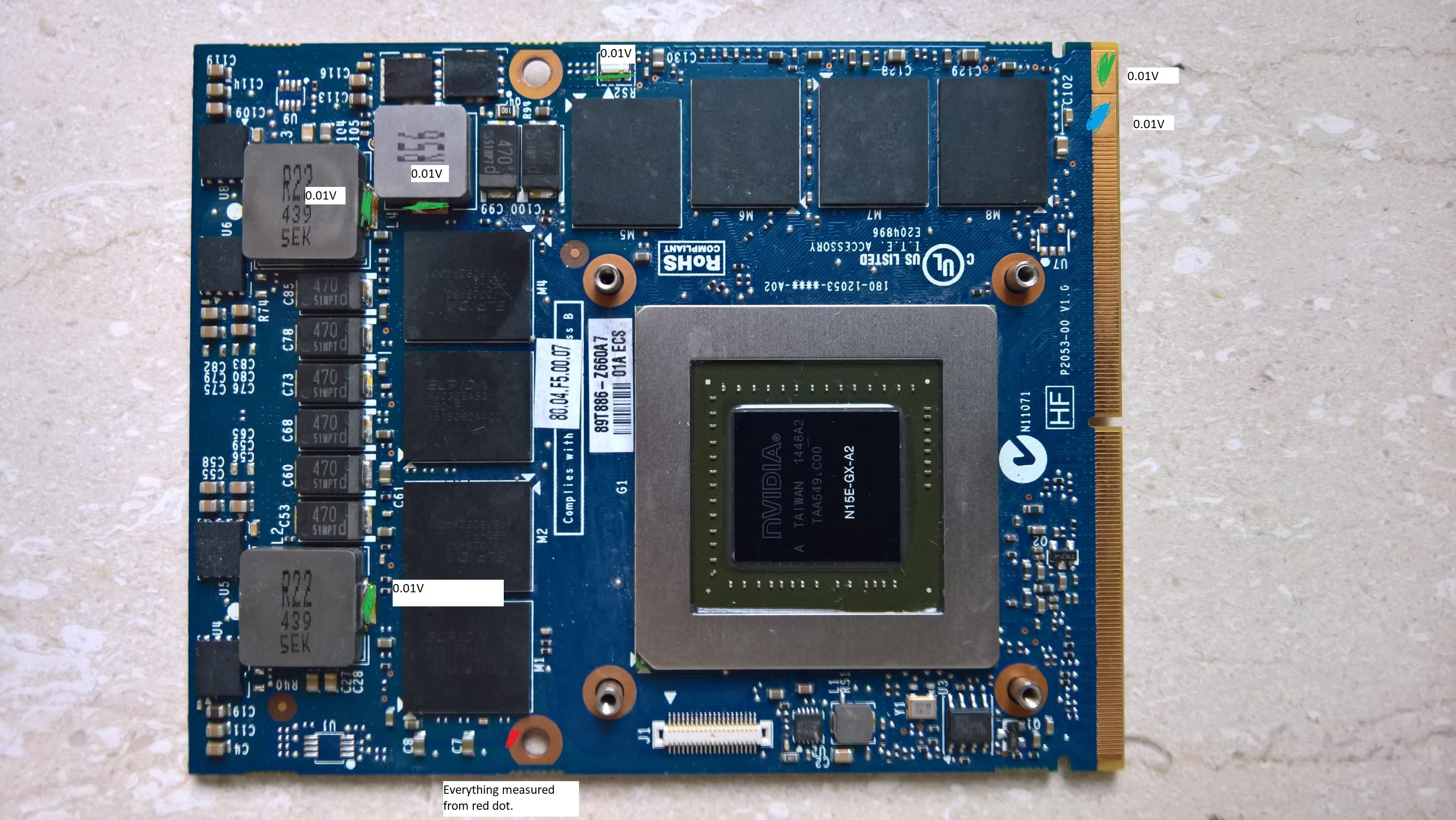

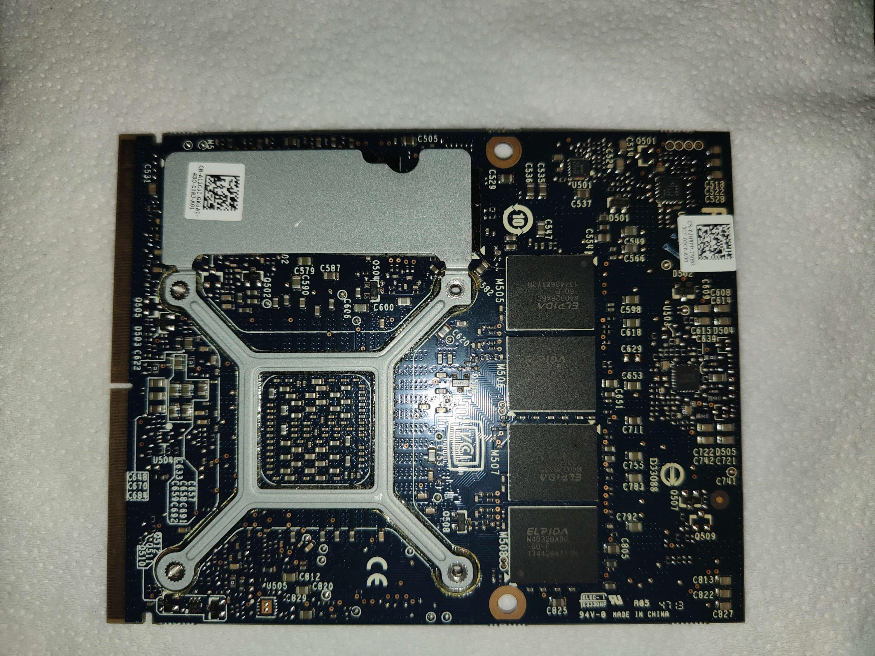

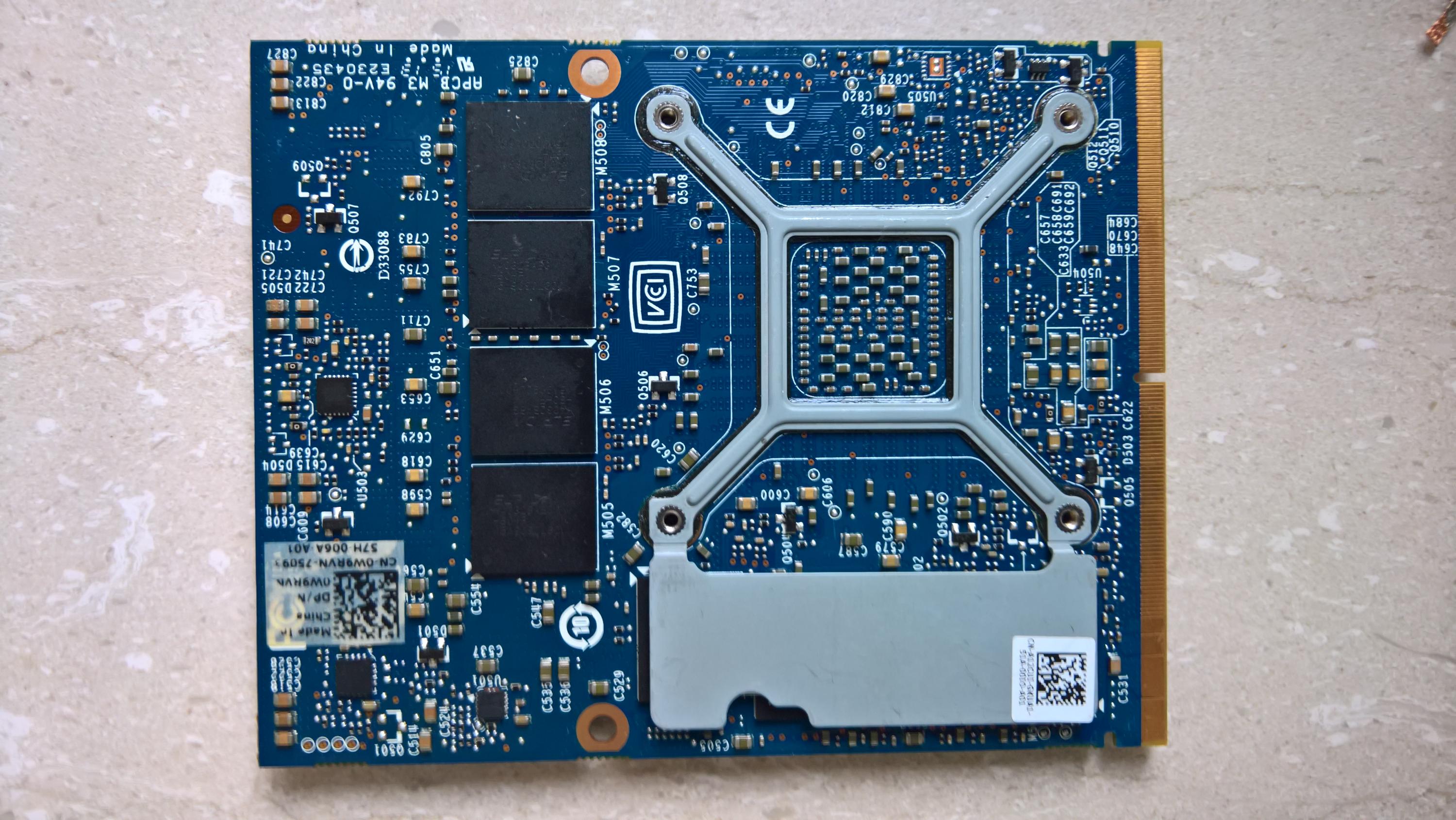

                          ive attached picture of one 880m i had in my old alienware. put multimeter in diode mode and red probe on rec spot. then one by one change the back probe to the 5 green spot and read value u have each spot. then measure also blue spot.
                          post results.
                          • GTAVC16
                            • Aug 2023
                            • 9
                            • Switzerland
                            Re: Alienware 18, Nvidia GTX 880m presumably shorted
                            Thanks for your help, dellxps15!
                            I've taken the measurements and everything comes up with 0.01V.
                            One of your pictures does not have any marking, is this on purpose or should I take some measurements from there, too?

                              edit checked on a vga i have here. blue spot is gnd, so it's normal to have 0,001.
