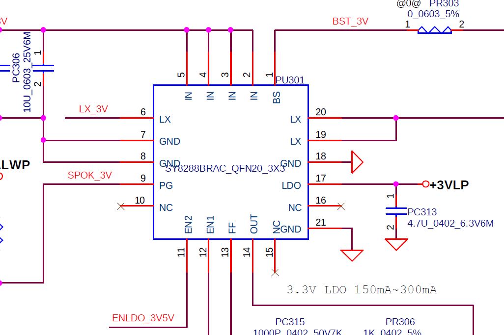

    can replace controller ic SY8288BRA with SY8288BAC?
    the original 3v controller ic from motherboard is SY8288BRA...I found replacement with code SY8288BAC, but i just get info from someone he said that BAC is only for 5v controller...is that right?

    can you post image of this chip
      this is the original from motherboard schematic

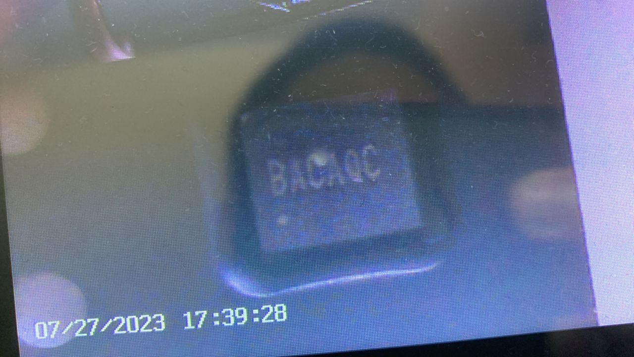

        Re: can replace controller ic SY8288BRA with SY8288BAC?
        and this is what i have....SY8288BAC....someone told me this ic only design for 5valwp...not for 3v
          It's NOT SY8288BAC but SY8288CRAC
          BACxxx=SY8288CRAC
          That "someone" is telling you the truth. You must buy SY8288BRAC

          • dqtech
            Badcaps
            • Jul 2018
            • 638
            • N/A
            BACxxx=SY8288CRAC
            noted. thank you sir

              The chip marking of the SY8288BRAC must be BABxxx.

                SY8286BRAC also designed for 3VALWP. pinout also same as per the datasheet. Have to checkout the pins before installation.

                  Silergy
                  SY8288CRAC (BAC)=SY8288CRAC, SY8288C, BAC7GC, BAC7LN, BAC5KA, BAC6GB, BACXXX.BAC7LN BAC5CU BAC6DC Silergy integrated circuits starting with BAC are SY8288CRAC and are compatible with each other.
                  ​SY8288BRAC (BAB)=SY8288BRAC, SY8288B, SY8288, BAB5ZA, BAB5ZD.BABXX Silergy integrated circuits starting with BAB are SY8288BRAC and are compatible with each other.
