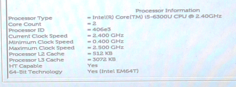

    Hi, a once-good board has suddenly developed a fault where it runs slow - I mean REALLY REALLY SLOW. With no peripherals attached (including no SSD/HDD), the bios screens can actually be seen redrawing/refreshing themselves and it takes 30 mins+ to boot an o/s off a USB stick. All the PS coil voltages are normal and everything on the board looks fine (and works fine). I have a couple of good working boards for comparison but can't find any difference between the 2.
    The problem is definitely not the bios.
    I've changed 2 of the crystals to no avail.
    What could it be?

                  • pingaroon
                    • Nov 2019
                    • 121
                    • uk
                    Re: Excruciatingly slow bios Dell E5570 LA-C641P
                    Interestingly, the bios is saying the cpu is running normally at 2.40 GHz, but it's still so slow, so could the cpu be toast?
