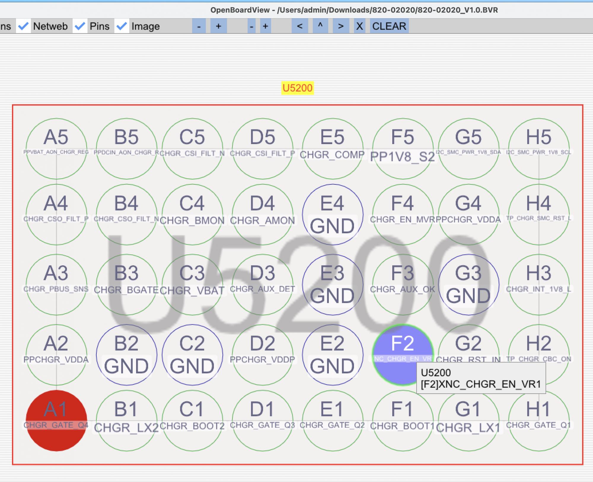

    820-02020-A missing pad on U5200
    Anyone knows where this pad (XNC_CHGR_EN_VR1) goes? I can't seem to find it in the board view.
    Thank you
  • ugamazing
    • Jun 2013
    • 169
    • usa
    Re: 820-02020-A missing pad on U5200
    It's not connected to anything ("NC"=not connected), no need to worry about it. Those come off a lot when replacing BGA chips.
