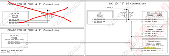

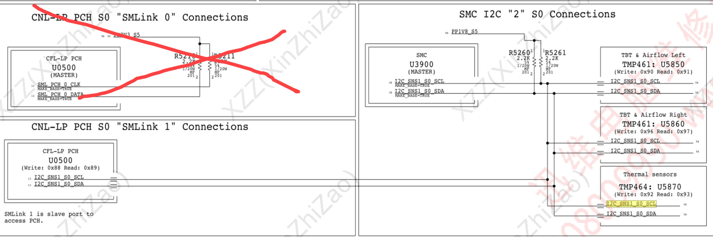

                          To me it sounds lower than the norm. Someone is pulling these lines down. Not sure if it impacts the raised fault but the default parked voltage should be 1v8. Sure - disconnect what you can and attempt to test this line again.
                          There appears to be only thermal sensors on this dedicated SMBUS network.

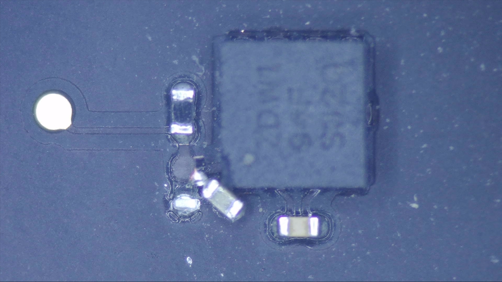

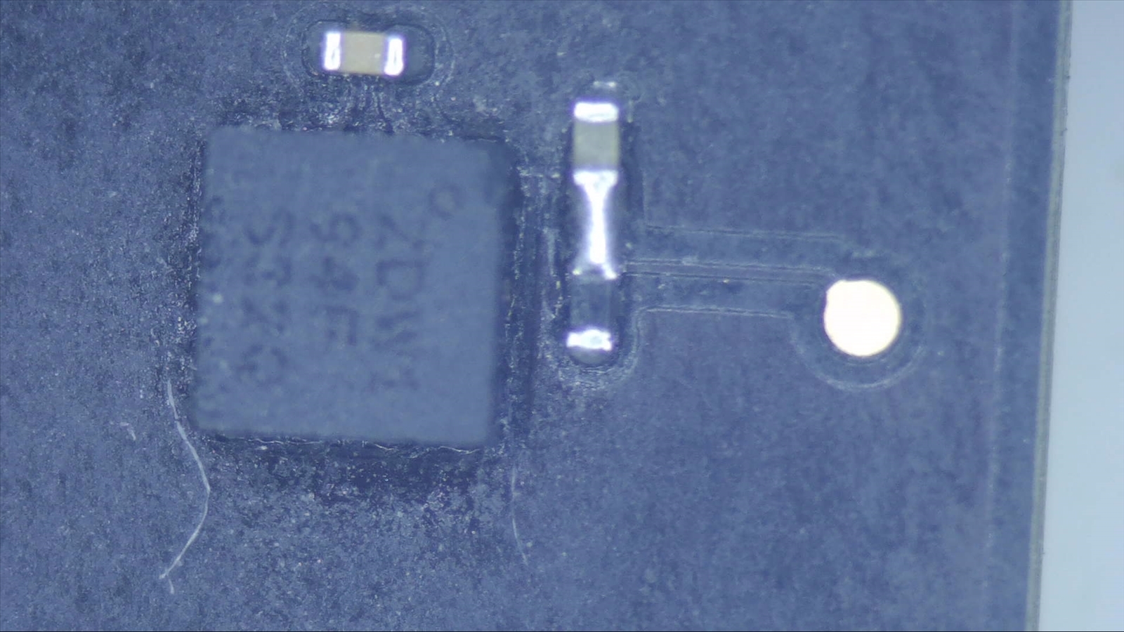

                            Hi, I double check it, 1v6 voltage there on both lines, everything disconnected from the board.
                            Diode mode reading.
                            I2C_SNS1_S0_SCL ; 0,4v
                            I2C_SNS1_S0_SDA ; 0,4v
                            Edit: I probably found culprit. C5850 area damaged
                            • hopkok
                              • Oct 2014
                              • 185
                              • Slovakia
                              #34
                              Its solved my friend. You helped me a lot. Thank you.
