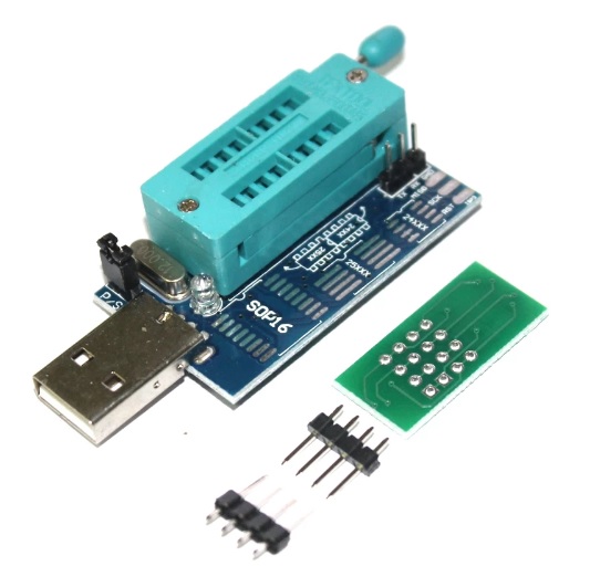

                                I'm curious to reflash SOC ROM. But don't know if there is any ROM i can download to replace old one.
                                and also i have only EEPROM programmer something like this if it will work also ...

                                  Hello,you may need U-BOS2 to flash bios .

                                    is it not possible to do it some DIY way ? as don't need such expensive tool for 1 usage only

                                      OK i was able to flash bios on original SOC ROM IC using my EEPROM programmer i have to be little bit creative and solder some small wires ... I've used AsProgrammer. I've tried 2 bios files that i've found online but i'm still getting error on line 500 or 600 ... but anyway i've tried to put the IC back and still exactly the same problem. I'm able to put macbook to DFU but when i try REVIVE or RESTORE i'm ending at Installing System (the bar goes under S (System) it's approx 50% and it stays there for few minutes and the i got only Padlock ...
