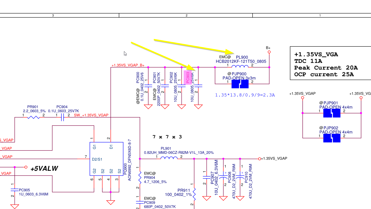

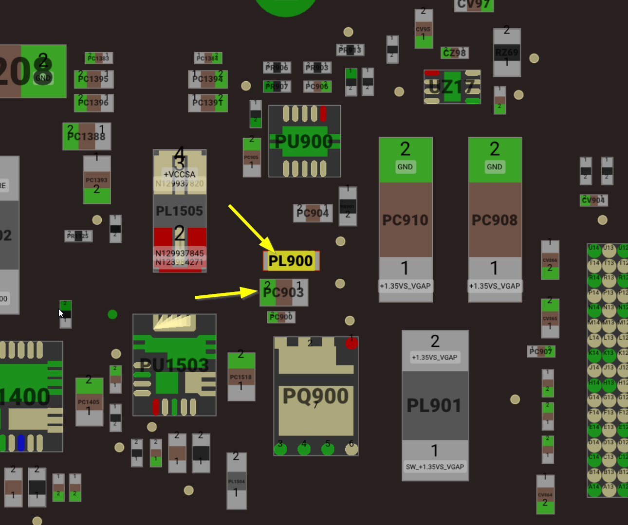

    I've got a LA-D993P with an exploded PL900(see attachments). I also want to replace the cap next to it, PC903. The schematics show the specs for the components which I'm sure I could find on mouser, alie-express, etc, but I was hoping to fix this board right now. I've got hundreds of laptop motherboards and I was wondering how you all go about finding replacement components from other(not same board) boards?

    I pull what I need from sample books, if i didn't have those then I'd locate a boardview/schematic of one of my donors and then look for the suitable value I required.
