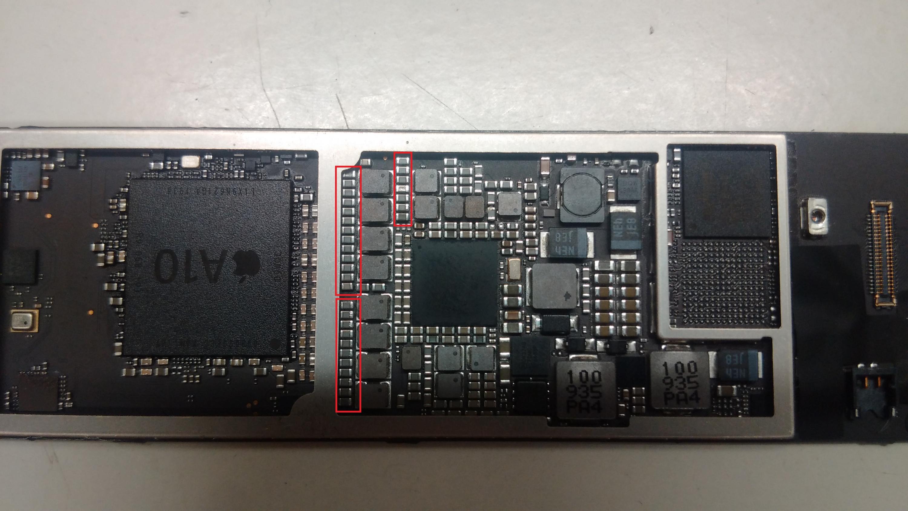

            • mon2
              • Dec 2019
              • 14657
              Re: iPad 7 A2197 dead
              Now locate these caps in the boardview file.
              Then again in the schematic.
              Then we will know to which power rail these parts are linked. Then we can determine if the low resistance is normal or not. Once at this stage, it may be worthwhile to inject a low voltage to determine who heats up.
              Alex's video mentions anything in the ~400-450mA is a short... regardless of the model.

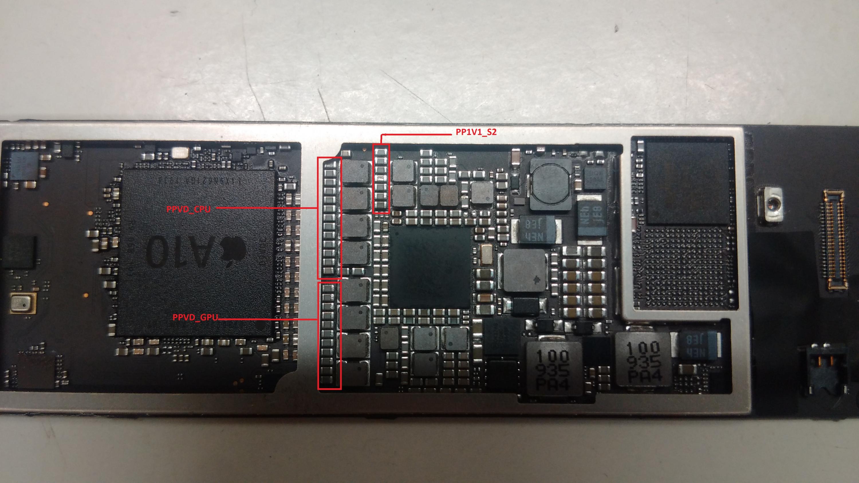

                Re: iPad 7 A2197 - no power
                • mon2
                  • Dec 2019
                  • 14657
                  Skip this batch of parts - each is linked to a low voltage rail and respectively, is expected to be a low resistance rail.
                  Continue your hunt. Best to use resistance mode checks - not diode mode to locate the defective cluster of parts. That is, for example, a 100 ohm resistance will not tone beep in diode mode but yet is considered a short if it is this low of a value on a 3v3 rail.
                  For this reason, measure the true resistance to ground of each cap on the board.
