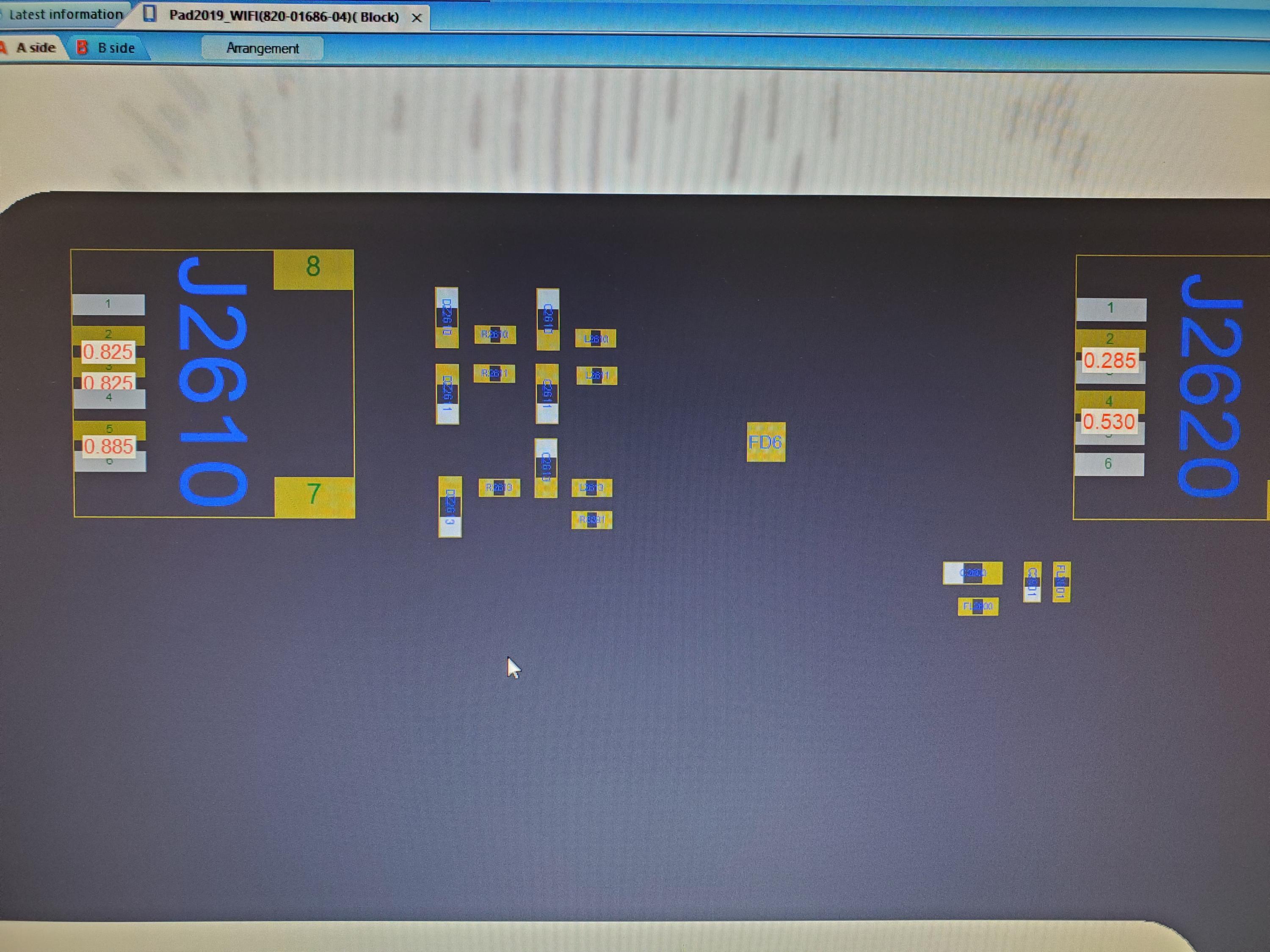

    A2197 / Ipad 7th Gen / 2019 - No Power / Low Current Draw

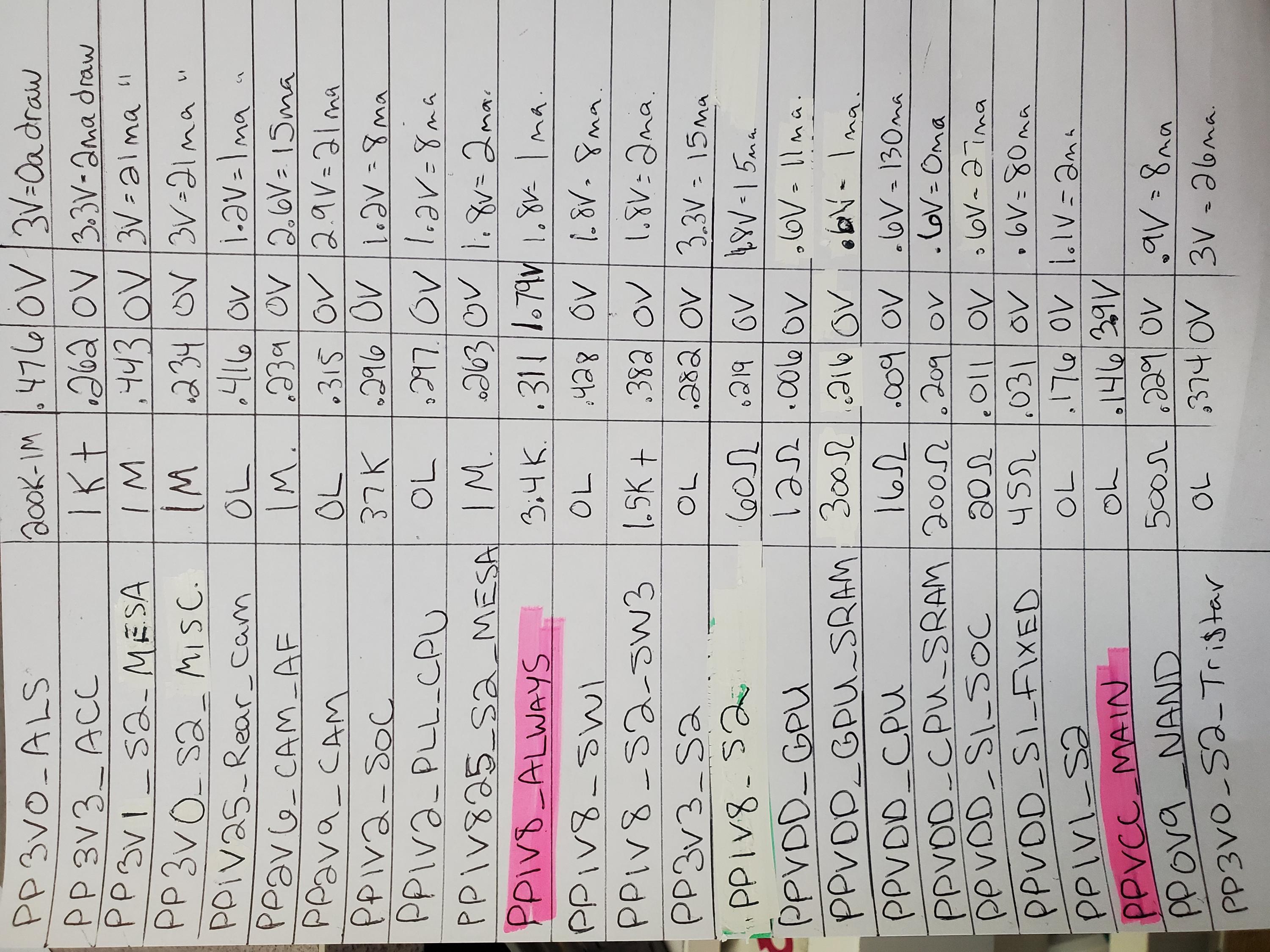

    Ive been working on this ipad for a little while now. CPU reballing is a common issue needed on this model.
    I wanted to try and verify there is not a PMIC Problem before reballing the CPU.
    Powering 4.2V at the battery gives a 0-1ma Draw
    Pressing the power button it jumps to 18+ma and settle at 15ma
    Ive attached my Readings for many of the power rails.

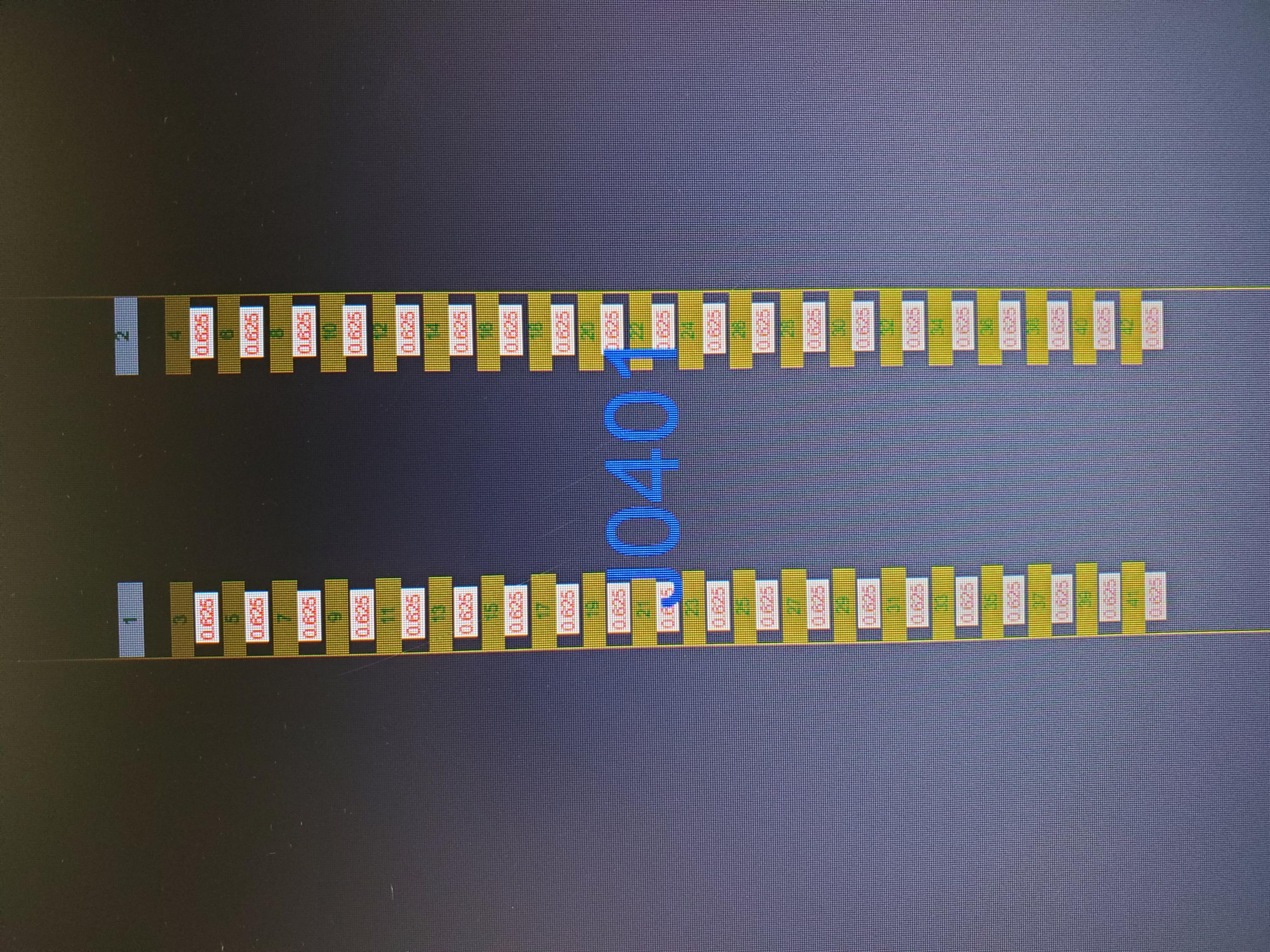

    THis is how the columns are layed out:
    Ohms/ Diode / Voltage After power button Press / Injecting Voltage Reading

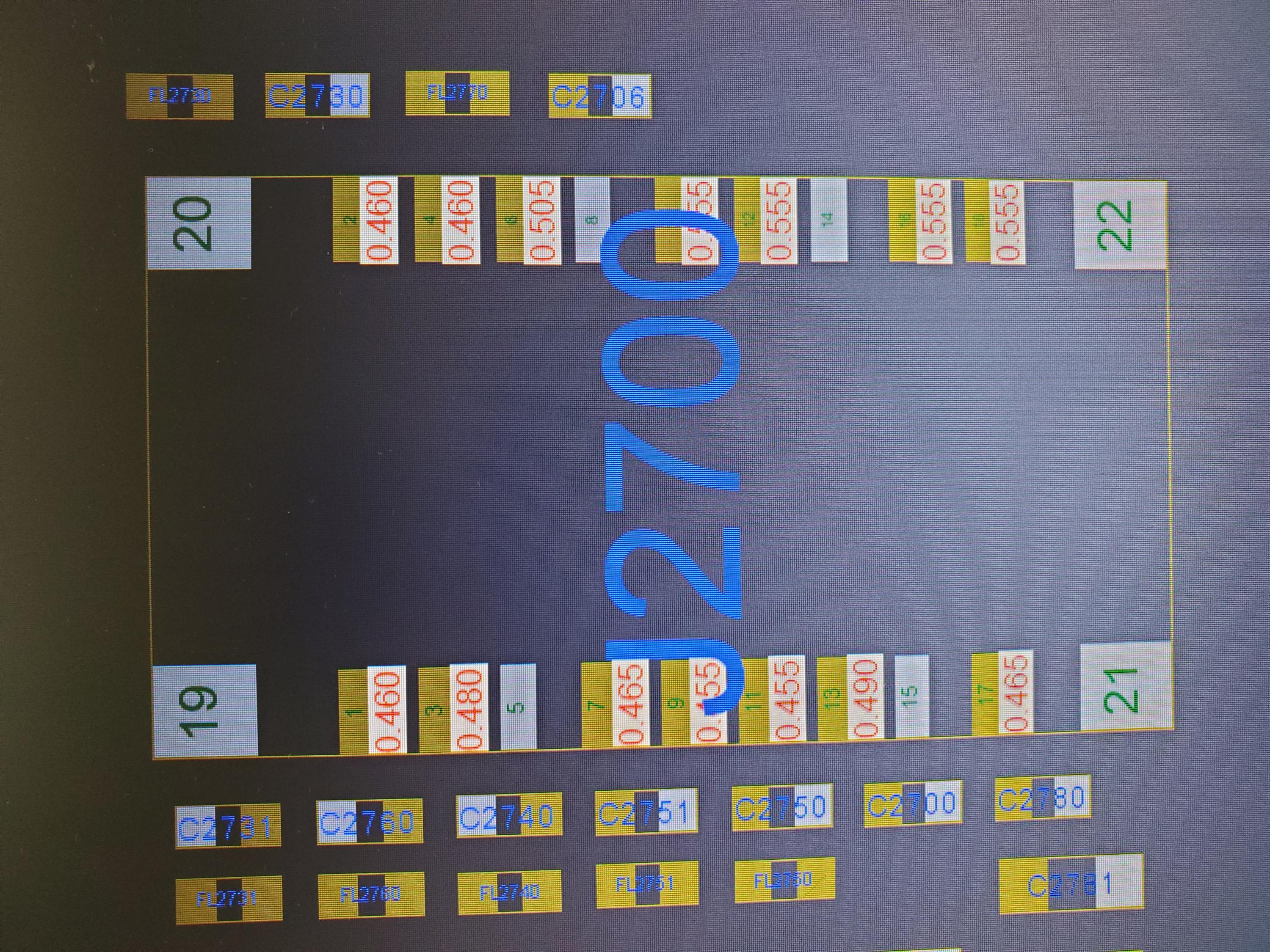

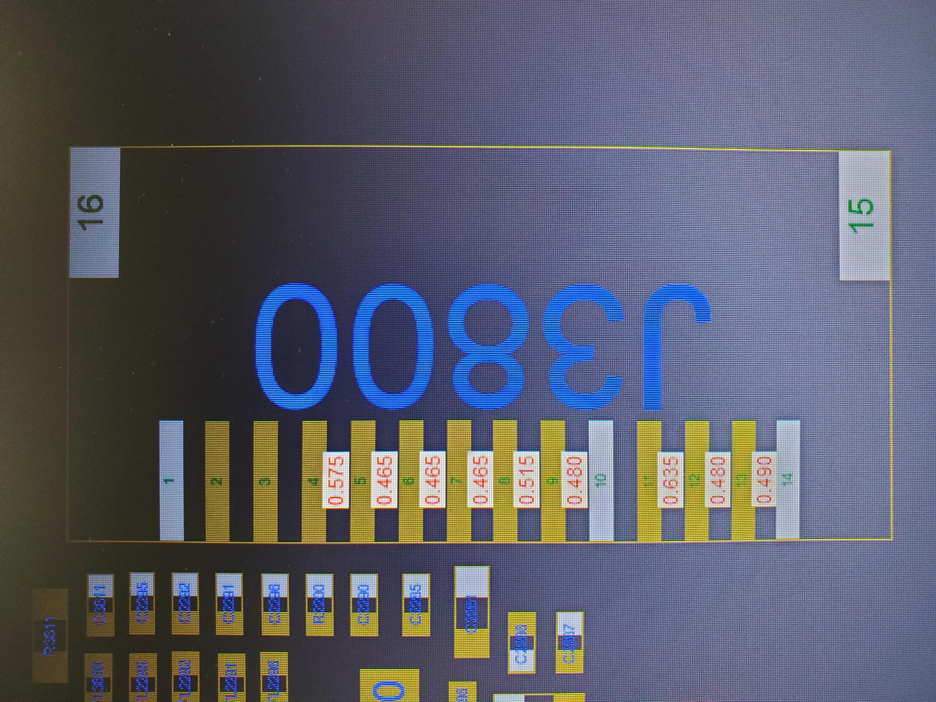

    In the second attachment there are some odd reading on vss Sense lines. They only come out the bottom of the CPU to a test point under the board. They read short on ohm meter, dioded and voltage injection..
    What ive Figured out now it that if i warm up the CPU/CPU Area, the current draw goes from 15ma up to 50ma and if i freeze the area i get like 11ma
    This makes me think more to do a CPU Reball, but i am still new with Ipads
    Can anyone chime in on this?

    Re: A2197 / Ipad 7th Gen / 2019 - No Power / Low Current Draw
    Here is my Attahment Upright :$

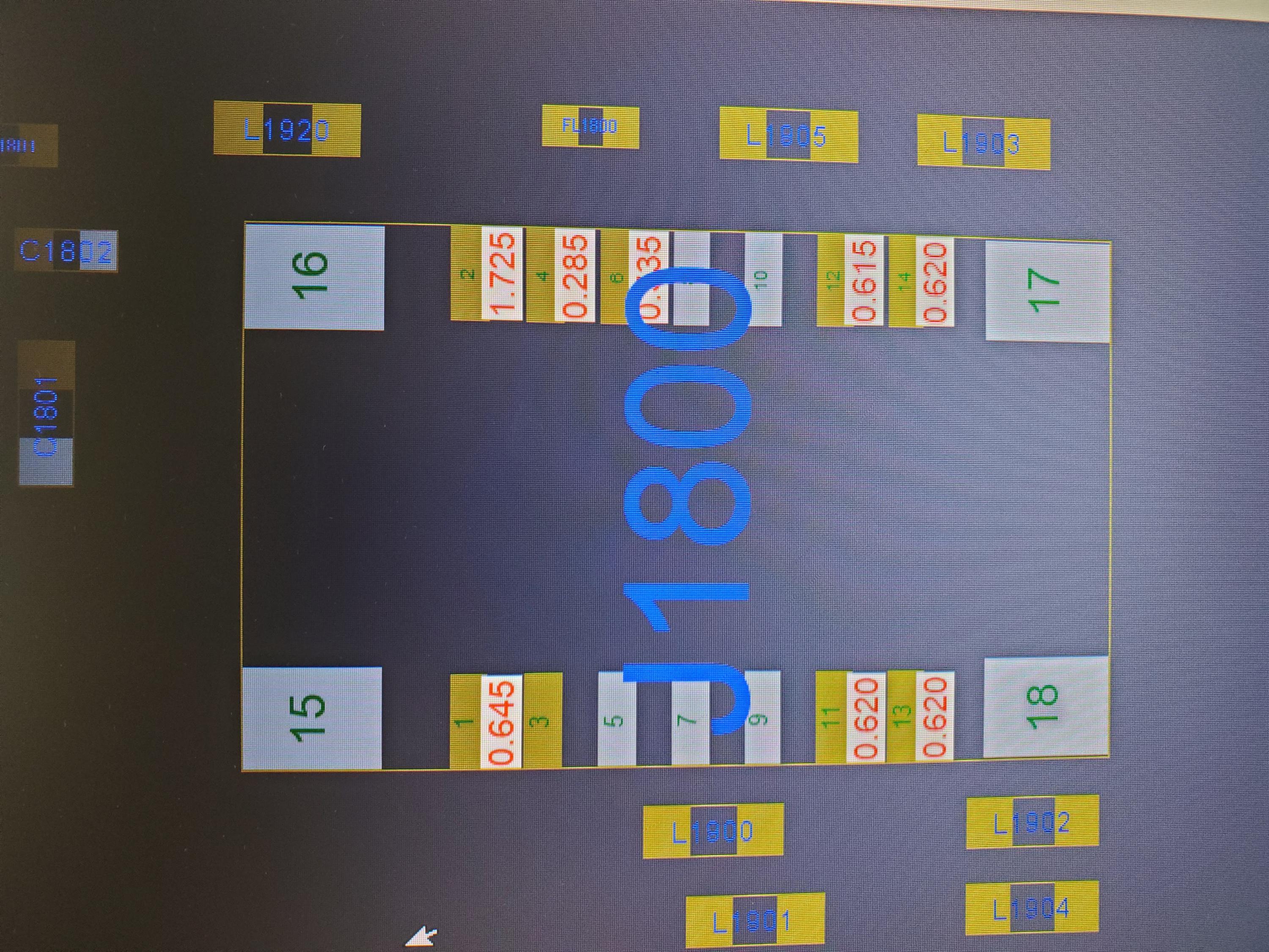

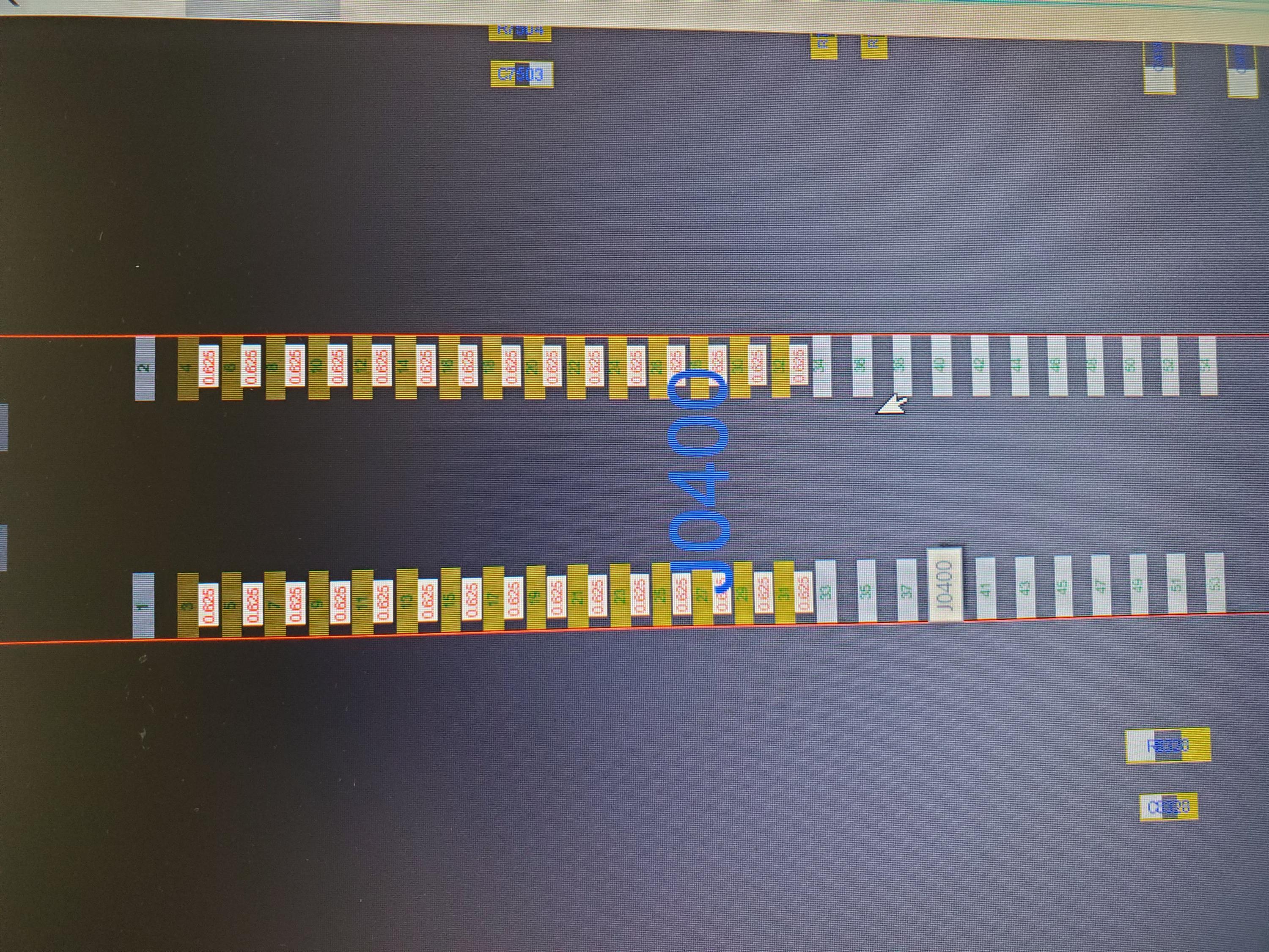

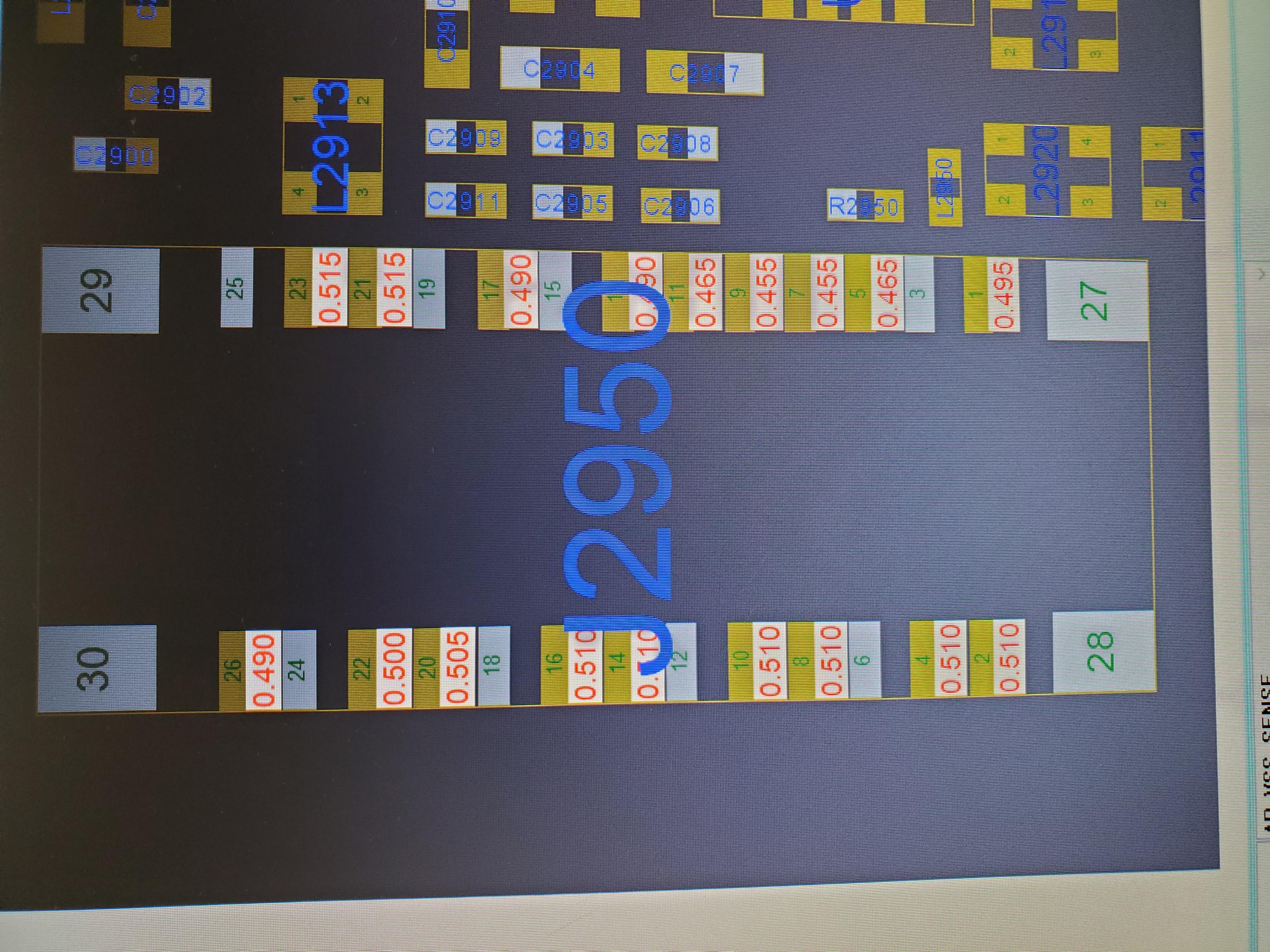

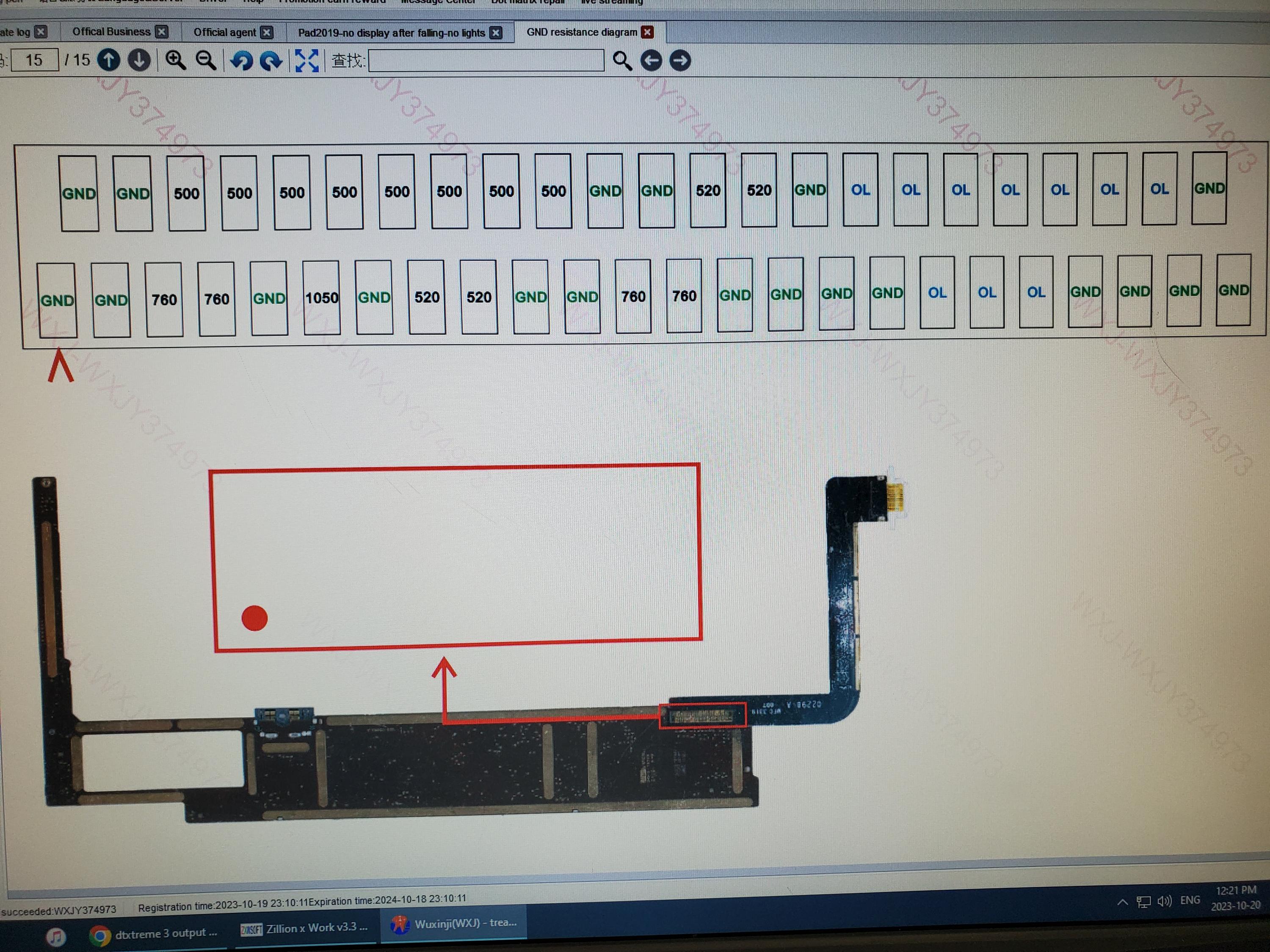

      I just found out there is a program called "Wuxijin" Seems way more resourcefull than ZXW and seems to way more diode readings. I might buy it today and see if there is more info on this tablet.
      "WUXINJI VS ZXW Schematics Full Review 15 big difference"
      https://youtu.be/vnA2LlEtjNo?si=Ws8nkTtx6RHsfQGH

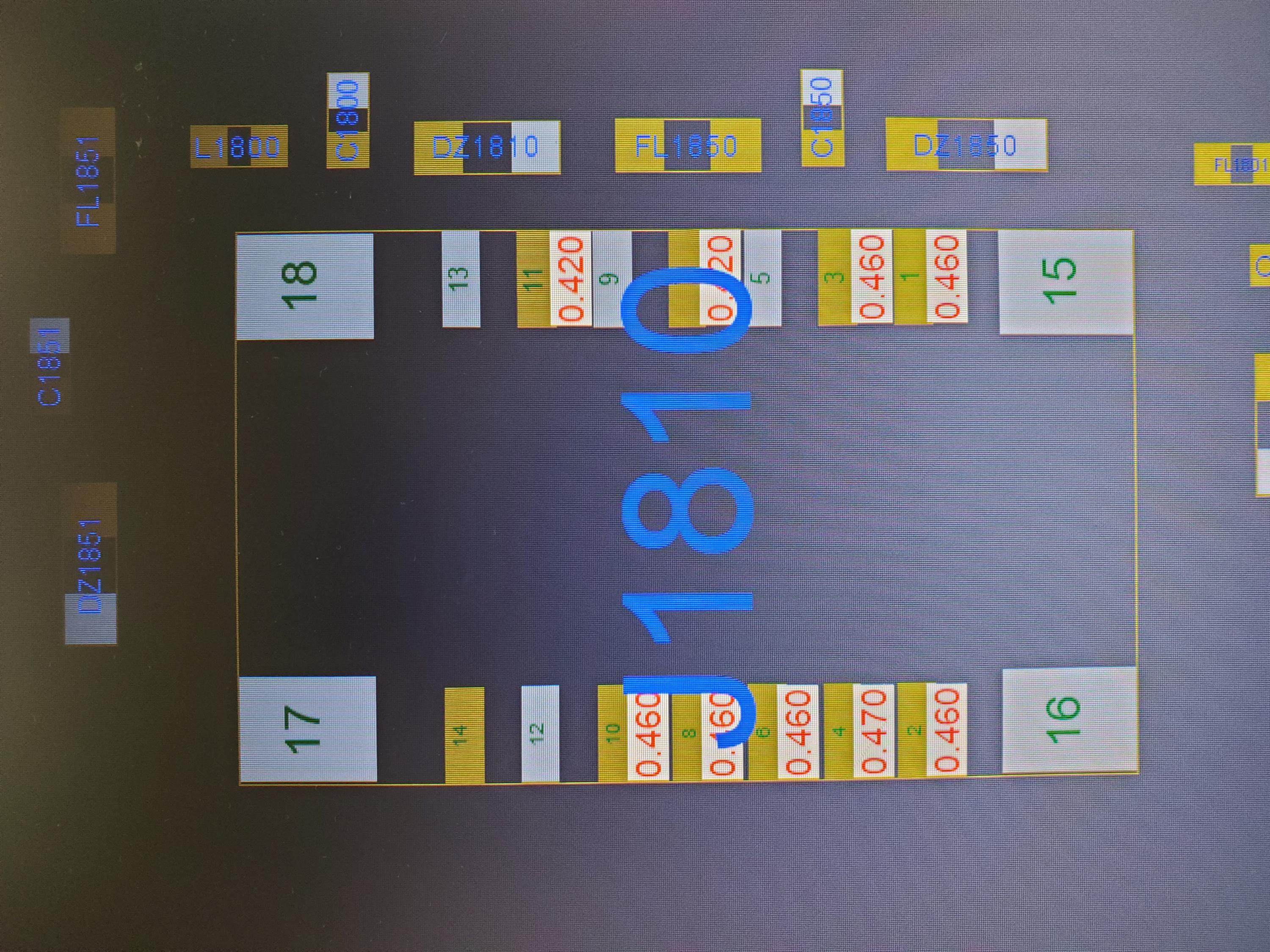

      All of my Diode Reading in ZXW check out. Except ZXW is missing a few things like the charge port flex.
      Ive attached the Diode Readings from ZXW. The only diode readings i get wrong are the two that have readings over 1V. I think i am doing something wrong here or my meter is weird, I know sometimes you need to swap the polarity of the probes for certain readings.

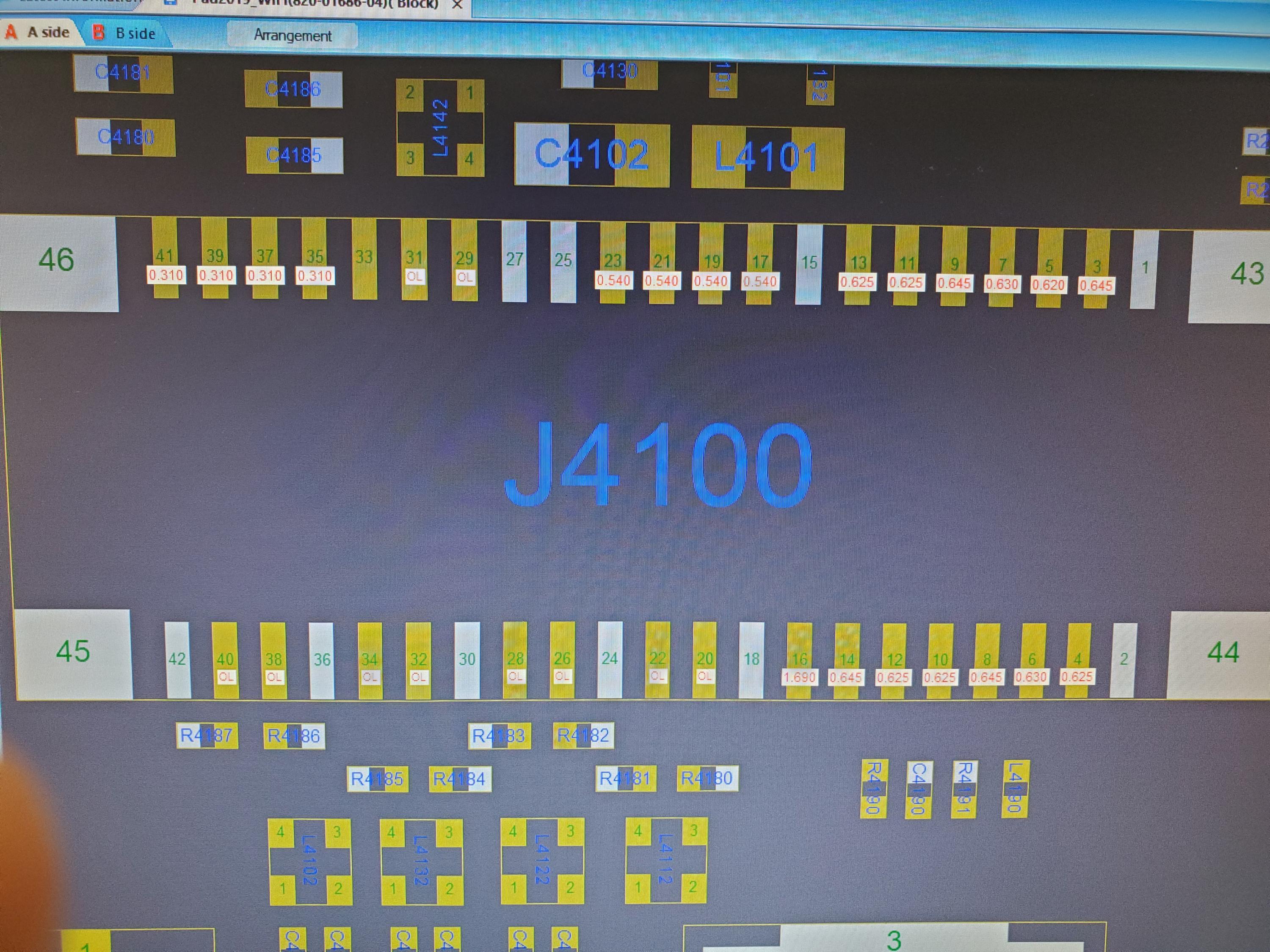

        I've purchased Wuxijin now. here are the diode readings for the Charge port flex
        • willis6732
          • Feb 2023
          • 41

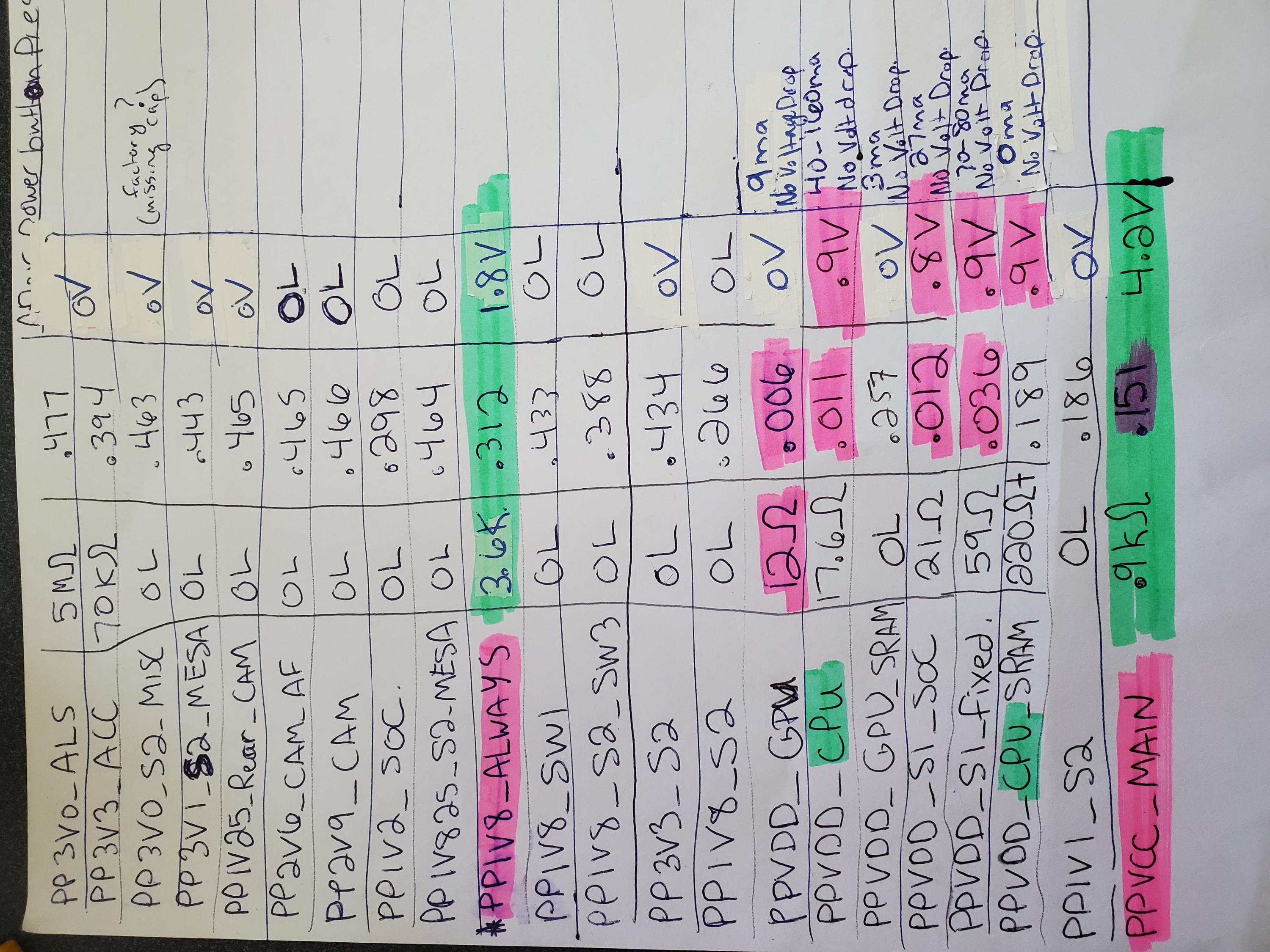

          Awww, I realized the ZXW board is different then the one in the component placement pdf for the ipad 7
          PDF's HEre post #4
          https://www.badcaps.net/forum/showth...ighlight=a2197
          So i redid all my readings from the first post.. Now I only get 1.8always and main, no other voltages... No luck yet...
