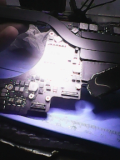

    Re: Macbook A1989 - 820-00850-A Won't turn on - stuck at 5V/5mA
    There is nothing. It looks like C7883 is burned.
    • mon2
      • Dec 2019
      • 13836
      #42
      Remove this capacitor. Test again without this component.

        #43
        Now the U7800 is not hot anymore. Still 20V / 0.4A. Should I put the PCB back and test it again?

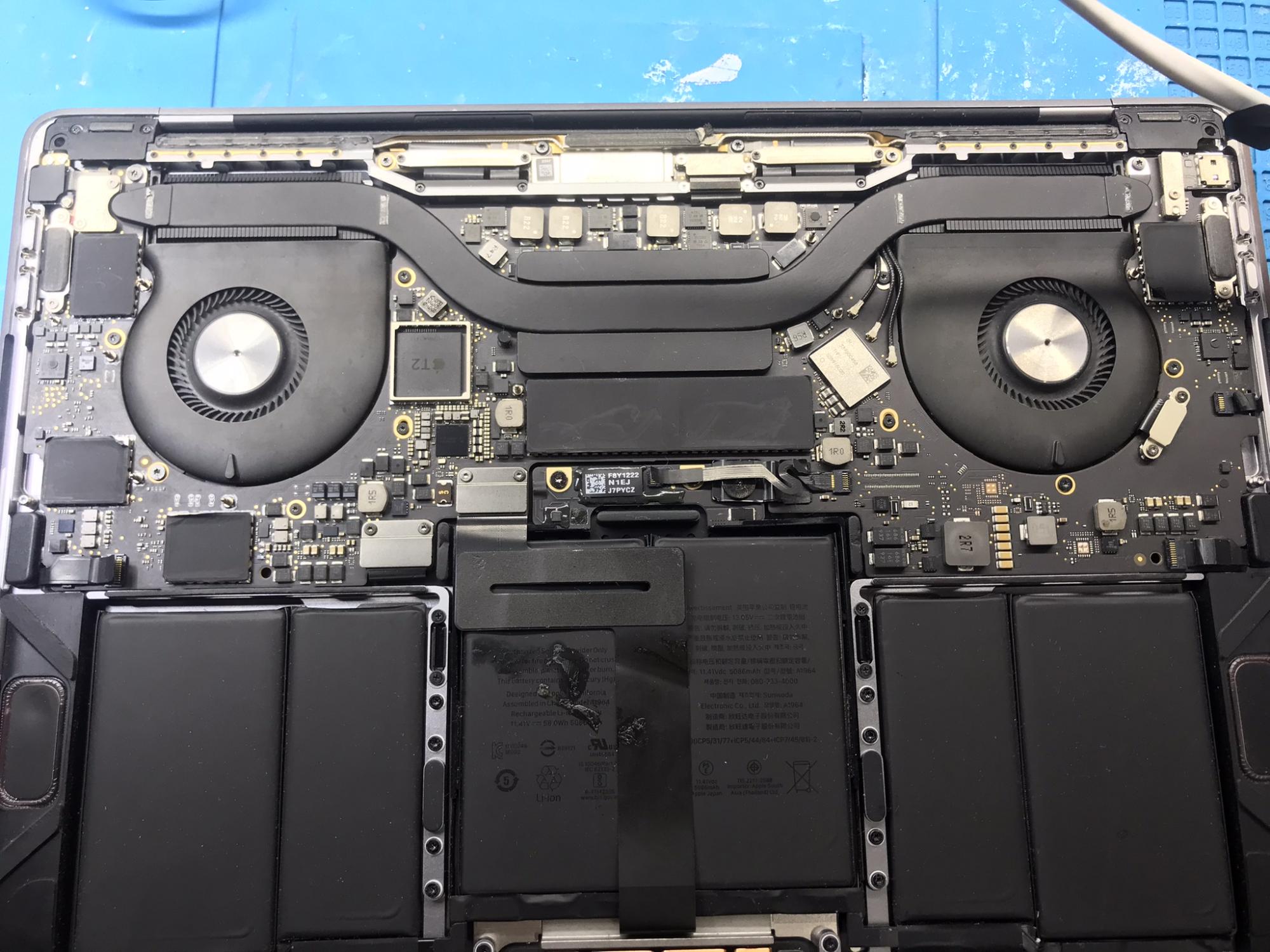

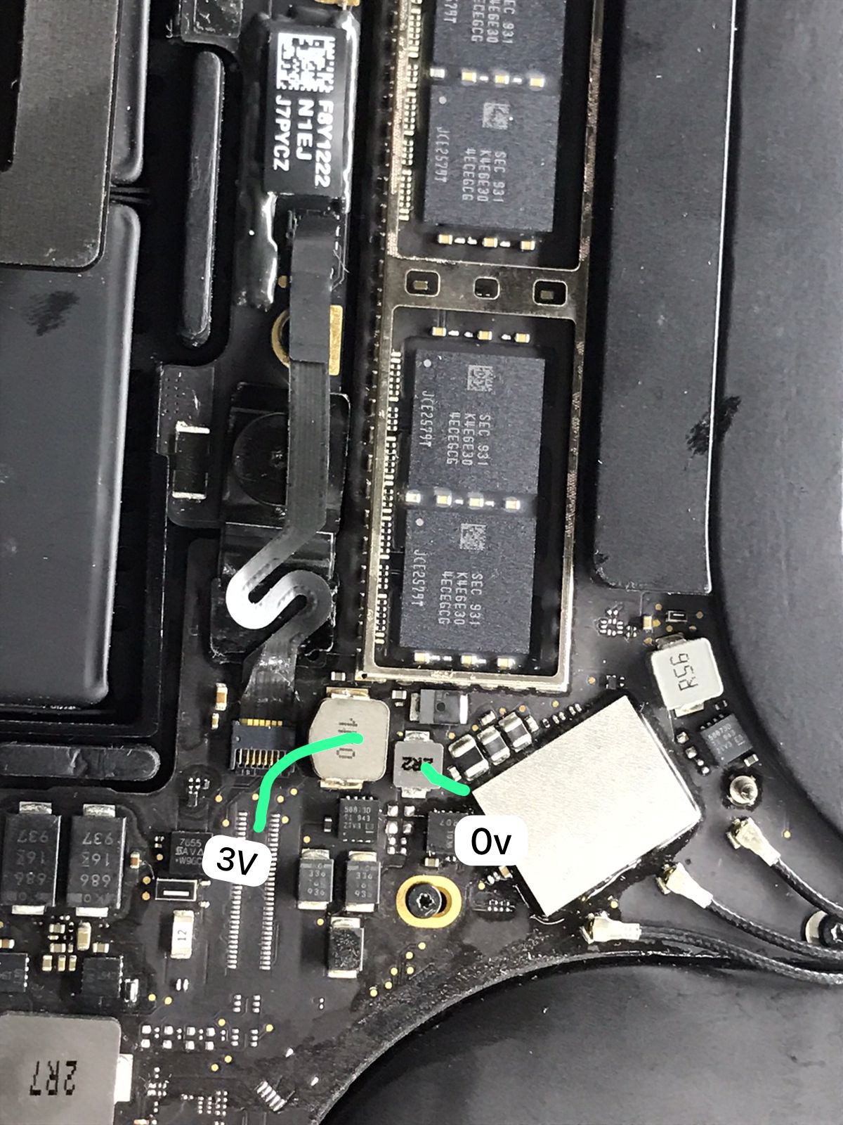

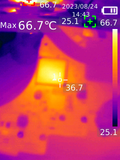

                #47
                MacBook PRO A1989 won't turn on
                Hello everyone at badcaps,
                Today, I have a MacBook Pro A1989 on my workbench that is not powering on. While conducting some tests, I noticed that as soon as I connect the charger, I observed using a thermal camera that the T2 chip begins to heat up, reaching temperatures between 33 and 32 degrees Celsius. I've only measured the input voltages of 12V and 3V at the coil "L7660," but the expected 5V voltage at "L7600" is not present.
                I don't have much experience with this type of equipment; my repairs are mostly focused on common laptops like HP, Samsung, etc. This is why I suspect I might be measuring incorrectly.
                However, I would appreciate learning at least the basic measurements to see if I can fix this MacBook. Thank you in advance.
