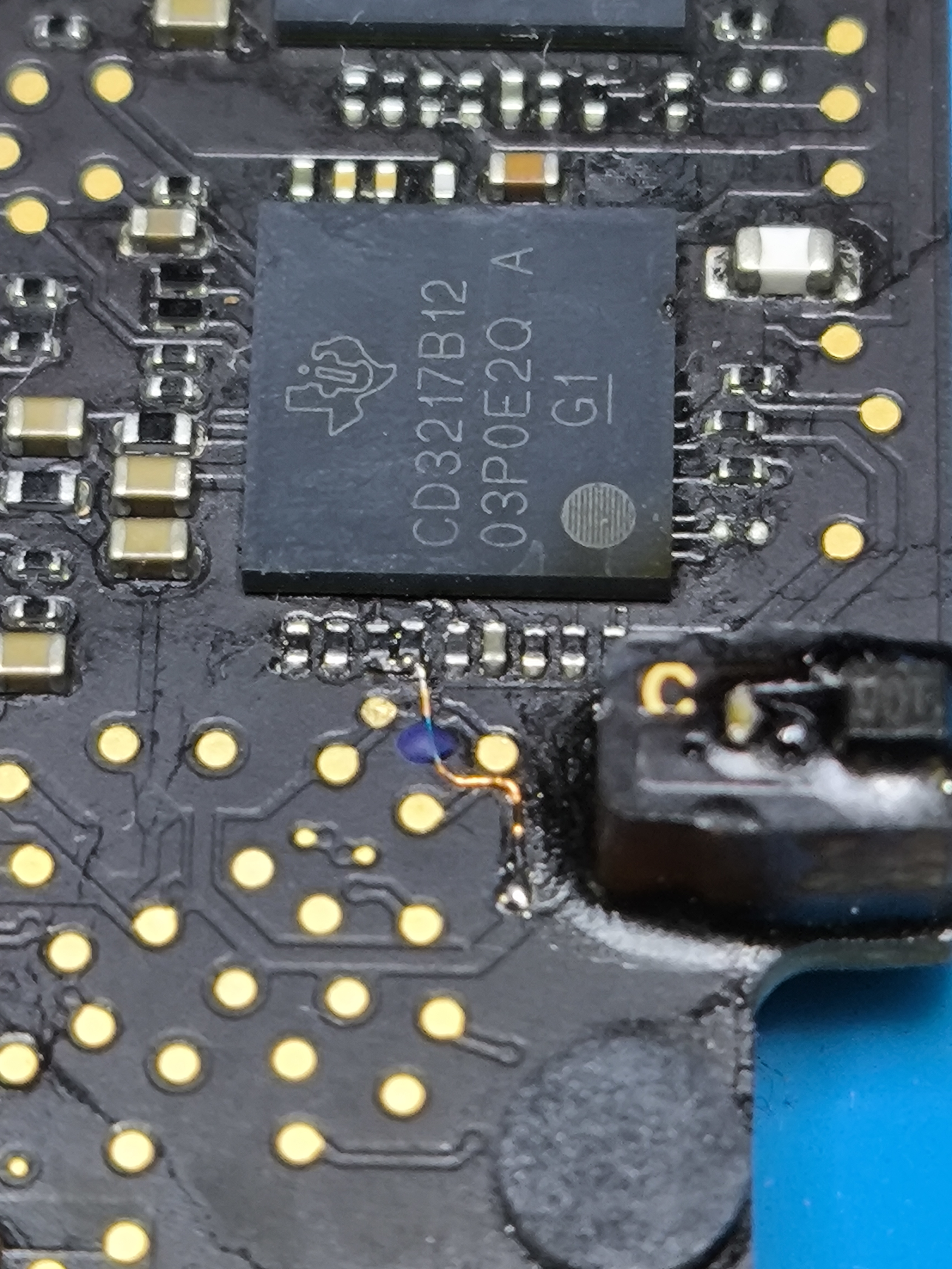

    Update: upon closer inspection, I can see some gunk around U3100 and some of the capacitors around it (e.g. C3108 and C3100).
    I am wondering:
    • Given that all the voltages still measure normal for that port albeit stuck at 5V, is there hope that some rework would clear the issue?
    • If I need to replace U3100, this chip and all 3 others on my board are CD3215C00Z (9AC1JZW); I have different MacBook Pro board (820-01041-A) that has CD3215C00 (87CLGFW), could I only swap one of the chips or would I need to replace all four CD3215 so that they are all the same model on a given board?
    Thanks in advance!

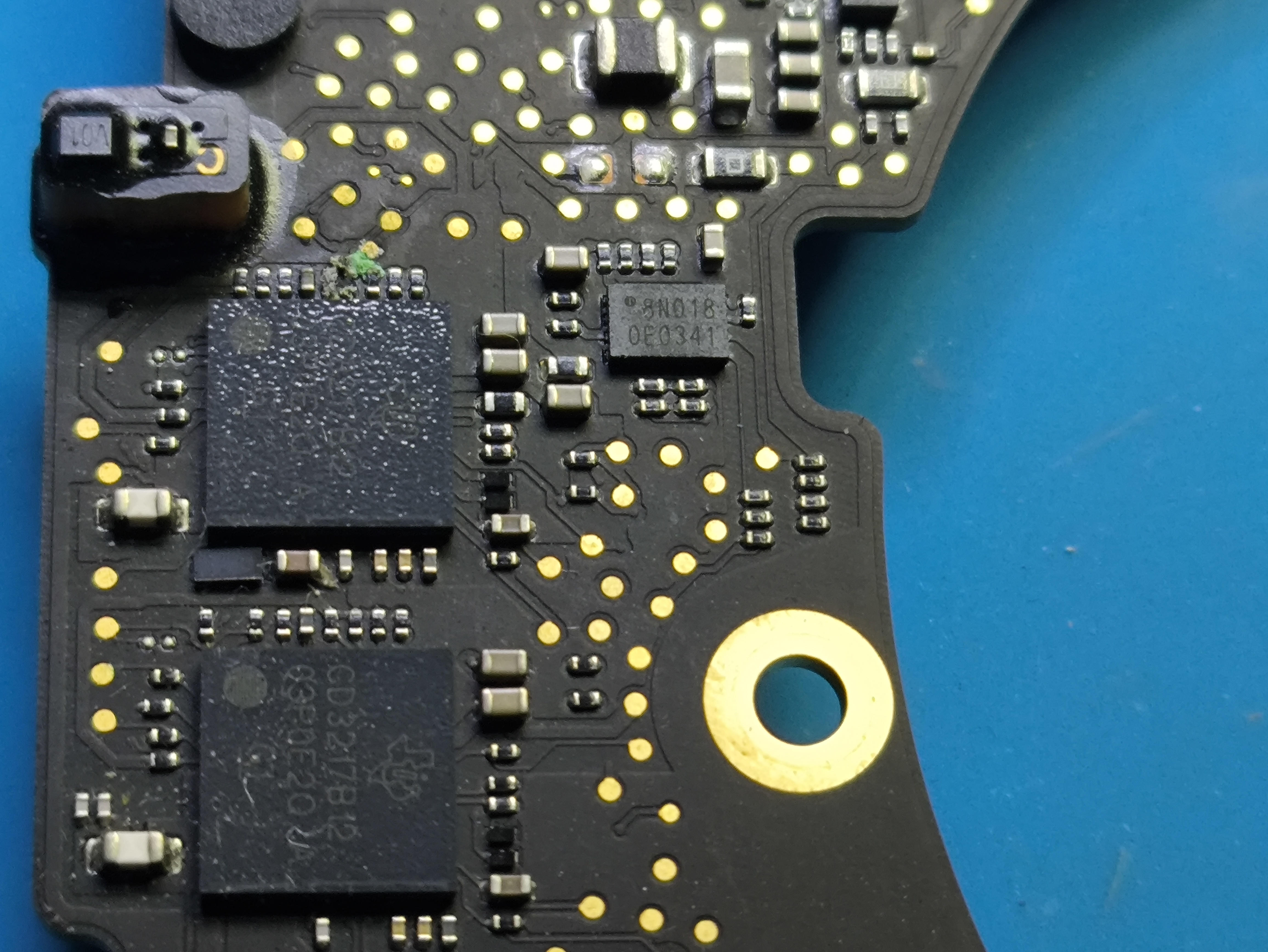

      Start with pouring IPA (pharmacy grade alcohol) onto this area. Then wipe all of this crud off with a Q-tip / cotton swabs to remove the corrosion. Then test again.
      • ErinV
        • Sep 2024
        • 10
        Thanks! I've attached pictures after cleaning.

          Good job on the cleaning. Check the voltage to ground of ppbus_g3h again. It is not being boosted.
          To boost, the smbus lines are required. Carefully measure the voltage to ground on each pin on the battery connector. Interest is on the smbus lines (SCL / SDA) to check if either line is being shunted to ground.

                            You can't simply clean around these components on U3100, they have to be removed and replaced, and pads inspected. 99% on MAC boards and I have corrosion on the component, the pad is corroded underneath.
                            I did have a very similar issue on an A2251 (820-01949), still a T2 machine which uses CD3217. This machine was dead, 5V @ 250ma on all ports. So a quick board examination showed corrosion near U3100_X, I'll attach photo's if it will help. Components affected were R3108, R3109 and R3032. Resistors R3108/R3109 are for a pullup for I2C_UPC_X_SDAM and I2C_UPC_X_SCLM to PP3V3_UPC_X_LDO. The pads for PP3V3_UPC_X_LDO were gone, and I needed to run a jumper to a nearby test pad. R3032 grounds UPC_X_RESET but I don't think this was the cause.
                            Note that until I fixed the above problem, the T2 wouldn't fully boot due to that CD3217 not communicating properly due to the missing pullups. If the T2 doesn't complete it's boot, you don't get any further in the power sequence and you certainly don't get 20V. So a rather seemingly minor fault with a pullup can kill an entire machine!! Your case might very well be the same.
                            In your case, I'd be removing C3100, C3108 and C3106, and cleaning up the pads. Check for continuity from C3108 to R3108/R3109 and the PP3V3_UPC_XA_LDO test point. The other caps go to pads under the IC so use diode mode to test against values in OpenBoardData. Then go around each component and check it's diode values etc. Depending on whether that is liquid or insect damage will determine whether you need to remove the CD3215 to clean under it and reball it.

                              Thanks, that's what I suspected.
                              I did end up removing U3100 and there was some damage around the pad for PP3V3_UPC_XA_LDO. I will attempt a repair later.
                              In the meantime, given that I have access to a bench power supply, is there a way I can provide power to the board directly to make the computer boot? I acknowledge that it would be a hassle to use it like so in the long run, but if at the very least I can boot it up once to recover some of the data on it in case something goes wrong with the repair later on.

                                  It looks like one of the U3100 pads (53 for PP3V3_UPC_XA_LDO) on the board got lifted in the process of removing the CD3215, so installing a new one will be a pain and not even guaranteed to work.
