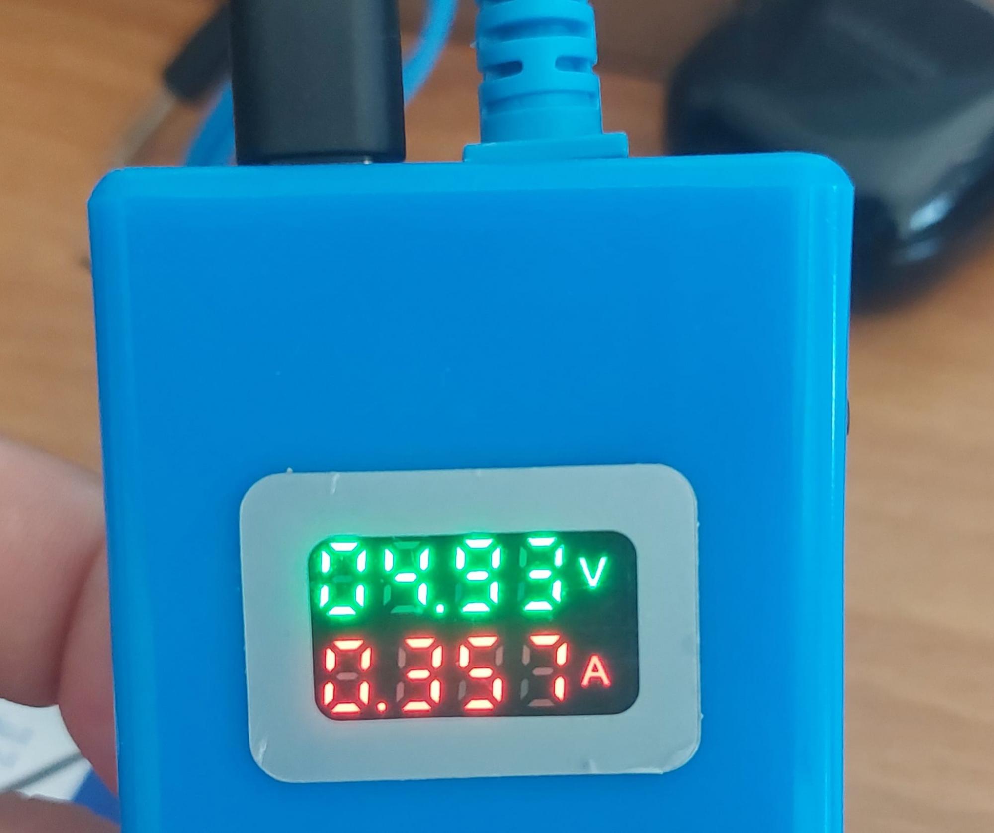

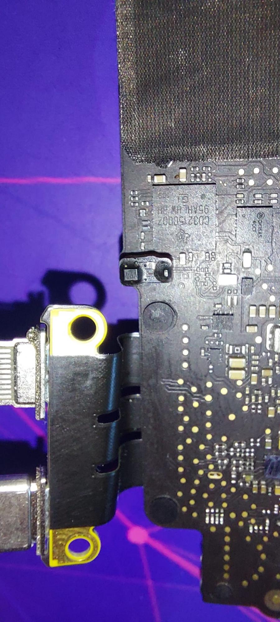

    Macbook Pro 13'' - A1989 stuck at 5v
    Preface : My primary job it's not repairing logic board, so please excuse me.
    The Macbook A1989 is stuck at 5v at 0.3A on three usb-c port, and in one port no absorption, so the incriminated chip may be the CD3125.
    I'have read that these mac have two CD3125 in daisy chain.
    How can i confirm my diagnose before reballing it? Someone have experience with this issue?
  • mon2
    • Dec 2019
    • 14698
    Re: Macbook Pro 13'' - A1989 stuck at 5v
    Does the meter jump to this current draw value or does it climb up to this value?
