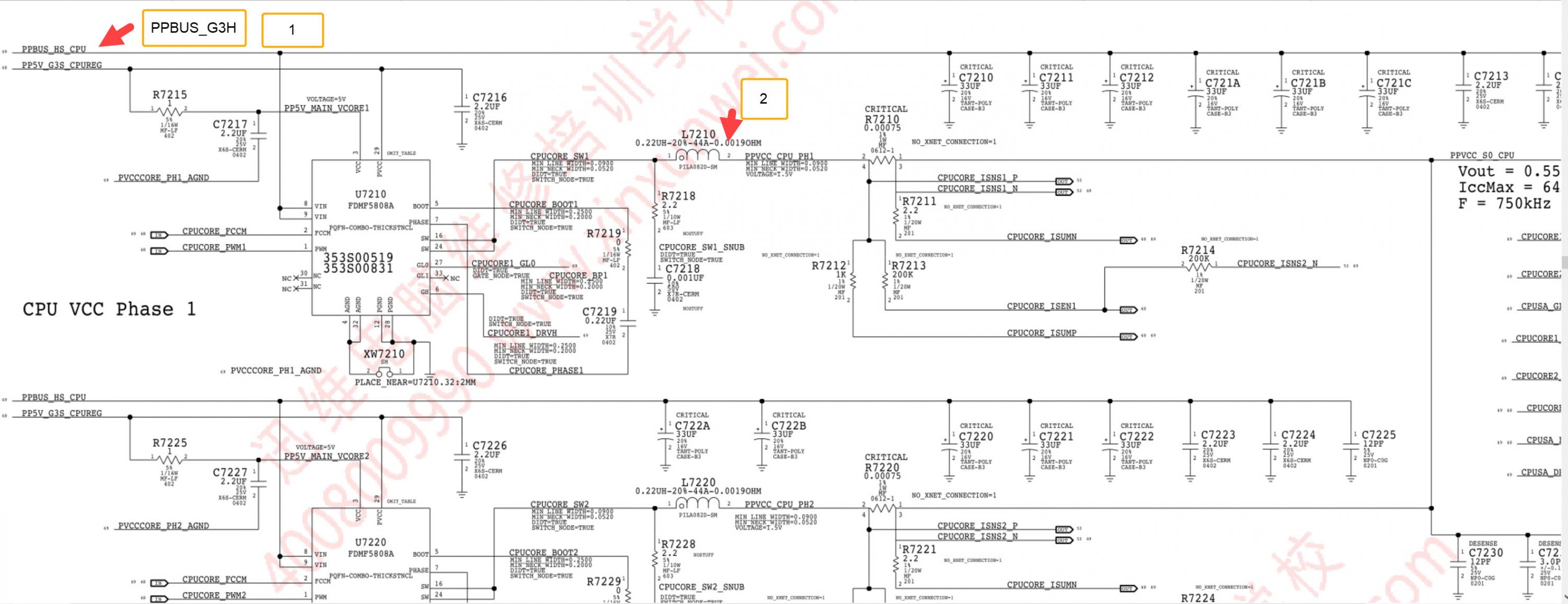

    I need help with Macbook A1989. It stuck at 5V / 5mA.
    I already do some measurements https://logi.wiki/index.php/CD3215_Bootup_Sequence
    PP20V_USBC_XB_VBUS - 5V
    PP3V3_UPC_XB_LDO - 3V
    PP1V8_UPC_XB_LDOA - 1.8V
    PP1V8_UPC_XB_LDOD -1.8V
    PP1V1_UPC_XB_LDO_BMC - 0V
    It's the same on all CD3215. There is no signs of corrosion or something like that.
    What should I check?
    Thanks for help.
    Martin

          • mon2
            • Dec 2019
            • 14603
            Re: Macbook A1989 - 820-00850-A Won't turn on - stuck at 5V/5mA
            These are good readings and each is without a short on the rail.
            What is the voltage to ground reading of PPBUS_G3H @ F7000 ?
            • martyjelen

                      • mon2
                        • Dec 2019
                        • 14603
                        Yes it is.
                        With such a hard short, the component will heat up and crack under the pressure. You should be able to smell it. A simple trick is to pour the region with caps with IPA (pharmacy grade alcohol) and watch it mist from the heating action of the shorted part. We did this for a while.
                        Now we use the short killer product rated @ 30A. We dial up 0v8 (must be 1v or under to be safe) and apply this zapper. Often, the ceramic or tantalum cap that is shorted will crumble into pieces with this process.
                        See attached.
                        Remove all power. Meter in resistance mode.
                        One meter probe at F7000, pin # 2 (downstream = consumer side of this rail)
                        Other meter probe @ L7210, pin # 2.
                        We are checking if the high voltage rail created by the ISL (PPBUS_G3H) is shorted internally through high side mosfets inside the CPU power rails.
                        If yes, then likely the CPU is toast from the same event.
                        Either way, you can inject 1 volts onto the PPBUS_G3H and check the current of your power supply and watch for the component (likely a capacitor) to heat up and crumble.
                        For now, share the resistance reading of the above.
                        • martyjelen
                          • Mar 2023
                          • 127
                          • Czech republic
                          It is about 5Ω.
                          • mon2
                            • Dec 2019
                            • 14603
                            To confirm, you are reading a 5 ohm resistance between PPBUS_G3H and the inductor / coil referenced in my last post?
                            That is bad news. This means that the high side mosfet inside the switch regulator is shorted and very likely passed the high voltage from this rail onto the CPU / PCH and killed it.
                            Do wait on others to comment but the CPU will have to be replaced which is not a simple process.
                            • piernov
                              • Jan 2016
                              • 4437
                              • France
                              Assuming no direct short PPBUS_G3H → PPVCC_S0_CPU:
                              resistance PPBUS_G3H→GND = 0 ohm
                              resistance GND→PPVCC_S0_CPU = 5 ohms
                              resistance PPBUS_G3H → PPVCC_S0_CPU = resistance PPBUS_G3H→GND + resistance GND→PPVCC_S0_CPU = 5 ohms
                              If direct short PPBUS_G3H→PPVCC_S0_CPU and no direct short PPBUS_G3H→GND:
                              resistance PPBUS_G3H→PPVCC_S0_CPU = 0 ohm
                              resistance PPVCC_S0_CPU→GND = 5 ohms
                              resistance PPBUS_G3H→GND = PPBUS_G3H→PPVCC_S0_CPU + resistance PPVCC_S0_CPU→GND = 5 ohms
                              • mon2
                                • Dec 2019
                                • 14603
                                Excellent. Thanks @Piernov.
                                Let us continue...
                                Remove all power -> meter in resistance mode -> check the resistance to ground of L7210, pin # 2.
                                What is the measurement?
                                How current can your power supply support?

                                  • martyjelen
                                    • Mar 2023
                                    • 127
                                    • Czech republic
                                    So, I checked it again.
                                    F7000, pin # 2 > L7210, pin # 2 - 5Ω
                                    L7210, pin # 2 > GND - 5Ω
                                    Current limit of my power supply is 5A.
                                    • mon2
                                      • Dec 2019
                                      • 14603
                                      Dial up 1 volt on your power supply.
                                      Mate the red probe of your power supply to F7000, pin #2 pcb pad. Black probe to ground.
                                      Do not have any other power to the logic board.
                                      This setup will inject 1 volt onto the shorted component on the logic board and will cause that part to heat up quickly. Note which part heats up. Often will be a defective capacitor which will often crack open. Then turn off this dc power supply and check the resistance to ground again at F7000, pin #2.
