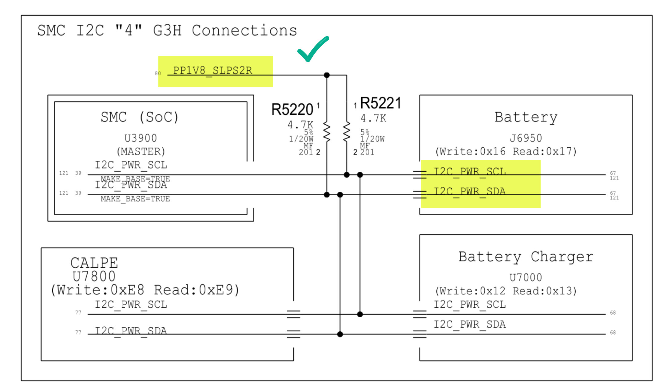

    Issues after the battery change?
    Check the ESD diode linked to the smbus lines (SCL and SDA) on the battery connector.
    Carefully measure the voltage to ground of each pin of the battery connector. Post the pin # and each voltage.
    If either the SCL or SDA pins are low, the smbus interconnect is not working due to a damaged esd tvs diode from an ESD surge event. Then the ESD diode has to be removed / replaced.

              Re: 820-01700-A macbook pro

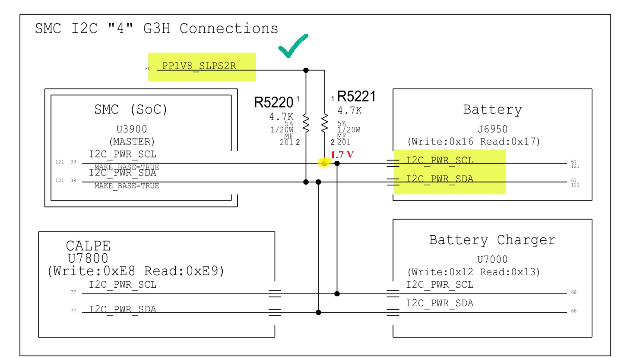

              On the new battery, is there a charge?
              Review the PPVBAT_G3H_CONN voltage to ground.
              Pin # 2 & 3 are linked to the I2C (SCL & SDA) lines and ~1v8 is correct.

                R5221 resistor shows 1 input 1.8v 2 no 1.7v. with the battery installed. the battery is charging, the device turns on, but still the keyboard + touchbar + speaker is not active. There is sound in the headphone output. these 3 hardware is not working .PPVBAT_G3H_CONN voltage 12v available.
                • mon2
                  • Dec 2019
                  • 14356
                  1v7 is ok since the clk line is pulsing high and low so the voltage is normal to show a bit lower.

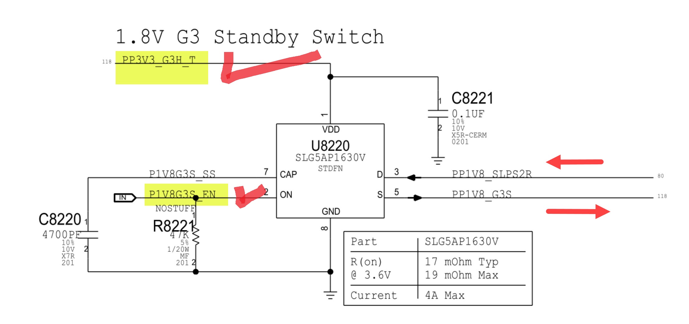

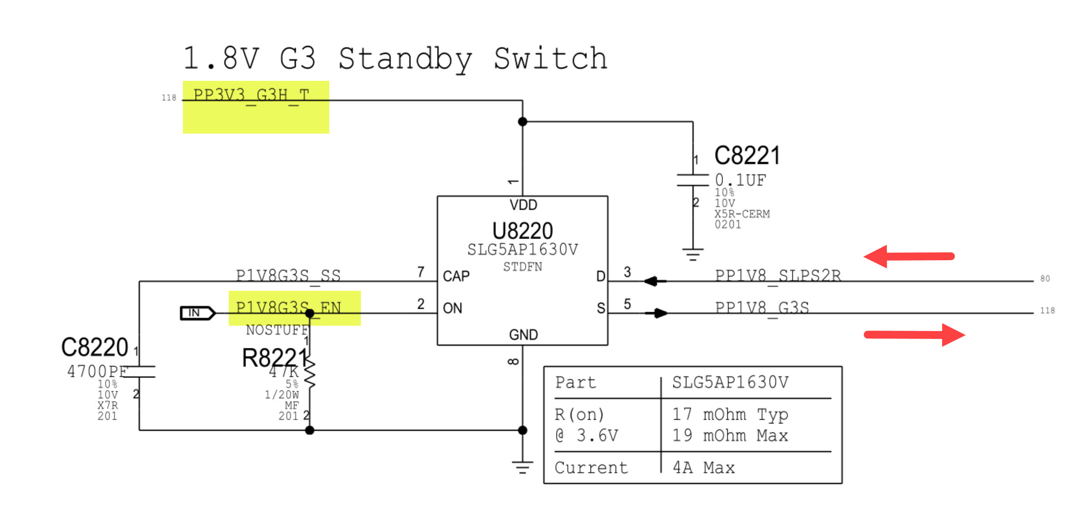

                      Check your voltage to ground of
                      PP1V8_SLPS2R
                      P1V8G3S_EN
                      PP3V3_G3H_T
                      What are the measurements?
                          PP1V8_SLPS2R
                          P1V8G3S_EN
                          PP3V3_G3H_T
                          now i can see both voltages are available. The device was brought to me from another service, the battery was changed, the battery is not the original apple, but it is a quality battery. It worked flawlessly for 1 day. After 1 day, when they turned on the device, the keyboard, touchbar and sound did not work. I have examined the motherboard a lot, there is no liquid contact or broken parts. voltages seem fine. The device is charging, it opens with both the cable and the battery. There is no problem in its operation, but these 3 hardware do not work. This is the first time I encounter such an error.
