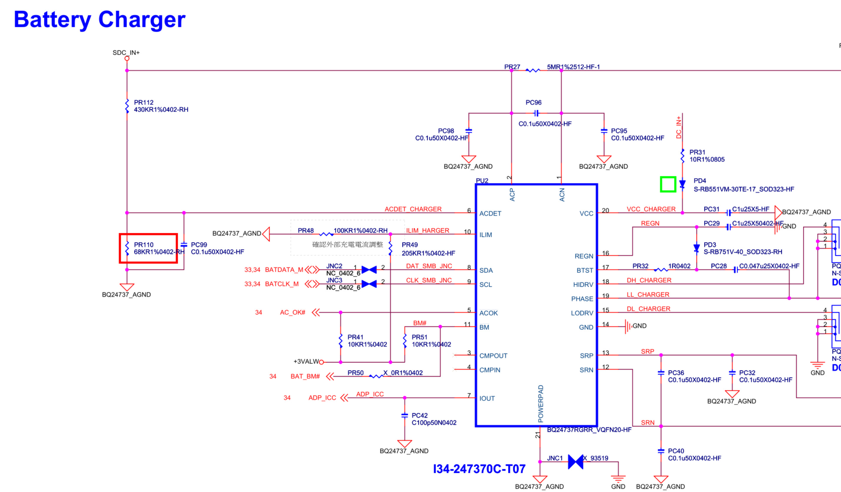

    Attaching a schematic - IC numbers are somehow different then my board (example: schematics U41 BIOS IC on my board is U43)
    Can you give me an idea where to go?
    Schematic: >>click here to download<< ---> https://www.badcaps.net/forum/showth...96#post1233196

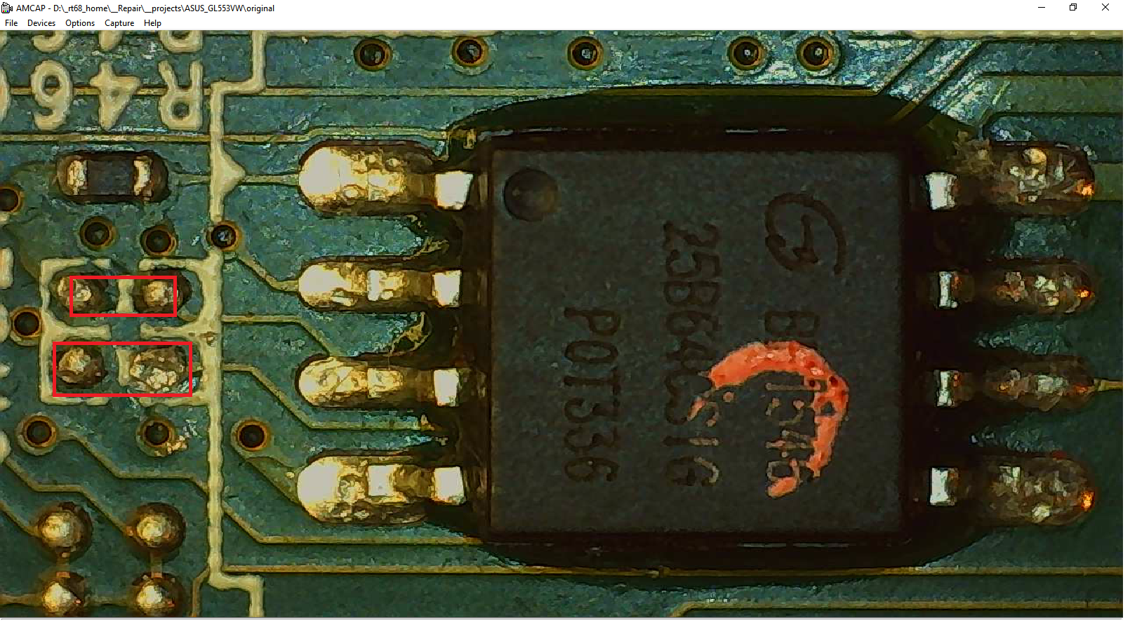

    After looking carefully on the board with my microscope. I have noticed that 2 resistors seem to be miissing next to BIOS chip (BIOS IC was drowned in flux residue so assuming someone messed with it)
    Attached picture with red marks on the assumed missing resistors.
    Pin 3 and 7 should be connected to +VCCSPI trought 1KOhm resistors.
    Now they are 1MOhm and 10 MOhm measured. (Page 24 in schematic.)
    Someone Please confirm my action before proceeding with solder iron.

      Re: GE62 6QF not reacting to power button
      Checked it on another working board and it also has nothing on that mark.
      Back to square 1.

                                  BQ24737 With only AC plugged in NO BATTERY
                                  pins:
                                  1 - 19,9 v (ACN)
                                  2 - 19,9 v (ACP)
                                  3 - 0,5 mv (CMPOUT)
                                  4 - 0,22 v (CMPIN)
                                  5 - 10 mv (ACOK)
                                  6 - 2,7 v (ACDET)
                                  7 - 1 mv (IOUT)
                                  8 - 3,3 v (SDA)
                                  9 - 3,3 v (SCL)
                                  10 - 1,14 v (ILIM)
                                  11 - 3,3 v (BM#)
                                  12 - 3,6 v (SRN)
                                  13 - 3,65 v (SRP)
                                  14 - 0 v (GND)
                                  15 - 0 v (LODRV)
                                  16 - 6,1 v (REGN)
                                  17 - 6 v (BTST)
                                  18 - 3,7 v (HIDRV)
                                  19 - 3,7 v (PHASE)
                                  20 - 19,6 v (VCC)
                                  • questore
                                    • Dec 2015
                                    • 509
                                    • csongrád
                                    Re: MSI GE62 6QF MS-16J41 not reacting to power button
                                    When only battery connected the ACOK signal goes 3.31V so It looks good!
                                    What to check next?
                                    • mon2
                                      • Dec 2019
                                      • 14332
                                      ACOK# is an active low signal so if this line is low = 0 volts, then the external adapter is OK. With only the battery, your reading is ok since the external adapter is missing.
                                      Measure the voltage to ground of each coil (inductor) on the logic board.
                                      Do you see the blue light on the board light up with the adapter & battery connected? Not sure what the blue light denotes but check the power rails (each inductor is a power rail).
                                      Do you still have a known good board to compare against?
