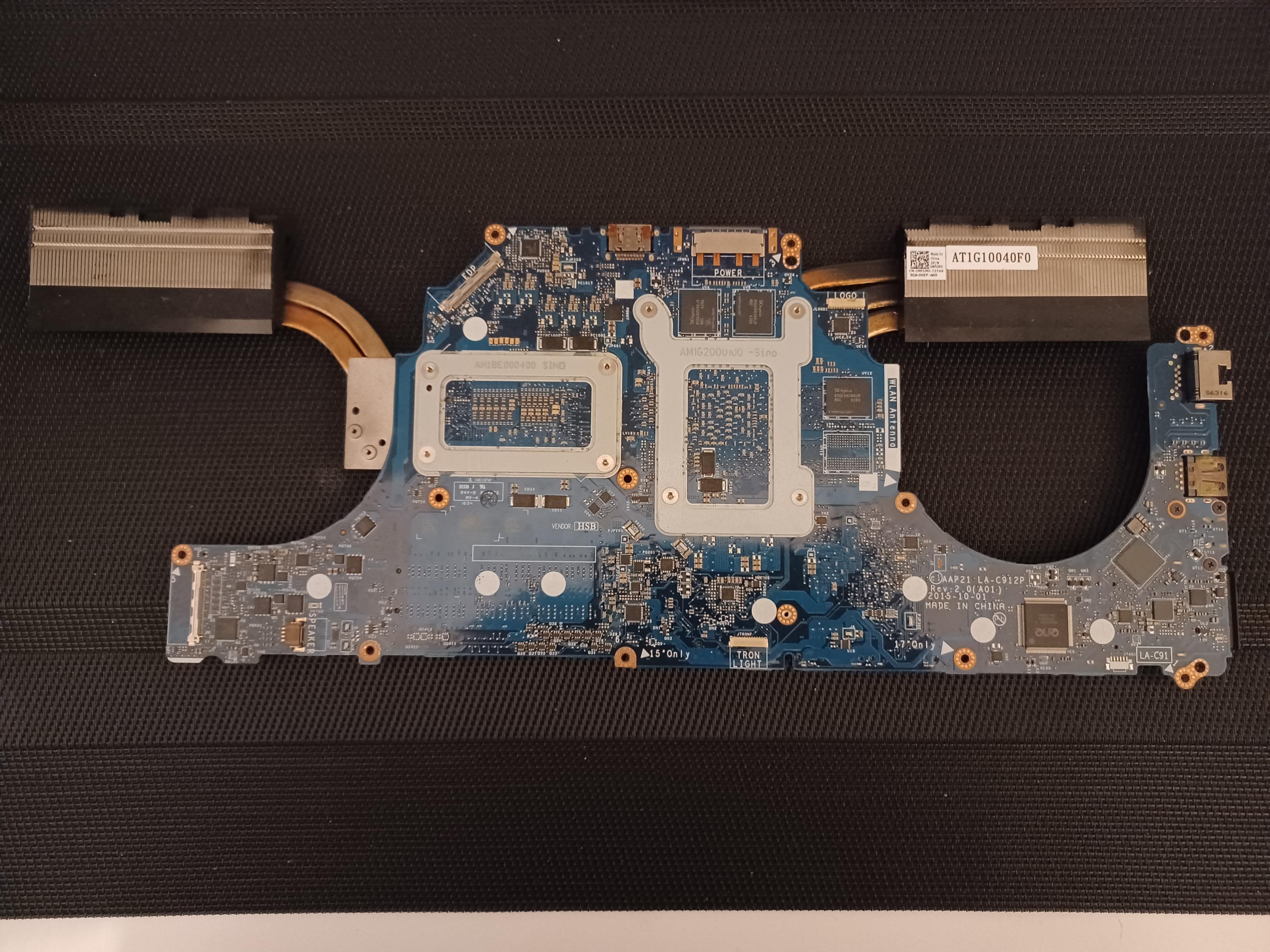

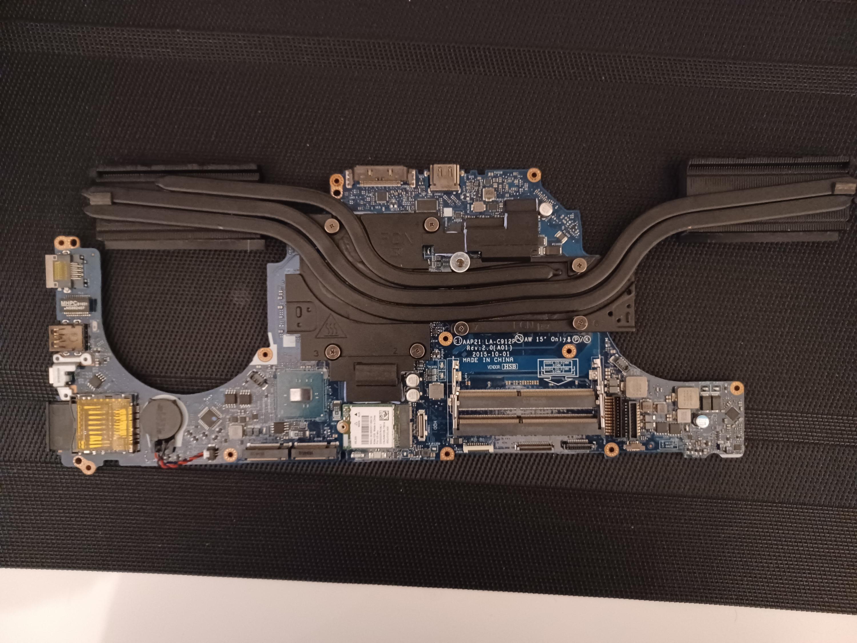

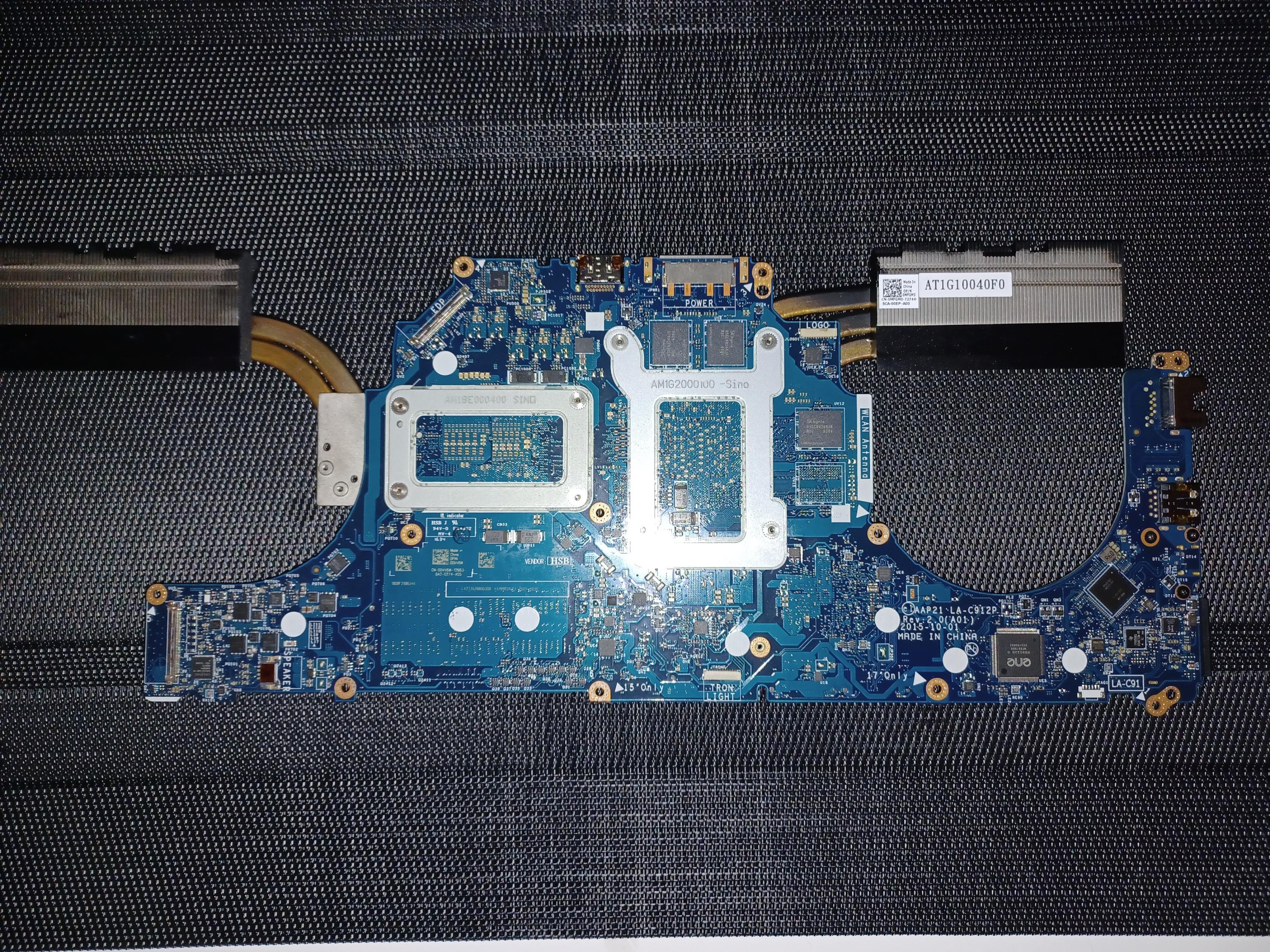

    Hello Guys,
    First off, I would like to say thanks for all the help and support this community is giving. Now to the issue at hand:
    My neighbor gave me his Alienware 17 R3 laptop that is not working right. The issue is when I press the power button, the light on the keyboard turns on, fans spin and no image on the screen and the laptop shuts itself off. I took out the ram slot cards and when I press the power button, the laptop beeps twice for no Ram. As soon as I plug in the Ram card(s) and press the power button, the lights on the keyboard and around the laptop turn on and the fans spin n then turn off. All this occur in 6 seconds. I have attached the motherboard pictures.
    Any help is appreciated.
    Thanks in advance
