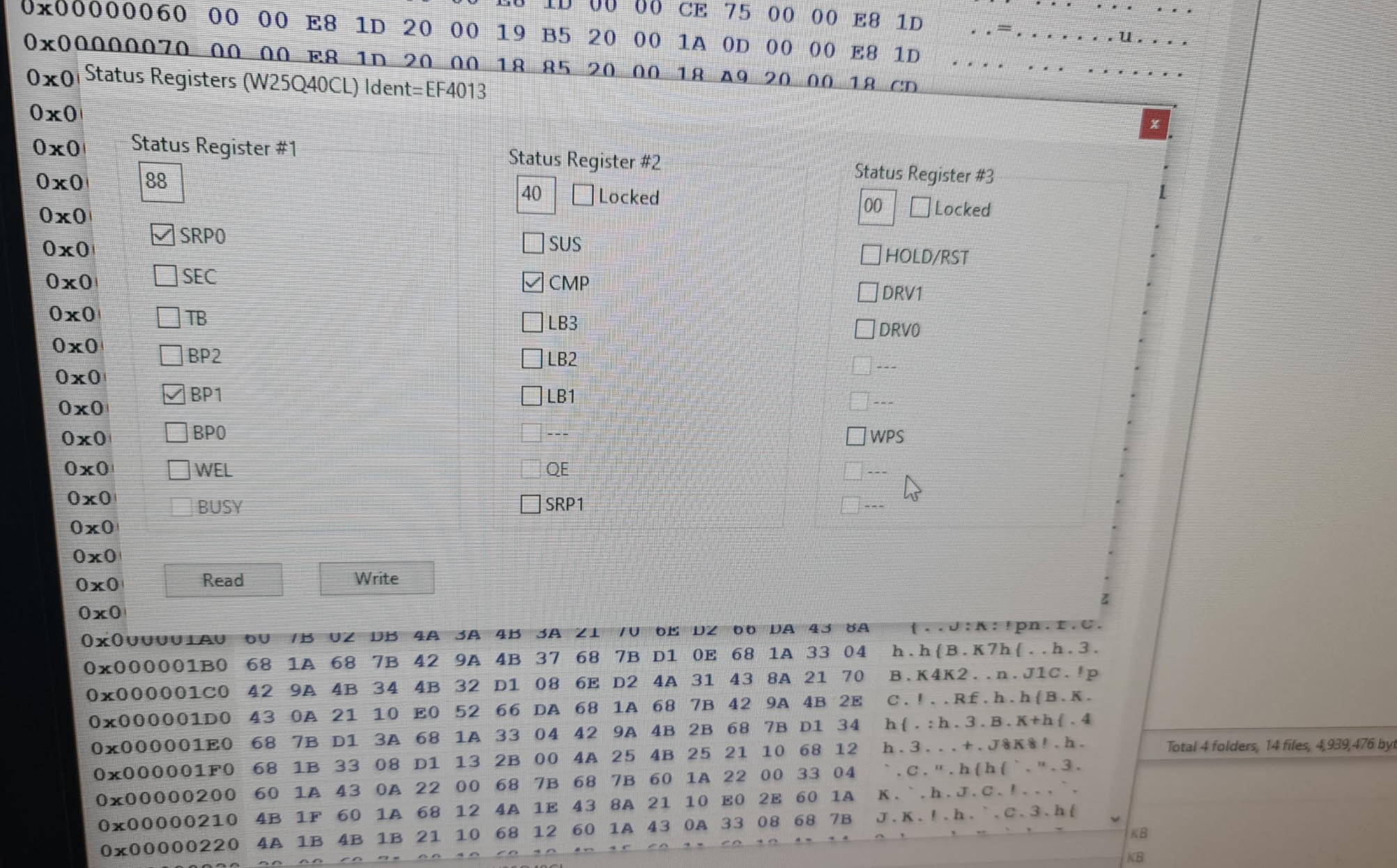

    See attached.
    Does your software offer a STATUS REGISTER view?
    Inside this view will be the QE bit option.
    Suggest that you do the following:
    1) Verify the contents of your JV flash against the original backup. If it matches, continue.
    2) If it does not match -> erase and flash the device. Verify again.
    3) As the final step, enable the QE bit to a value of '1' or apply the checkbox. This configuration will then enable the QSPI mode feature of this flash device.

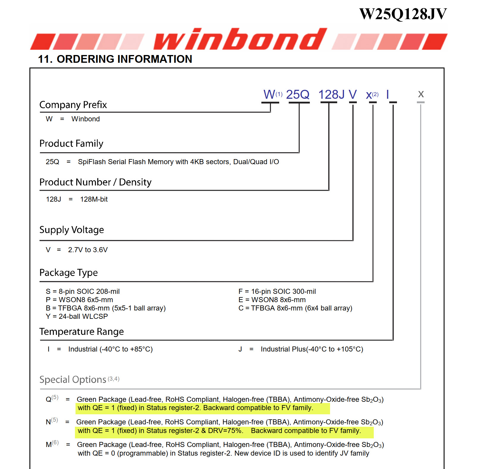

                        I seen this chip: Winbond W25Q128JVSIQ. I read the datasheet which is attached and it seems that QE is set as 1 by default.
                        I guess I can order this right?
                        Thanks again

                          Nice find !! Yes, do proceed to source the version you referenced with the JVSIQ suffix.
                          See attached. They actually built the JV series to be backwards compatible with the FV series if the QE = '1'.
                          The programming of this register is very straightforward and would be surprised if someone has not developed a program to perform this task.
                          On our many back burner projects to do is a much faster programmer as the hardware (RISC-V; FPGA; RP2040) devices are getting to be very common and cheap.
                          The WCH CH341A is ok but there are much much faster options that should be considered.

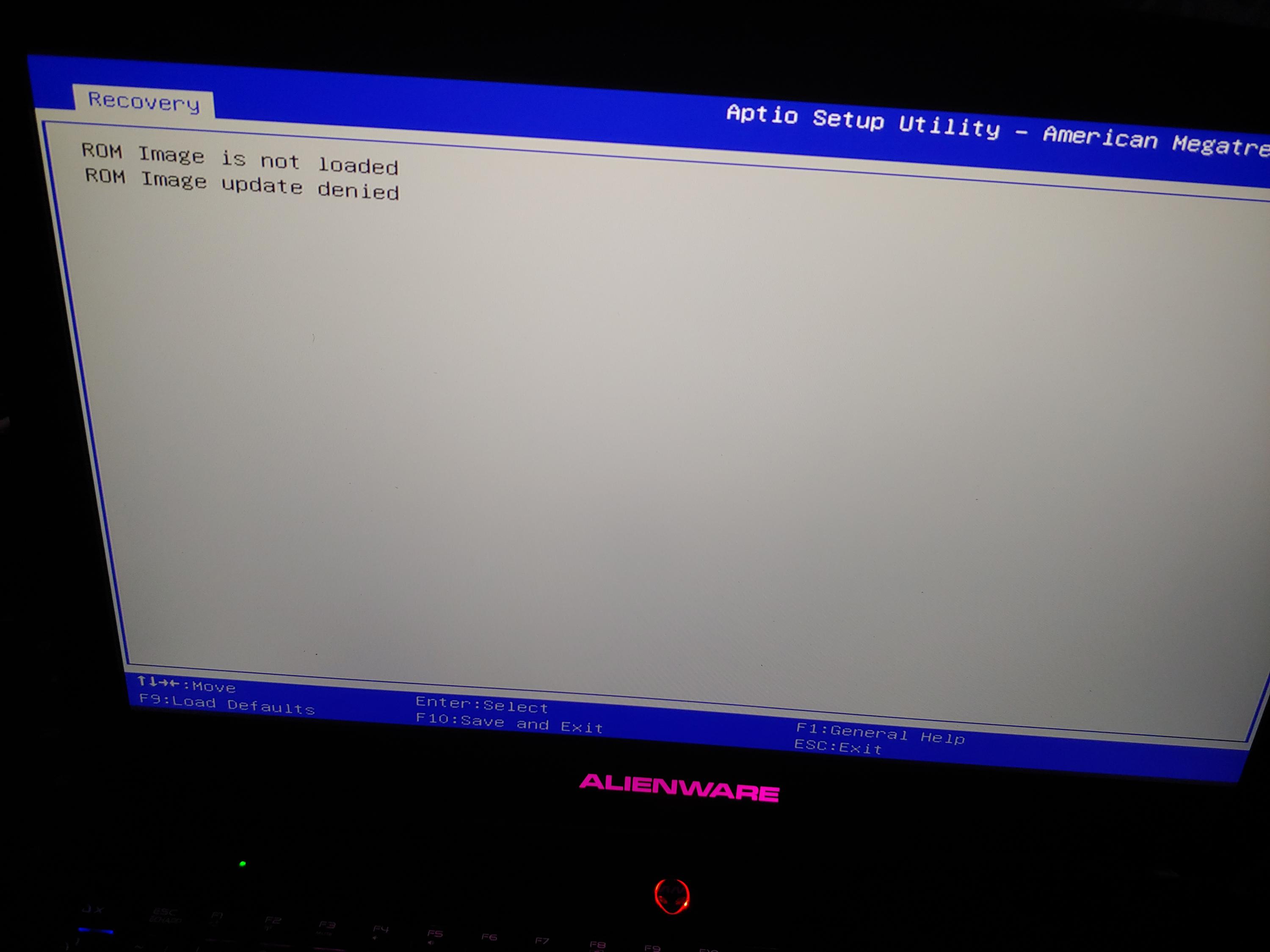

                              Re: Alienware 17 R3 power on and shuts itself off and stays off
                              update...
                              All thanks goes to mon2, Sephir0th and mcplslg123.
                              With the new chip soldered to the motherboard and the bios flashed. the computer exhibit the issue I had initially. There is no 7 beeps but now it turns on and then off. I was able to get to the bios recovery screen by pressing ESC + CTRL on the keyboard and plug in the power cable and the following image is shown:
                              Recovery Aptio Setup Utility - American Megatrends, Inc
                              Rom Image is not loaded
                              ROM Image update denied
                              Any help?

                                  #56
                                  See image below.
                                  I cannot even get into the Bios at all
