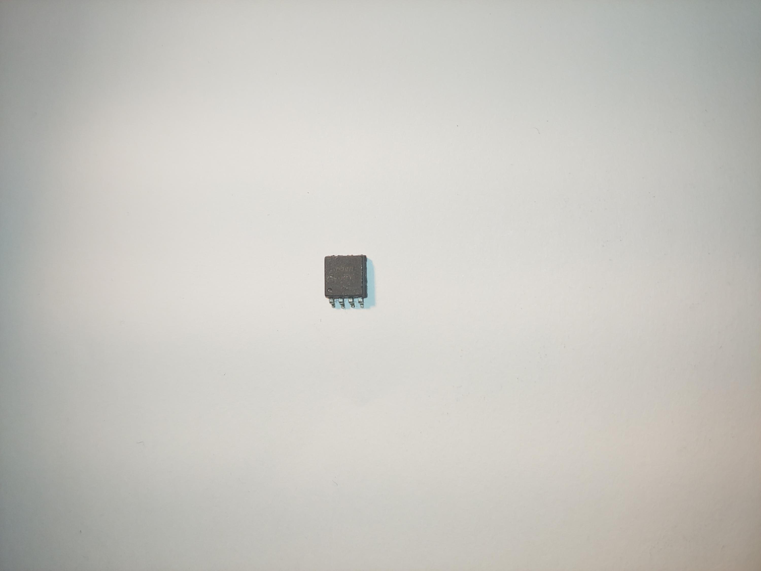

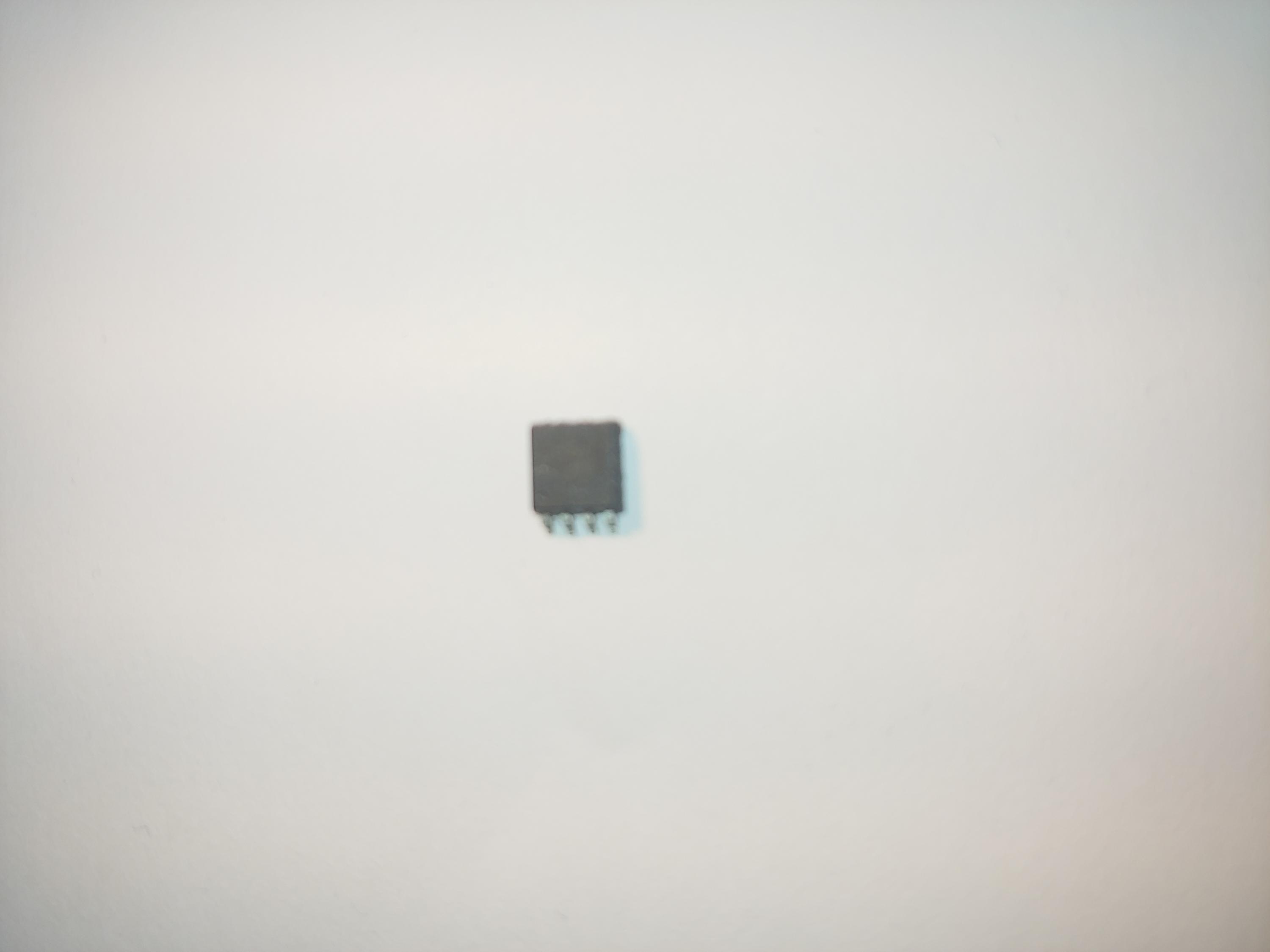

                            Can you post a pic of the original part that was onboard? Perhaps it can be repaired?
                            • waakye
                              • Dec 2018
                              • 340
                              • Electronada
                              #34
                              Re: Alienware 17 R3 power on and shuts itself off and stays off
                              Sure. It's attached. Look at the side and all four pins are broken off.

                                While not simple and not impossible, you may have enough meat left on the IC to solder on wire wrap wire. The issue will be how long you can heat up that wire before the solder melts and falls off. Let me check if there are any sources of this part still left.

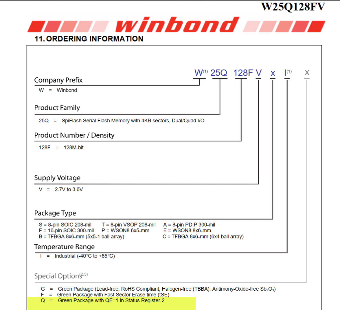

                                      W25Q128FVSQ
                                      Can you confirm the full markings of your flash IC that was on the motherboard?
                                      This is very important.
                                      From the datasheet, found the following - see attached.
                                      With a 'Q' suffix, this implies the flash device as sold from Winbonard is indeed in QSPI mode.
                                      This means that your JV flash will NOT be the same until you manually enable the QSPI mode using your programmer tool.

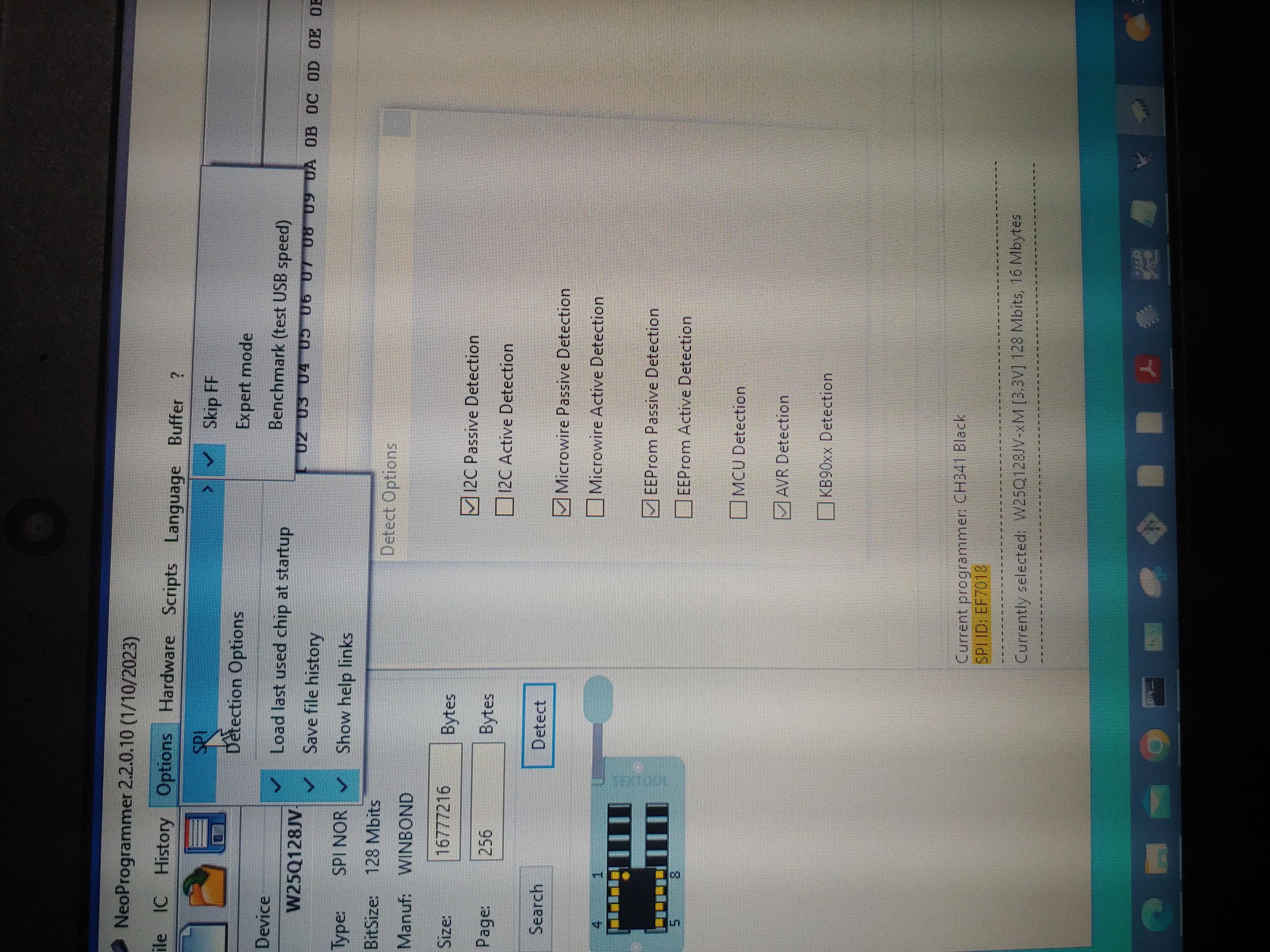

                                      Personally do not use the same tools but can you share screens of the options for the JV flash device ?
                                      You are looking for the 'QE' bit and by default, it will be '0' and you want to change this to '1' and continue to flash the device. Then test again.

                                        This is the marking on the chip: Winbond 25Q128FVSQ 1633

                                          I have attached the option menu of the chip. Let me if that is sufficient. Btw am using Neo programmer and CH341A black edition programmer. The volage modification is done to supply the chip with 3.3V.
