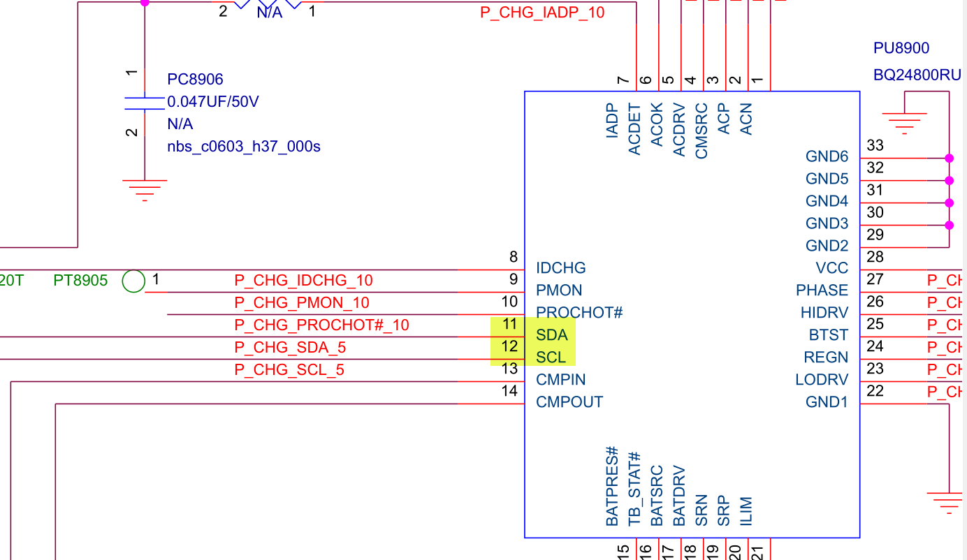

      #122
      Re: Dead ASUS ROG G14 (GA401)
      My bad, yes pins #4 & 5 which appear to be ok for the diode mode readings.
      Let us check that the contacts reach the charger IC.
      Meter in diode mode. Short the meter probes and you should have a tone beep.
      One meter probe on pin #4 of the battery connector (without the battery connected); other meter probe to pin #12 on the charger IC.
      Do you hear a tone beep?
      Repeat with pin #5 of the battery connector & pin # 11 on the charger IC.
      After the above tests, power up - still without the battery.
      Meter in DC volts mode. Measure the voltage to ground on pins #4 & #5 on the battery connector.
      You should have ~3v on each SMBUS SCL / SDA pin.
      Finally, connect the battery again and check if the voltage to ground measurements remain at ~3v on these battery contacts.
      A defective BMS board on the battery pack can cause the SMBUS communication to fail. At that point, the battery should be replaced.
      Post each measurement.

        #123
        Connection between connector and IC is there.
        Both pin #4 and #5 show only 0.66V when DC in connected and pc turned on, also with battery plugged in.

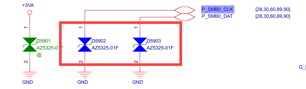

                #127
                Remove the battery. Using only the power adapter, what are the voltage readings to ground of these 2 pins?
                Both are 0.6V
                • mon2
                  • Dec 2019
                  • 14579

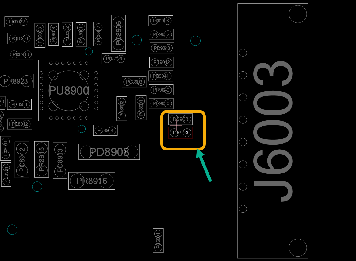

                  #128
                  These are open drain pins so they must have local pull up resistors to park these pins to a soft logic high level.
                  Either these pins are missing these pull ups or the ESD diodes are pulling these pins low.
                  Locate the ESD diodes on these pins on the logic board. They should be fluxed and carefully removed. Do not lose the parts.
                  Then power up again and check these pins.
                  See attached for their component names.
                  • jacobtc
                    • Apr 2016
                    • 274
                    • Denmark
                    #129
                    Both are still 0.6V after removing diodes.

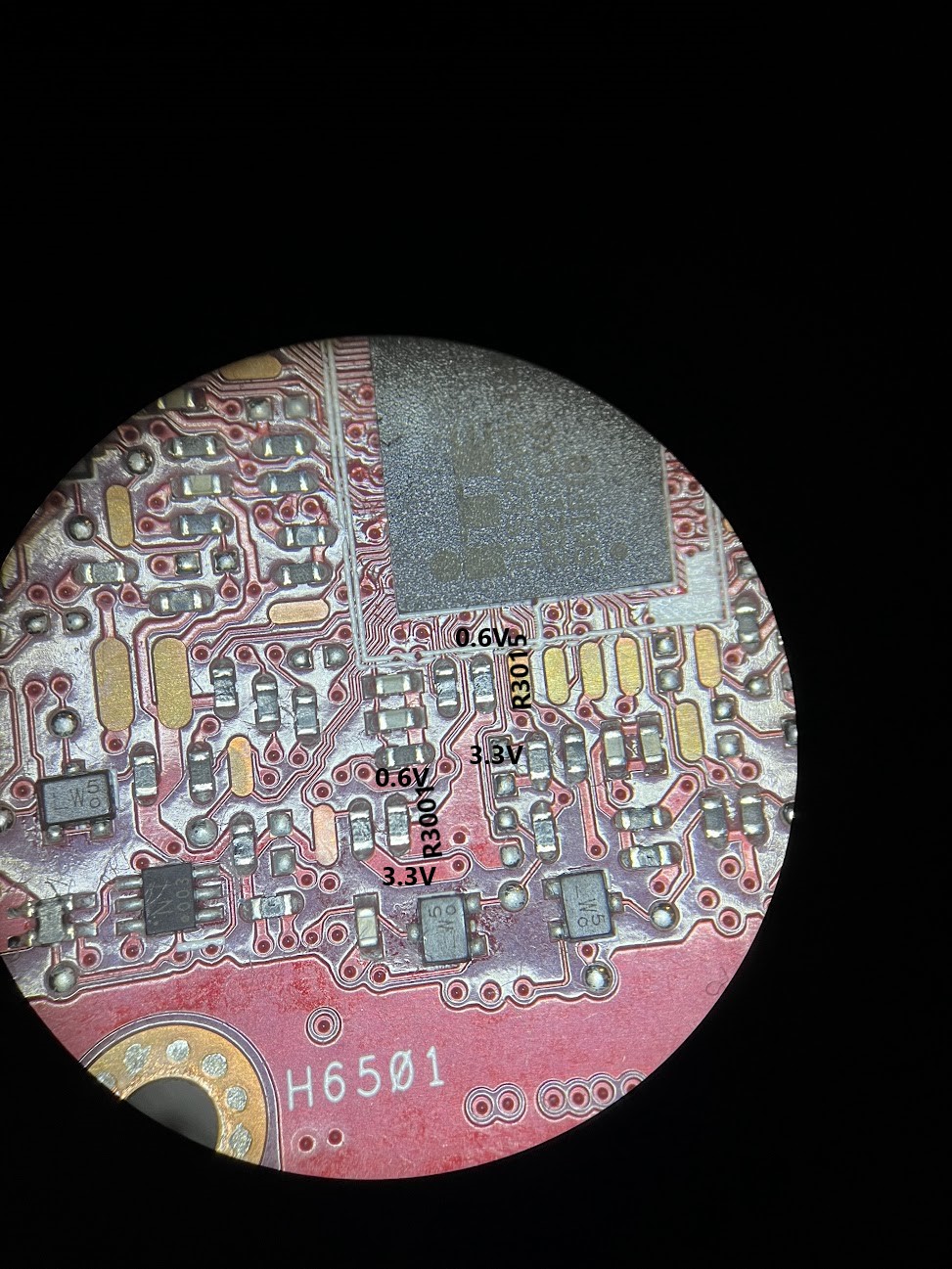

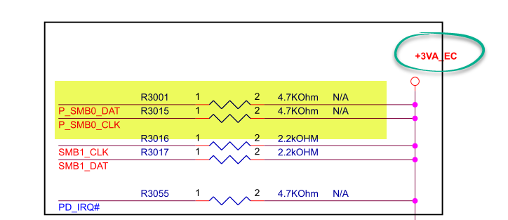

                      #130
                      See attached. Locate these local pull-ups for this SMBUS pair of lines.
                      Confirm the voltage on each side of the pull-up resistors.
                      R3001
                      R3015
                      • jacobtc
                        • Apr 2016
                        • 274
                        • Denmark
                        #131
                        R3001
                        R3015
                        Thanks, the boardview is not the correct one, but I found one elsewhere, these are the resistors and their measurements (see pic).
