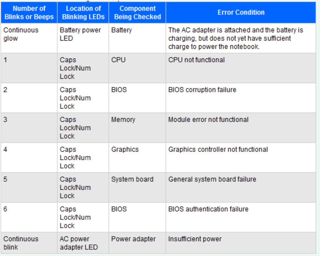

    Hp 450 g3 i5 no turn on
    Hello everyone, hp 450 g3 i5 mainboard DAX63CMB6D1 Rev D X63C . Power jack light off and 7 white caps lock flashes. Any ideas? Thank you.

    Re: Hp 450 g3 i5 no turn on
    Could it be 6 flashes ?
      Dont bother much about the blinking codes-they often misguide you.
      DC jack light should be present when ac adapter is connected.Since you dont have dc jack light,it could be for the following possible reasons:
      01.Bad/corrupt bios
      02.AD_ID not correct
      03.3V LDO is shorted or missing
      04. Bad EC.
      Probe the listed issues one by one and update.

        Thanks for the help , the problem was the bios . The version I installed, however, 'does not have any data of the machine, what can I use to insert them taking them from the image of the original bios ?
          Unfortunately it makes 7
            Phone up your local HP technical support office and ask them to explain this (undocumented??) code. Post an update here.
