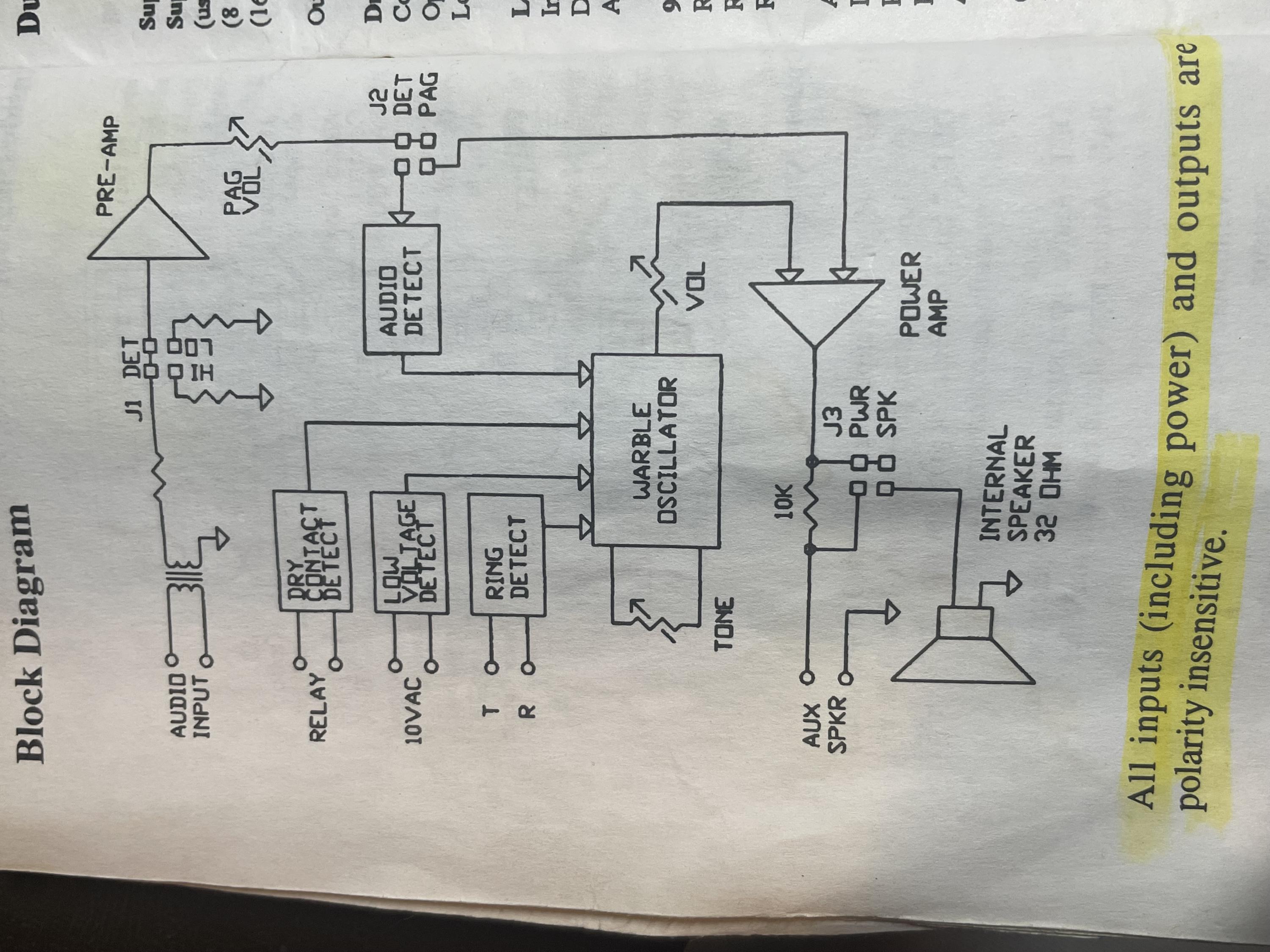

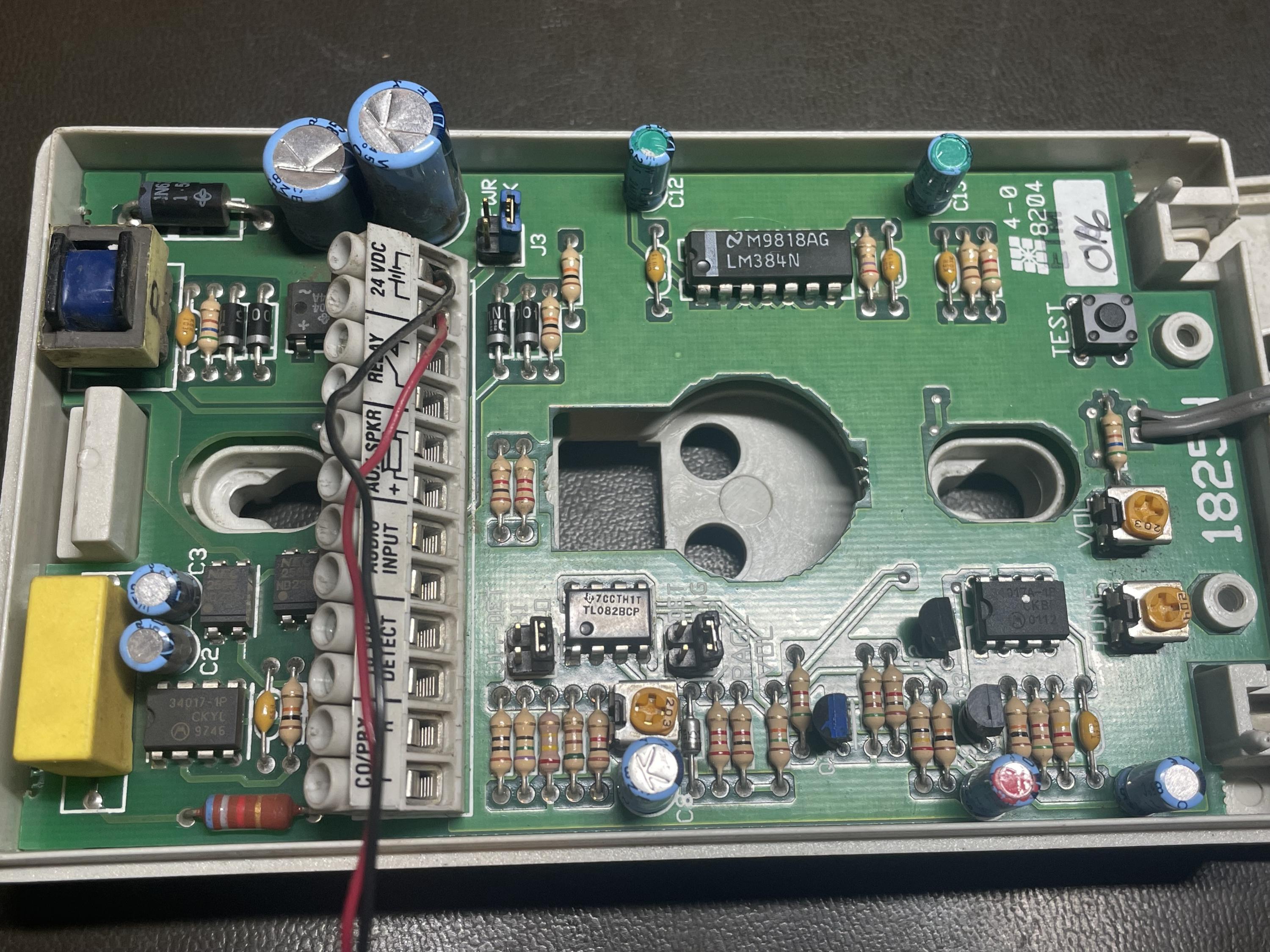

    Got one of these Algo Duet-Plus 1825(p) in for repair. Complaint: Not making any noise anymore.
    Yeah... and nope it wasn't the LM384N audio amp. The warbler IC is the MC34017A-1P. In short, if you press that test button a warble sound comes out that speaker. In my case I injected a tone with my tone generator on pins 2 and 3 on MC34017A and sure enough... sound was getting to pin 6 of the LM384N and amplified out to the speaker.
    Hmm... o.k. is the IC getting turned on pin 4 when I press the button? Yep. Is really that warbler IC bad? Sure enough... dead like a door nail.

              Hmm... interesting, that the S2561 failed the same way that this MC34017, just with an extra short life span. lol. Apparently this MC34017 sounded different (probably like a cat dying) before it died. When I got it, it was absolutely dead, no audio at all. I found some of these MC34017's at futurelec.
              • CapLeaker
                Leaking Member
                • Dec 2014
                • 8352
                Re: Algo Duet-Plus 1825(p) not warbling repair
                To round it all up, I never got the order from futurelec. Reordered at Ali, put the new MC34017 and the unit is working once more. A fourty cent part… lol.
