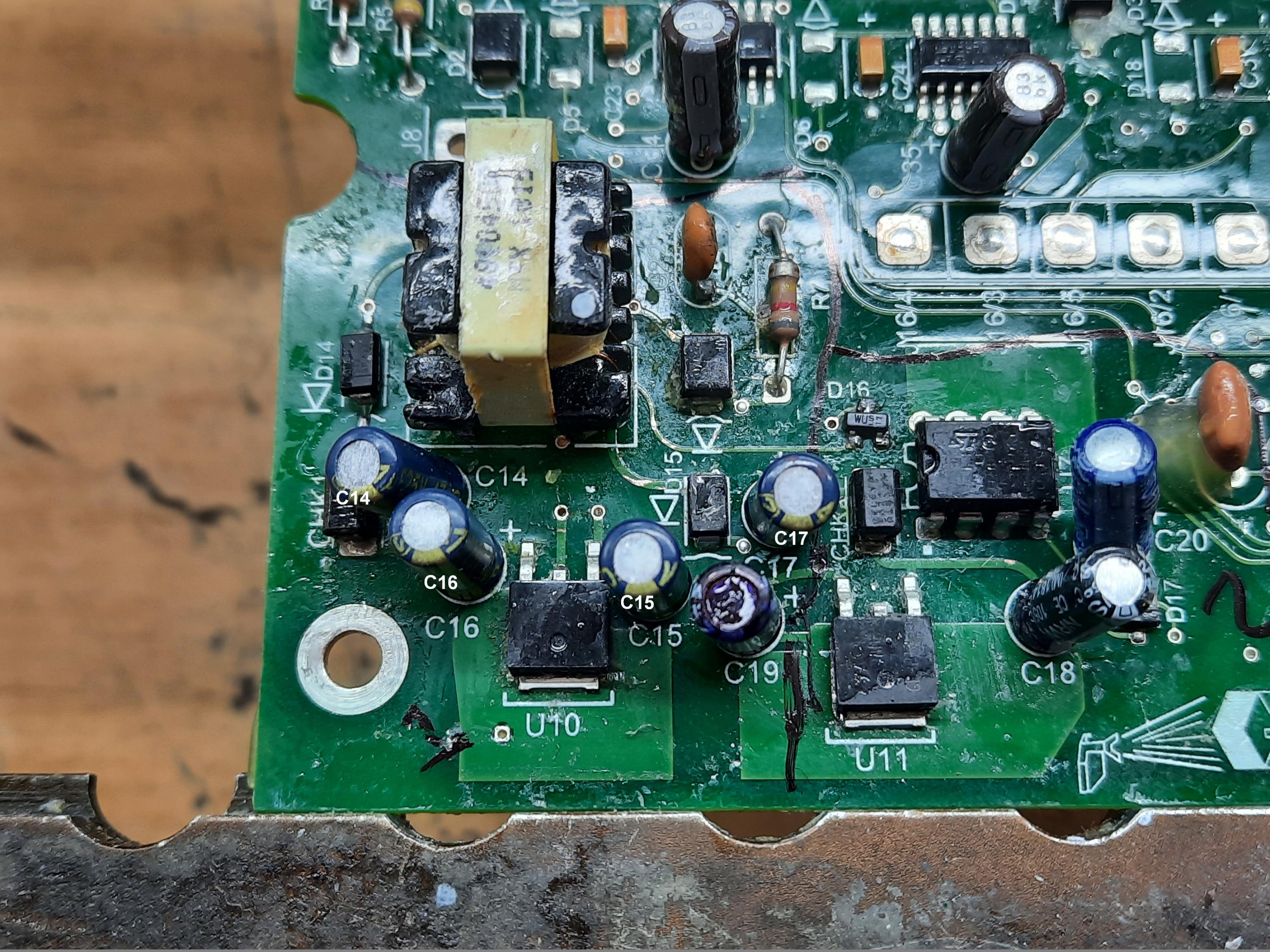

        Re: Graco ST MAX II 495 PC PRO , paint spray machine help
        So far found C14,C15,C16 & C17 ( 47MF , 25V ) , poor ESR readings .
        Also D16 , which seems to be O/C , has previously been reworked and/or replaced .
        Messaged customer to find out what the hell is going on .
          C20 looking preggo, D16 pin not soldered, was a gorilla inside trying to fix this?
            Yes unfortunately
            Customer took it upon himself to replace D16 , so now i need to try & discovered part number of original.
            C20 on my to do list as well .

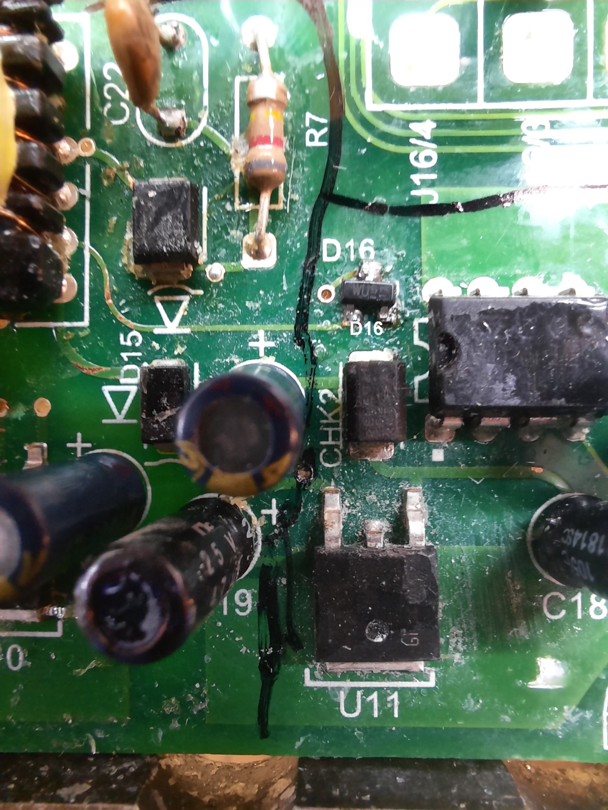

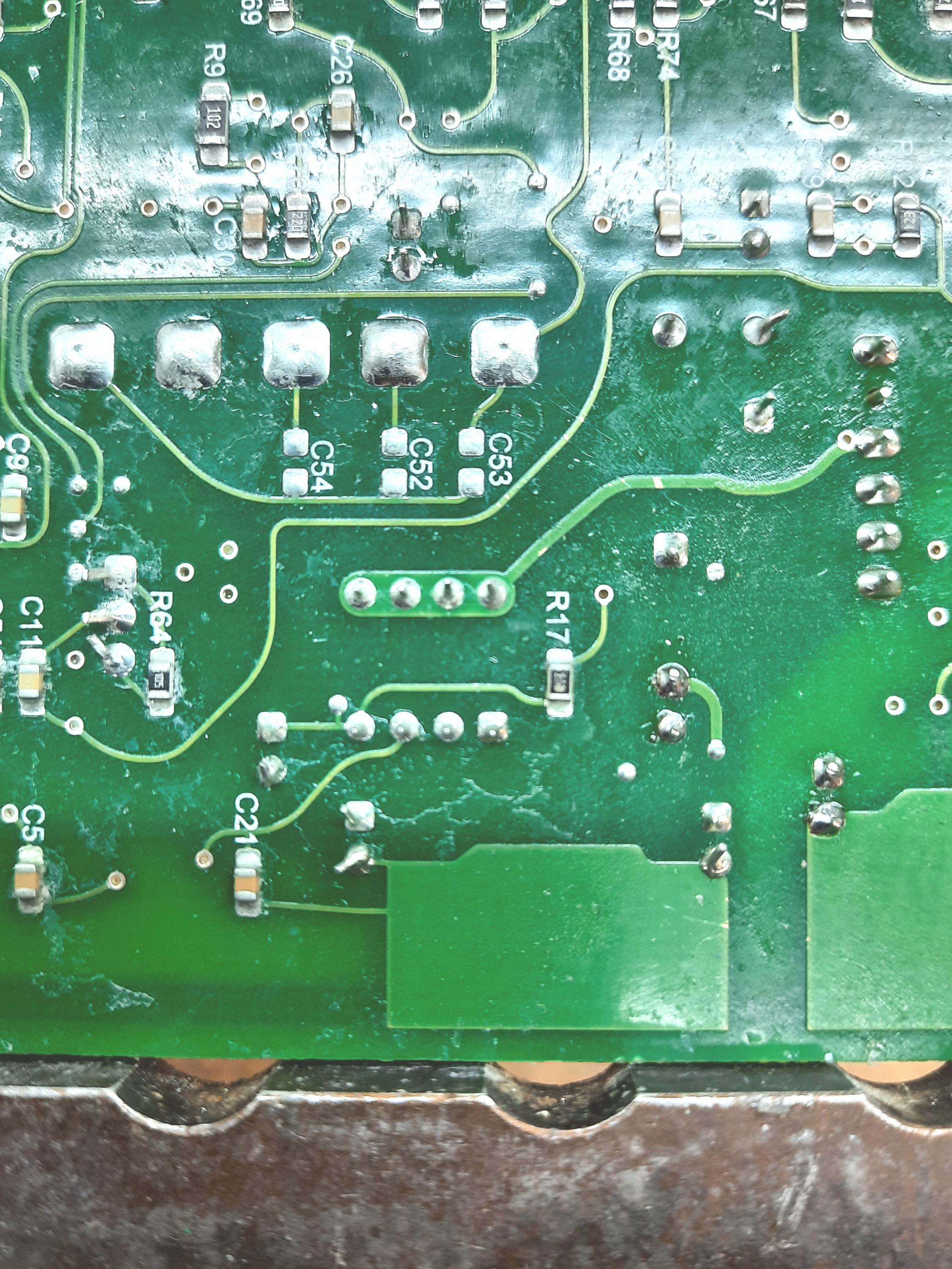

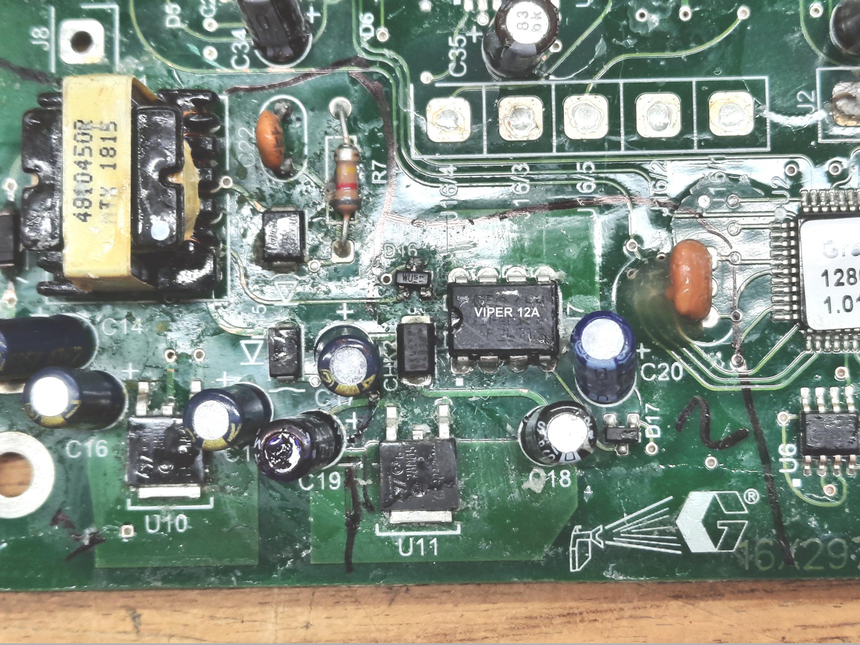

                Thanks , still battling with this one .
                U7 ( VIPER 12A ) control chip also seems to be faulty .
                D16 is fed from a transformer ,then follows through R17 which is cooked , then to the supply pin 4 ( VDD ) of U7 .
                Only 2 pins of D16 are actually connected , therefore assume it's some sort of fast switching rectifier diode .
                Can anyone help with replacement advice for D16 ,& also value of R17 , which i assume will be quite low .
                  The component installed at D16 now seems to be a transistor (BCR162) any sot23-3 200ma or higher diode should work. Many circuits use a 1N4148 for this diode, so find a similar SOT23-3 (BAT54, BAT54C)
                  The resistor could be anything low 0~10Ω maybe
                      D16 is usually a SOT-23 diode like BAV99, BAS16, MMBD4148 etc. I think BAT54 at 30V is too low. Around 10R looks reasonable for the resistor. C20 must be in bad shape.
                      What fused? A shorted Viper 12 usually blows the top off, and this board has pretty thin pcb traces and looks 4-layer. Many scuffs and nicks on traces/solder mask. Even parts are trashed, R7, U11- could you use a bigger hammer.
                      I'd check with an ohmmeter the path from primary cap to transformer to see if there is an open-circuit. I don't see what fused yet.
                      There's no feedback opto either, so it might not be an isolated supply.
                        The bat54 voltage is a bit low, go for something around 100v
                          Hi Redwire ,the scuffs are due to all the hardened glue i needed to removed so that i could gain access to many of the components .
                          Cheers on the advice for diode type guys , will check to see what i have in stock .
                              I understand the conformal coating can make the repair extra hell. I use needle probes to poke through for readings, and hot air gun to heat/soften the coating and scrape it off.
                              TBH the board is a piece of junk, nobody puts a MCU ceramic oscillator right next to the SMPS primary. Skinny traces and more glue please.
                              Customer seems to keep trying people to repair it for $0.99 or something. If someone already was in there, I don't take on the repair because it can be such a mess.
