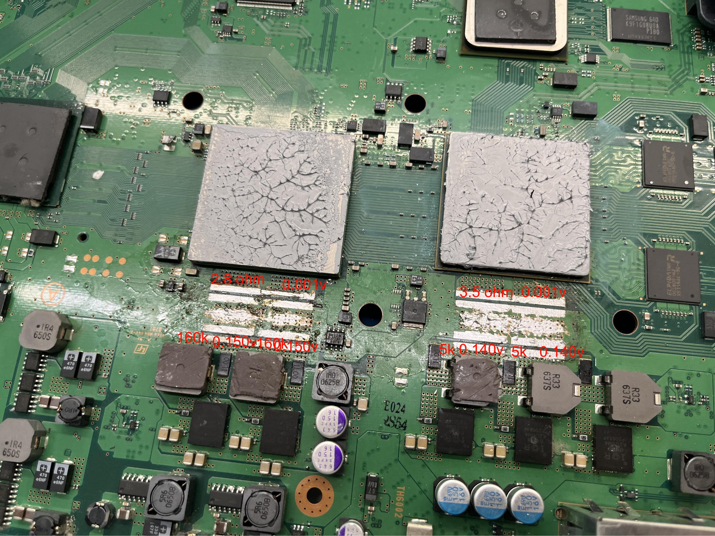

    Hi guys i already checked the hard drive and its ok ..
    its gpu failure =?
    https://youtu.be/yTjMAt4szrE

    Re: Ps3 Fat 60 gb RED LIGHT
    very rare,
    usually it's the prodalizer capacitors or the psu module.

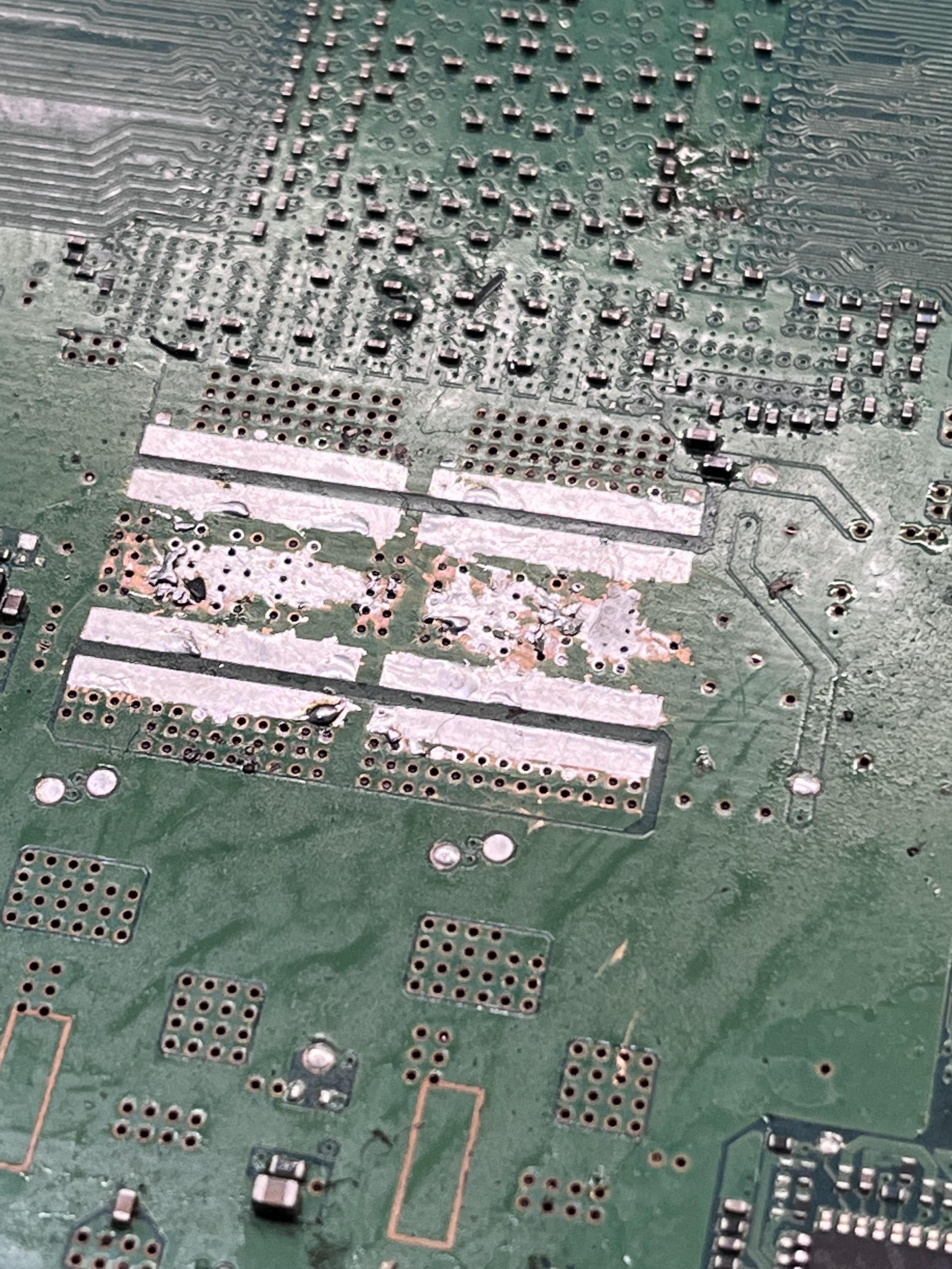

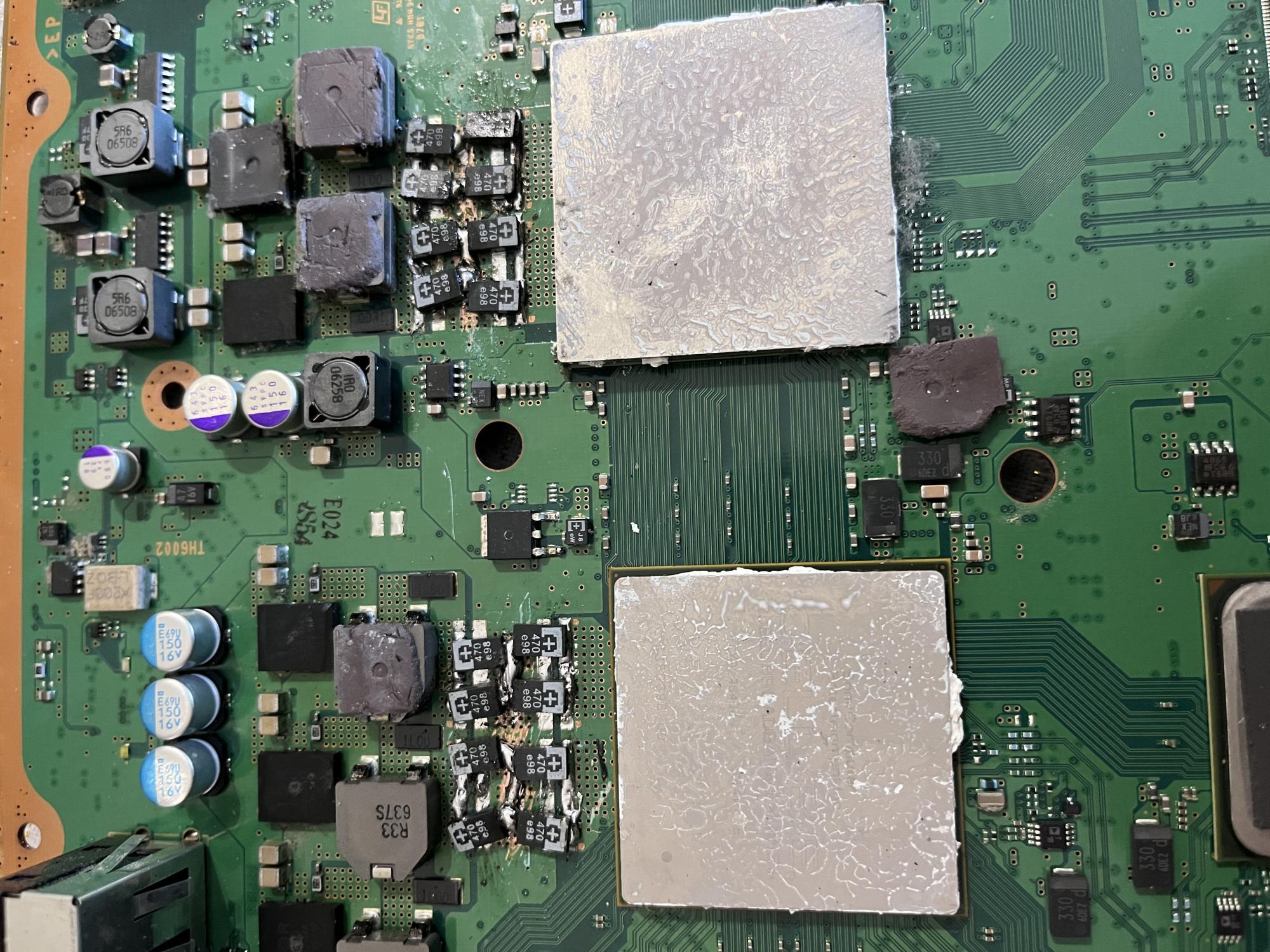

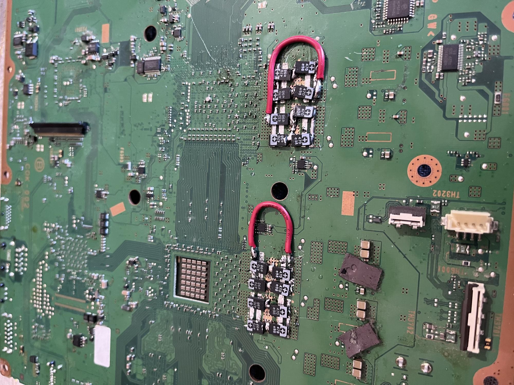

          i replaced all nec tokin with 470uf caps , first time was working , but only with one xclamp not fully screwed up. Second time no more boot and after full short on 12v , now i removed every caps and solder just want to make from scratch . Short is gone .
          I scratched in the center for convenience but it is gnd anyway.
            i found one of the caps is in short / beeping and 0.000 in 2k scale.... whats the problem.... i buyed from aliexpress can be rubbish ?
              • 31301
              what caps? tantalum?
              could be shit, but i never had a bad one.
              maybe reversed? too much heat from soldering?
              can you link what you purchased.
                    i have this value , are ok ?
                      • 31301
                      no idea.
                        The correct way to diagnose PS3 YLOD (it briefly flashes yellow before going red) is with the syscon diagnostic method using a USB to TTL converter, soldering a few wires to specific test points on the board, and using a wonderful script someone wrote to connect to the syscon and get it to spit out error code.
                        This guy's video is a little long but between the video and the items he has in the description, it should get you everything you need to get the syscon to spit out the error code for you. Once you get the codes, you can go here to see what the actual problem with your PS3 is: https://www.psdevwiki.com/ps3/Syscon_Error_Codes
                        Long gone are the days of just replacing the NEC Tokin caps and hoping that was the cause of your YLOD
