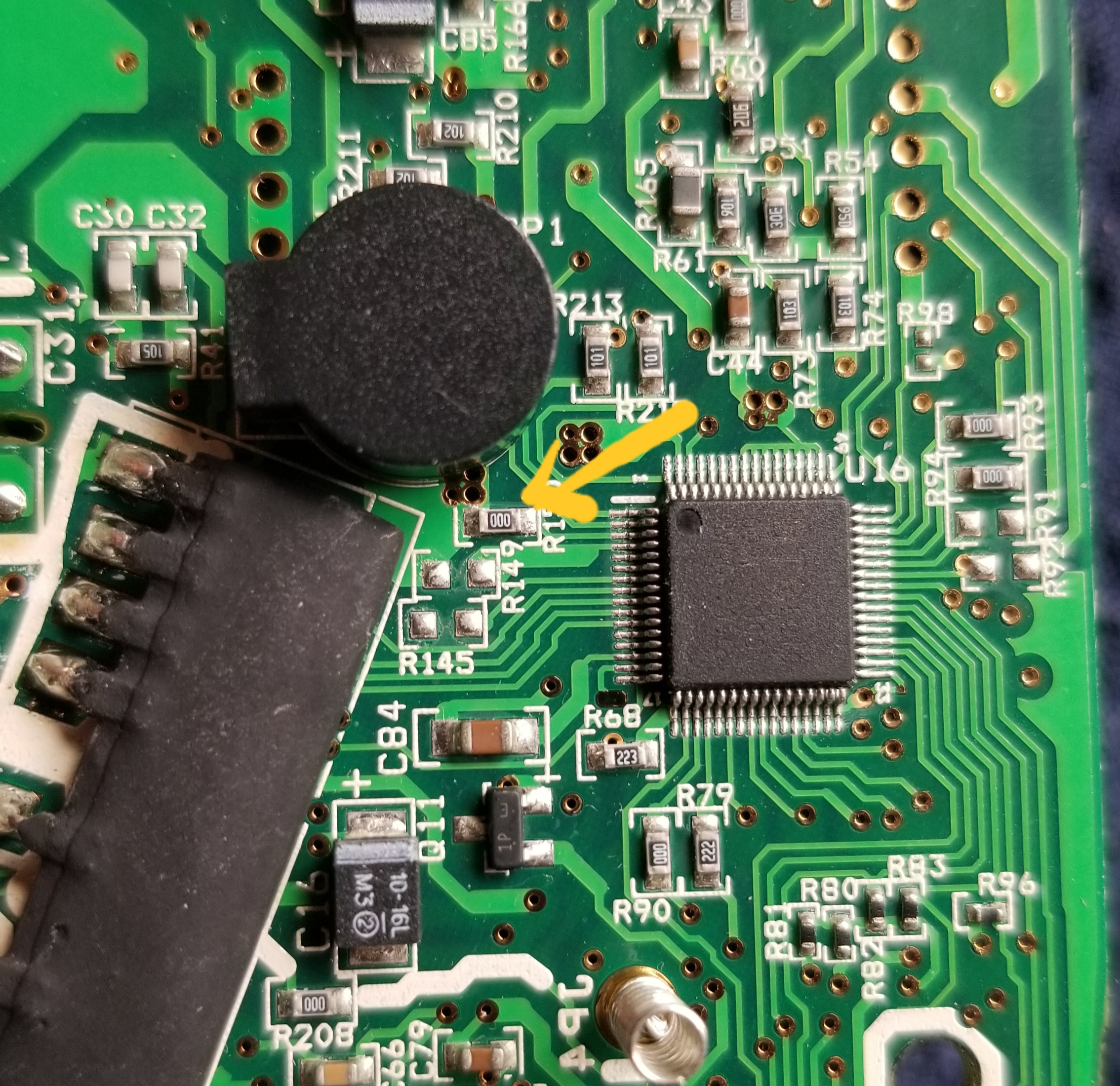

    I have a dead bm786.
    Inserted new fresh batteries, rotate the switch, unfortunately no display..
    Could anybody with knowledge guide where to start probing/ troubleshooting ?
    Background : I m familiar with simple circuit, have another working fluke multimeter
    Preliminary probing.
    Output from linear regulator is normal about 3.5vindicated by yellow arrow in picture, There is 3.5v going into ic which I believe is a microcontroller.
    No short found on any caps ...
    There are the other 2 ics which I believe to be front end ADC ic and lcd driver, but since they are custom btc IC I can't find any datasheet (including the assumed microcontroller)
    No sign of 3.5v going into ADC IC and lcd driver.. maybe supplied by different circuit or there is MOSFET gate failing somewhere... Hmmm...
    Greatly appreciate your help

        Re: Multimeter repair brymen 786
        For the Brymen 786/789 etc. I looked at pictures and it's a 4-layer board and a bit hard to follow all the traces.
        I can suggest a few things to check. But first, never run a handheld multimeter from a bench DC power supply, always use the batteries.
        On handheld multimeters input COM(-) at the banana jacks is floating and not the same as DC power (-) so it is too easy to blow the A/D if they ever touch.
        Main voltage regulator U20 S-812C35 LDO output should be 3.5VDC and it looks like it's always powered on by the batteries.
        Next is DC power switch Q18/Q19. This switches power to U4 LCD Driver HY2613C pin 5 and big tantalum C86 it looks like. Q19 base R158 goes to whatever turns it on.
        So I would not rule out the crappy on/off switch just yet. Measure the voltages at Q18/Q19 and let us know if they have numbers.

            Is that the right video? The defect with the rotary switch was never divulged. Too many Brymen fanboys that won't say anything against it.
            OP, measure mosfet Q18 gate voltage (goes to R155/R152 junction) and if it's near 3.5V it is OFF.

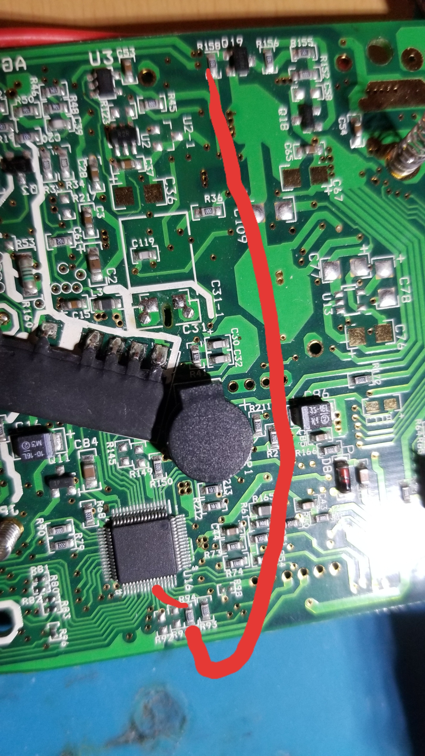

                              Sorry late, was busy, here is the measurement results
                              Q18 Pin1 0v pin2 3.2v pin3 3.5v
                              Q19 P1 3.2v p2 0.05v P3 0v
                              C86 0v
                              It looks like both q18 and q19 are PNP transistor. For q18 to turn on it needs to be pulled down by q19, and in turn q19 also need to be pulled down through 10k resistor connected to who knows what.
                              Here is the funny thing, the base of q19 was several mega ohm high, so whatever supposed to drive it is whether not responding, sleeping, or dead
                              Edit
                              Found the trace, that 10k resistor is driven by main ic.
                              See attached
                              Maybe the main UC is dead ? Or need reprogram ?
                              Either way, sad violin ......
                              Another meter bit the dust
                                Or the display is dead. When you turn the meter on, the display should run with all the segments on, then it goes in what ever measurement mode it is selected to.
                                So it could be the MCU, the EEPROM, the display controller or the LCD itself. It's a tough repair. All you can do is to probe the MCU to see if it is doing anything at all or not with and oscilloscope and go from there.
