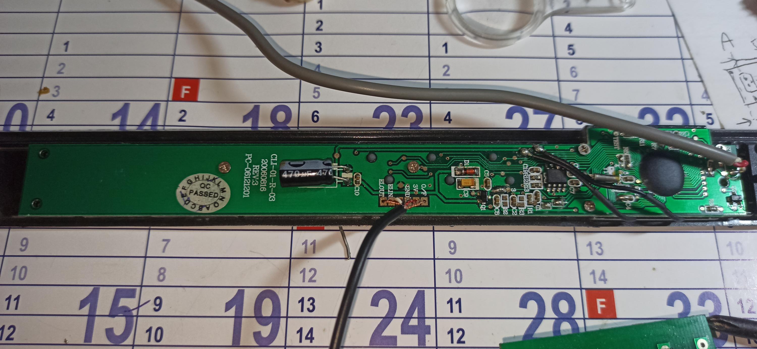

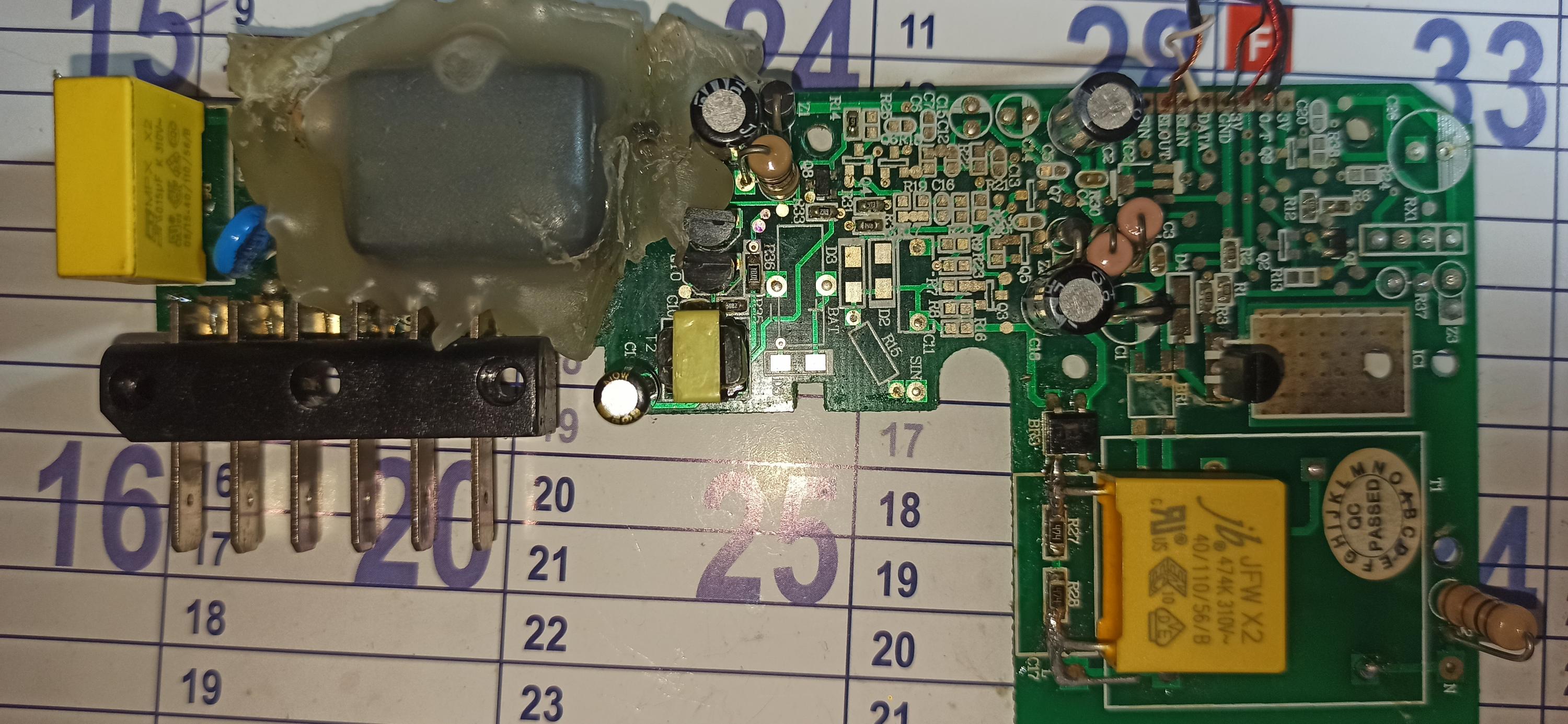

    Hy guys!
    Today Im posting a few photos from my electrical heater controller.
    The thing is that it turn on just right but as soon as the backlit comes in when I press the UP / DOWN temperature buttons the displays fades at such a point that the display fades completely progressively in 1-2 secons, its noticeable the display fading away, then the backlit stays really weak and the power LED goes out.
    Everything comes back to normal after a 10 seconds that is the time the backlit should remain ON while i change the temperature setting.
    Besides this, as long as I don't touch the temperature setting it works, I can see the temperature in the display (because the backlit is not turned ON).
    Below I attach a picture of the PCB from where you can see several capacitors, all JACKCON
    I've took one out, the 4.7uF 100V that is near the small yellow transformer (that feeds the backlit among other things) and it reads 4900nF , 10ohm for ESR and Vloss 4.5%.
    The value seems OK but im not sure about the ESR and the Vloss, I'm not a electronics expert but i would like to repair this unit, so i think I can count with your expertise by looking at the PCB photos and giving me some inputs, all are valid.
    I have several other electrical heaters becoming like this one: when the backlit kicks in the displays fades completely.

          Can we see some high res pictures?
          • R_J
            • Jun 2012
            • 9553
            Re: Electrical heater controler
            180 x 83 pixels is too small to be usefull

              ^^I uploaded the originals to the OP.

                  Sometimes supplies like these use a capacitive dropper: then the value of the yellow X class capacitors is very important (that it has not degraded in capacitance value).
                  I'm not sure if this is such a device, I do see a small transformer so maybe not, but won't hurt to chuck (as long as it is discharged lol)

                    Ok, Im going to remove both just now and will write the result right away:
                    Ok, both rated for 275V, one is 0.47uF, while testing gives me 259.7nF with 3.8ohm ESR. Almost half the capacitance it should have.
                    The other is a 0.15uF and reports 1005pF, no ESR value (strange...). The reading is wayyyy too low. Should i do some other testing to be sure? I've disconnected only one leg of the capacitors, discharged both and done the testing.

                          Yes you should change them both, and when you get the new ones test them on the meter:
                          Because it needs to be properly calibrated to be able to show values this low with confidence, so it will be a good test for the meter too

                            Ok, i've tested the ESR02. The new capacitor 4.7uF 50V is reading 4800nF, 4ohm for ESR and Vloss 3.5%. It's not perfect but better than the previous.
                            The new 0.15uF reports 145nF, no ESR value again and no Vloss. At least the capacitance is in the right range.
                            The 0.47uF testing gives me 480nF with 4.8ohm ESR, no Vloss value too.
                            Everything assembled and the unit worked properly!! But only for...20 seconds...
                            The back light was on, the power LED was on and I was changing the temperature setting with everything visible in the LCD, but all that stopped working in a few seconds and never came back again. Now I can't turn on the unit, no LED, noe LCD, no relay kicking in, nothing...
                            I've opened everything again but I can't see anything out of the place, i'm lost now..

                                Can you upload new straight shot high resolution pictures? Maybe we can see something where the smoke came out.
                                Check for DC voltage at the bridge rectifier next to the 0.47uF cap. Recheck the other cap for proper orientation. Check for open or higher in value resistors than spec. Bad diodes… etc.

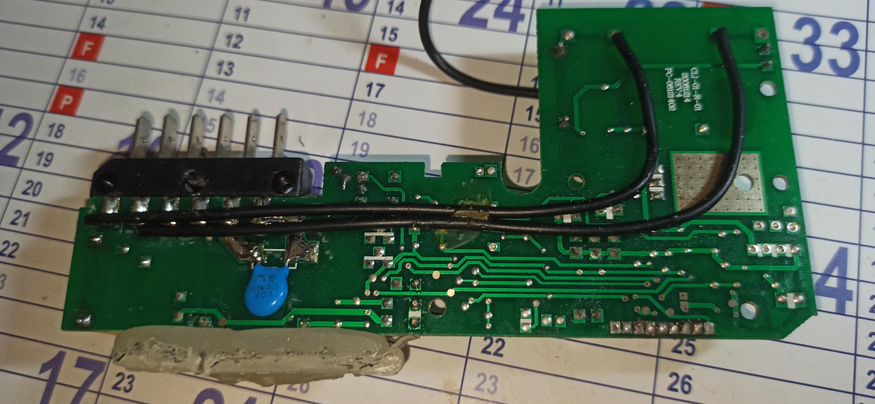

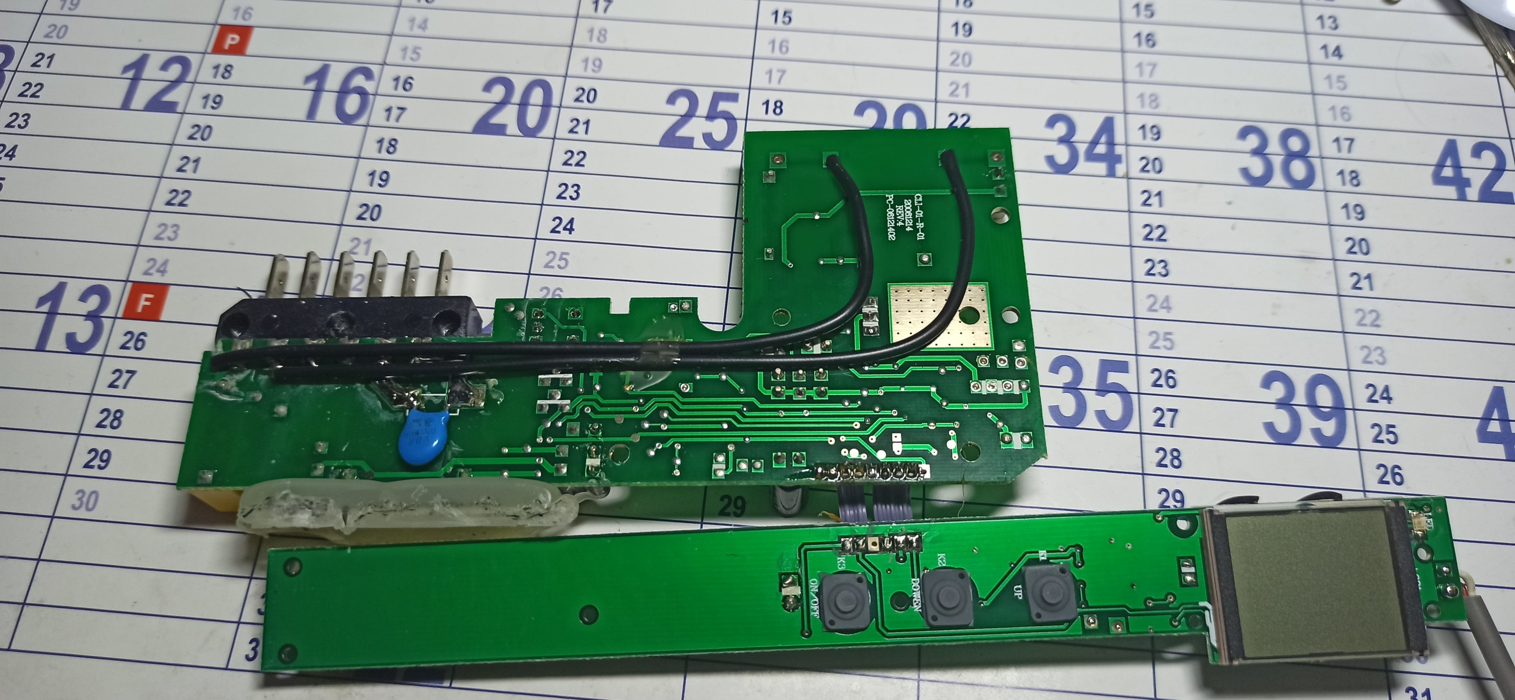

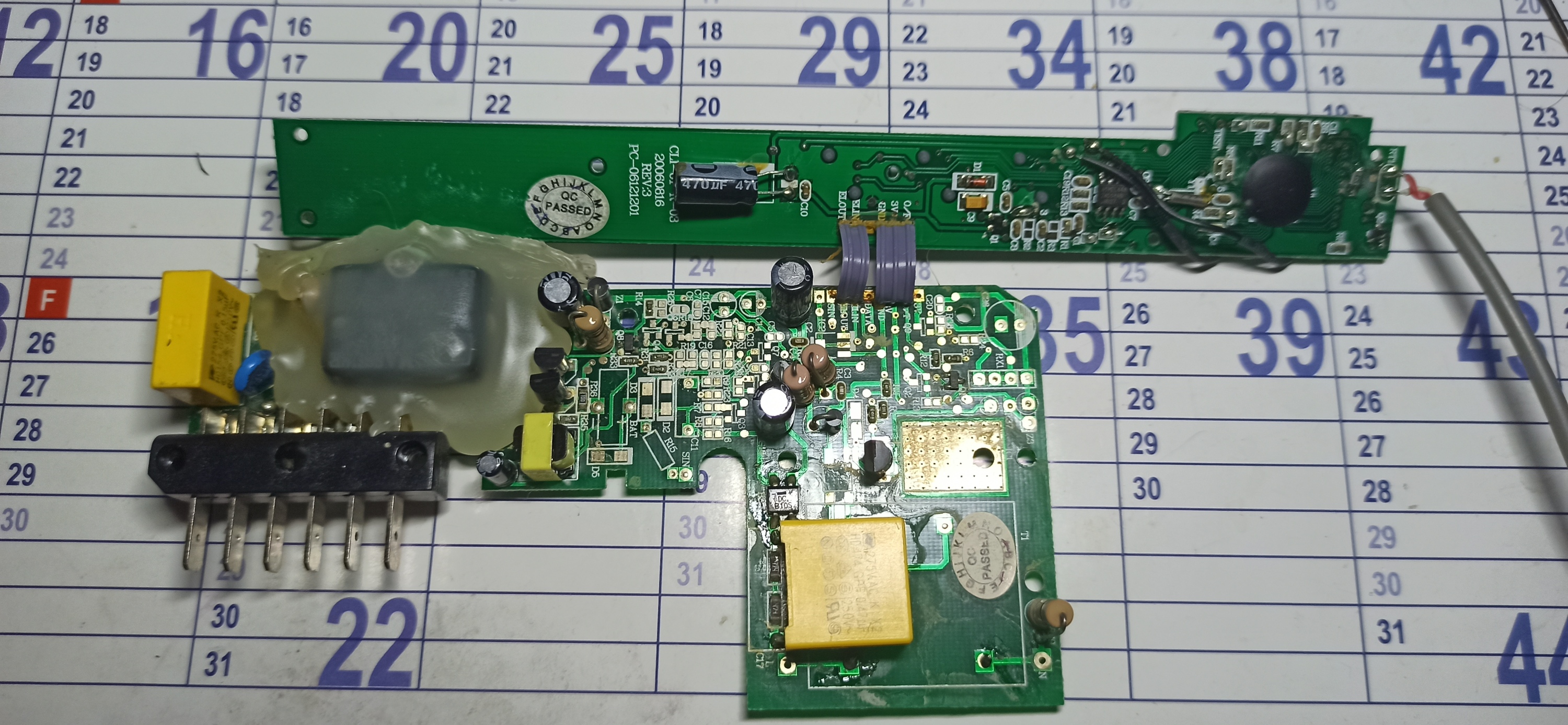

                                  Ok, i've uploaded the photos, I don't have any other camera then the phone so this is waht I can send. Searching around I can't see anything out of ordinary, nothing roasted, not even that typical smell is present.
                                  Some notes about the photos, I've rebuilt a track that i've destroyed near the polyester capacitor, but it was working before so the problem isn't there. Another thing is that the new polyester capacitor is 310instead of 275V if that matters.
                                  About the rectifier, I see there a BC B10S just after the polyester capacitor., is this a rectifier? This means something to you? Is the one near the right yellow capacitor.
                                  Ok, meanwhile I've been reading around and this BC B10S is a two in one diode, it rectifies the voltage from AC to DC, right? Instead of having two separated diodes doing that there is this BC B10S.
                                  Done some testing between the rectifier poles, the ESR02 gave be me a thing like: 2* >| (DIODE SYMBOL) \ 2 >| 3 >| 2 \ Uf= 2,23V 700mV
                                  On the other "channel" gave me 2* >| (DIODE SYMBOL) \ 2 >| 3 >| 2 \ Uf= 700mV 2,23V

                                    I don't know where the "BC B10S" you're working with is on your board.
                                    I can see a BR3 designator on the PCB and that's a bridge rectifier that should contain 4 diodes. Having 4 pins I'm not sure how you got it into a 3-pin avr transistor tester?
                                    Hmm...capacitor dropper psu...

                                      B10S must be the numbers on the bridge rectifier BR3, this bridge contains four (4) diodes.

                                        Well, I've tested it, i've connected the 220V on the line of the PCB and measured the output on the B10S. There is 2.4V, i think its working properly.
                                        Meanwhile I've detected a pin without proper grounding, the wire that connects there is not conducting properly, I'm going to change this wire and test again everything, i'll keep you guys posted
