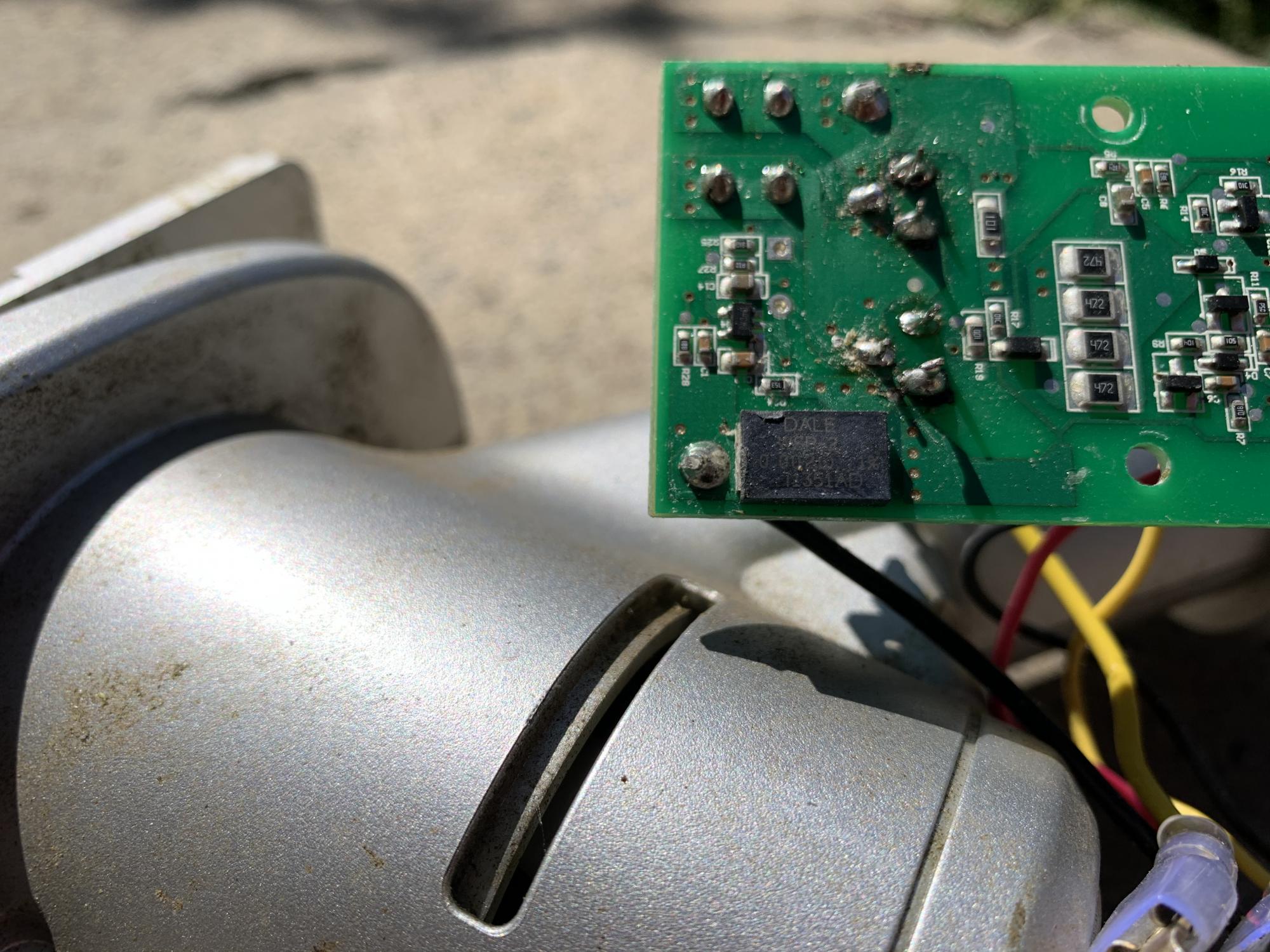

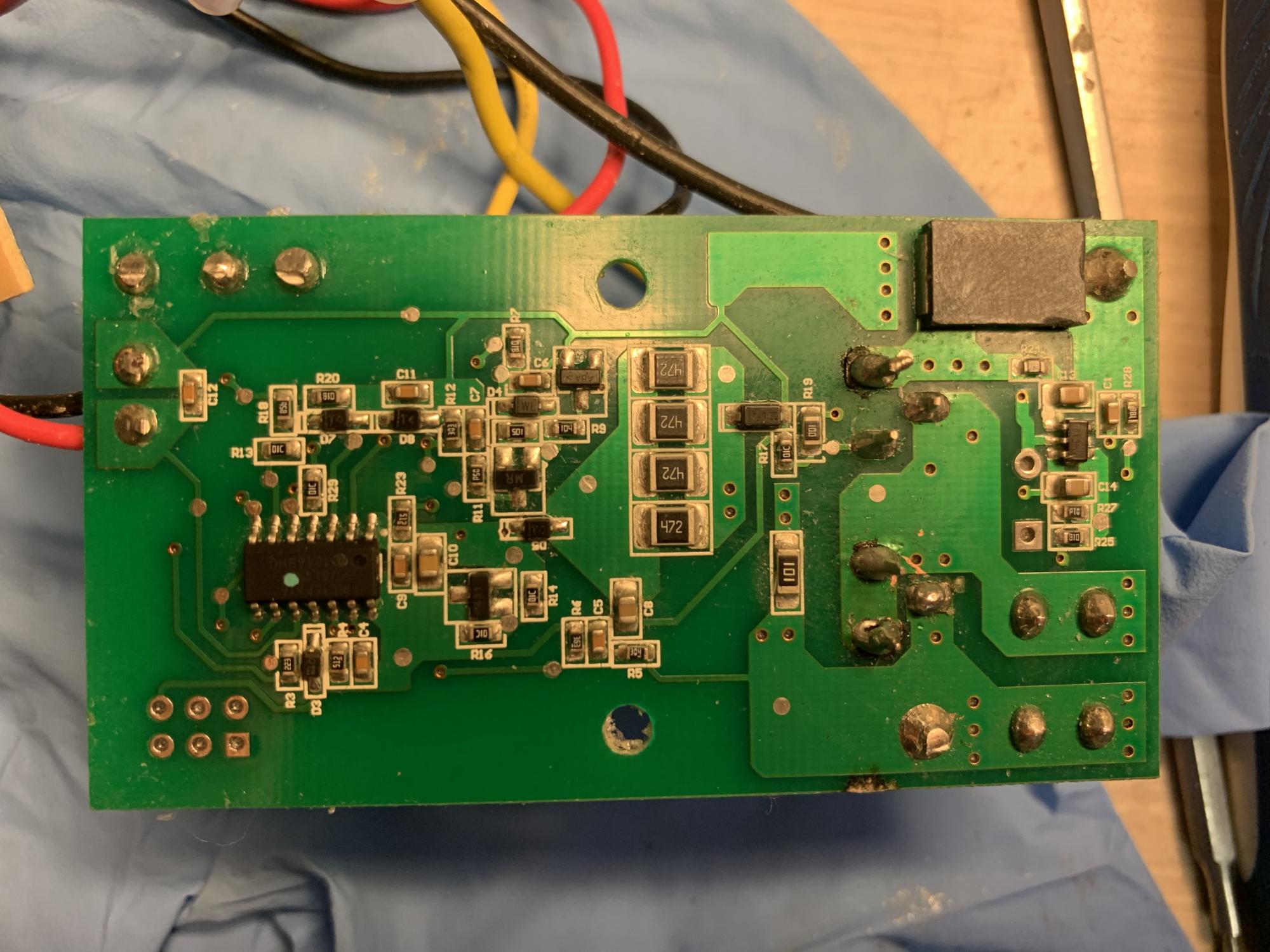

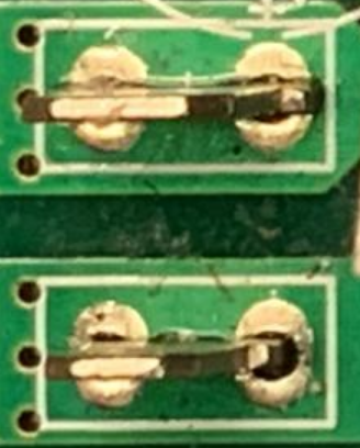

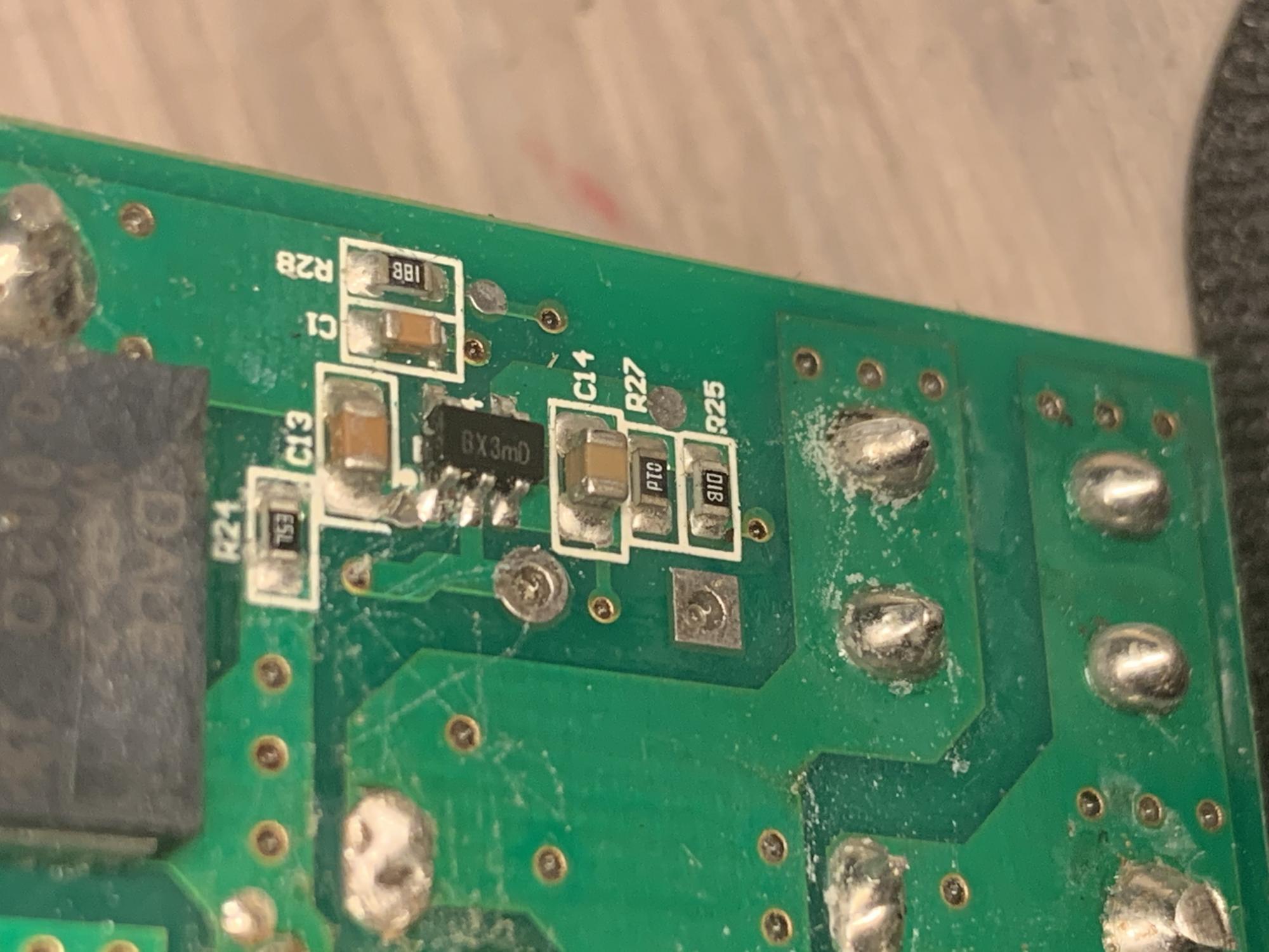

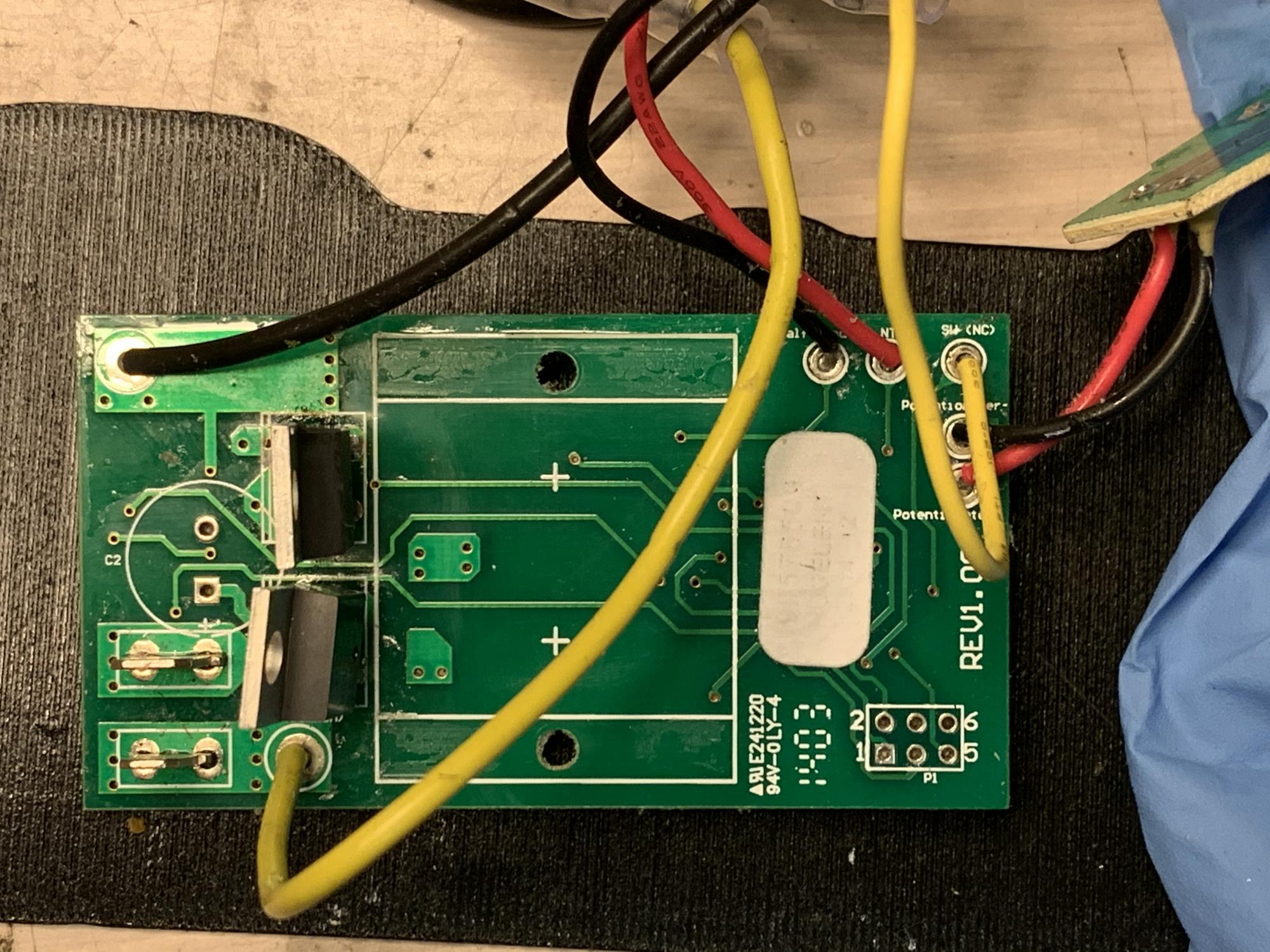

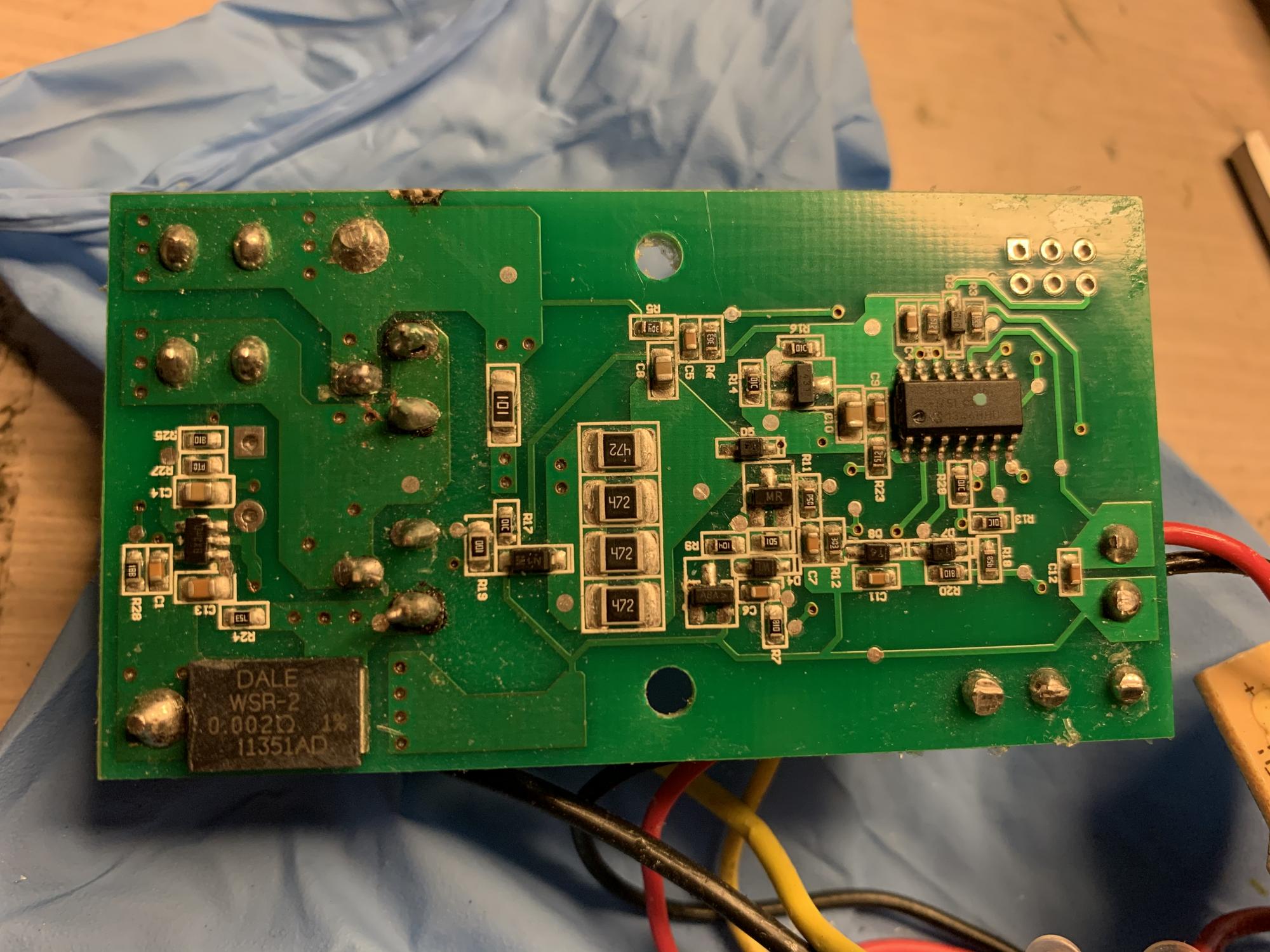

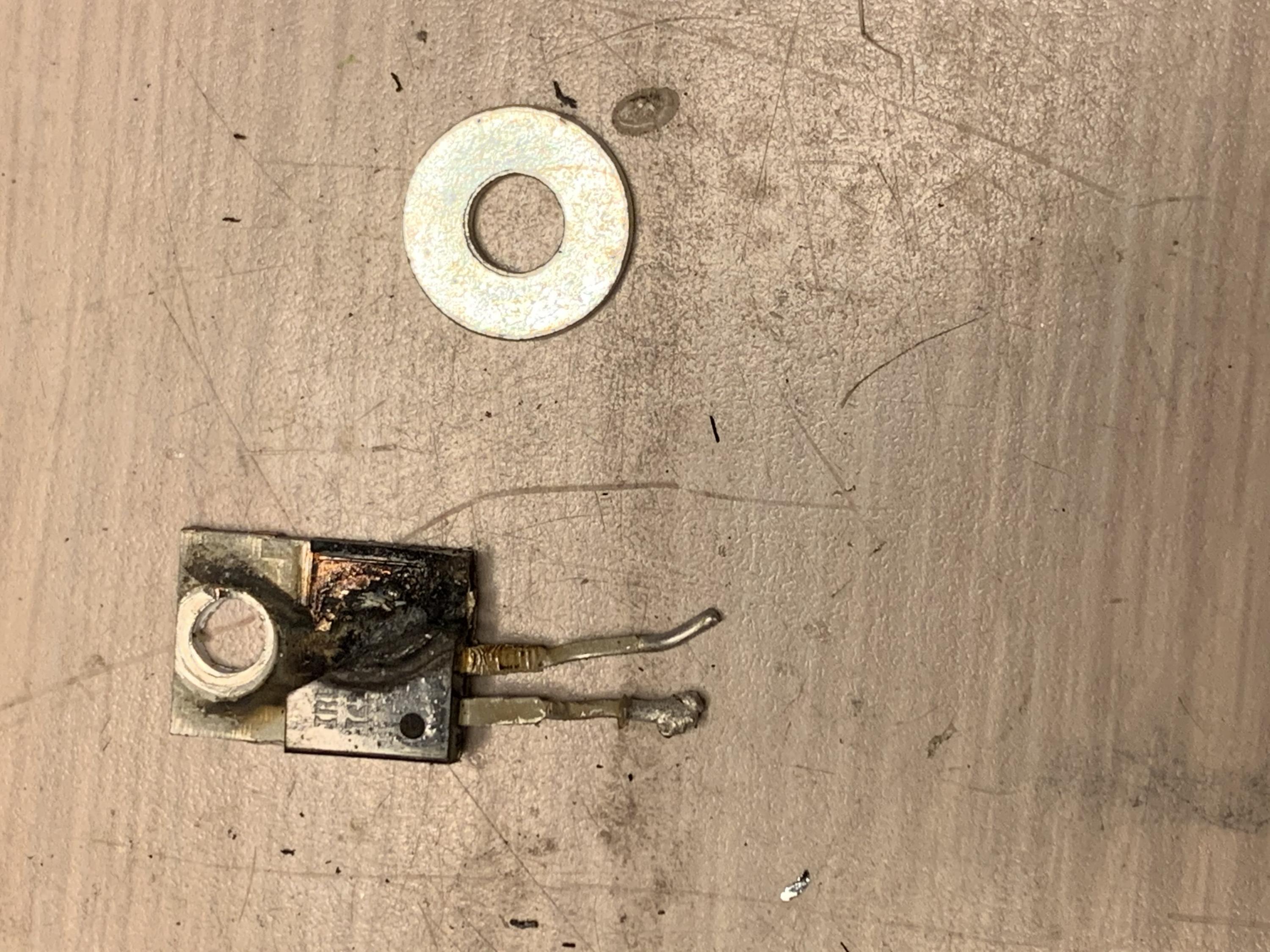

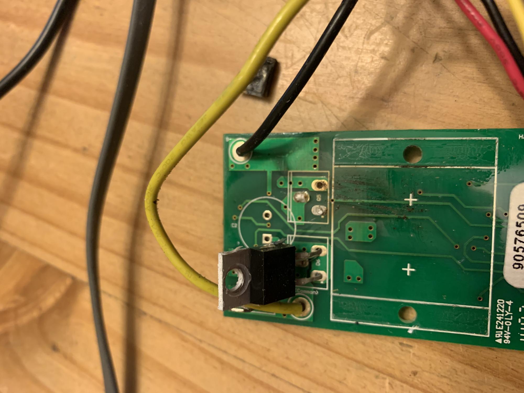

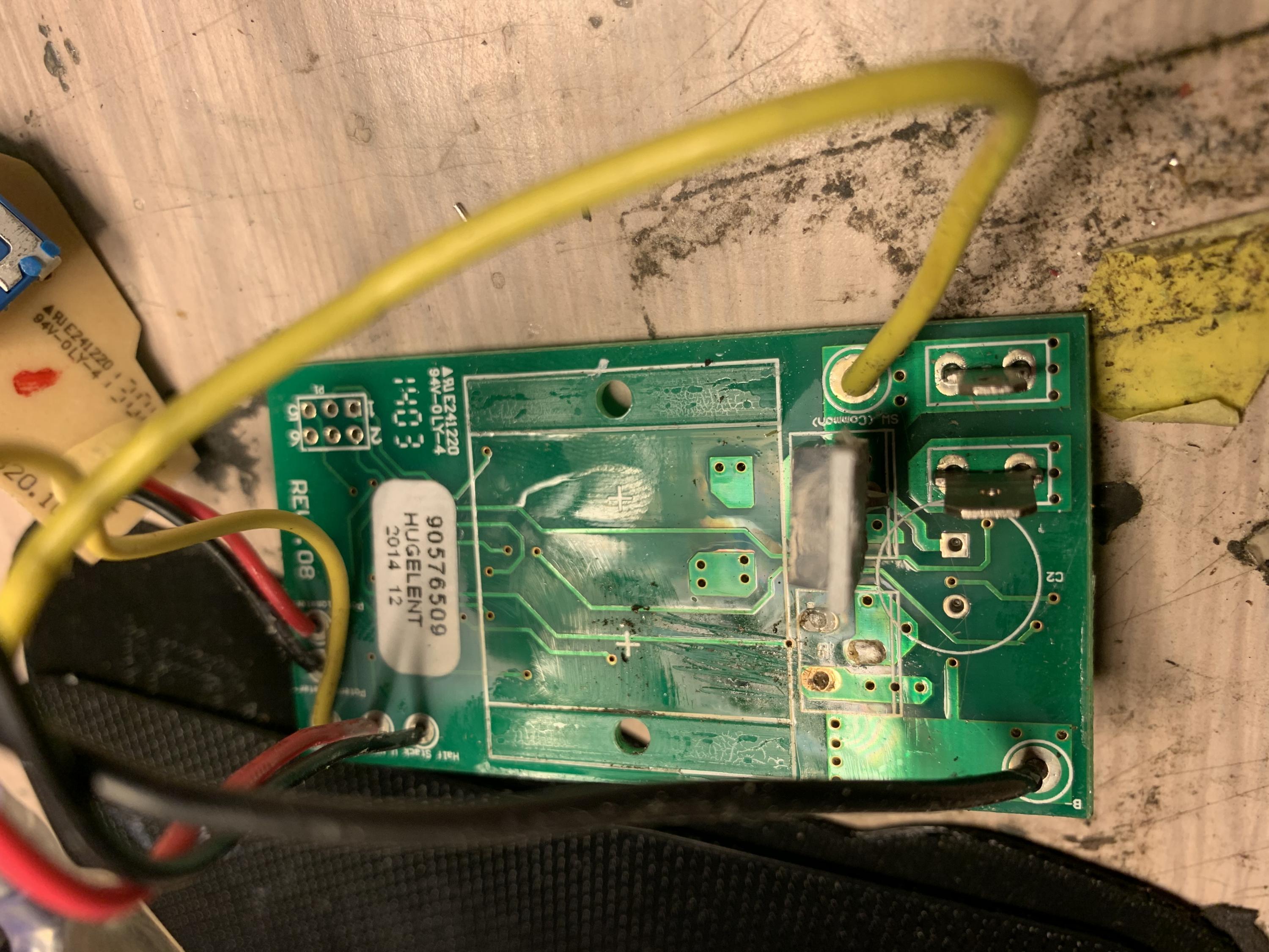

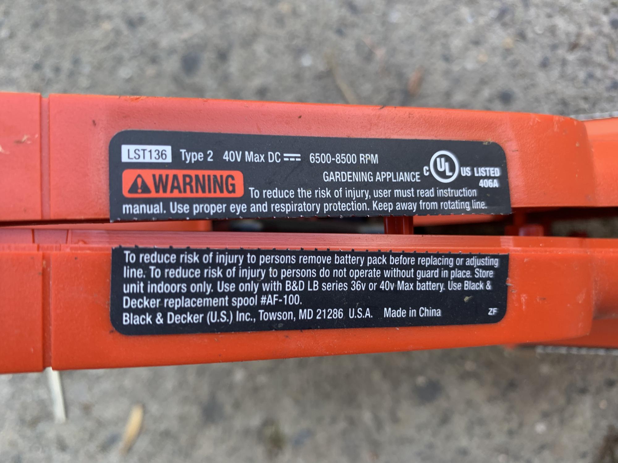

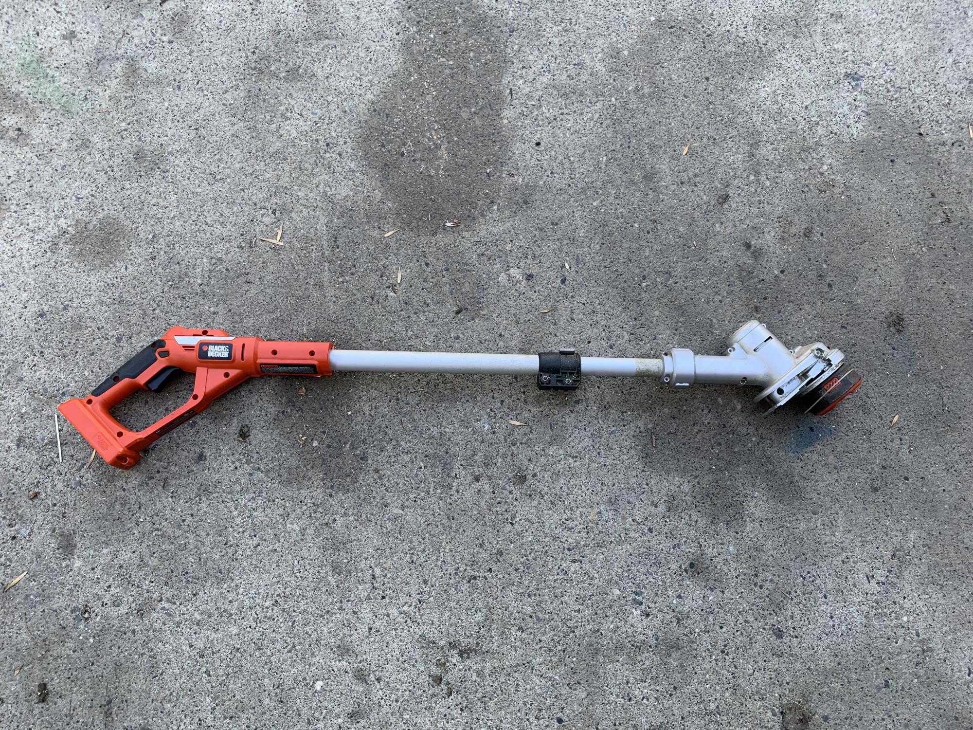

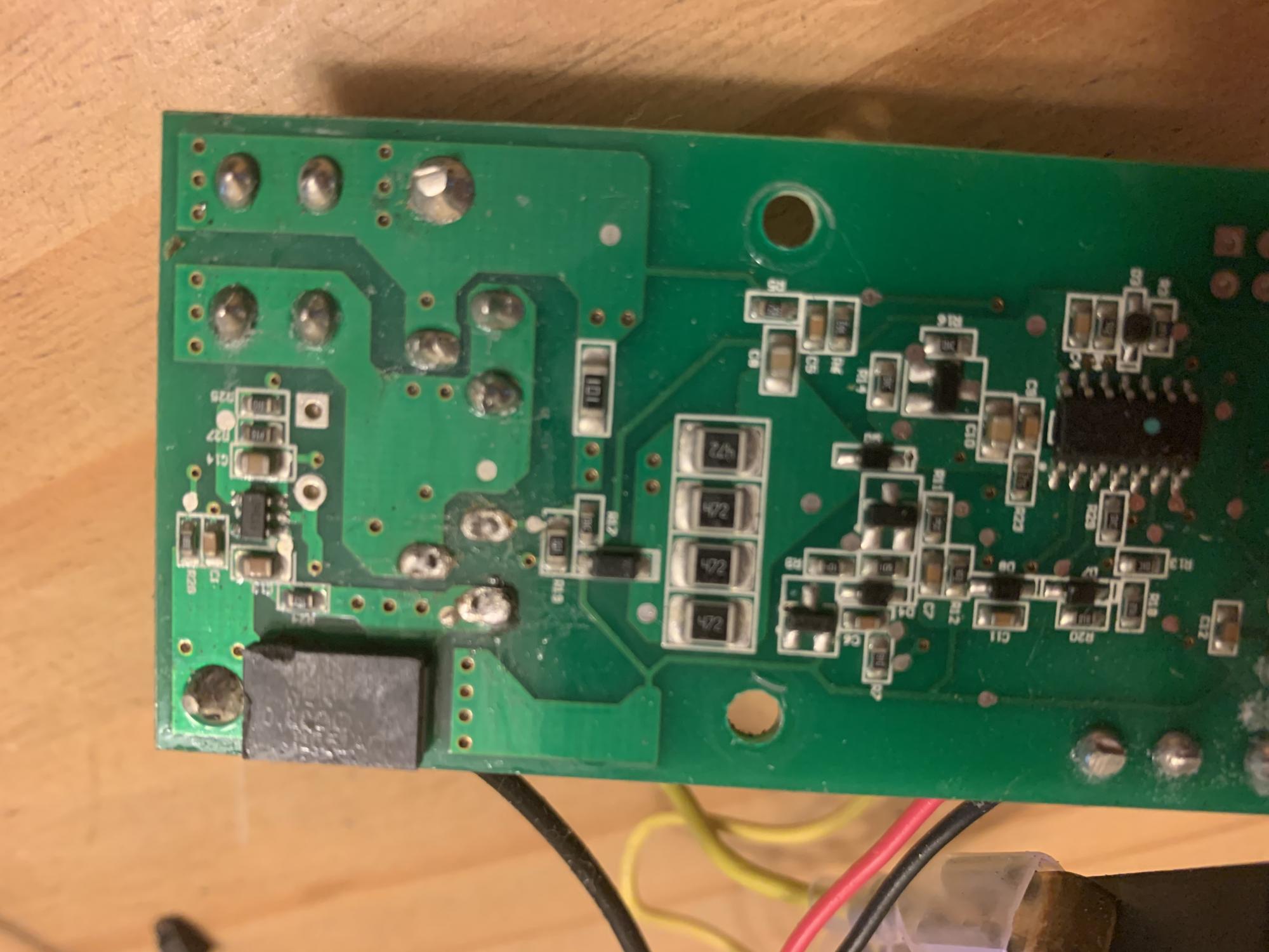

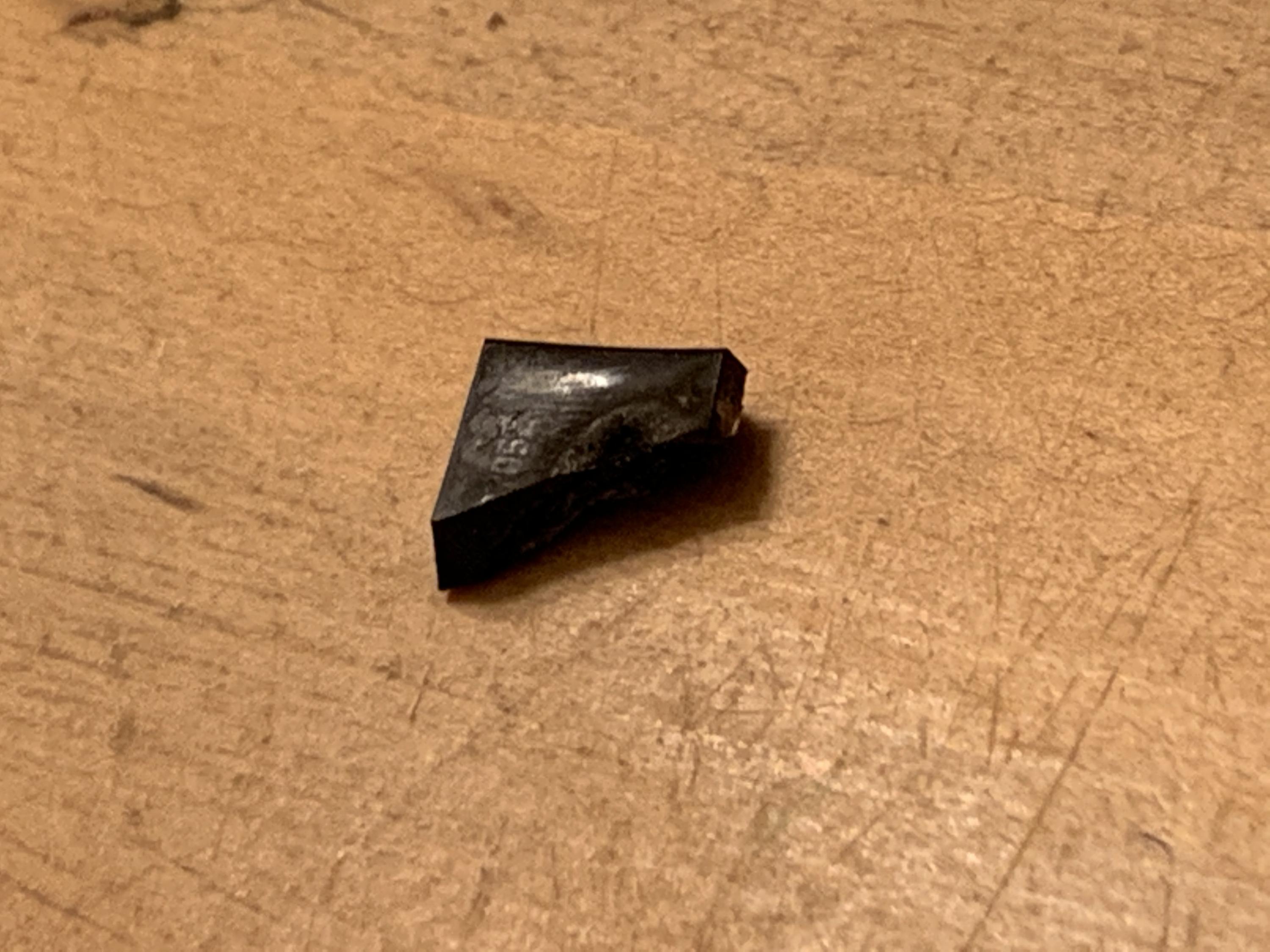

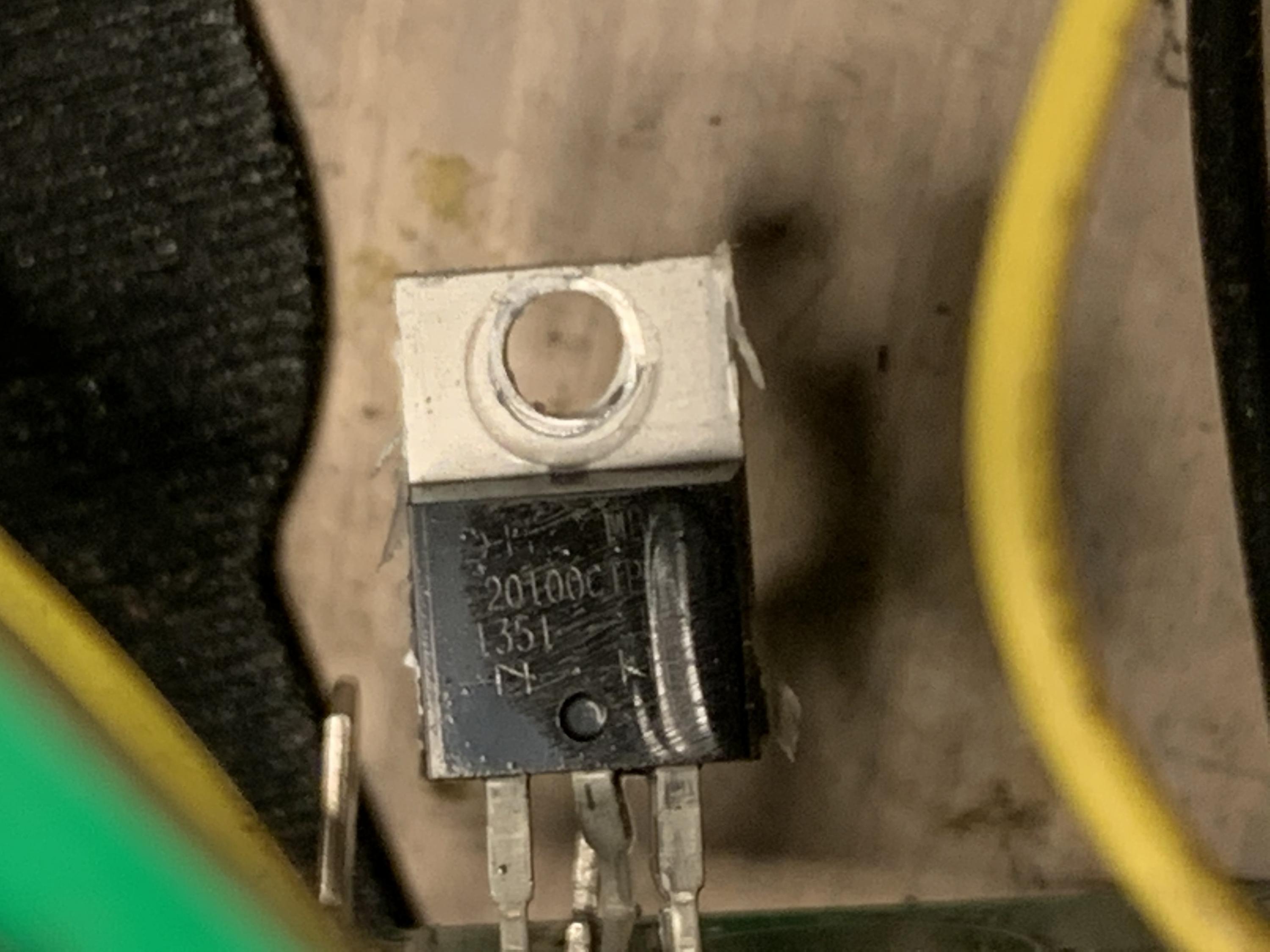

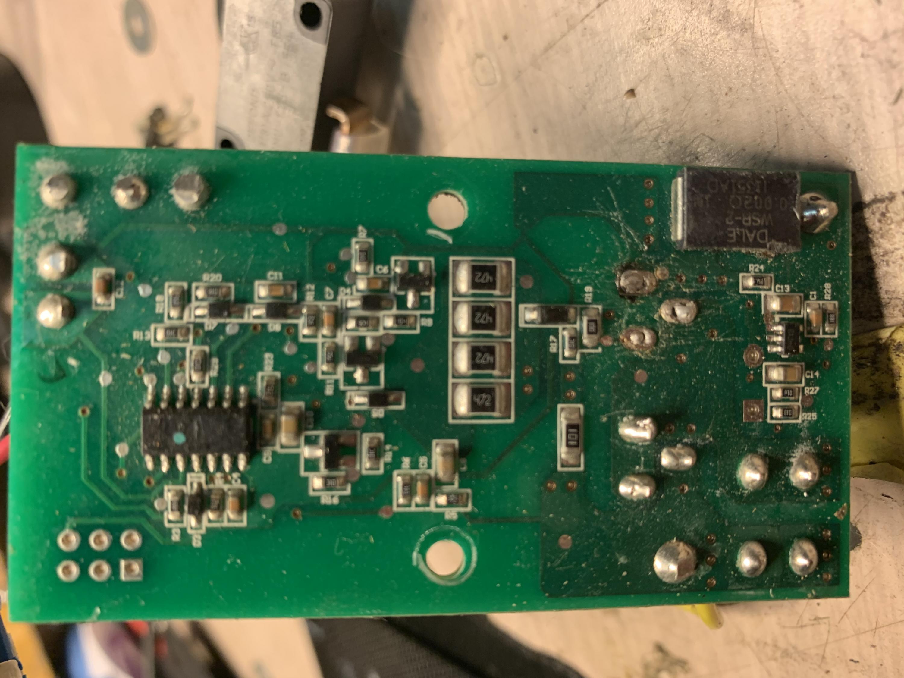

Black and Decker 40V Lithium weed trimmer PCB board damage
  • braxton
    • Nov 2009
    • 146
    Black and Decker 40V Lithium weed trimmer PCB board damage
    I have a Dewalt / Black and Decker 40V trimmer model LST136 Type-1.
    It stopped working. Trimmer motor tests fine. I opened it up to find that the controller board had a blown component at position Q5. It also looks like a similar component at D6 has a bulging area. These two mosfets? are attached to a heat sink. The D6 component looks to be a MBR20100CTP rectifier. The Q5 component blew apart, so its difficult to read the label. I am hoping to get help identifying the Q5 component. Pictures are attached.
    In the photos, the heatsink and the Q5 component have already been removed from the board. One of the three legs broke off of the Q5 component.
    The last 2 pics are of the component I need help identifying.
    Last edited by braxton; 08-10-2021, 09:01 AM. Reason: corrections and additions
    • 31258
    Re: Black and Decker 40V Lithium weed trimmer PCB board damage
    100v is too low for a schottky diode - 250v atleast.
    ideally 10x the running voltage!
    • braxton
      • Nov 2009
      • 146
      Re: Black and Decker 40V Lithium weed trimmer PCB board damage
      Originally posted by stj
      100v is too low for a schottky diode - 250v atleast.
      ideally 10x the running voltage!
      Thanks. I will keep that in mind when ordering the D6 component.
      Any idea what Q5 is?
      I am attaching two more photos of the board
      Last edited by braxton; 08-10-2021, 09:21 AM.
        • Jul 2011
        • 6070
        Re: Black and Decker 40V Lithium weed trimmer PCB board damage
        Be careful with protection boards when repairing them make sure that the battery are not fully charged if necessary run them down to 3.2 volt and be ready to remove it from the tool or the charger if something goes horrible wrong
        I have repair Ryobi battery packs sometimes you can repair them sometimes not
        • SluggerB
          • Aug 2020
          • 747
          • US
          Re: Black and Decker 40V Lithium weed trimmer PCB board damage
          Originally posted by braxton
          Thanks. I will keep that in mind when ordering the D6 component.
          Any idea what Q5 is?
          I am attaching two more photos of the board
          Try and find someone who owns one (or buy a new one), open it up, identify the part, and then return it?
            • Jul 2011
            • 6070
            Re: Black and Decker 40V Lithium weed trimmer PCB board damage
            I just noticed that this battery pack is 40 volts which I do not have
            Just be aware of this if this is an older battery pack the controller board of a new one might not be the same as one you have
            Last edited by sam_sam_sam; 08-12-2021, 08:24 AM.
            • braxton
              • Nov 2009
              • 146
              Re: Black and Decker 40V Lithium weed trimmer PCB board damage
              Here are photos of the trimmer with the model number.
              The board is from inside the handle part.
              The board is not from the battery itself.
              Last edited by braxton; 08-12-2021, 08:52 AM. Reason: Addition
              • braxton
                • Nov 2009
                • 146
                Re: Black and Decker 40V Lithium weed trimmer PCB board damage
                Based on a closer look at the blown chip, it looks like it is an Infineon IRL3705Z mosfet.
                Digikey lists it as obsolete.
                Can anyone help out finding this part or an equivalent?
                Thanks.
                • R_J
                  • Jun 2012
                  • 9607
                  Re: Black and Decker 40V Lithium weed trimmer PCB board damage
                  Originally posted by braxton
                  Based on a closer look at the blown chip, it looks like it is an Infineon IRL3705Z mosfet.
                  Digikey lists it as obsolete.
                  Can anyone help out finding this part or an equivalent?
                  Thanks.
                  If that is the correct mosfet...
                  Digikey IRL3705ZPBF-ND direct replacement, in stock
                  • braxton
                    • Nov 2009
                    • 146
                    Re: Black and Decker 40V Lithium weed trimmer PCB board damage
                    Originally posted by R_J
                    If that is the correct mosfet...
                    Digikey IRL3705ZPBF-ND direct replacement, in stock
                    Thanks!
                    Ordered a few of those and the MBR20200CTP (200V instead of 100V)
                    Hopefully that will get the trimmer working again...
                    • R_J
                      • Jun 2012
                      • 9607
                      Re: Black and Decker 40V Lithium weed trimmer PCB board damage
                      Check the gate drive circuit resistor (R24) to make sure it is not open, When the mosfet shorted, many times it also takes out the drive ic, that sot23-5, best to get it's number before it is also unreadable.
                        • Jul 2011
                        • 6070
                        Re: Black and Decker 40V Lithium weed trimmer PCB board damage
                        This means that the charger has the protection board and the battery has no protection board might not even have a protection fuse in it
                        When you test this board be careful and be ready to disconnect the battery very quickly if something goes horrible wrong
                        • braxton
                          • Nov 2009
                          • 146
                          Re: Black and Decker 40V Lithium weed trimmer PCB board damage
                          Originally posted by R_J
                          Check the gate drive circuit resistor (R24) to make sure it is not open, When the mosfet shorted, many times it also takes out the drive ic, that sot23-5, best to get it's number before it is also unreadable.
                          R24 resistor has 753 written on it and tests at 75.5 Kohm
                          • braxton
                            • Nov 2009
                            • 146
                            Re: Black and Decker 40V Lithium weed trimmer PCB board damage
                            Originally posted by R_J
                            Check the gate drive circuit resistor (R24) to make sure it is not open, When the mosfet shorted, many times it also takes out the drive ic, that sot23-5, best to get it's number before it is also unreadable.
                            The sot23-5 chip is hard to read but it looks like GX3mD maybe?
                            • braxton
                              • Nov 2009
                              • 146
                              Re: Black and Decker 40V Lithium weed trimmer PCB board damage
                              Replacing the 2 chips had no effect. Still dead.
                              What about this component (largest chip in the corner) in the attached photo?
                              Last edited by braxton; 08-13-2021, 05:43 PM.
                                • 31258
                                Re: Black and Decker 40V Lithium weed trimmer PCB board damage
                                the "dale" part is a resistor - it should look like a short circuit.
                                clean the board with alcahol - it's hard to see the parts clearly.
                                • R_J
                                  • Jun 2012
                                  • 9607
                                  Re: Black and Decker 40V Lithium weed trimmer PCB board damage
                                  After a closer look R24 is likely the resistor between the mosfet source pin (Dale resistor) and the CS pin of the ic, and not the gate drive resistor. Check that the resistors between the gate and the ic are ok.
                                  Last edited by R_J; 08-13-2021, 10:21 PM.
                                  • braxton
                                    • Nov 2009
                                    • 146
                                    Re: Black and Decker 40V Lithium weed trimmer PCB board damage
                                    Originally posted by R_J
                                    After a closer look R24 is likely the resistor between the mosfet source pin (Dale resistor) and the CS pin of the ic, and not the gate drive resistor. Check that the resistors between the gate and the ic are ok.
                                    I tried to take better photos of the board.
                                    I also measured all of the resistors on the board and all seem to give an ohms reading (Highest was 100K and none seem to be open as far as I can tell).
                                    • petehall347
                                      • Jan 2015
                                      • 4445
                                      • United Kingdom
                                      Re: Black and Decker 40V Lithium weed trimmer PCB board damage
                                      what about these solder joints ?
                                        • Jul 2011
                                        • 6070
                                        Re: Black and Decker 40V Lithium weed trimmer PCB board damage
                                        what about these solder joints ?
                                        I agree with you that these connections do not look very good
                                        • m1ch43lzm
                                          by m1ch43lzm
                                          05-12-2025, 08:37 PM
                                        • rounin
                                          MacBook Pro A2442 (Board No. 820-02443-05) – Liquid Damage Repair Assistance
                                          by rounin
                                          Device Information
                                          • Model: MacBook Pro 14” M1 Pro (A2442)
                                          • Logic board number: 820-02443-05
                                          Original Issue
                                          The device suffered liquid damage, causing a short circuit on the logic board.
                                          Near the audio jack area, the CR852 capacitor pad was severely burned, creating a clear short-circuit path. The board could not power on properly.
                                          Work Performed
                                          Removed the short circuit by drilling through the board (bypassing the short path) in the CR852 area.
                                          Current Status
                                          • When powered on, the screen shows support.apple.com/mac/restore....
                                          10-20-2025, 11:15 PM
                                        • howardc64
                                          by howardc64
                                          07-24-2025, 05:17 PM
                                        • howardc64
                                          by howardc64
                                          Problem
                                          08-04-2024, 10:36 PM
