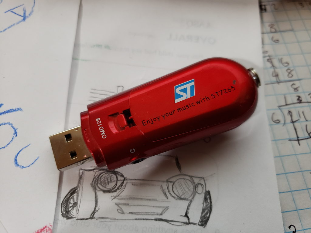

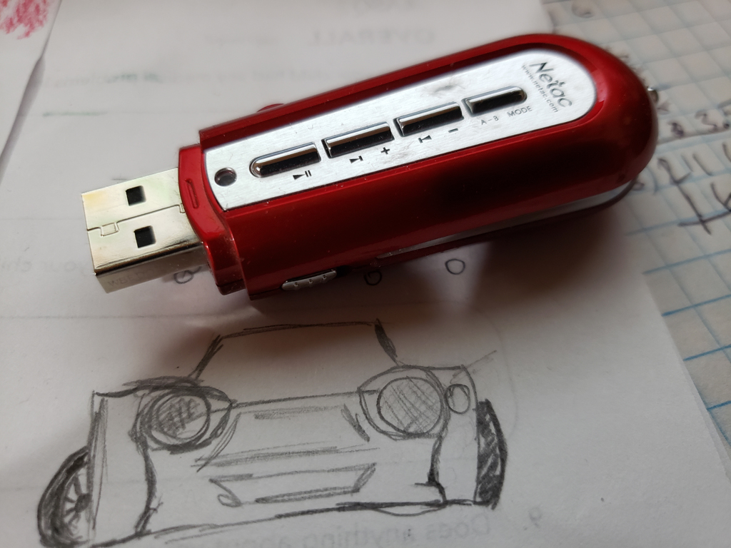

    Obscure Netac OMD128
    If I recall correctly, I acquired this at a surplus place in my area. I'm trying to figure out what sort of battery it takes. There's a Chinese site that mentions something about 1.2V, but doesn't really explain the battery. I can see it as a USB stick in that it has storage, but the portion, which plays music must be completely, separate internally as it doesn't speak to the computer as a device.
    http://detail.zol.com.cn/46/45854/param.shtml
    Anyone remember these?

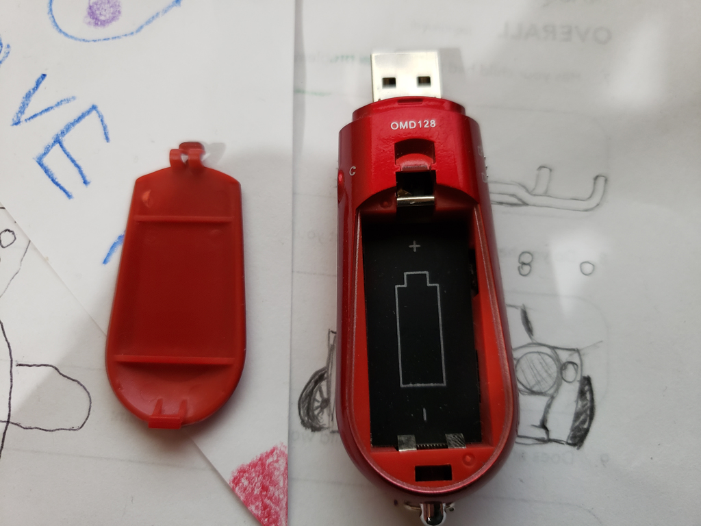

    i remember a version of those with an lcd.
    it should use an AA cell.
    try holding down different buttons as you plug it in - btw i think you play mp3's from the memory your seeing and the firmware is on a hidden partition.

      The thing is, the battery compartment is larger than a single cell as if it took a proprietary battery. And why the dual contacts at the bottom? I'll put a cell in a picture for comparison sake, when I get home.

        are the 2 contacts connected??

          That's a good question! I'll check.

            gumstick battery 1.2V, 550mAh, NiMH 6x17x35mm

              i remember them too... mine had a single AA in it. But his is different. Can't see the voltage being more than 1.5v...

                Ah! That could very well be it. Thank you! I'll order one up and give it a shot. I actually, have a nimh charger, too.
