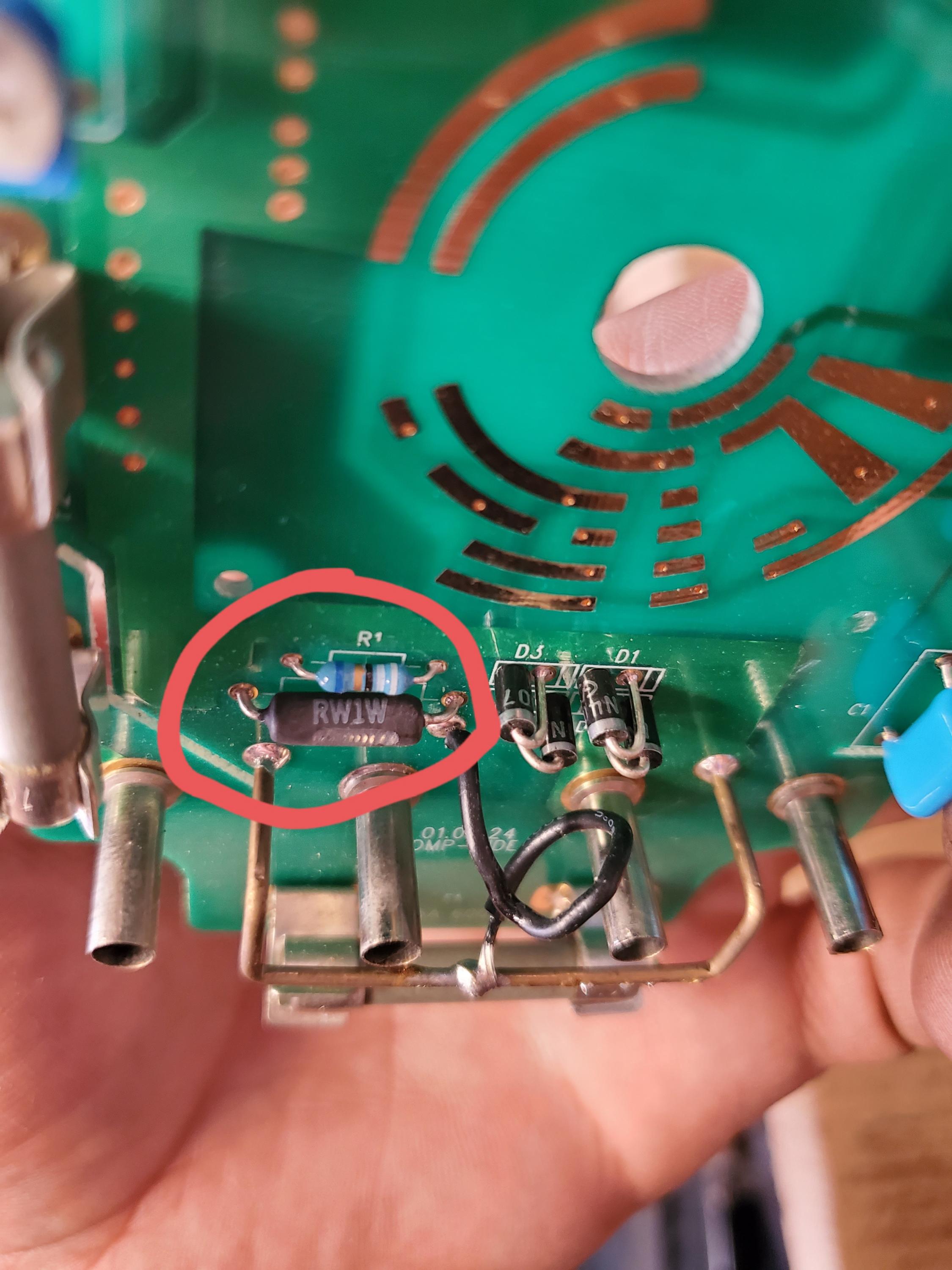

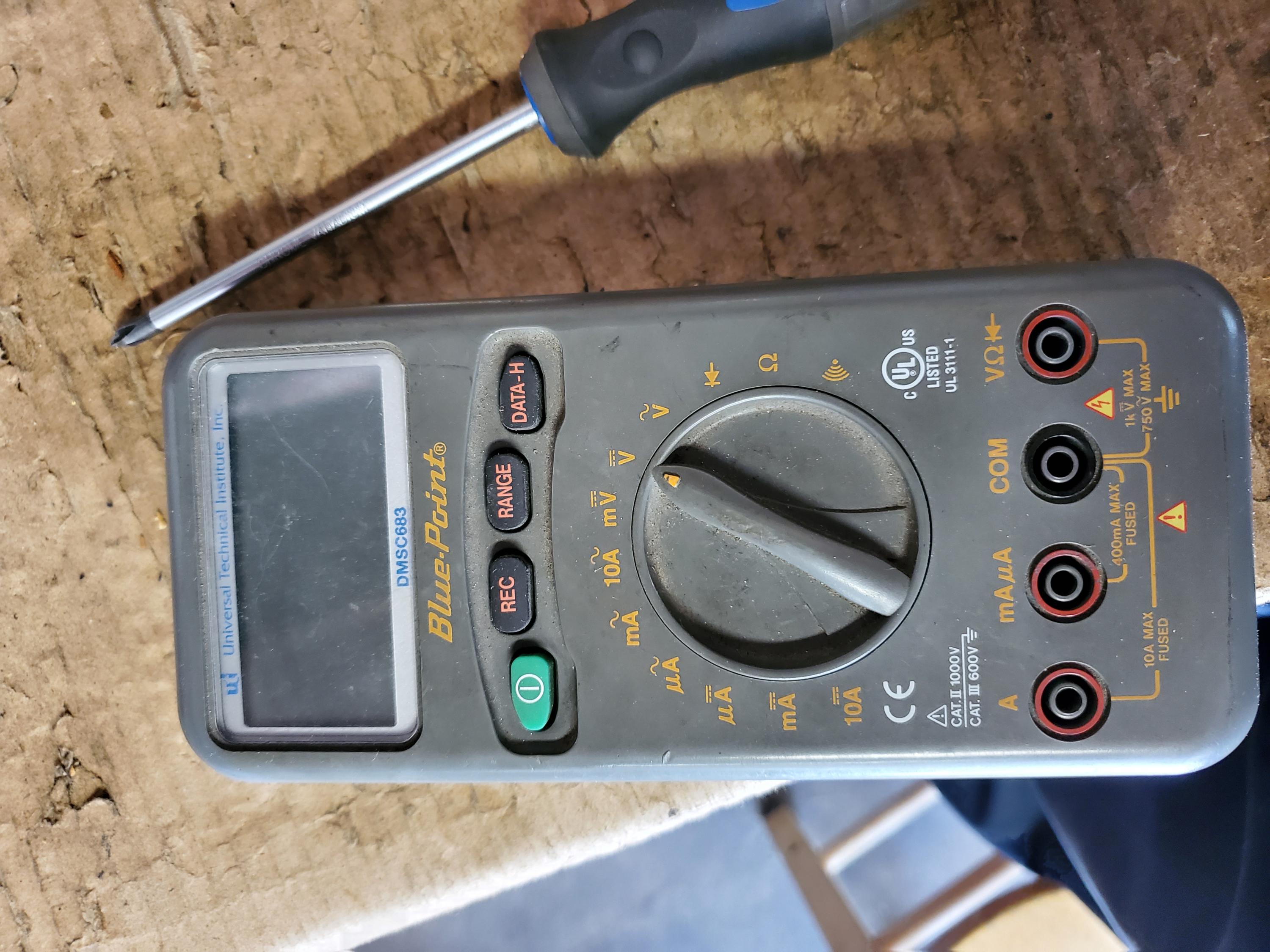

    i have a bluepoint digital volt meter that does not turn on unless i hit it or shake it.
    If i shake itnor place it down hard it will shut off

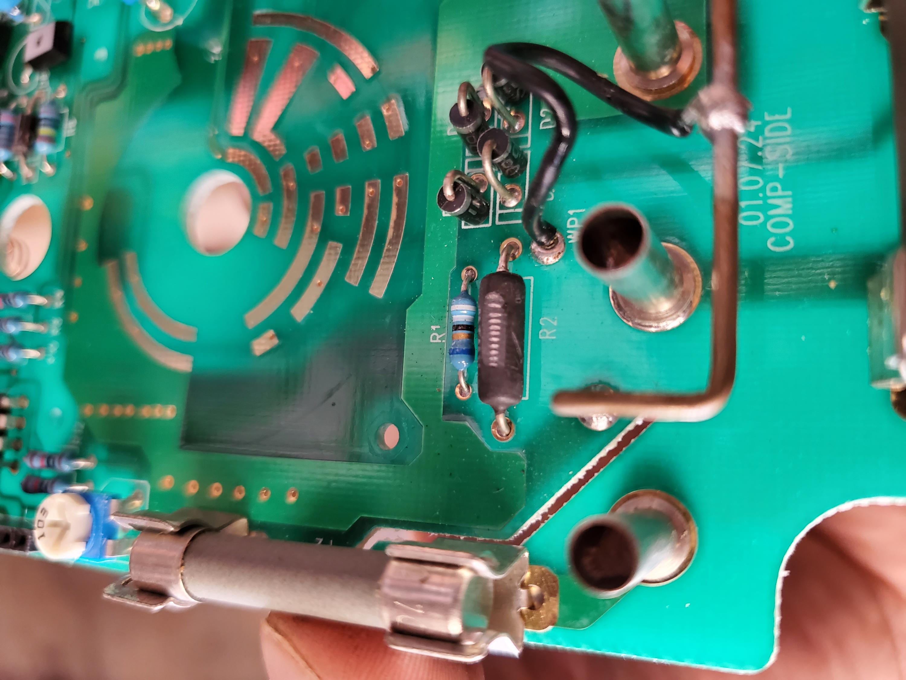

    I opened it and noticed a component has some odd wear on it
    I tried looking it up on digikey but it doesnt show up
    Can someone help me identify the component?
    Hopefully this will fix the issue
    • 31294
    Re: DVOM dmsc683 turns on and off when i shake or bump it
    what's above it in the case?
    either way, it's not the problem - clean the rotary switch contacts with alcahol and check the power switch - those small switches are the same type they used to use on pc cases and arent great
    the other thing to check is your battery clip and wires
