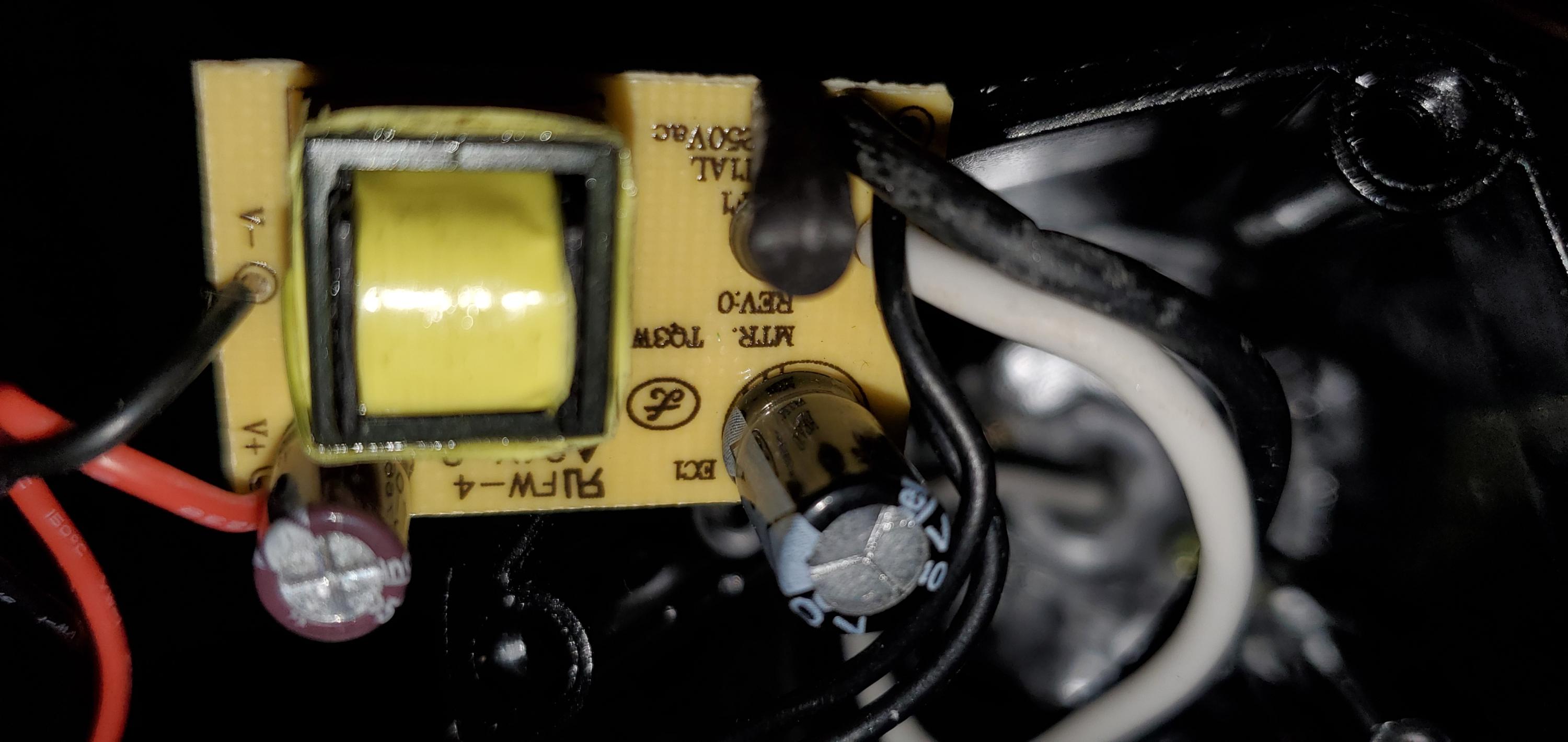

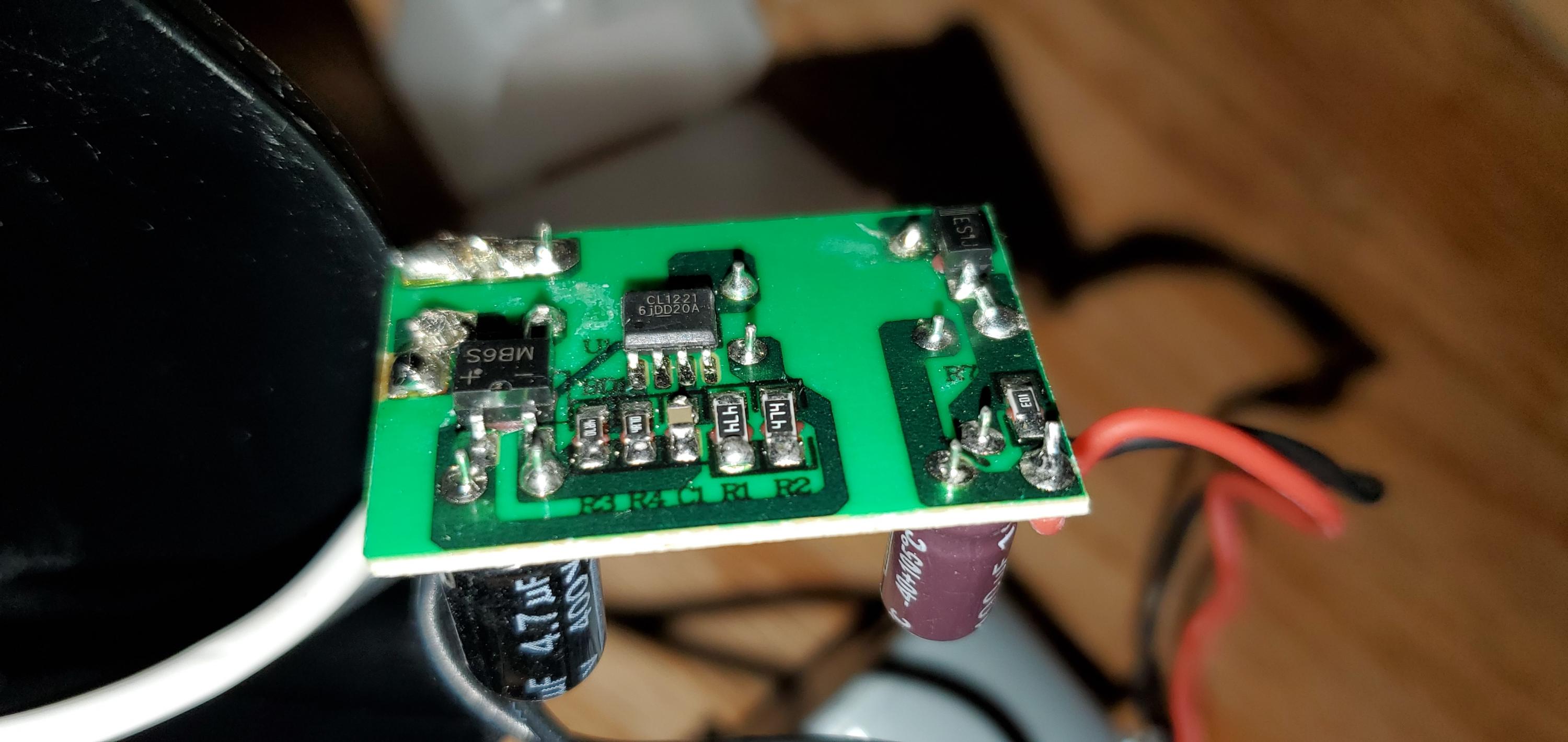

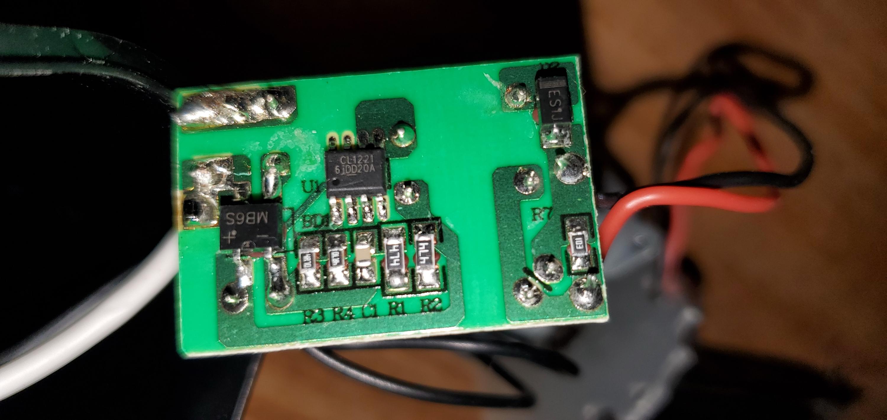

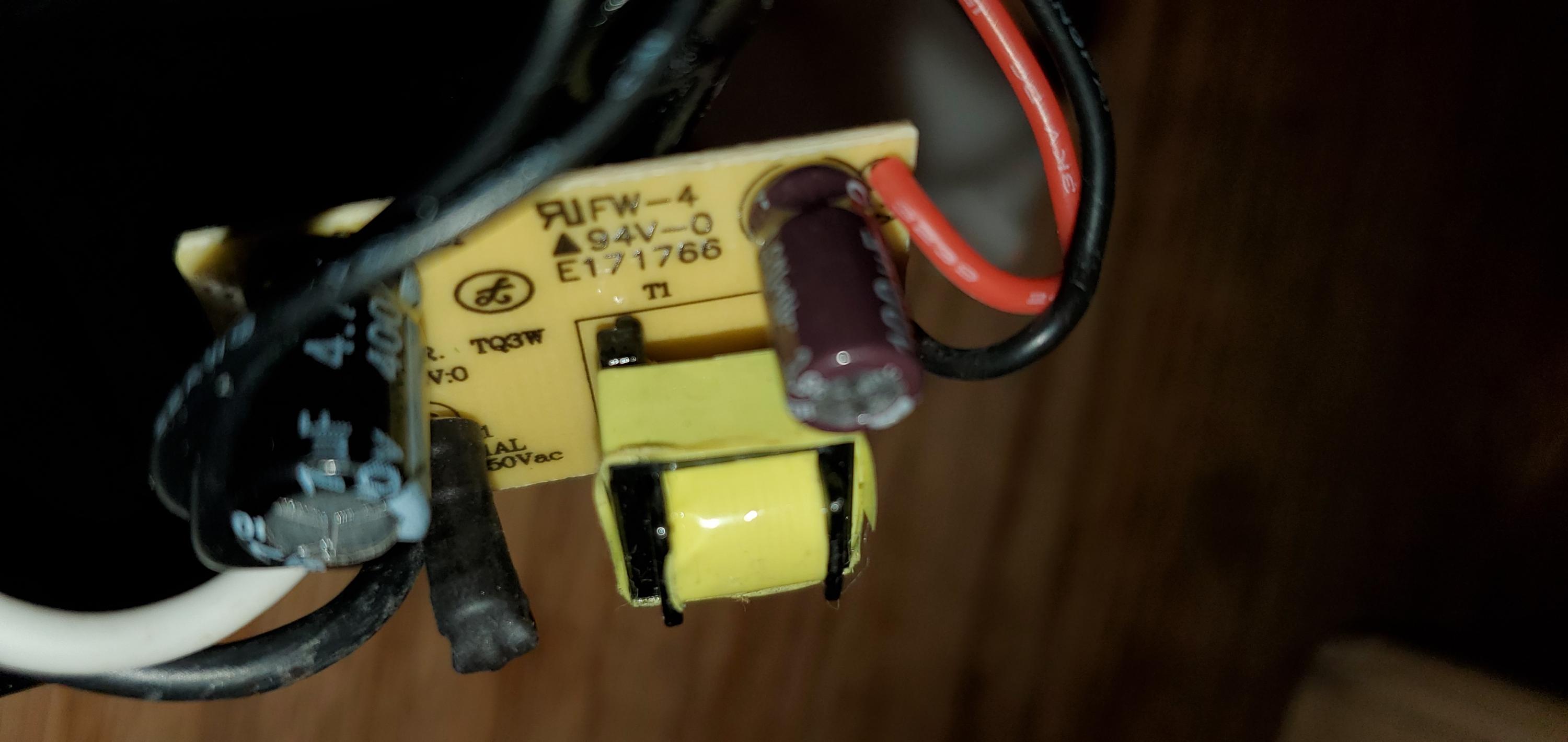

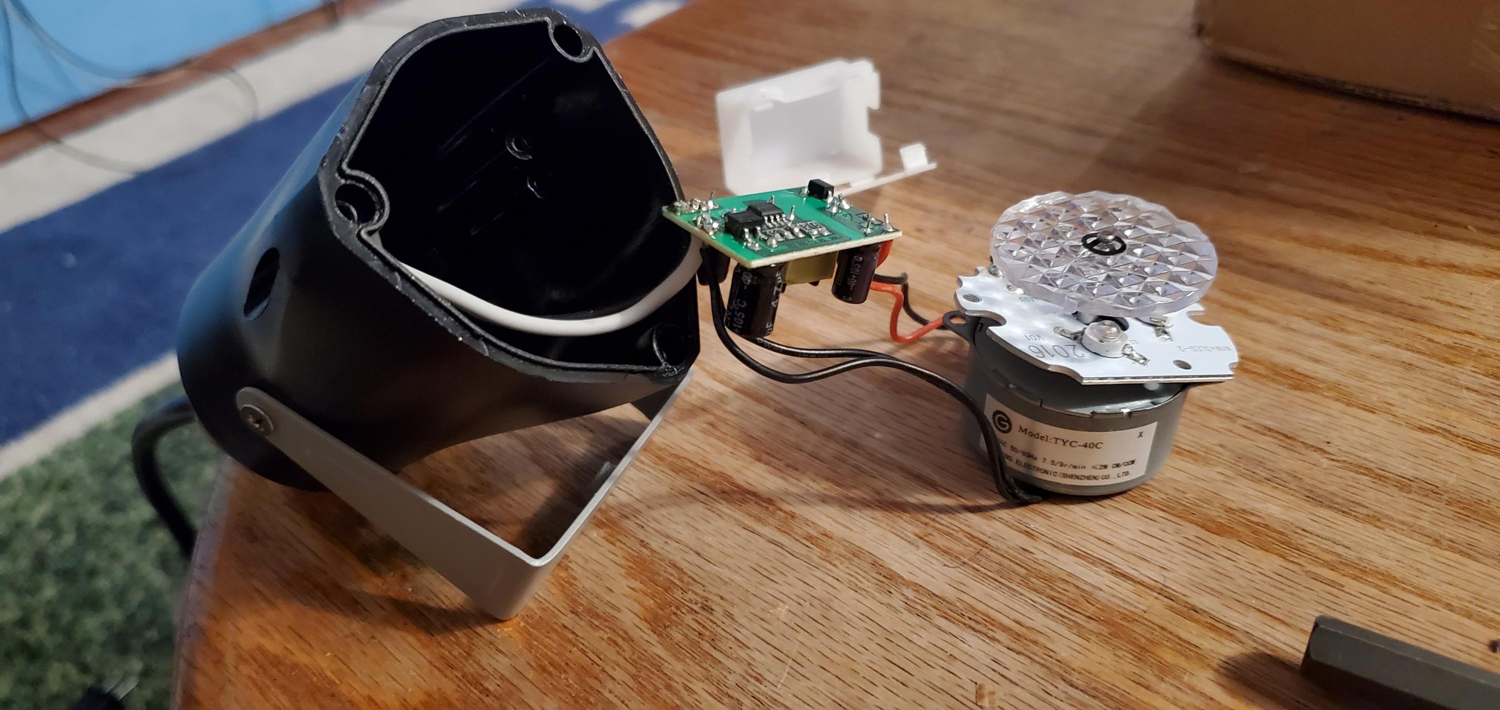

    I hate the idea of throwing something like this away if I can fix it and use this opportunity to learn something.
    I have a party light with three leds and a motor that isn't working right. The led are dim. I don't know much about electronics but I have a multimeter and a soldering iron. Thinking maybe a voltage regulator issue?
    Issue is only with the LEDs. motor is turning fine. LEDs light up but very dim. Here are some pics. Any ideas if what to replace?
    I appreciate any help in this. Thanks in advanced!

    Re: Party light no longer bright
    the power supply is probably fine,
    the leds are in series - if one fails it will effect the others.
    it's an old design btw, the newer ones use 5 or 6 leds and a dc motor all in series.
      Hmm.. wonder where I can scavenge a few of these multi colored leds. I'll try that first. That will be easy enough for my skill level. Can I use multimeter to determine which us out?
        • 31285
        read the voltage across each led.
        • Rebellelouch
          • Jan 2020
          • 7
          Yeah.. I don't know what I'm doing.
          I first reflowed solder all around just in case - no improvement
          Took reading off red and black wires and getting something like 22v. Go to first led in series, same reading. Next led around 1v. Then the next led even less. No idea what this means.
          Soldered red and black wires directly to the first led - no improvement
          I notice before during and after all this testing nothing changed in the way the leds are acting. Upon turning on device leds are very dim almost off completely. They seem to brighten up over a short time but only slightly. Not enough to light up the device fully assembled.
          I have to believe it is something on that board. There are two caps a transformer and some other smaller components.
          Help! I just don't want to trash it.
            That is a constant current led power supply. Looks like your problem is that the led's are bad. They seem to be 3v~3.5v 1 watt 350ma gullwing led's
            This is one site that has them I believe, and there are likely a lot more
            https://www.aliexpress.com/item/4000...E&gclsrc=aw.ds
            Or here: https://www.aliexpress.com/item/3281...E&gclsrc=aw.ds
              Thanks for the links. I ordered the leds. Needed 3 and got 30.. oh well.
                    UPDATE: LEDs came yesterday. I installed 3 new ones and they are working at full power!(had to redo it after realizing they had +/- designations and I had two backwards). Thanks for the tips. Saved this guy from the trash can.
                        Did you measure the current on this device to see if the LEDs are being over current
                        Because this might have caused this problem in the first place
