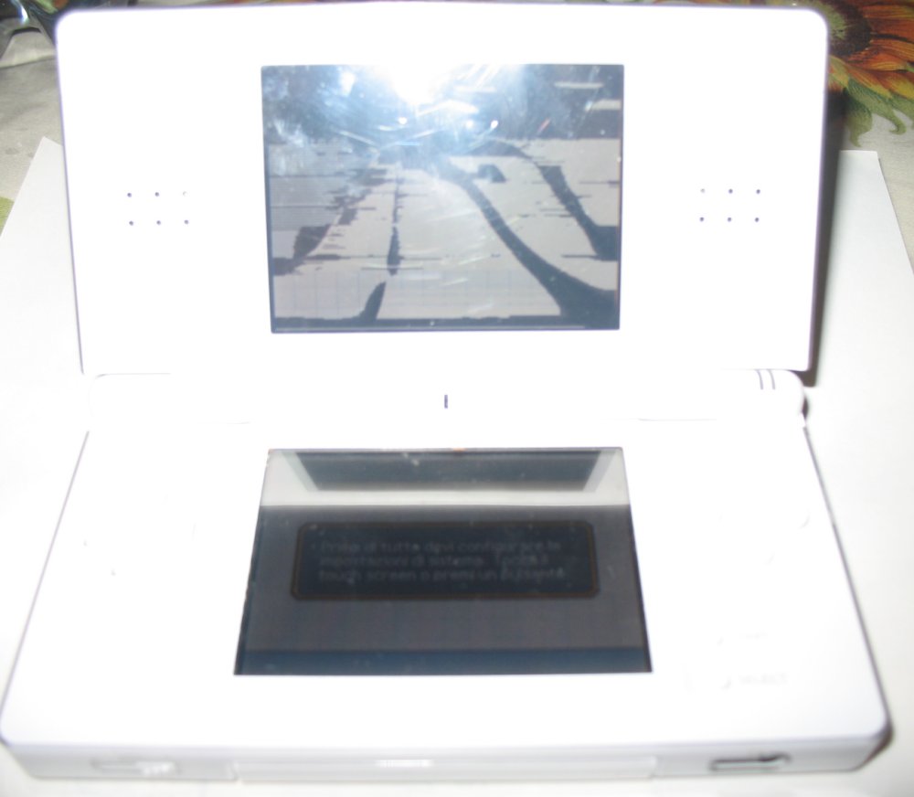

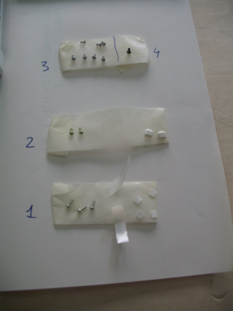

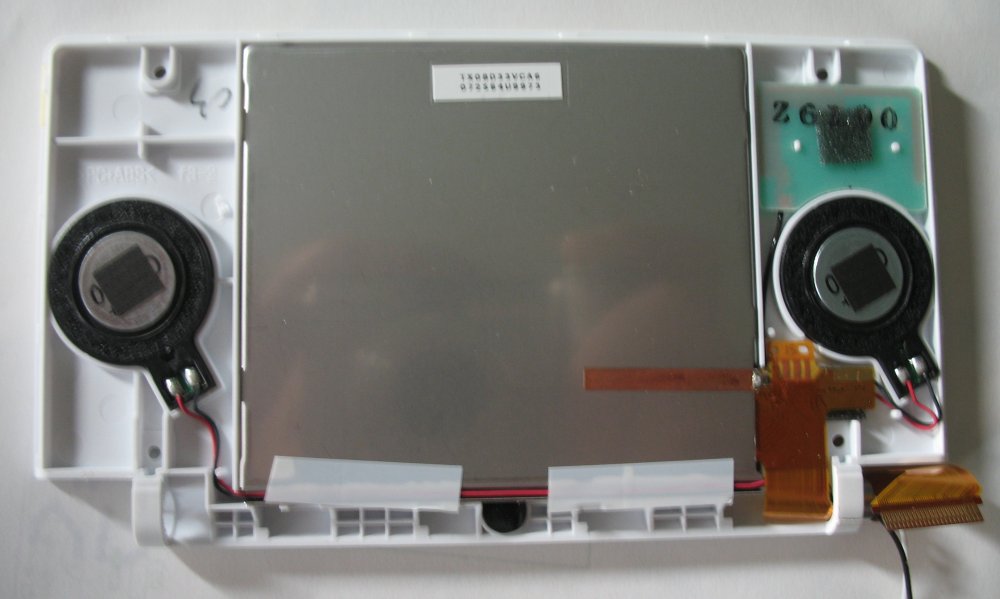

    Some days ago my sister-in-law found a DS Lite in a garbage can.
    As she knows I like to repair almost everything she brought it to me.
    It start up but the top display is cracked.

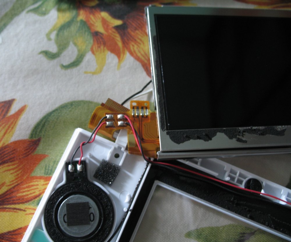

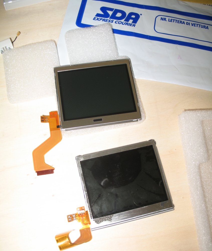

    I disassembled it completely and today I have ordered a new display, probably I will receive it on Friday.
    I hope I can repair it otherwise I have wasted 22.90€.
    Here some pics of the work in progress.

              Re: Nintendo DS Lite

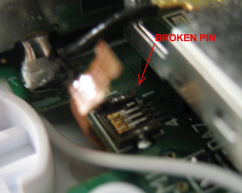

              I successfully screwed Nintendo and wasted my money.

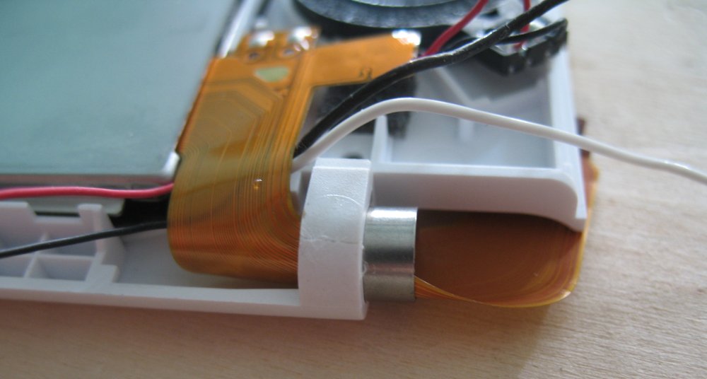

              The most difficult part (for me) was to pass the flat connector of the display trough the case shoulder.
              Don't know what went wrong but seems tha Wi-fi module is broken: I finished to reassemble Nintendo and when I powered it the bottom display flashed and Nintendo went off.
              I disconnected the new display and reconnected the old but Nintendo behaved the same way.
              I checked everything and at the end I removed the Wi-fi module: the Nintendo power up, the green Led stays on but the display not even flash.
              I reconnected the top display and without wi-fi module the green led stays on after power up but both displays are off.
              If I reconnect the Wi-fi module the Nintendo shut down (green Led) after power on.
              I'm so down because I thought this was an easy fix to do and I failed.
              Moreover checking around the board to look for something strange, I touched the touch-screen connector and I broken it.
              I was happy today because I received the display quickly and now... I have my balls under my feet...
              Here some pics of my failure job.
              I need a beer now...
              Gianni
              "In the confrontation between the stream and the rock, the stream always wins...Not through strength, but through persistence."
              H. J. Brown

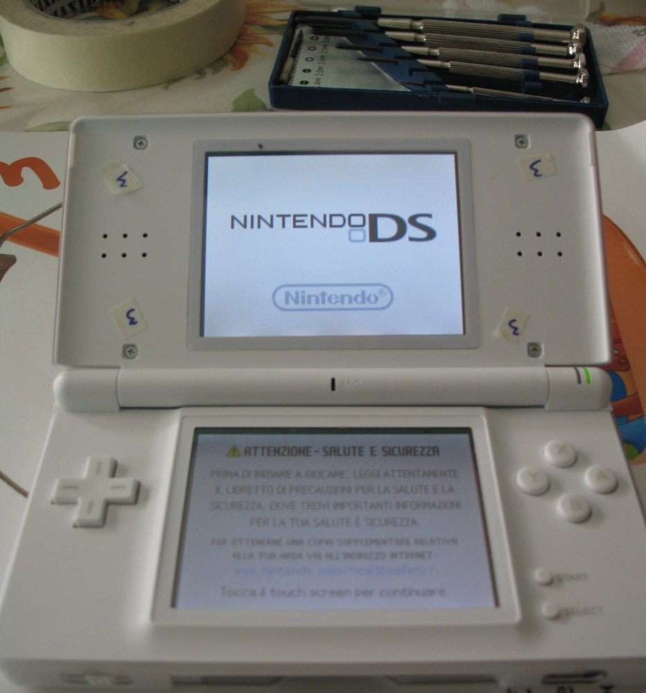

              • kikkoman
                • Jul 2007
                • 691
                that's exactly how it behaves if the top screen cable isn't seated properly.

                • Gianni
                  • Jul 2008
                  • 681
                  • Italy
                  Hi kikkoman
                  you are right, last night after I get over my rage I searched info and I saw a lot of people had the same problem.
                  At first I thought I had screwed up something because the green LED stayed on if I removed the WI-fi module.
                  I was convinced that it would stay on even with only the bottom display connected... but I was completely wrong.
                  Today I will try again. What I don't understand why it doesn't start with the old display, but probably it is because that damn connector is not so easy to close correctly.
                  This is a new lesson on the road of experience... I should have read more before doing anything, I have overestimated my skill.
                  Let's see what I can do, the problem is that I have broken the small connector for the touch screen: I was checking the connection to see if there was something wrong and with my tweezers I have touched the connector and the top plastic tip jumped out. I tried to reinsert it but I broken one pin.
                  I have a colleague that had repaired one Nintendo, he one as spare part, so if the connector is the same I will try to replace it but I can't do the job at home because I need a professional solder (very thin tip) and magnifier.
                  I getting old... my sight is not as good as use to be and playing with tweezers on that small connector just because I saw something strange brought me a bad headache.
                    Today after 5 times I connected correctly the screen cable and now the DS start up.
                    Ok I feel better but I feel also stupid because yesterday I should have stop my activity before I broke the connector.
                    Well another piece I have to buy and I hope this time I can fix it completely, here the picture of DS and the small connector.
