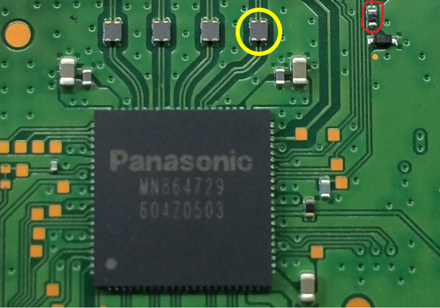

    Missing Component Near HDMI
    Could someone tell me the component in yellow circle, please? I've knocked it off while replacing the HDMI for a PS4 B-SAD-001. Thanks
    Full-time computer repair tech (10am - 6pm) and full-time, (8am - 11pm), Ruby on Rails Developer
  • diif
    • Feb 2014
    • 6978
    • England
    Re: Missing Component Near HDMI
    They are coils.
    https://www.tfix.co.uk/project/ps4-hdmi-coil-repair/
      Originally posted by diif
      Thank you!
