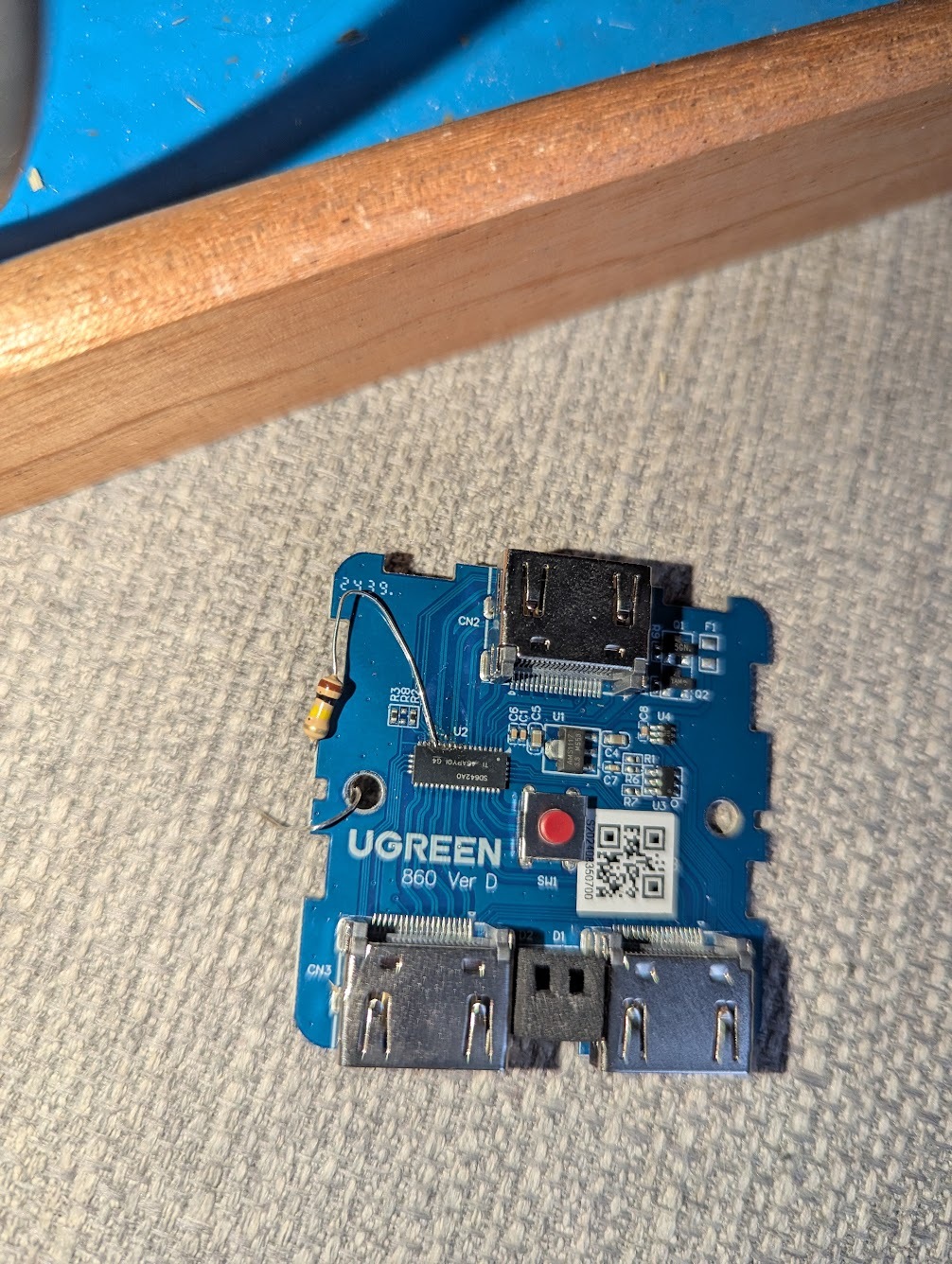

    Ugreen HDMI splitter missing a pulldown resistor
    Odd one I've found. This splitter likes to cut out - on my Xbox Series S the display/audio would randomly go to black for a few seconds - on my PC the monitor would flicker several times before eventually staying on. A few others have reported similar issues. Couldn't be bothered returning it for the sake of £8.
    I pulled it apart and found it is driven by a Texas TS3DV642 mux/demux. There appears to be a missing pulldown resistor on the HPD line, it is just left floating. Adding a 100K pulldown to ground fixes the flickering.
    (Not that this is worth the hassle for an £8 splitter)
