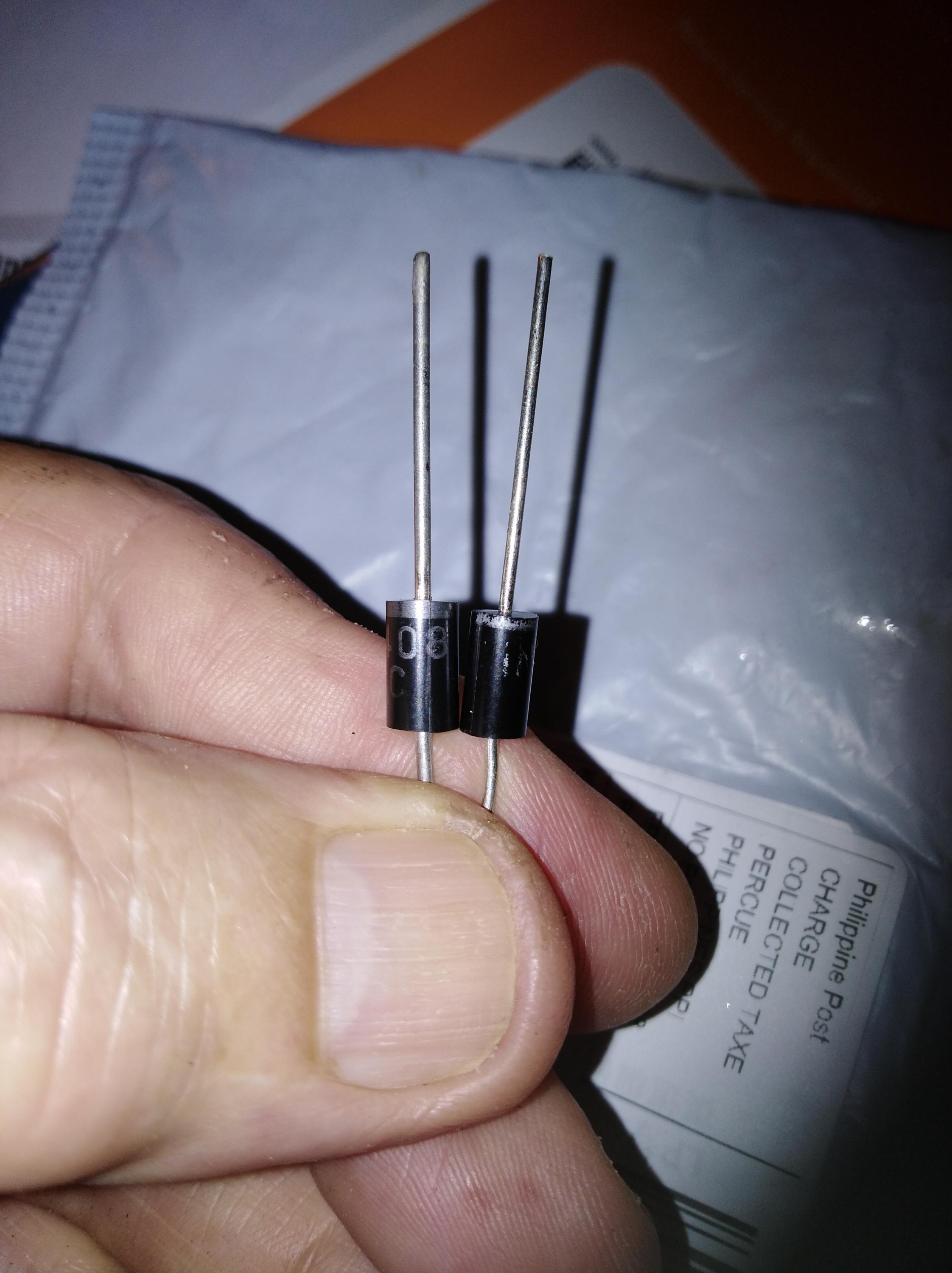

    UPDATE: Originally, I ordered 1N5408 from aliexpress and since that was taking too long, I paid twice the price for half the quantity from a USA seller on eBay, for delivery in a week. In the pics herein, you can see the eBay sellers product is on the RIGHT and the Chinese seller on Aliexpress is on the left. If SIZE MATTERS, then the Chinese Aliexpress product is superior. Also note, not only is the chinese diode itself large in diameter and length, the diameter of the cathode and anode wires on the chinese product is larger. Remember, herein the USA sold eBay product blew out 3 times before I placed the heatsink. Just FYI. Opinions?

      Re: Harbor Freight Tools Heat Gun Item 96289 JSRF-601C Repair
      lots of good stuff is produced in china under licence . and lots are produced on the cheap that anyone can sell on .
      one on the left looks better markings to me .

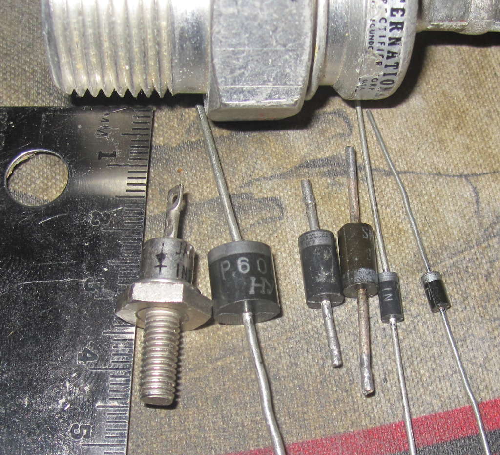

        The 1N5408 must be bigger than the typical 1N4007s I hope people have seen before... Need a scale to really tell how big they are, but yes they should be larger to dissipate more heat and hence support more amperes.
        Some diodes, from left to right:
        (15 amp stud rectifier)
        1N1614 (1969)
        (6 amps plastic)
        P600M
        (3 amps)
        MR851 Motorola (1983)
        SMR750
        (1 amp)
        1N4007 Motorola (1981)
        1N4007 (??)
        1N1379 240A
          the one on the left is new and has lead-free solder coated wires, the one on the right looks very old.
            I could have sworn I had a 1N5408 somewhere, and I finally found it... same size as the MR851/SMR750. And yeah I've noticed a lot of my old diodes have "shitty paint jobs" that scratch off very easily. However the size difference of the two you have is probably inconsequential, though if they are both the size of a "tiny" 1N4007, that's a problem...
            And it could very well that the "USA seller" bought a boatload (literally) of counterfeit 1N5408's to resell...
              #46
              those p600's bring back memories!
              i used to fix boards that had an early type on them, the package had pads with soldered on leads.
              when the voltage regulator shorted they used to get so hot they desolderd themselves and fell into the casing, leaving the wires on the board!!!
                Yeah I've heard a bunch of horror stories about the P600's as well. Though rated for 6A, that thing must get HOT, how could plastic deal with that much heat!!! IIRC the P600's seem to be readily available and probably the highest current plastic tubular diodes available and people readily use it reverse voltage protection, including things that require many more than 6A.
                I'd imagine at that much current, one needs to look into heat sinking, and should be using TO-220 diodes instead... or some other solution...

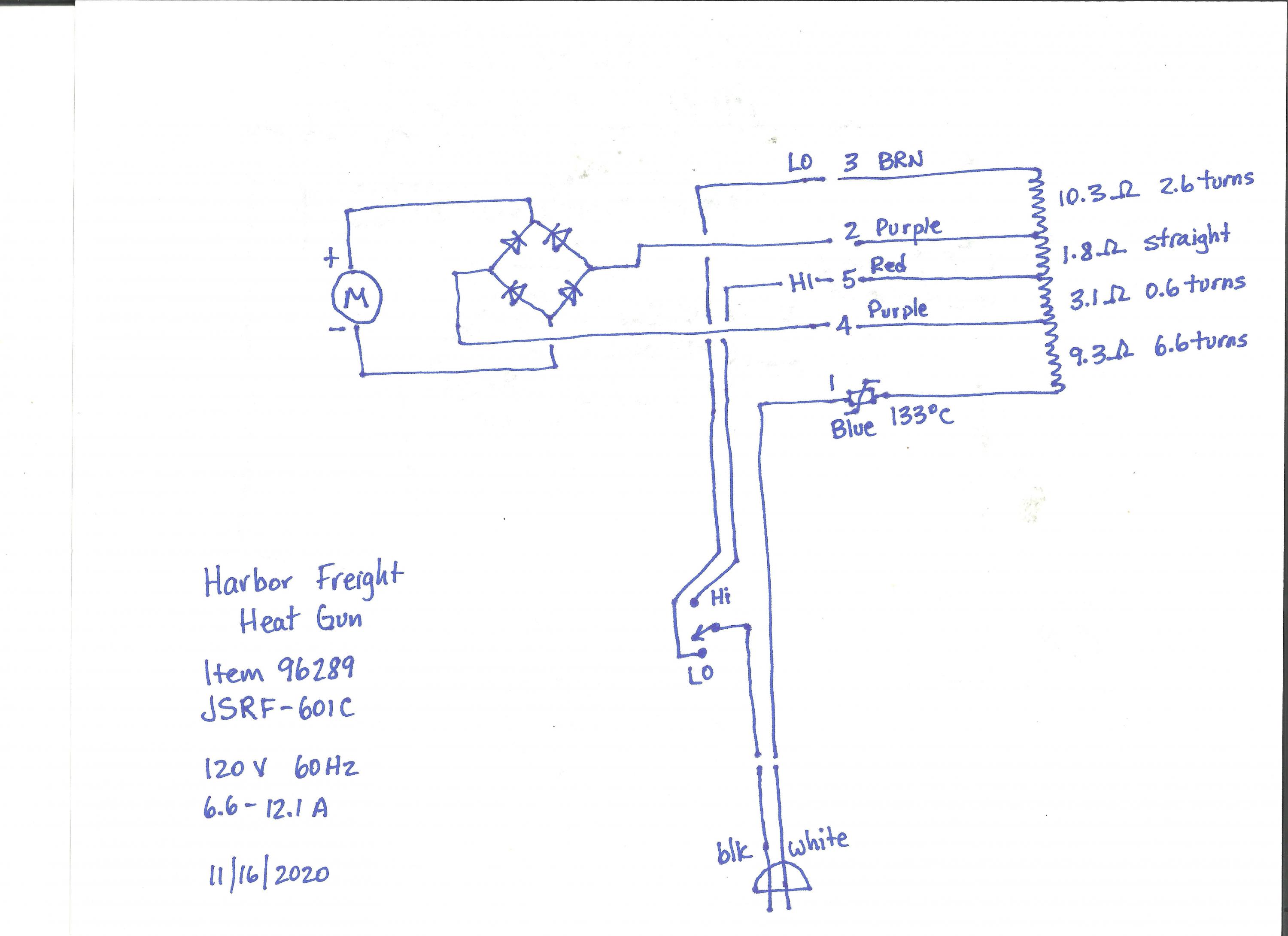

                      There must be several (multiple) versions of item 96289. My manual indicates revision 11a. There are no diodes present in my heat gun. The wiring diagram for my heat gun is attached.
                      --Jim x 3
                        There must be several (multiple) versions of item 96289. My manual indicates revision 11a. There are no diodes present in my heat gun. The wiring diagram for my heat gun is attached. Resistance values may not be accurate given the condition of my heating coils.
                        --Jim x 3

                          Then it might be using a ac type motor
                            @sam x 3
                            Well I mis-spoke. There is no diode in my heat gun at the switch that provides 2 power settings.
                            However (as you can see from my diagram) there is a 4 diode bridge providing DC to the motor.
                            Jim Jim Jim
