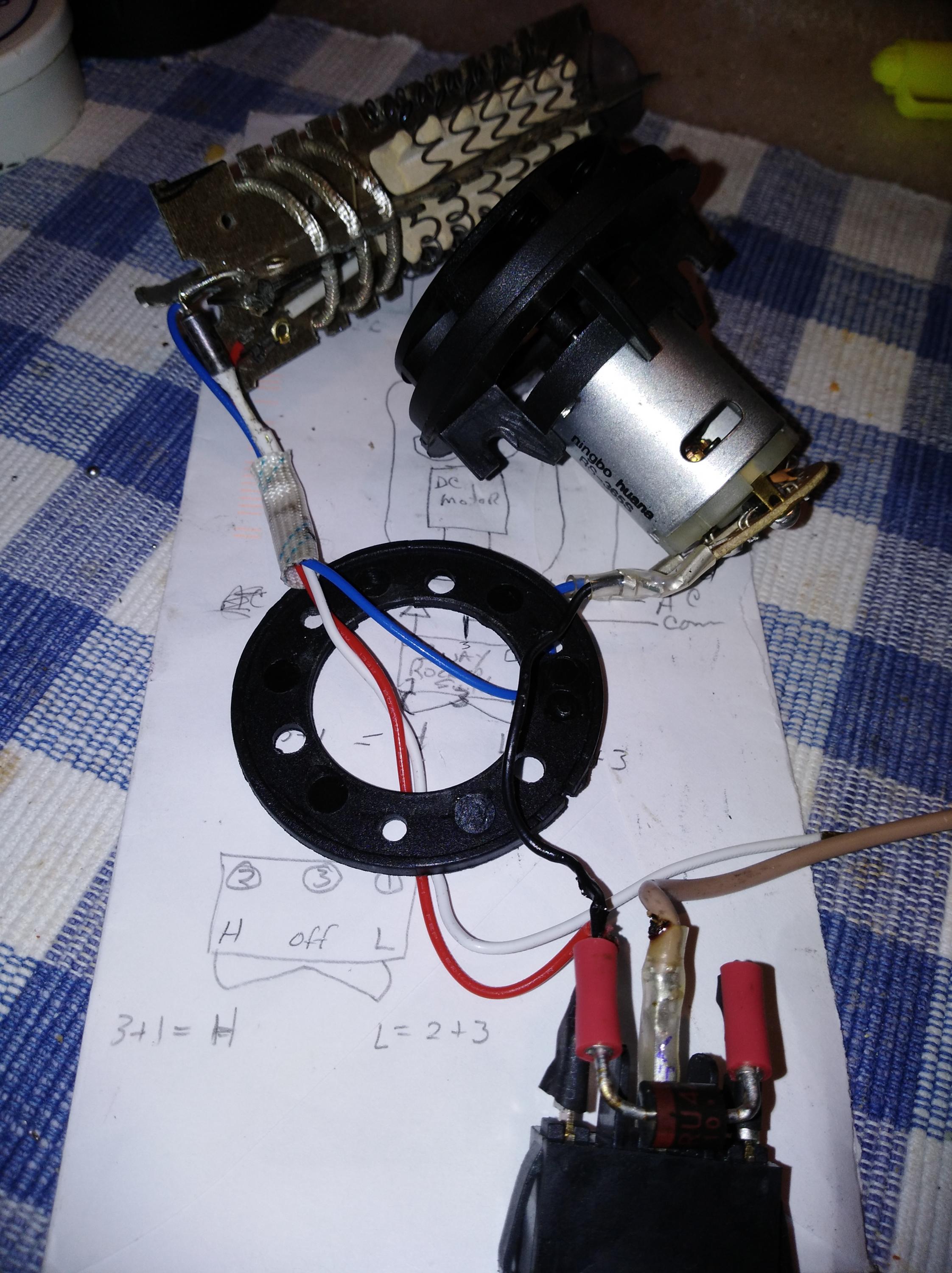

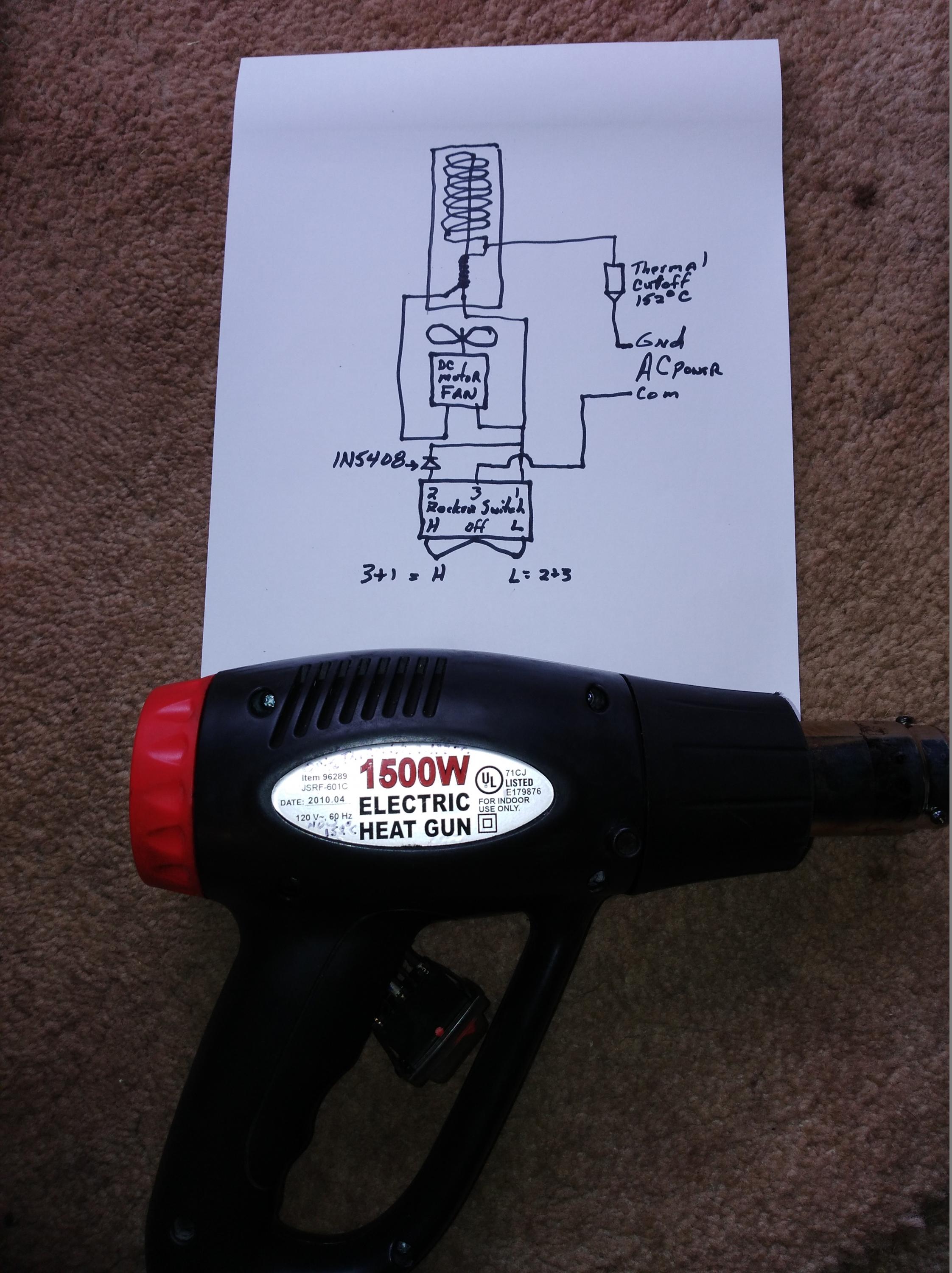

    Harbor Freight Tools Heat Gun Item 96289 JSRF-601C Repair
    This is a seldomly used electric heat gun that was designed to operate with two fan speeds with two heat settings controlled only by a rocker switch on either high or low. It was working ok and while using on low heat/speed, it suddenly switched to high speed/temp without a change in the switch setting. On disassembly, and testing the 1N5408 Rectifier Diode 3A 1000V, it was found to be bad. It was replaced with the same and it worked as designed .... for 60 seconds and then blew the diode again. Is there a modification I can make to fix this? The heating elements, rectified DC fan motor, thermal cutoff and switch all tested good. Any ideas? See my crude schematic......thanks for any ideas. Would a change to a lower temp thermal cutoff help? How can I keep the 1N5408 Diode for exploding? Would a low quality 1N5408 be the issue here?

    3 amp diode does seem a bit light
      • 31296

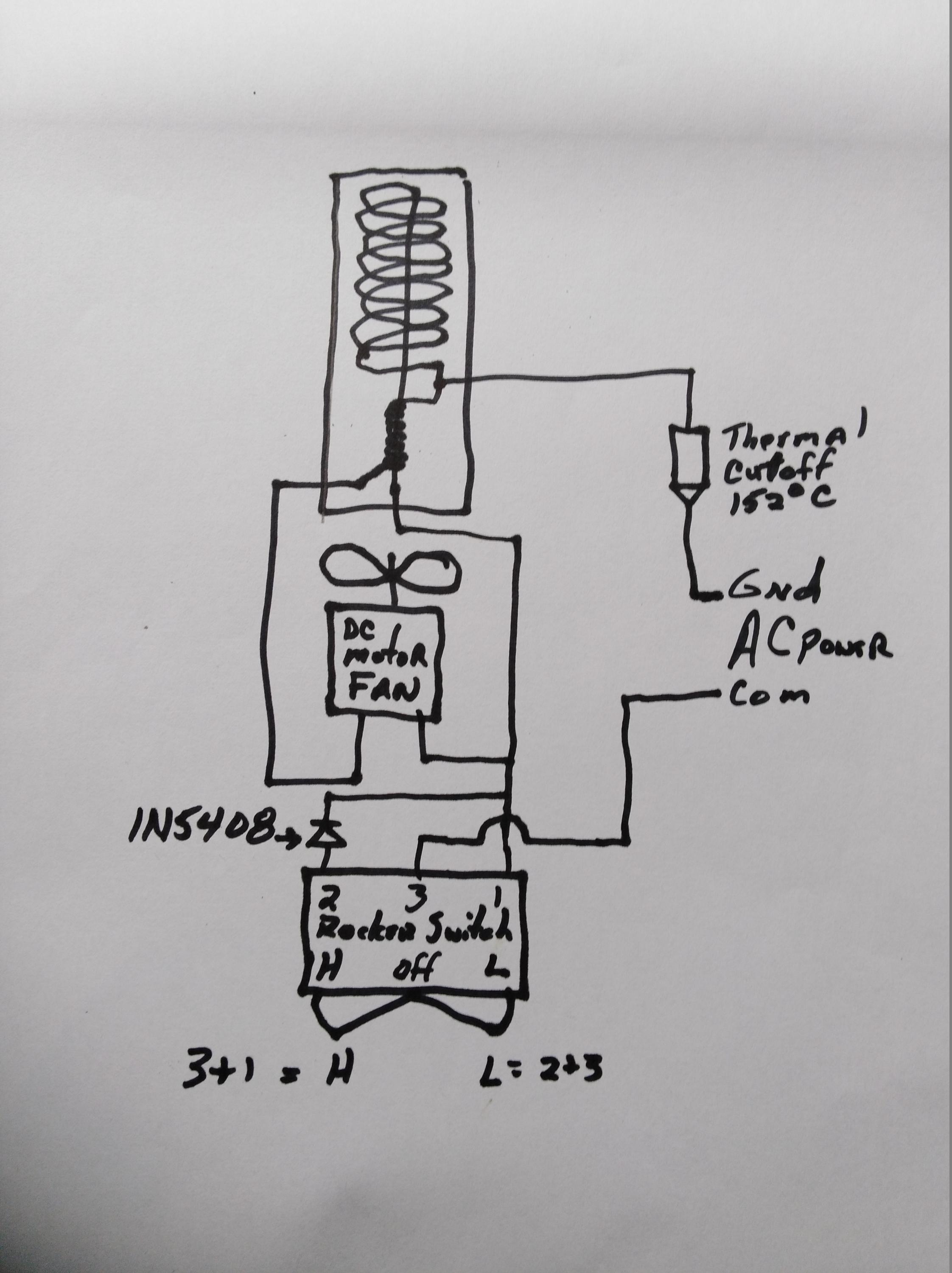

      Re: Harbor Freight Tools Heat Gun Item 96289 JSRF-601C Repair
      1st, it cant be a DC motor unless there is another diode we arent seeing,
      your schematic shows it getting AC.
      second, what's the power consumption of the gun?
      the way the circuit works is that the fan motor is getting power via a resistor built into the element,
      and the whole thing is powered either by full waveform (H) or by half the power cycle because of the diode.
      but the diode at 120v is only going to handle 375w (120v 375w = 3A)
      btw, i know it says 1500w - but that is probably bullshit these days.
        Thanks, remember I said crude schematic, so you can take my word That rectifying diodes are on a small board on the back of the blower motor. (I assumed, see new pic with partially exposed fan motor circuit board). Can I just substitute a 10A10 rectifying diode for the 1N5408, or add a resistor before the 1N5408.? Or is this asking for a fried potato? I may take another look inside.....

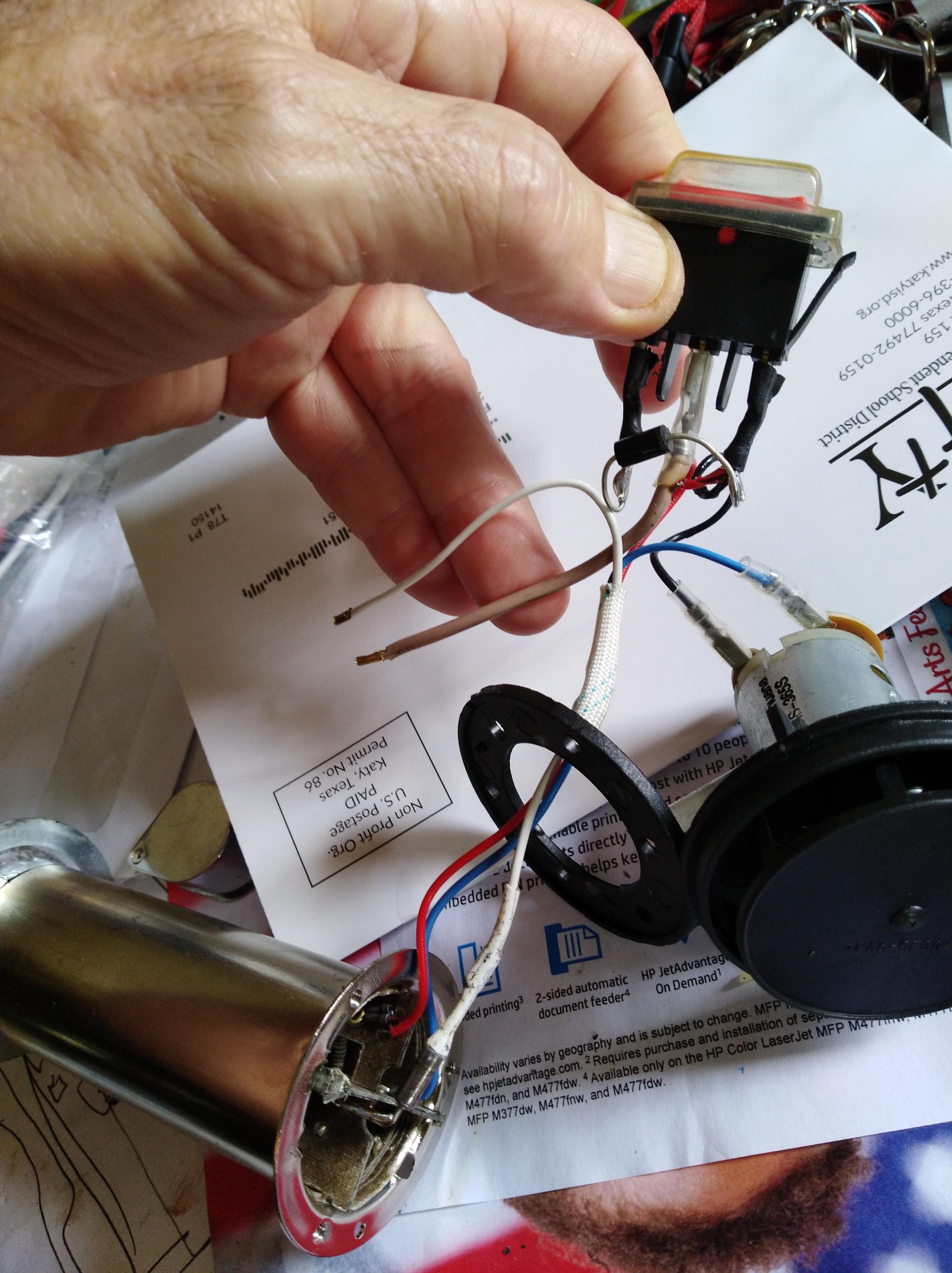

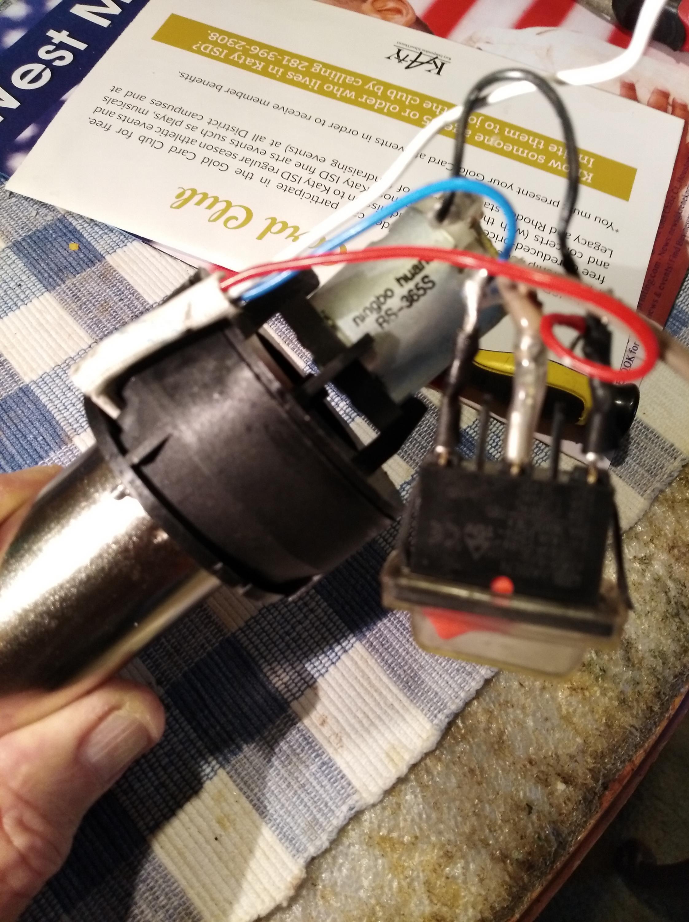

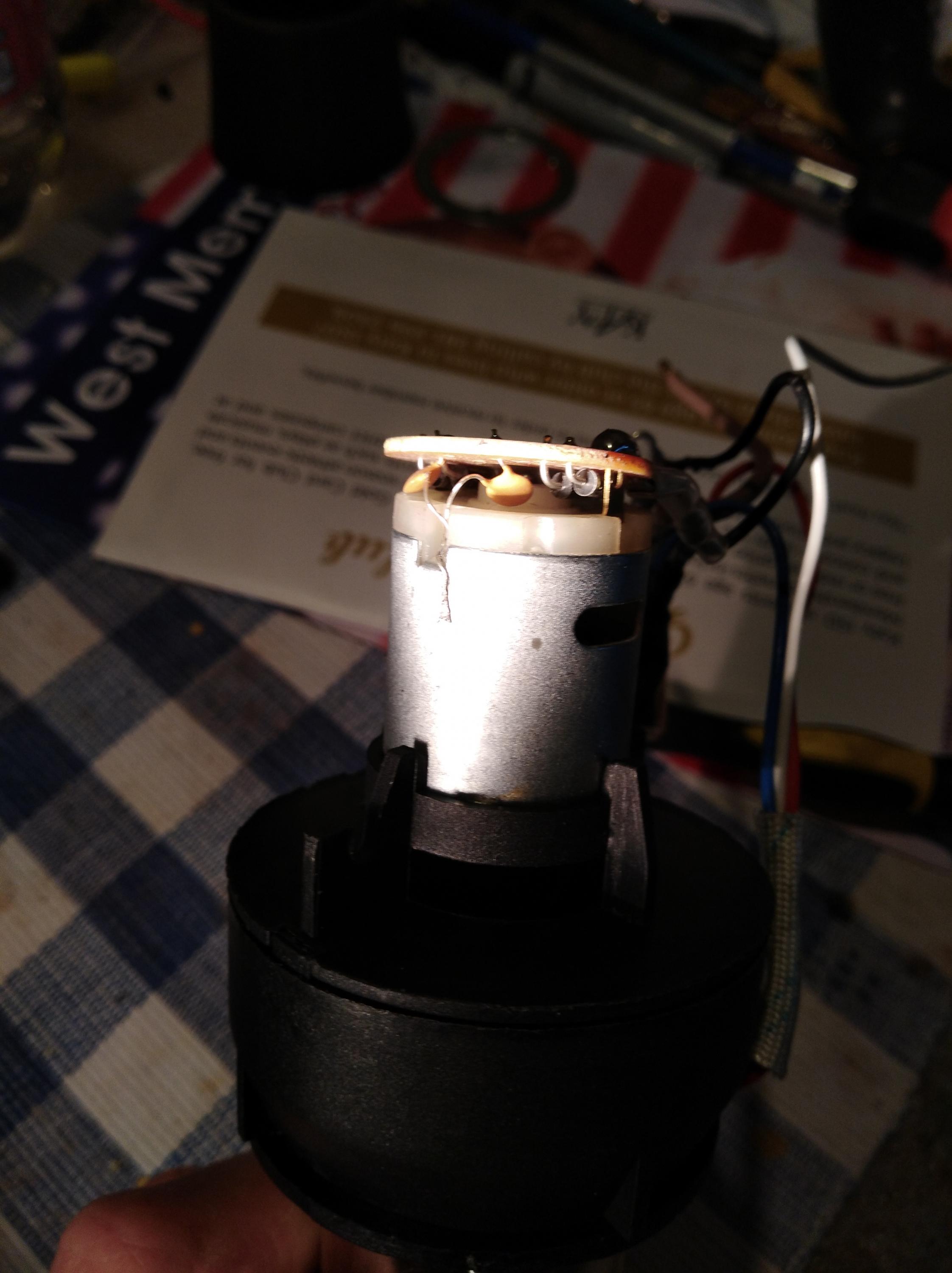

          Yep, I was right, the motor is DC, ningbo huana RS-365S, see pics. Any direction appreciated. Note these pics of the switch is missing the 1N5408 diode between the switch 3 and 1 contacts because I soldered it and it got so hot it fell off.

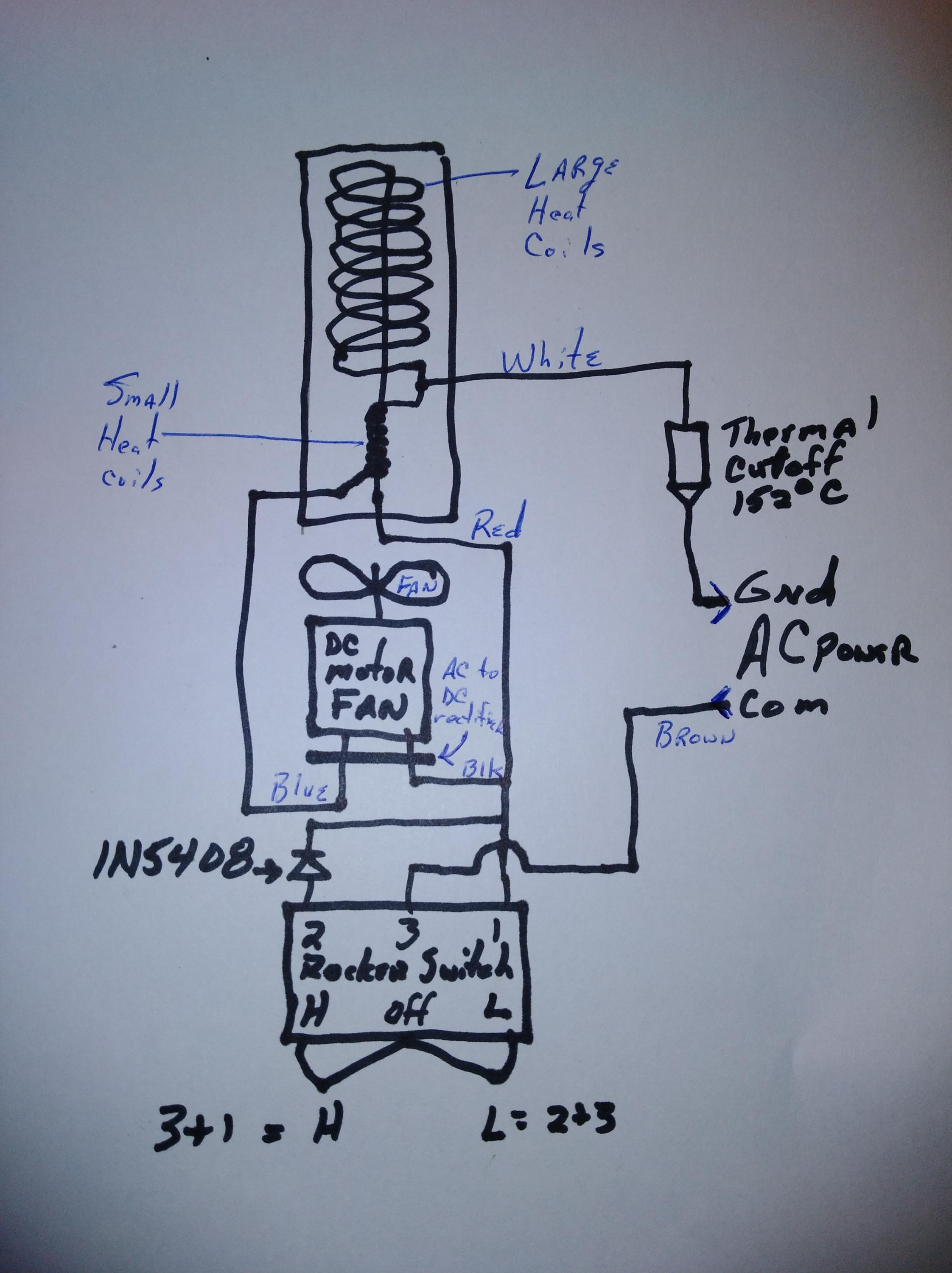

            That schematic can't be correct, in HIGH the diode is out of the circuit so the DC motor would be running on full AC
            Is this the same heat gun? https://www.ifixit.com/Device/Drill_Master_Heat_Gun

              I am not an electronics repairman, only a scientist, and I do not understand it either, but that's the way it was built and worked well on both speeds, for 15-20 minutes at a time for at least 20 sessions during it life......
              R_J, my schematic lacks details of the circuit board on the back of the motor, which I assume rectifies the AC to DC...? And NO that is not the same gun internally, that gun has no circuit board on the back of the motor, nor a 1N 5408 on the switch, and does have WIRES running to each terminal of the switch.
              When I replace the 1N5408, then start it in LOW mode ( which places the 1N5408 in circuit, it works as it should on lower air flow and heat), then after a couple minutes, it switches to high mode by itself, probably b/c the diode has shorted. the diode is only 88F, but the wire between the switch and the anode side of the diode maxed at 150F, before it failed. Any ideas?
                    I suspect the "small heat coil" is just used as a resistor to drop the 120v ac to supply the motor, the motor is likely 12~24 volts dc and the board on the back of the motor supplies the dc voltage. so there is not much that can cause the diode to burn up, the only thing would be exceeding the 3 amp current rating of the diode and if it worked before, the only thing I can think of that would change the amount of current would be shorting in the heat element which would lower its resistance and increase the current. But I doubt that is happening as the heat element looks like it is in good shape and well spaced between the coils
                        R_J, i believe you are right when you said, "the "small heat coil" is just used as a resistor to drop the 120v ac to supply the motor, ouch, what a cheap way to do that.....maybe I can get it running while opened long enough to check that blue wire voltage.
                            It IS as DC motor; runs on AC with an internal rectifier, usually 1N400x's.
                            Heater has a tap for the motor with 12-14V across, similar to a hair dryer. The latter usually having a separate "dropper coil" in their heaters, allowing the main heaters to be shut off with a "cold freeze" feature.
                            Check the current draw on "Hi"- a bit much for a 5406, even at 50% duty cycle as expected when chopping off one half of the sine wave. 3A average= 6A for half the time...
                            These always ran on the edge. Heater may have shorted turns- ohmmeter tells you nothing other than the ckt is complete. Use an amp clamp or "Kill A Watt."

                              The fan spins freely, and the armature looks good on the brush plates. The circuit board on the back of the motor is soldered, with the back of the board facing outward and the rectifier diodes between the board and the motor, and I can see the four diodes and some small resistors. I would probably destroy that circuit board if I tried to remove it to check the rectifier circuit. The heat is NOT 100% all the time, as when it worked, I would switch to hi, the fan cranks up and the heating elements go to bright red, which doesn't make sense, since I would think the hi mode would be when the 1N5408 would blow. But it blows while on lo mode, which then bridges the inside of the 1N5408, and it goes to hi mode without touching the switch, essentially making the same circuit in the low and hi modes
                                  Well.. it's a PM DC motor, but this time with an external PCB/diodes to run on AC. Jumped in before looking at motor pix.
                                  Try an 8-10A, 400V diode instead. The 800-1kV diodes tend to have higher junction drop, which means more dissipation for a given current.
                                  Bare minimum would be a 200PIV part, but this only gives a 30V margin on top of peak line voltage.
                                  With a half wave rectifier, a heating/resistive load draws 1/2 the power it would as on full voltage.
                                  750W at 120V is 6.25A If it's thru that half-power diode, it'll be 12.5A, but for half the time, so the same 6.25A average.
                                  One diode drop of .7v * 6.25A=4.375W in the diode. No wonder the solder melted.
                                  This is true even if it's a 10A diode, you just have a bigger package to spread the heat.
                                  If you must keep the half power option, either try to stay around 2mins (or less) on/5mins minimum off.
                                  Or use a TO-220 part on a small heatsink tucked away.
                                  Using 1kV PIV diodes, which have close to 1v drop, you'd end up with 6.25W instead...
                                  This is initial dissipation- as the diode heats, it's voltage drop will fall, to a point.
                                  As I said above, the dual heat option always struck me as a gimmick, and a dubious one at that- literally using a part that's half of the minimum required.
