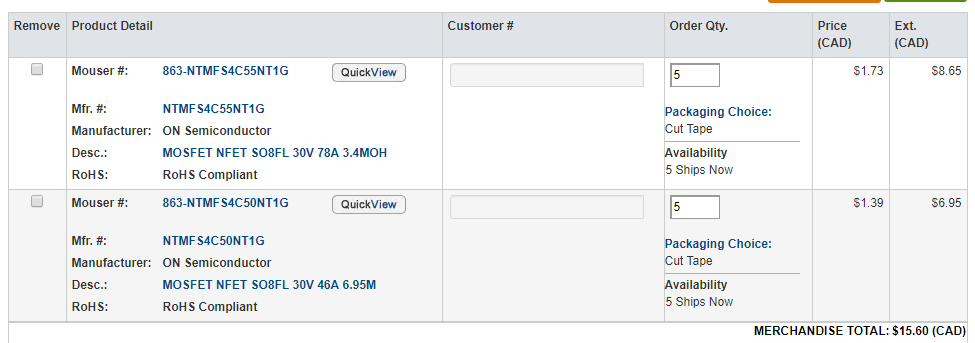

    anybody know what the small ones are?
    they are marked "4c50"

    This could be it: ntmfs4c50nt1g
    Looking up the ic's pdf seems to point to the NTMFS4C05N

        4C55 marking.
        https://cdn.badcaps-static.com/pdfs/...a59b643c84.pdf
        4C05 marking (part number NTMFS4C50N)
        https://cdn.badcaps-static.com/pdfs/...e33b7fc9f6.pdf

          thanks, that '55 looks like a nice upgrade.

            Is one of those supposed to replace the 4C50? the 4C55N is the larger one, the 4C05 looks like the larger one too. Thanks

              i think these will work - they will fit and are the most powerfull i could find.
