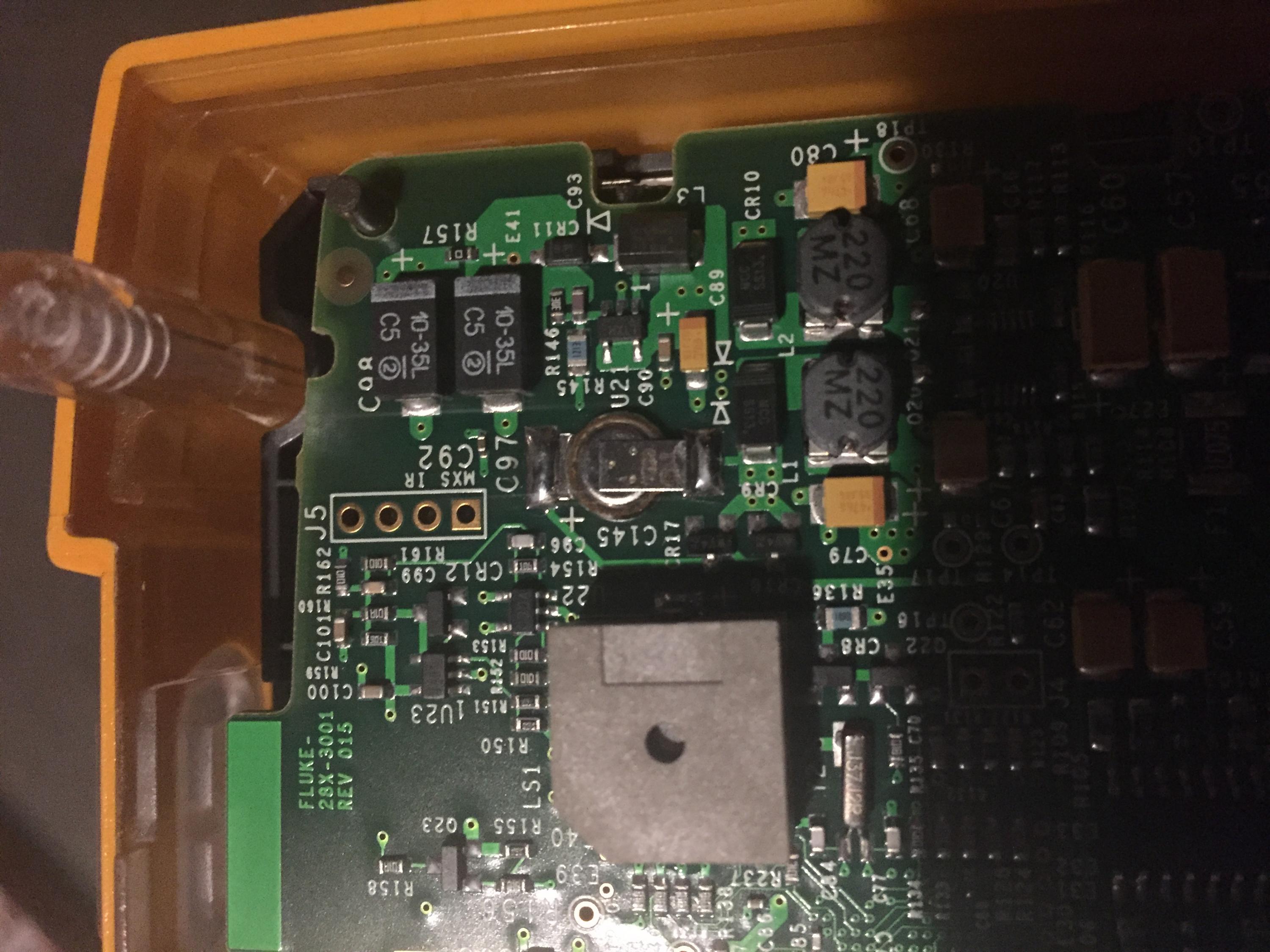

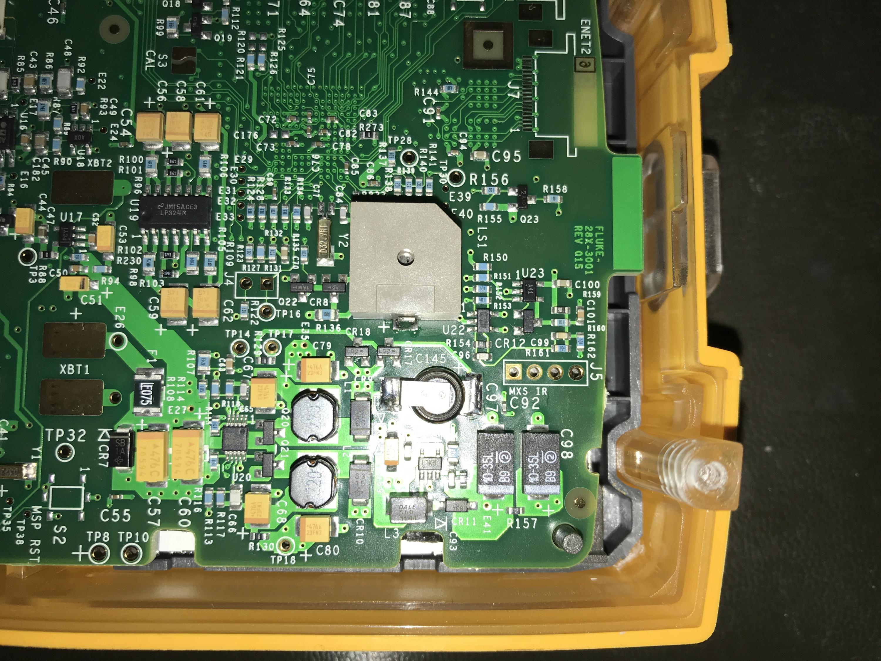

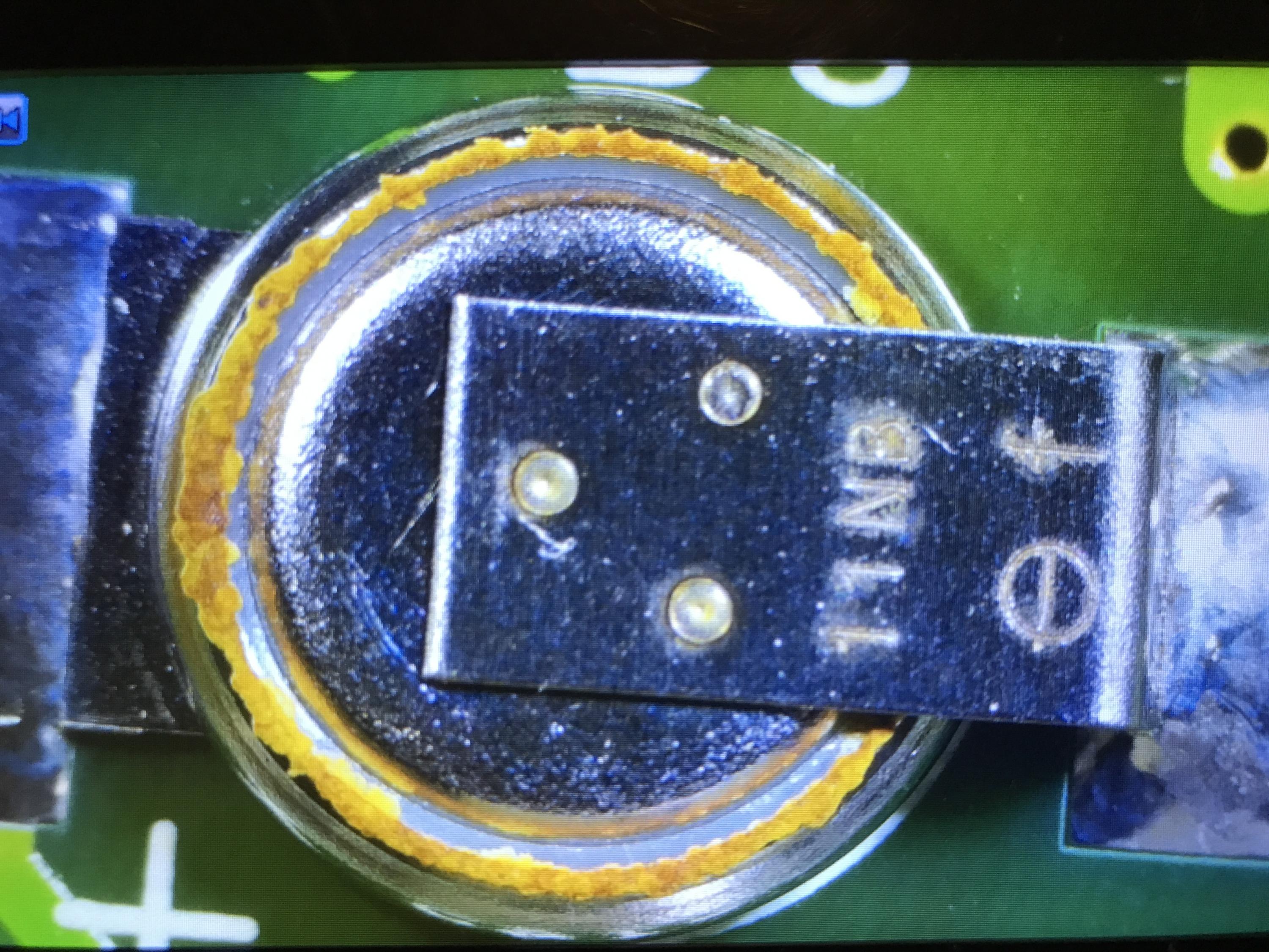

    Here it goes... we have two Fluke 289, bought one in 2012 and the other in 2013, both are rev. 015 boards. Both supercaps are done for. Take battery out for 3 seconds, put it back in, got date and time error on the display.
    The original supercap was a Panasonic EN series 3.3V 200mF SMD @ 500hrs rated. Digikey #: P14162CT-ND , Manufacturer #: EEC-EN0F204AK . https://www.digikey.com/product-deta...2CT-ND/1937320. Not available anymore.
    Replacement SMD Digikey part #'s:
    ELNA DSK series, 200mF @ 3.3V, exact original size Digikey #: 604-1147-1-ND, Manufacturer #: DSK-3R3H204T614-H2L
    or:
    ELNA DSK series, 220mF @ 3.3V, same diameter, but 3mm tall (will fit too): Digikey #: 604-1020-1-ND, Manufacturer #: DSK-3R3H224U-HL
    I am going to replace them with the 220mF one in both. The original is 1.8mm high, well this one is 3mm high, same diameter. One can fit up to 5mm high in there. Hope this helps someone that sit's in the same boat as I am. There are tons of threads out there and folks took all kinds of different replacements. However, if one likes their replacement cap looking like stock and not having to shim, trim, glue or whatever, these are proper drop in replacements for Fluke 289's with the SMD supercap.

                Got the supercap today, it fits perfect, and the meters are back in business as they suppsed to be.

                  Nice! But you're supposed to post pictures to make us happy
                  • CapLeaker
                    Leaking Member
                    • Dec 2014
                    • 8327

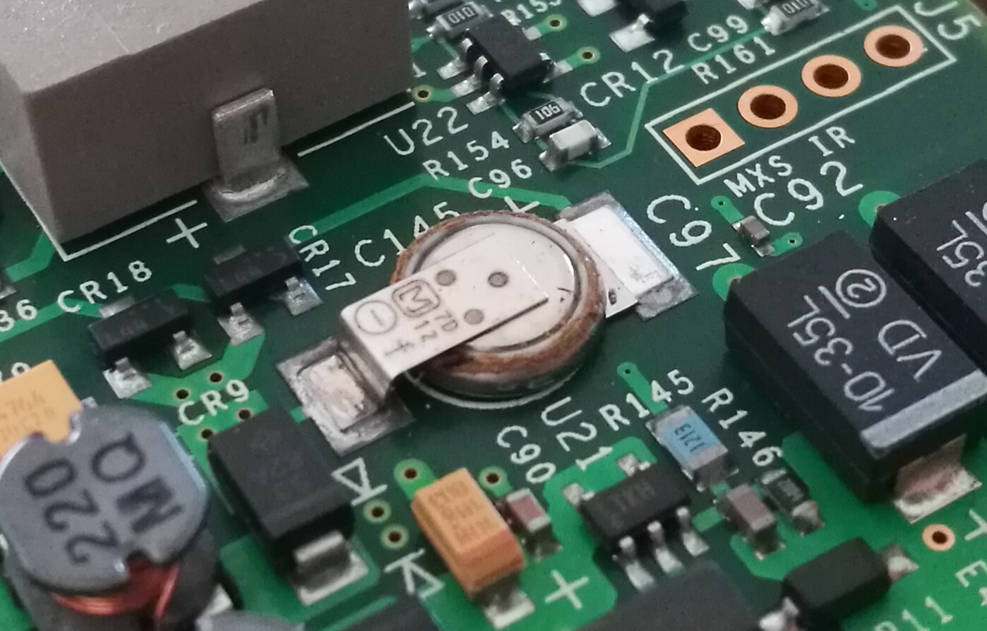

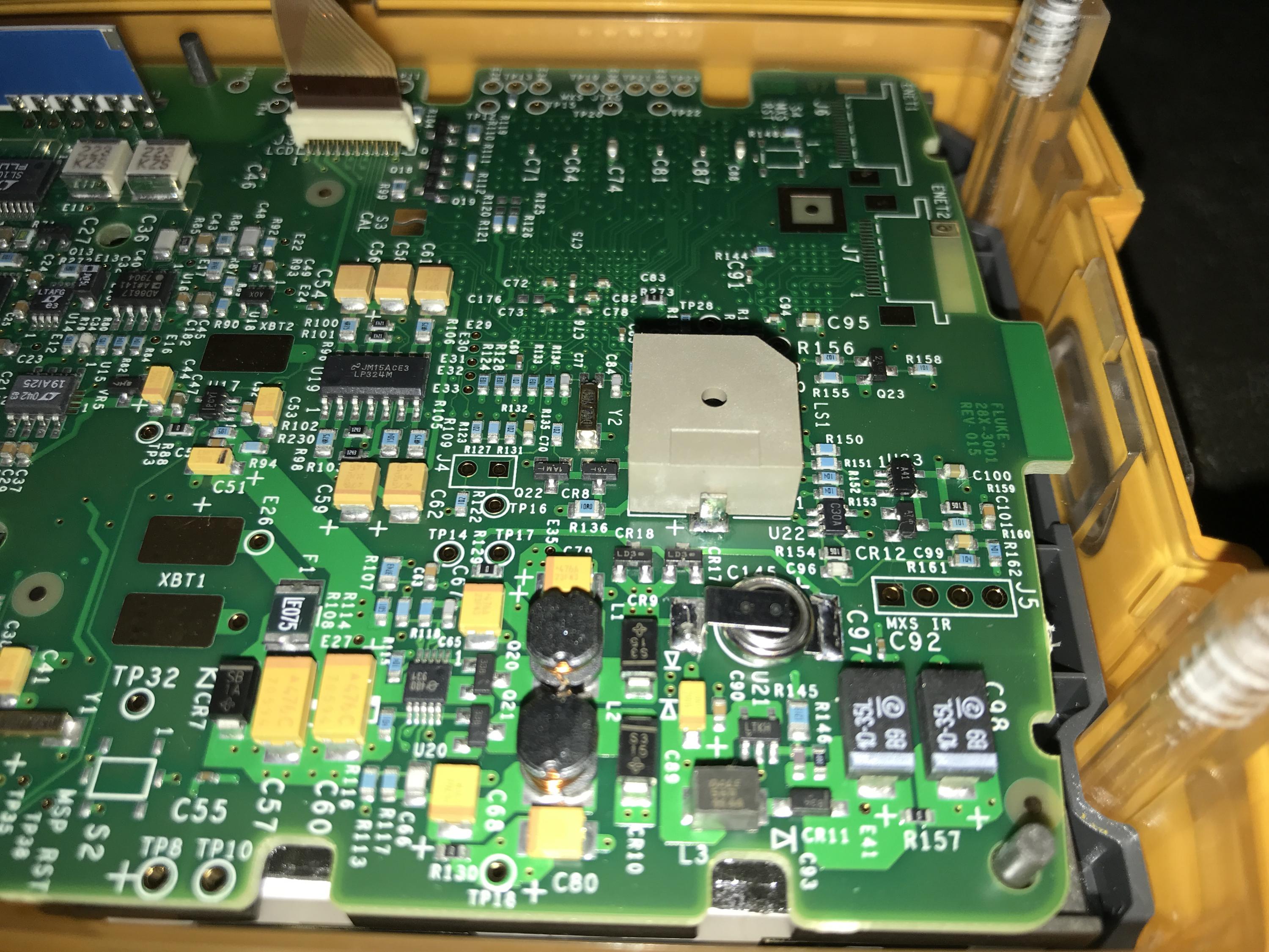

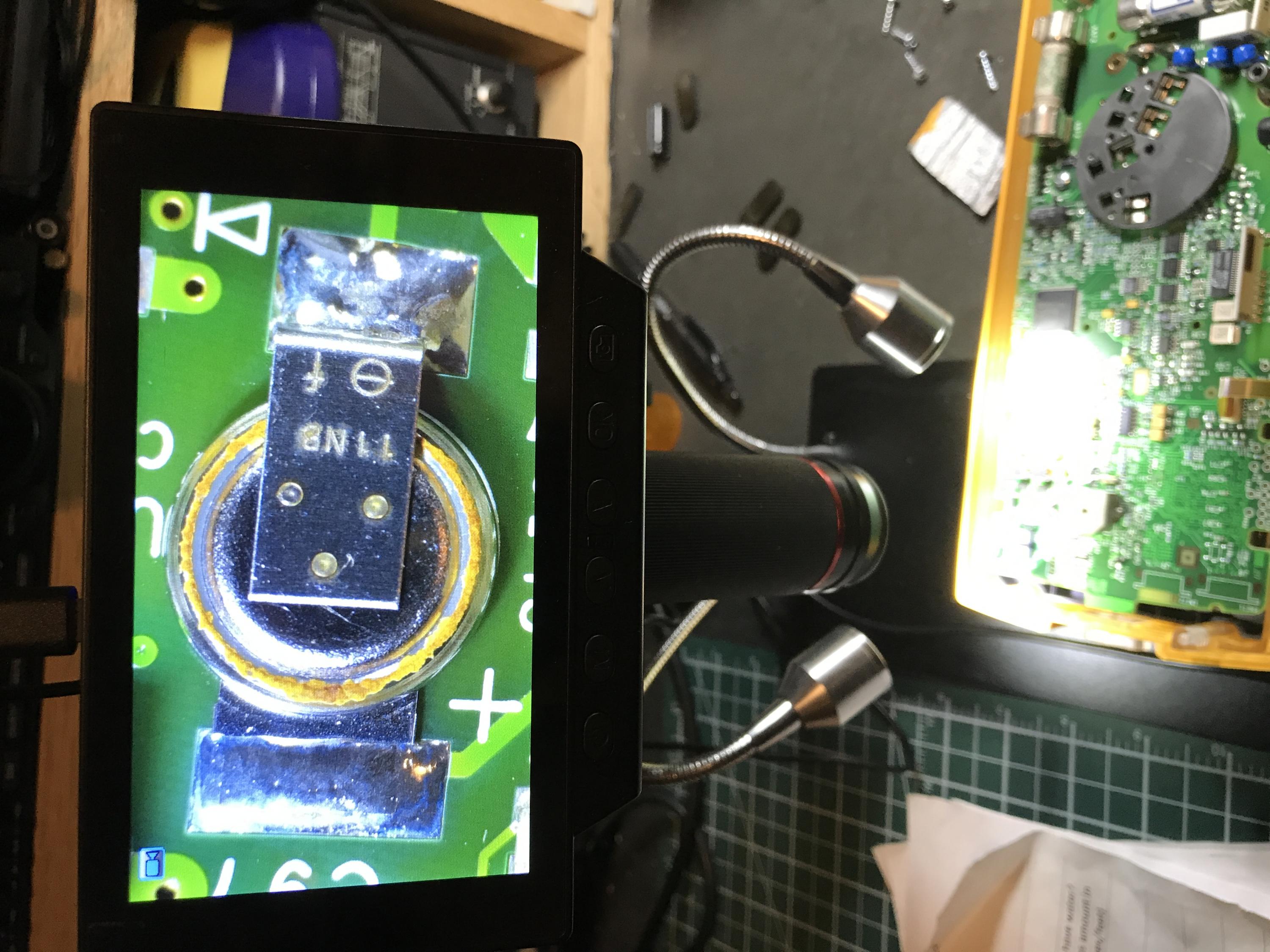

                    Re: Fluke 289 bad supercapacitor replacement repair
                    Beware you are about to see Fluke porn!
                    I had to take the 289 apart again to make pictures. On a side note: The supercap held the memory for the entire time I had it apart again. So I am happy!

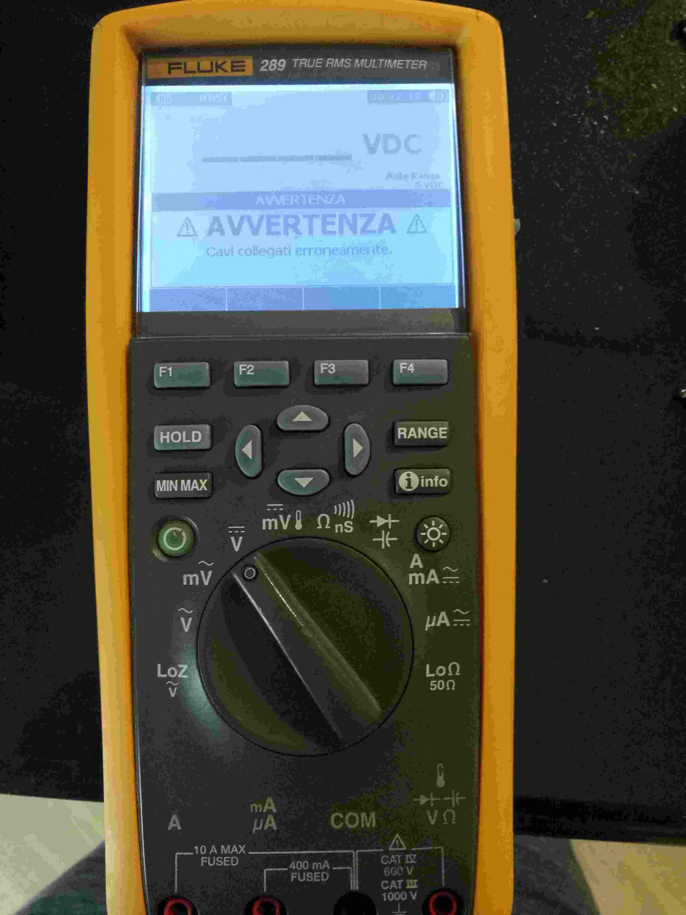

                        I need your help. :'( :'( :'(
                        I have the tester 289 that as I turn on gives me an "incorrectly connected cables."
                        Could it be the super capacitor?
                        it is damaged. the fluke is 289 and of the year 2008.
                        I found on ebay a PANASONIC GOLDCAP KONDENSATOR Capacitor 0,22F 3,6V 10x5MM[/img].
                        You can help me?
                        Thank you.

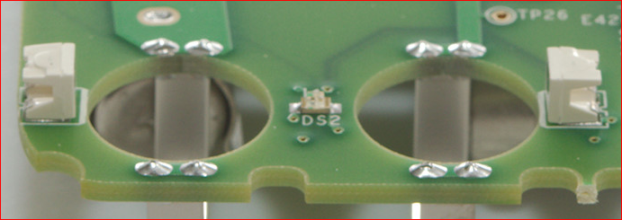

                          Check for contamination inside the jacks for the cables.
                          If memory serves me right there is an optical sensor there.
                          So if there is dirt in the ampere jack it will cause this message...

                            i wonder if putting RTV on the cap would contain it, or if the leak is under pressure??
                            • eccerr0r
                              Solder Sloth
                              • Nov 2012
                              • 8701
                              Is the electrolyte leak causing damage to other components?
                              Anyway, probably the same answer as whether to use RTV on a regular electrolytic capacitor to prevent leaks, though a supercapacitor does not need to deal with ESR as much if it's just needed to maintain static RAM state.
                              In other words, it leaks because it's under pressure...
                              • redwire
                                • Dec 2010
                                • 3912
                                The supercap electrolyte is acidic and it eventually corrodes through the case and causes a lot of damage. Putting RTV over that, uh just a mess for a few dollar part in an expensive multimeter.

                                  For Fluke 289 jack-detect DS2, any top-emitting 0805 IR LED will work, just not too high to hit jack diffuser when you assemble everything.
                                  Original is mentioned as OSRAM SFH 325 FA-3/4-Z series, peaking at 980nm. One guy used 940nm Harvatek HT-170IRAJ works fine.
                                    i didnt mean instead of replacement - i meant ON the replacement.
                                    • redwire
                                      • Dec 2010
                                      • 3912
                                      I see- as an extra seal to protect against future leaks. I'm not sure what the acid is, as silicone sealant dissolves in sulfuric acid and puffs up in nitric and acetic acid. Larger supercaps can take a piss on a PC board. If the cap had a housing or was potted maybe.
