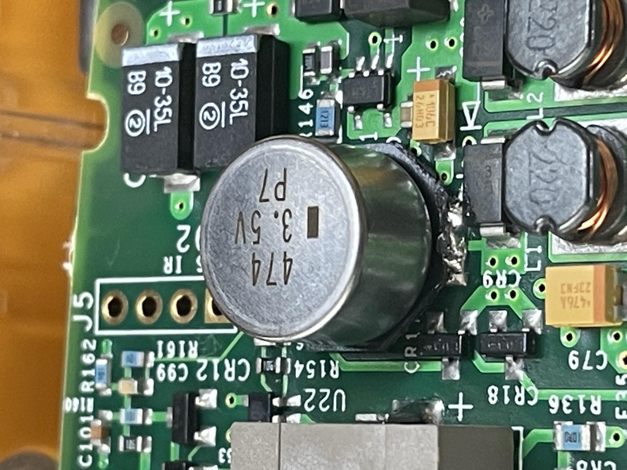

      Originally posted by AleXis6
      I think similar due to enough space around.
      which supercapacitor you used last time ?
      Last time I replaced it with an ELNA DSK-3R3H224U-HL. BTW this part number is still current. Mouser and Digikey have them on back order. So it may be good to wait if time is reasonable. It's about 6.8mm in diameter and height is about 2.8mm.
      The other one is 10.5mm diameter and is really going to push it diameter wise. One has to be very careful to place the battery so it won't touch anything else. The height is a problem at 8.5mm. That's not going to fit.
      Found some EDLC381420-501-2F-70 which could be taped or glued somewhere. These are way more expensive, but in stock for me and still better than shelling out $370 bucks.
      Edit: Turns out DSK-3R3H224U-HL is back in stock @ Digikey on July 4th, 2022. Worth while waiting since it is only a couple of weeks until the new shipment arrives.

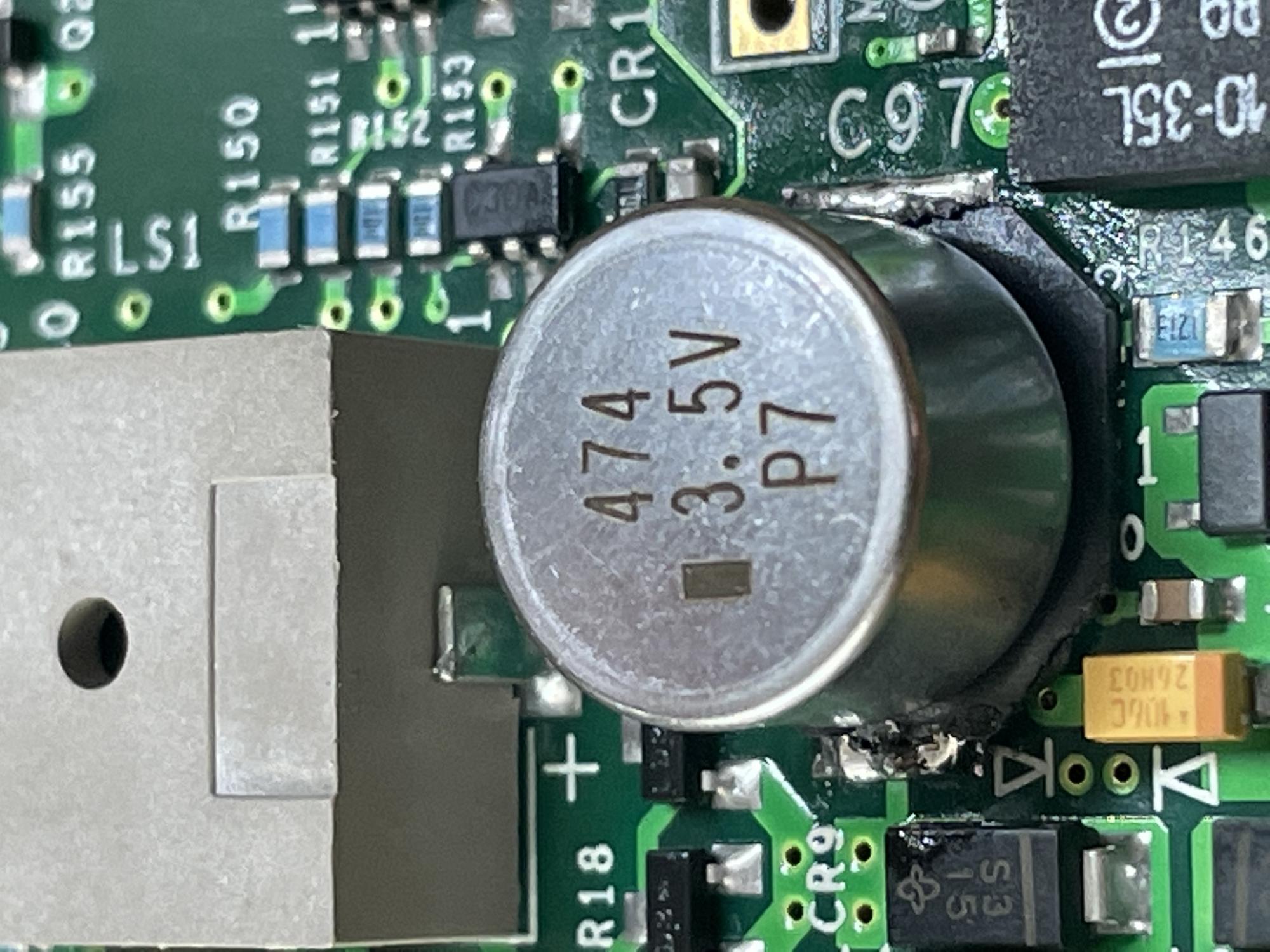

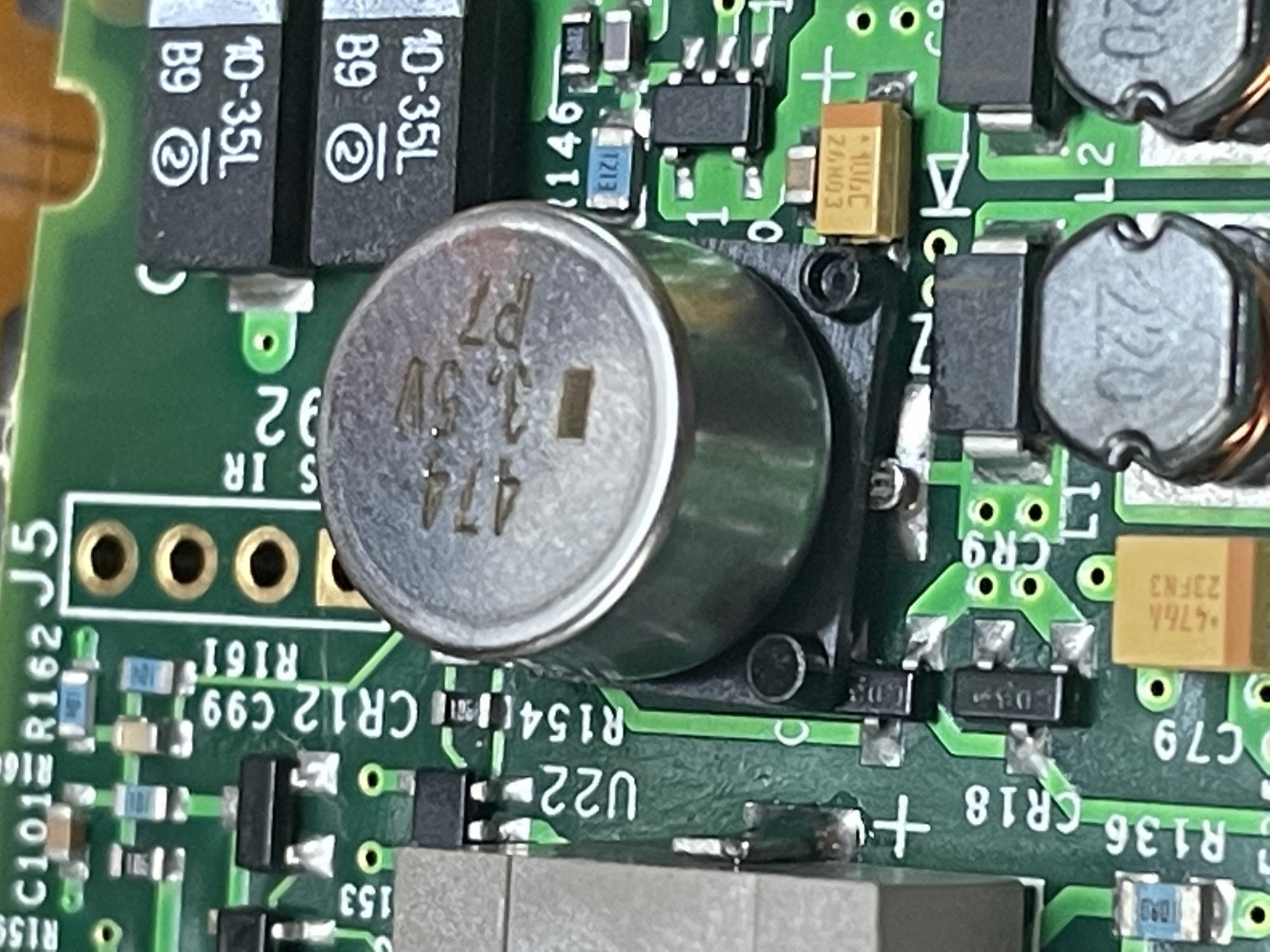

              Panasonic EECS0HD334H 0,33F 5.5V it bigger.
              The diameter is close to the maximum possible.
              The height is normal and might be even greater.
              negative leg has been cut.
              But the current consumption has increased in sleep mode from about 10 μA to 60 μA (my another multimeter is not very accurate in this mode).
              Also I performed a test before soldering- charge the supercapacitor to 3.0V and keep it for 24 hours, the voltage after that was 2,24V.
              I found similar supercapacitor with vertical legs in my stock :-) the voltage after 24 hours was very close to the first one

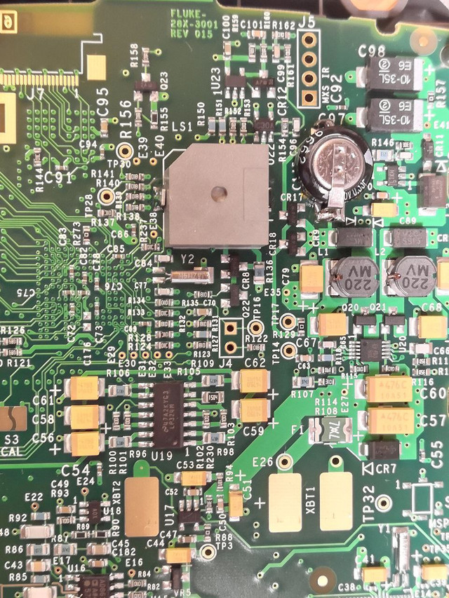

                Yeah... I figured that out too that 10.5mm diameter is the biggest that fits in there.
                Panasonic EECS0HD334H has been discontinued long time ago. I came up with a Eaton KR-5R5H474-R. However the diameter is 11.5mm.
                You can squeeze this in too with wires: TDK EDLC371420-501-2F-50
                Anyway... I guess I have to wait until the ELNA DSK-3R3H224U-HL are back in stock in September. Ugh!

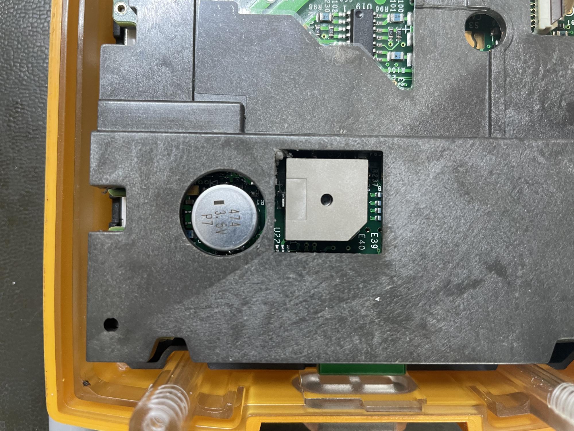

                      I replaced that ELNA DSK-3R3H224U-HL with a KEMET FC0V474ZFTBR24 from Mouser. This new cap is much bigger than the old one, but SMD, 3.5V, 0.47F.
                      The corners on the cap need to be cut and that plastic lid that sits over the board needs to be drilled.
