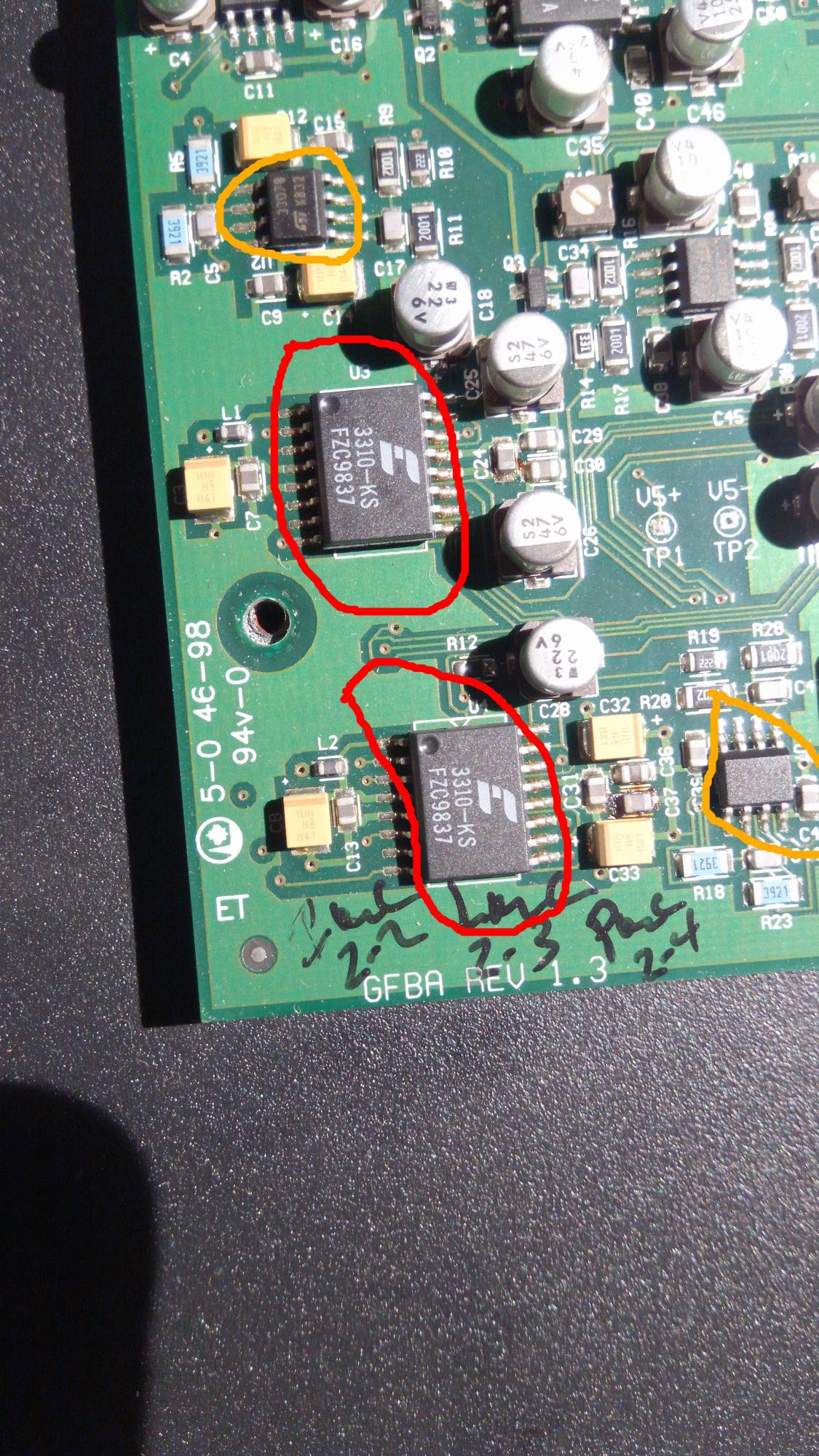

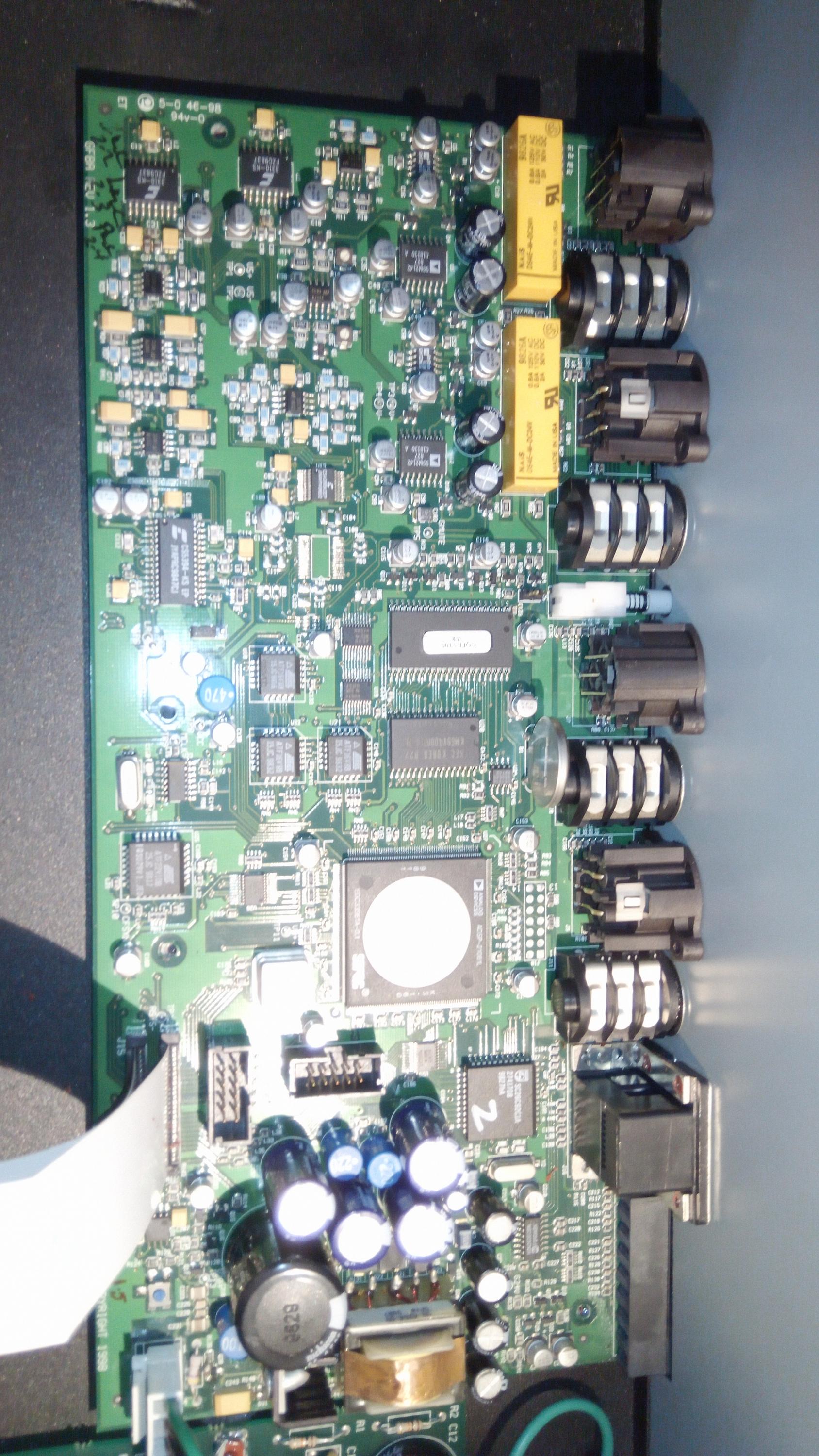

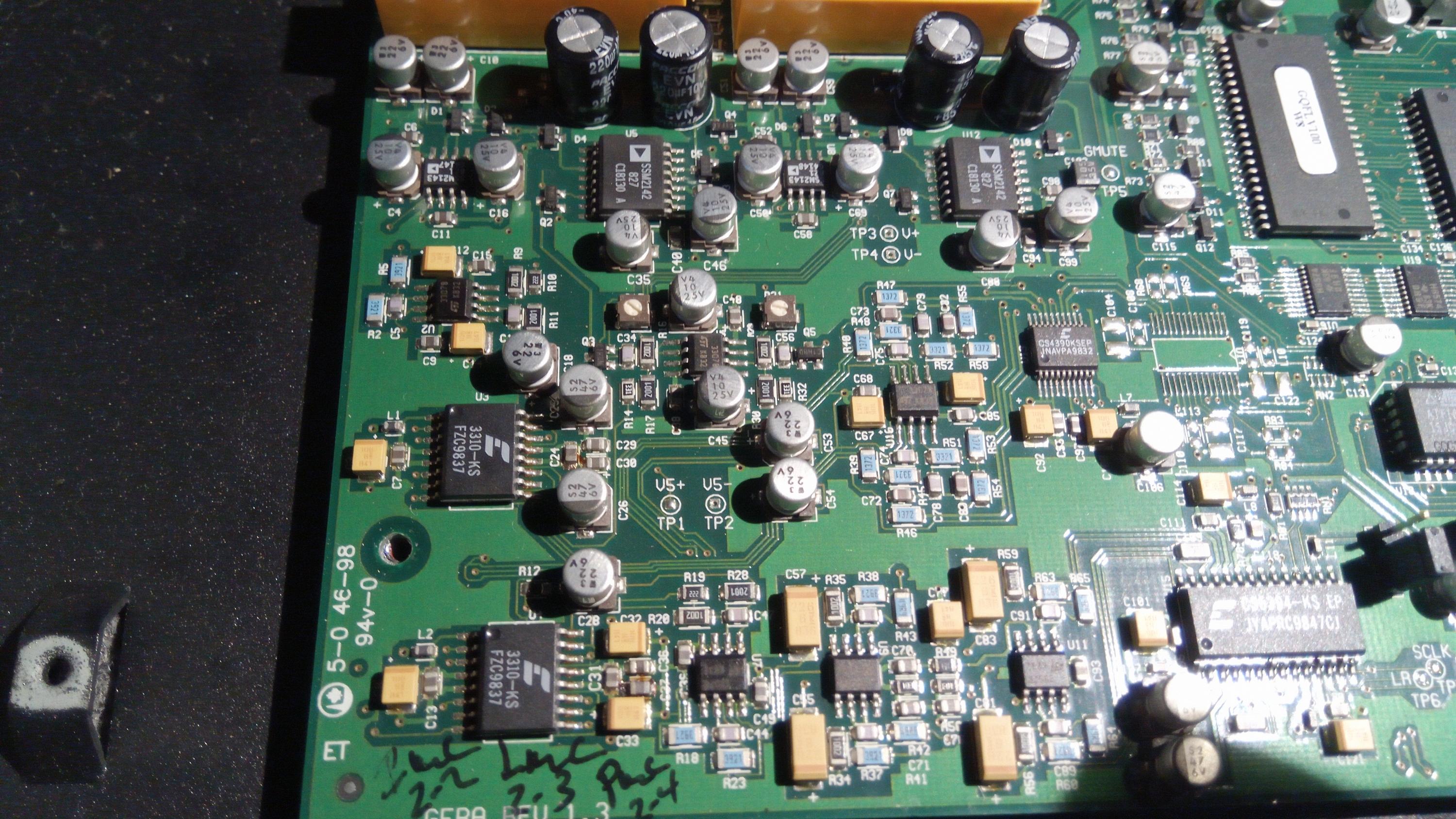

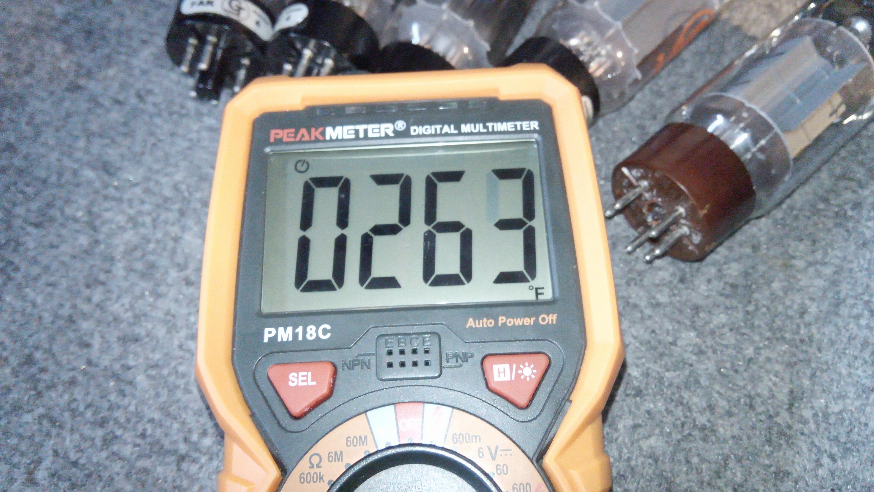

    So my dad has had this Sabine Graphi-Q for years and could never repair it as it's way above his head. Well, I went into it and found two things, the DIGITAL power in rail for the MC3310-KS chips was being dragged from 2.0V to 1.5V. The ANALOG power in rail was being dragged from 5.0V to 0.3V(!). So the chips are shorted. How do I know? Both of them go up to 300 degrees Fahrenheit, after I let them cook for awhile. Plus the inductors on the power rails have melted, not in a way that they're bad, they just have their plastic casings deformed. Still perfectly functional.

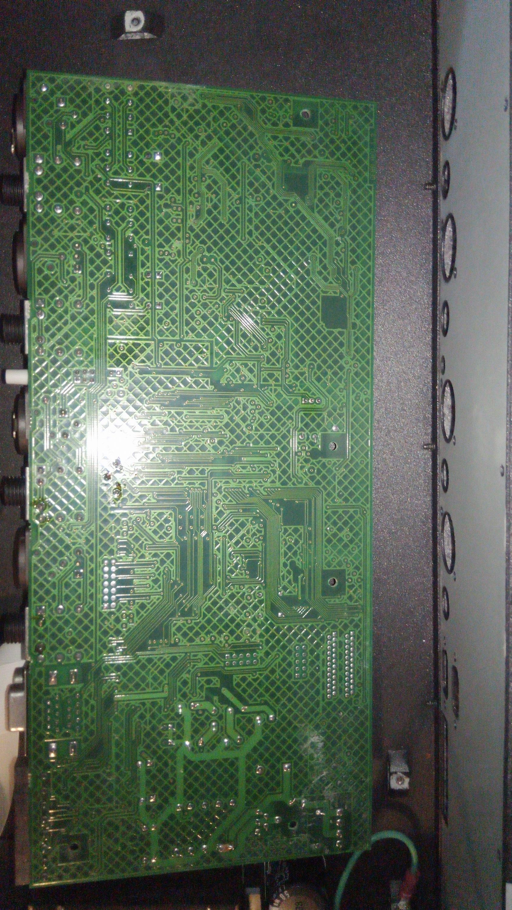

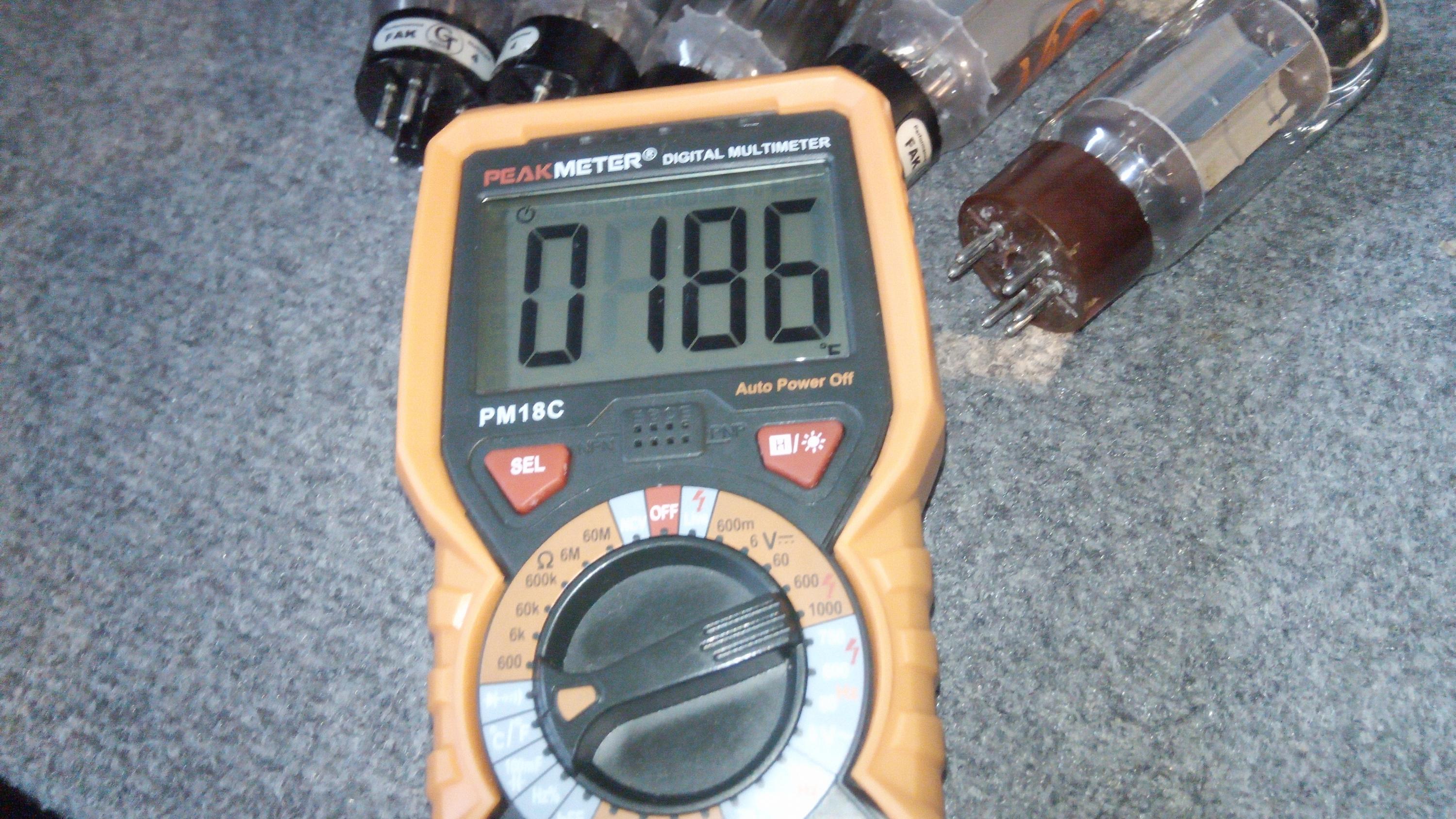

    High res zoomable pictures attached. There are 4 components that are circled in one. Red was the 263 degree chips that eventually go to 300. The others are some MC33078 low noise dual op amps. They go up to about 180-190 ish. What I'm wondering is if all 4 chips have gone bad, should I replace them all or should I be looking further? I can't make heads or tails of anything because no schematic and double sided PCB that I think has multiple layers due to the microprocessor/DSP.

    desolder them and see if the voltages are still being dragged down.

      Removed them just now. Thing powers on, except C24 has gone up in smoke. No idea the value at all. Lit up red hot and then went out as the output relays click on. I checked the cap on the other chip for the one that fried, C31, and it measured 5uF. So probably something in the region of 6.3v 4.7uF.
      Not sure where to go from here other than replace that cap with a 4.7uF cap and put a new set of chips in.
      Edit: The Dual op amps still are getting up to 180 degrees. So I assume they are shorted as well. However they are much smaller so that would explain it powering on.
      Also, C31 & 24 are both on the analog power in.
