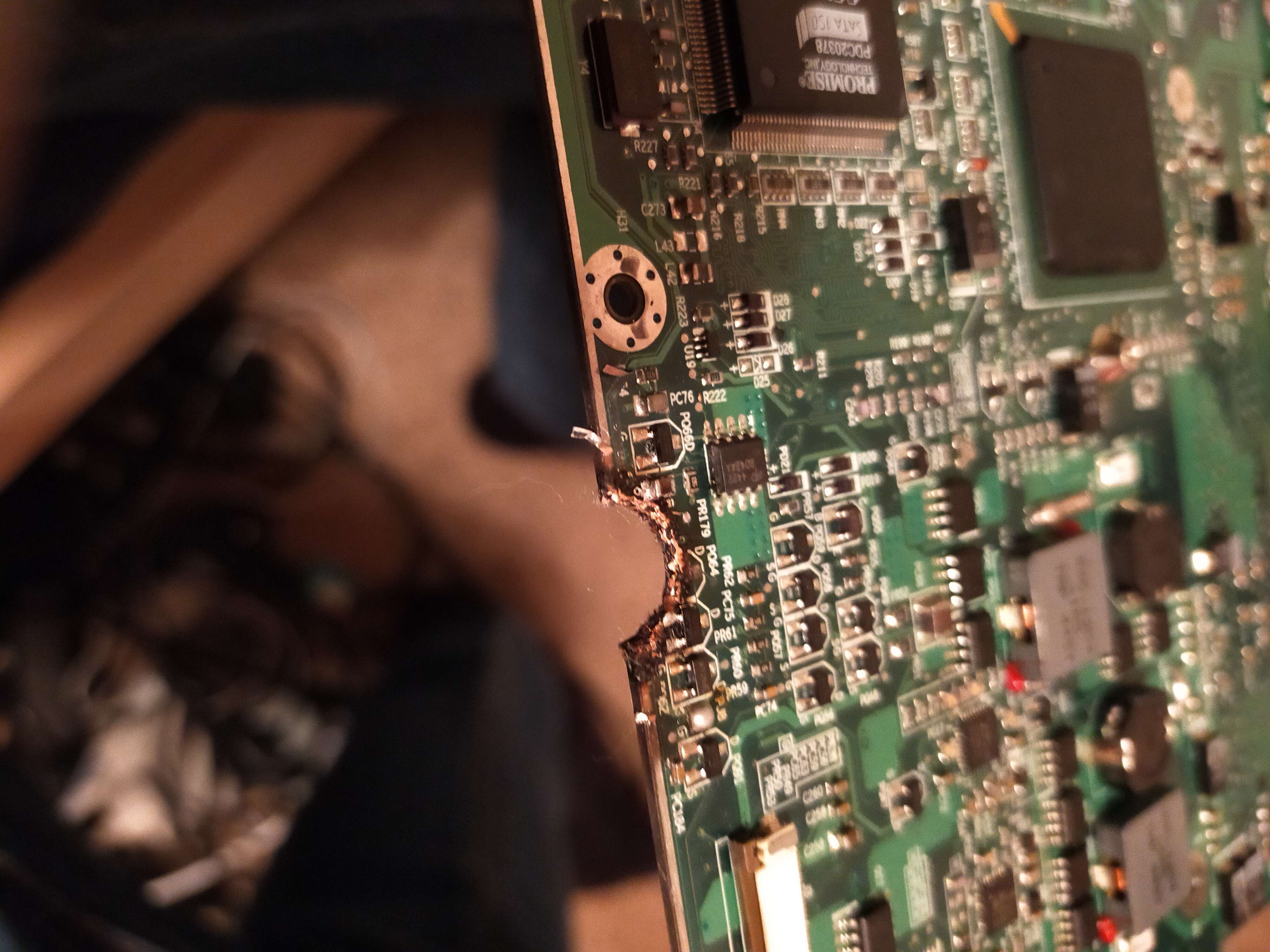

          Do you know much about the NV41? According to techpowerup there was only "one" GPU under the NV42 number (6800 Ultra I believe) either they didn't find any others or that's the only chip. Gonna say it's as unreliable as the latter due to it basically being the architecture of "most" I'd the 6000 series. But as it's a 2004 laptop I'm keeping my fingers crossed.
          According to some Clevo owners the Quadros in the D900T fair Better than other cards. It's just upkeep you gotta keep ontop of and since the M7700 is based on the same system it should be relatively the same. (Exept my motherboard has a large hole.blown in the edge thanks to a very angry trace catching fire.
ID:	3219110 a new board is expensive but I don't have much of a choice I think somebody offered to take a look at it for me but I'd be shocked if they're able to fix it...even if the system powers on the DJ board on the front of the laptop will never run again as most of its components were. Consumed by the fire.
