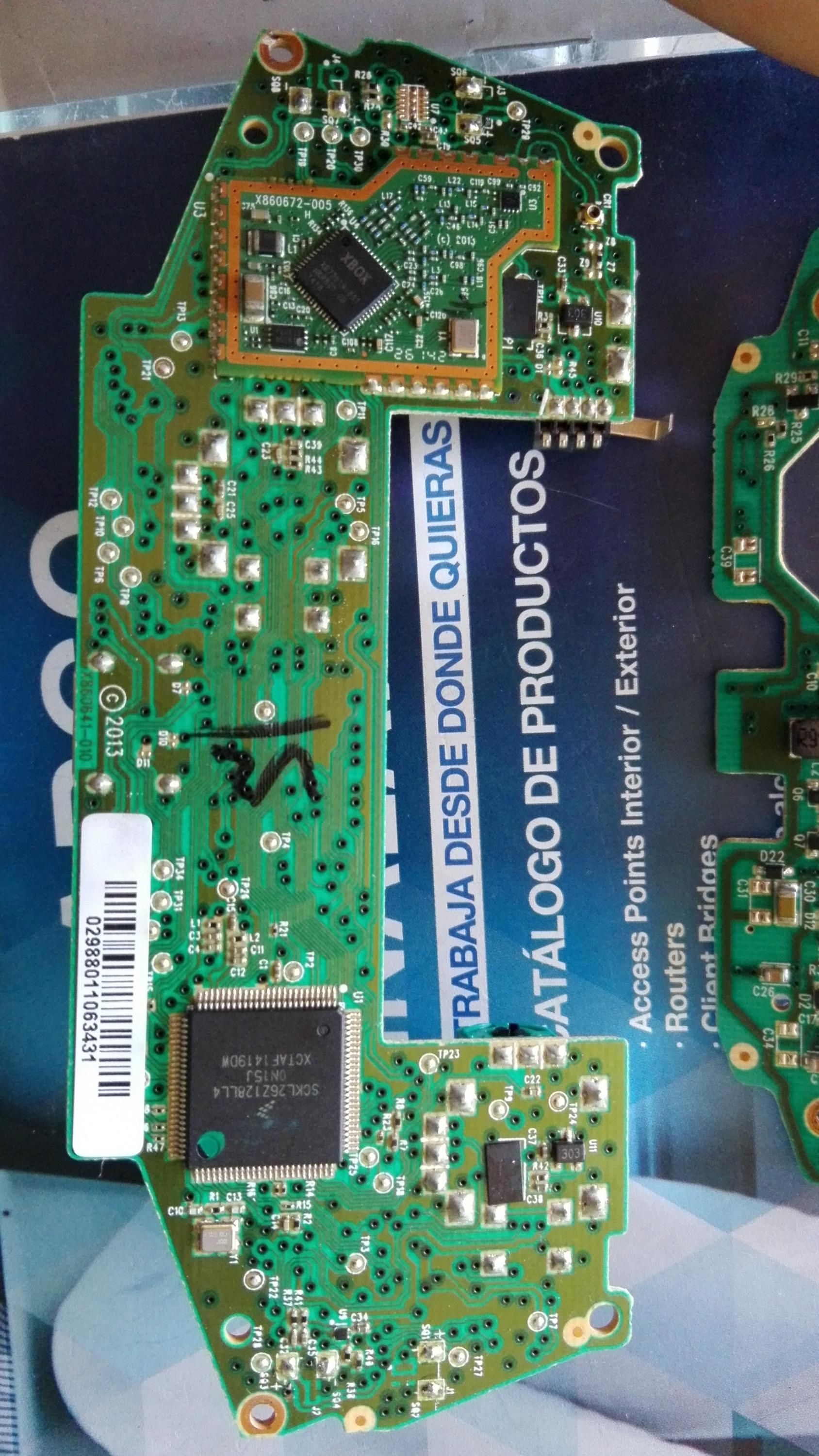

    Xbox one controler does not turn on.
    I have a Xbox one controller model 1537 that does not turn on at all when I press the home button or to sync. It was tested with a usb power cable and with batteries but with no luck. So I proceeded to disassemble the controller to find out it has gotten wet by some kind of sticky substance. As a usual, with a deep cleaning using isopropanol alcohol to get the sticky stuff off then reassemble with no luck. The next step is to check to make sure all the individual components are getting the required voltage but this is were I need some assistance.
    All and any suggestions will be taken into account plus very appreciated.

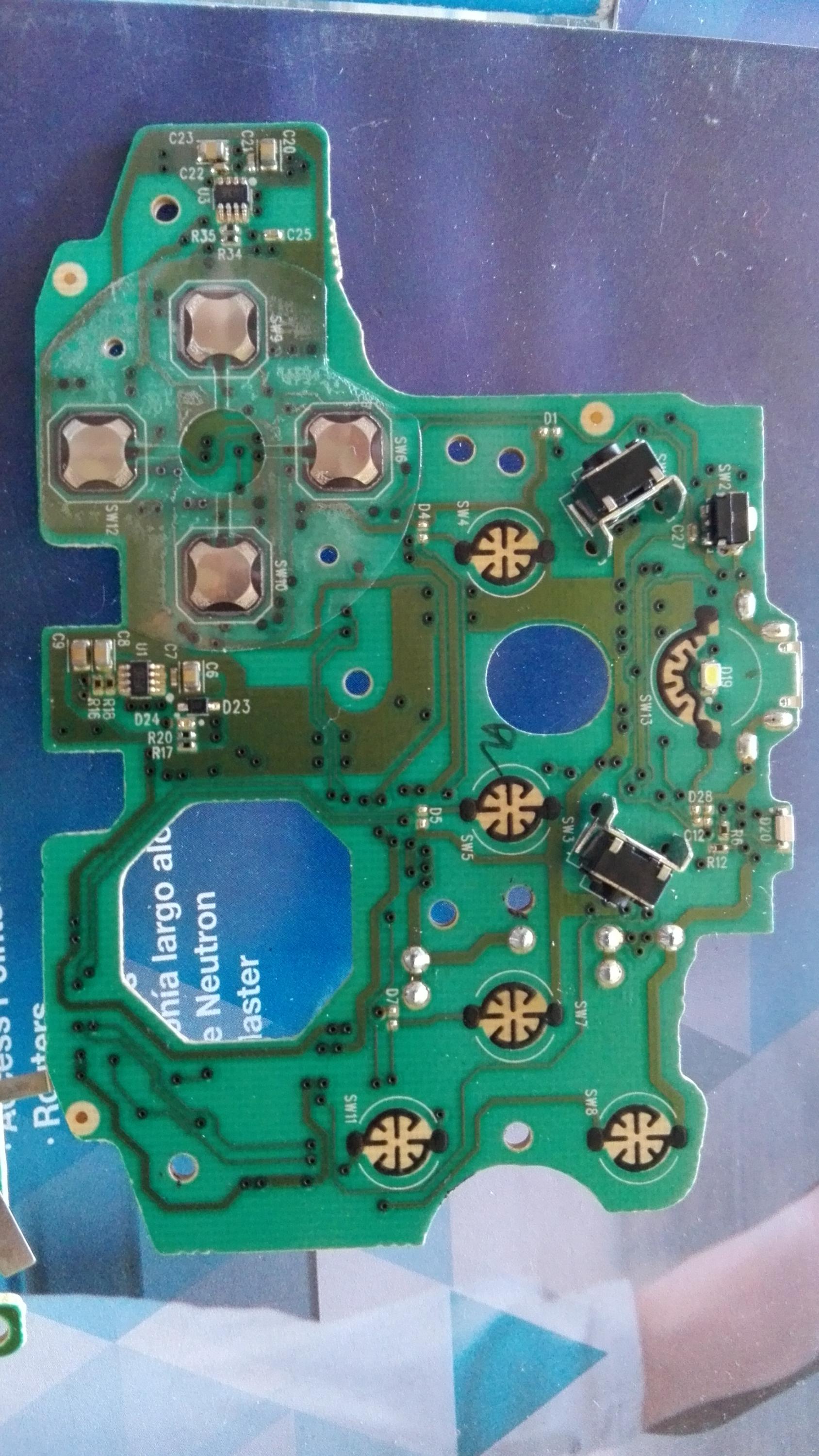

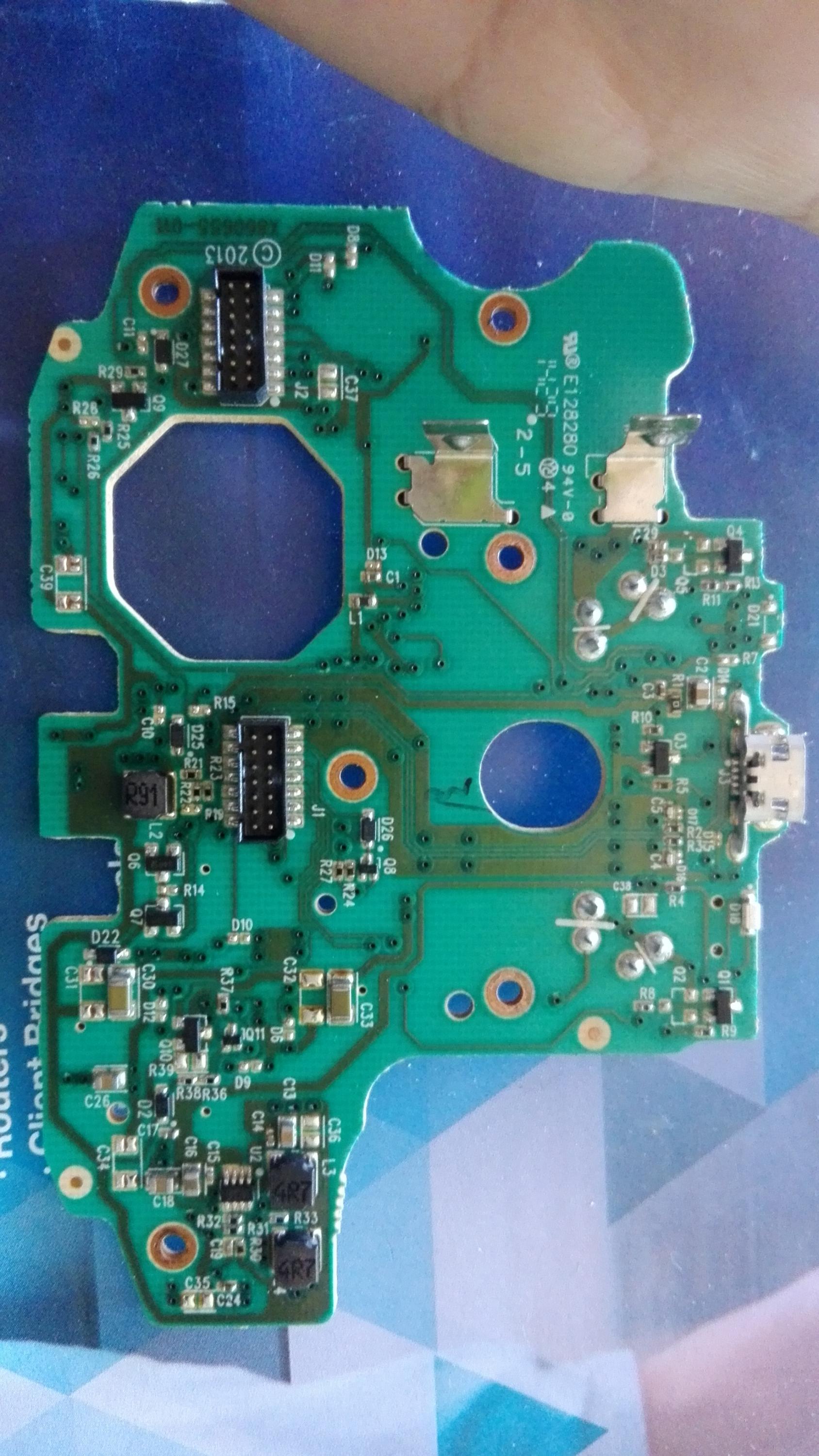

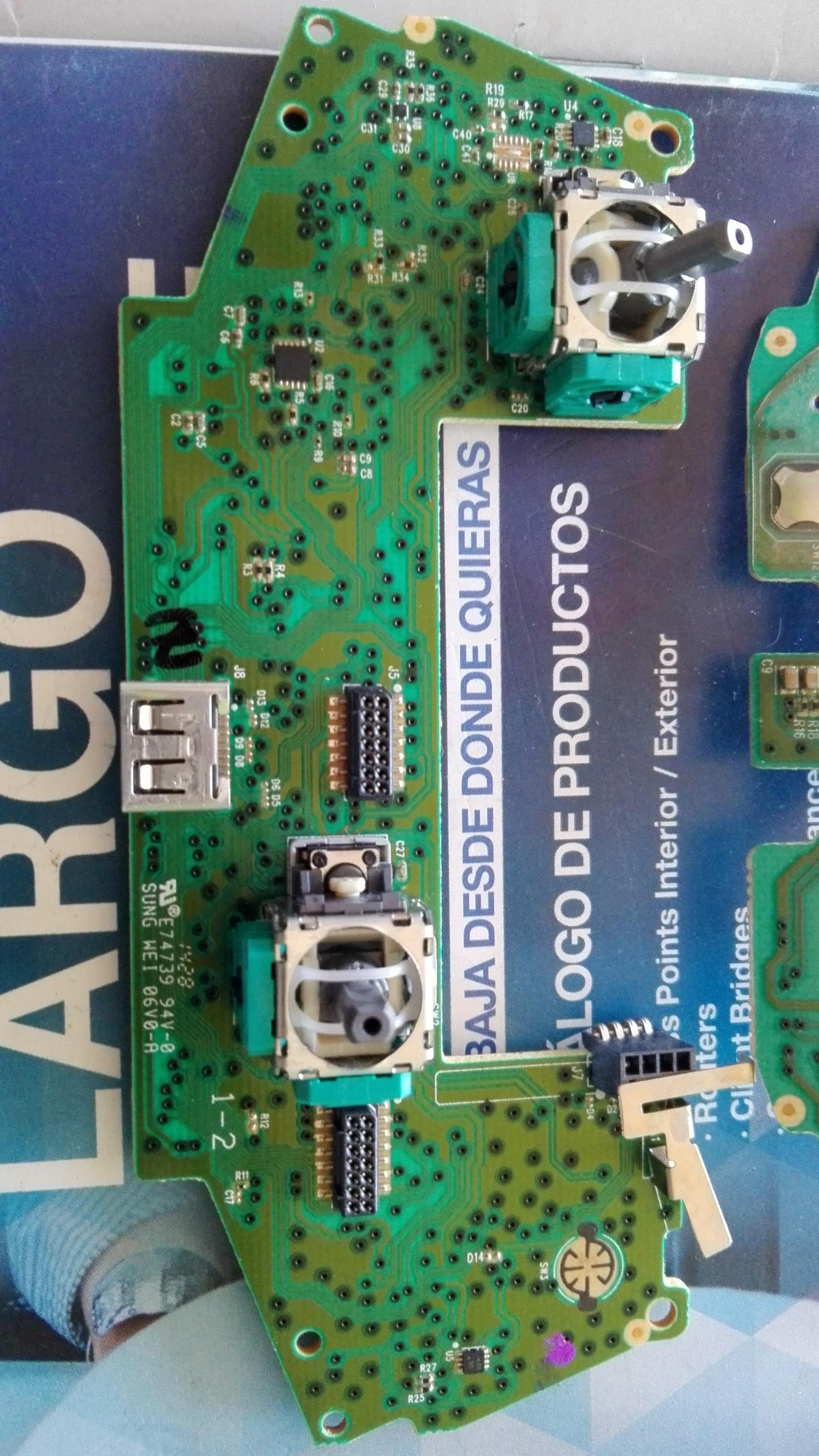

          Ok, here goes. Top and bottom views of the boards.
            • Jul 2011
            • 6065
            Re: Xbox one controler does not turn on.
            Start where the battery is and work towards the microcomputer or micro controller and see if get power to that point
            This means hit the power button to try to power ON unit when you try to getting these readings
            I would also look this hole board over with a magnifying glass at all of the soldiering joints to see if you crack or dull joints
            Look at these places at the battery and switches very closely for cracks and dull joints

                            Found it! Turns out its a bad capacitor marked C33 that was causing the shortage. Now, this raises a doubt due to the fact of some missing information. What value does this capacitor have in order to replace it properly?
                              • Jul 2011
                              • 6065
                              Where is the cap located at on the board power supply rail or some where else on the board
                              • Drassh
                                • Apr 2017
                                • 43
                                • Mexico
                                It is located on the power supply rail, bottomside of the board. Use the 3rd picture that was uploaded above as reference if you don't have a controller on hand. And thanks sam_sam_sam for bearing with me.
                                  • Jul 2011
                                  • 6065
                                  The value is not real important but use a 250pf something small like that and see if the unit works with a value like that
                                  • Drassh
                                    • Apr 2017
                                    • 43
                                    • Mexico
                                    Got it, and the controller is working now. ^.^ Thanks
